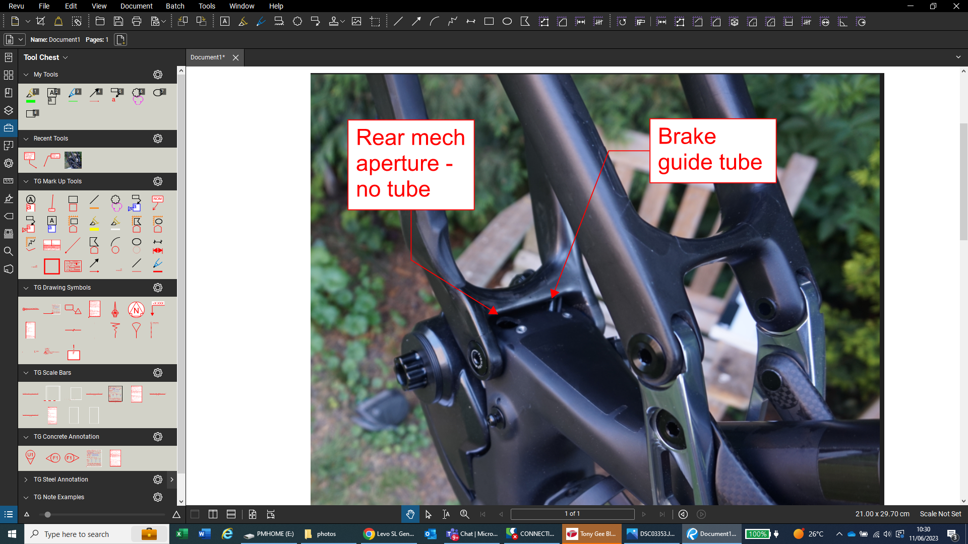

I am building up a frameset and and struggling to install the rear mech cable sleeve. According to the assembly instructions there should be a plastic guide tube running from the chain stay and over the motor to the bottom of the down tube - but there is no tube provided. The cable sleeve refuses at the end of the chain stay near the pivot where the sleeve needs to bend fairly sharply.
There is a guide tube for the brake so no problems here.
I was wondering whether the frame was assembled with AXS in mind and hence no need for a mech cable?
Going to contact the LBS tomorrow, but was wondering whether the lack of guide tube is common over all framesets? In the absence of a tube, I guess the solution is disassemble the chain stay pivot and drop the motor, and try to wiggle the cable sleeve through. Not keen on this unless I have to!
I reckon so, I’m running AXS but was curious when I was building mine up and had the same result, outer cable feels like it’s hitting the motor and/or harness. There isn’t true tube in tube routing, from port to port on this frame.
It looks the same for a cable actuated dropper, it’ll be a motor down job, I’d try dropping the motor before dismantling the rear stays as it may give enough access to get the cable through. Dropping the motor doesn’t look too much of a hardship.
I assembled the frameset and had to drop the motor for the rear mech cable and seatpost one. Someone on here suggested leaving the rear two bolts in and swinging it down, that worked really well for me and I didn’t have to unplug anything. All my motor bolts were loose so I assumed I was expected to drop the motor.
I had exactly the same issue and unfortunately you have to drop the motor 😒
Thanks for your advice. A bit of wiggling of the cable outer in the chainstay, followed by dropping the motor (with rear bolts still attached) has sorted the problem.
