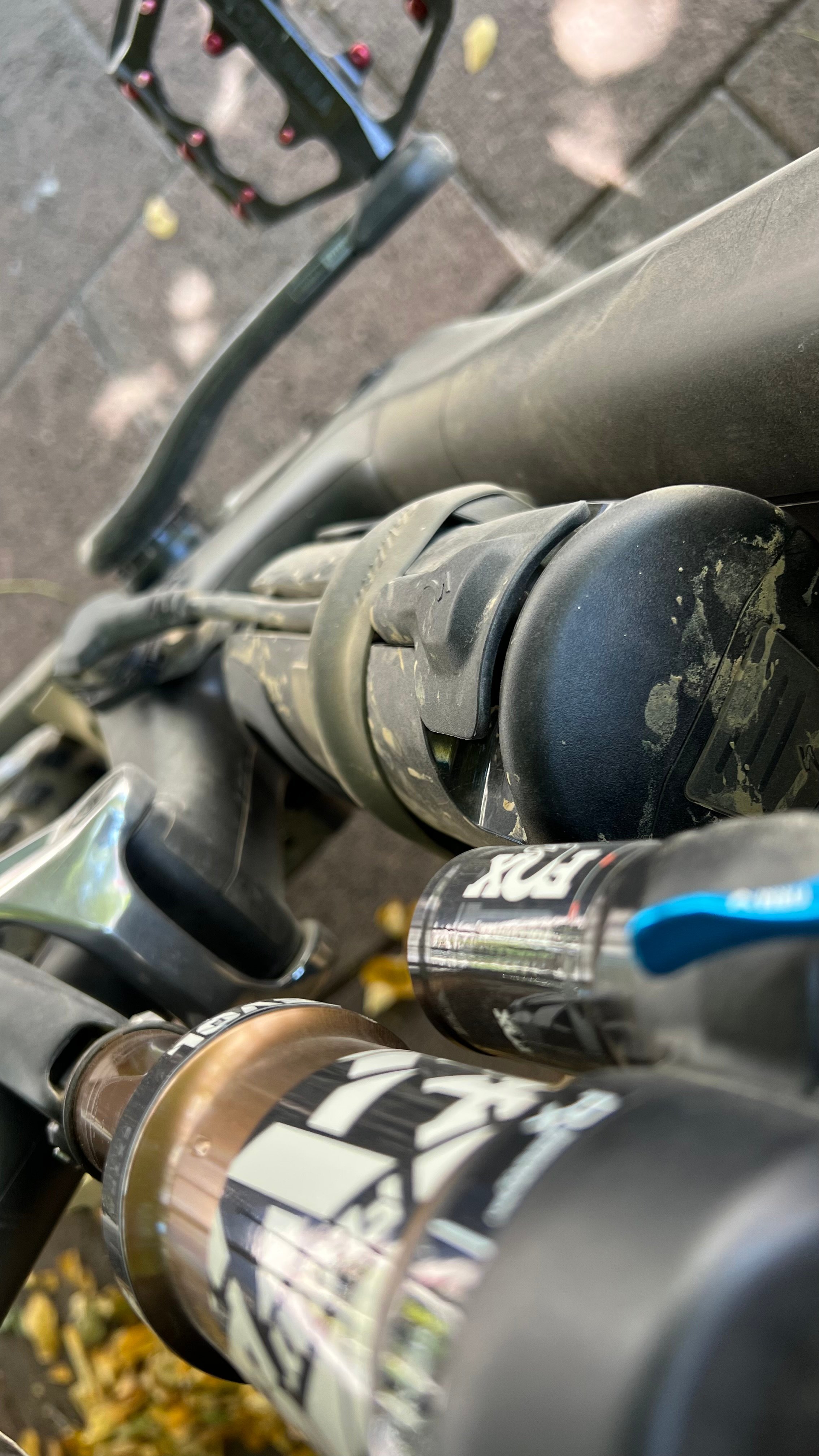

Rode high speed chunky stuff today using full suspension travel and again the range extender disconnected. I would place the band higher but i still want it wrapped on the cage too.
Am i the only one experiencing this issue? I don’t use the cage for hydration so wishing there is a better mount for the RE with a dedicated mount
Sounds daft, but are you ensuring the plug is fully in. They seem to have 2 stages of insertion. Firstly locates the plug, then a much harder push to lock it in place.

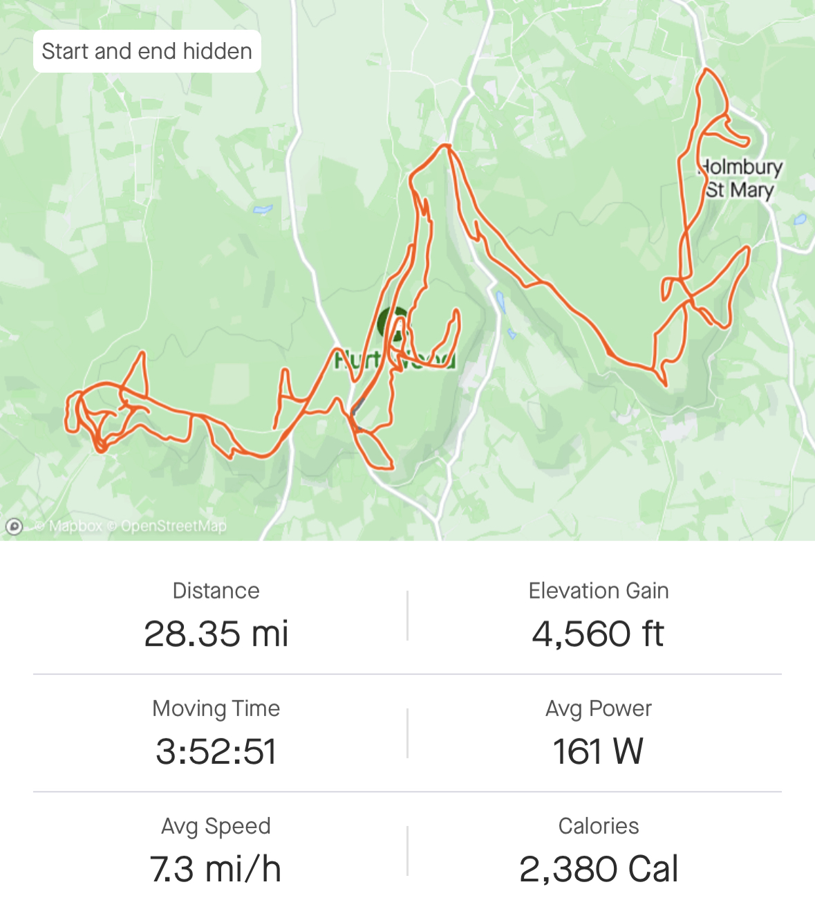

I manged another 3 hour ride, 3298ft elevation, 19 miles, and this was without the range extender in the surrey hills. Its strange but it seems the battery is lasting a lot longer now I've done more rides, maybe its the weather or my cadence?
Finished with 18% left over
30% trail at 40/70
50% mastermind 40%
rest was eco (30/30)

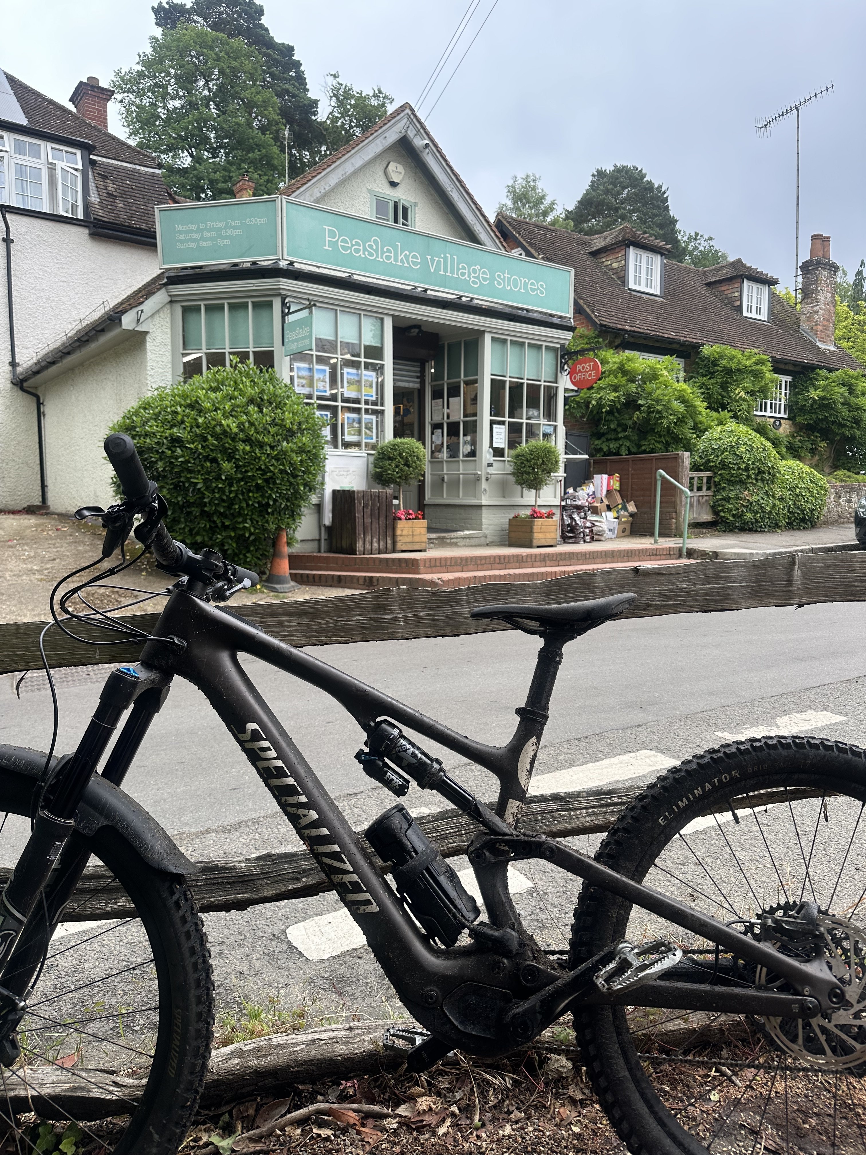

I'm not so sure about that - I think it's there to make sure the bottle cage doesn't 'open' when bouncing down the trail. That's where it's fitted in my owners manual too. The cable once correctly pressed in - should stay in place.
Some people, me included, have experienced cut off unless the rubber band is over the plug. I’m aware that Specialized photos show it around the cage. I still had problems recently even with the rubber band over the plug but since releasing the connection cable from its slot in the battery extender near the motor end, I have not experienced a reoccurrence. Something to do with vibration?
Need to make sure its correct in its connection also. I've had times it seems connected at the plug and it hasnt been. I ride with mine with the band around the extender and never had it drop out on trail even doing steep descents, large jumps and drops.

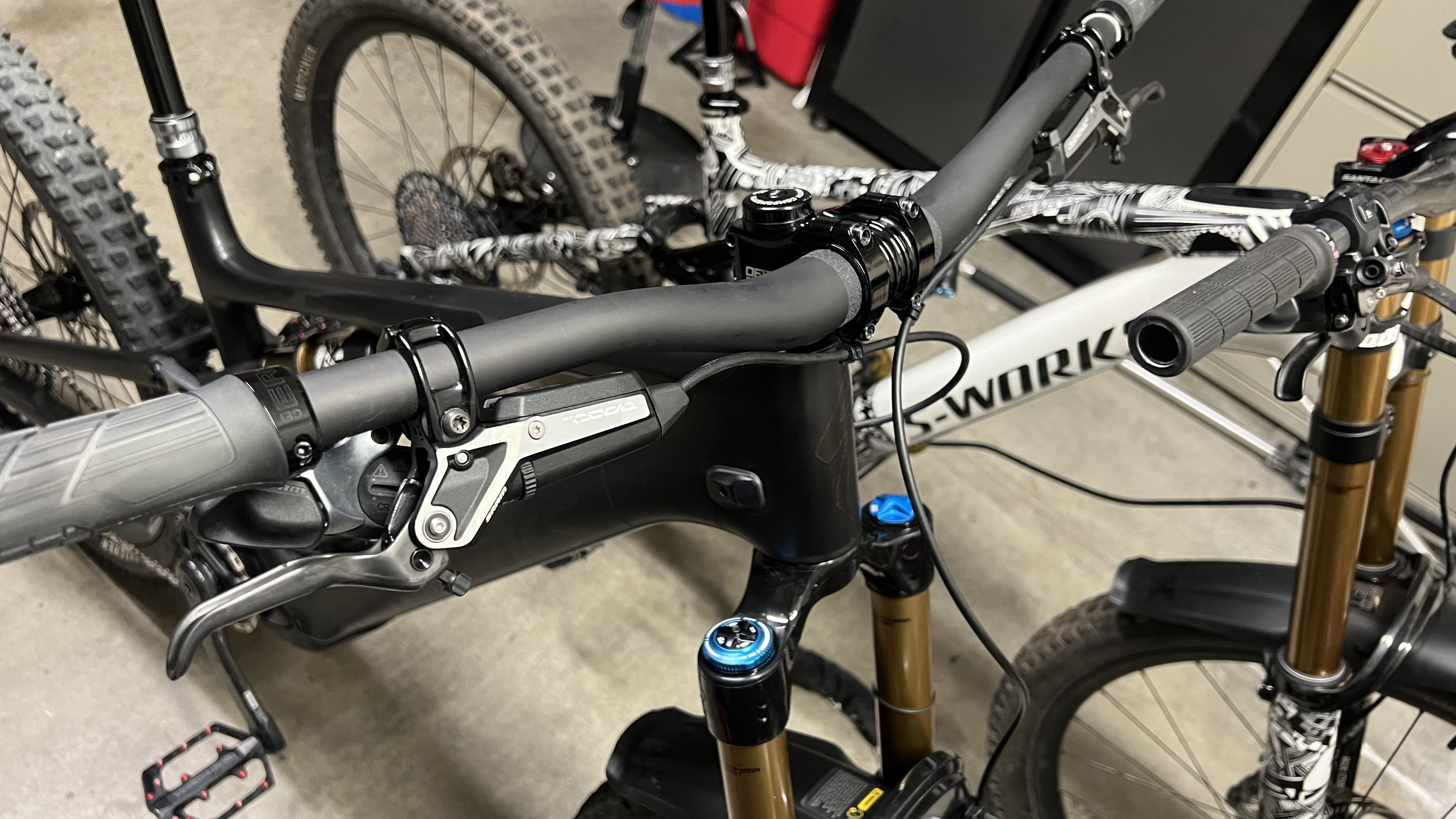

I tried to get used to the new AXS Pod controller for shifting. I like the old controller better
If specialized can do a firmware update so a button on the Pod can connect to the TCU to toggle assist modes. Then I would use the other button to control the dropper…. (Left side)
Haha I must be doing something wrong here . Made sure cable was pressed all the way before the ride
