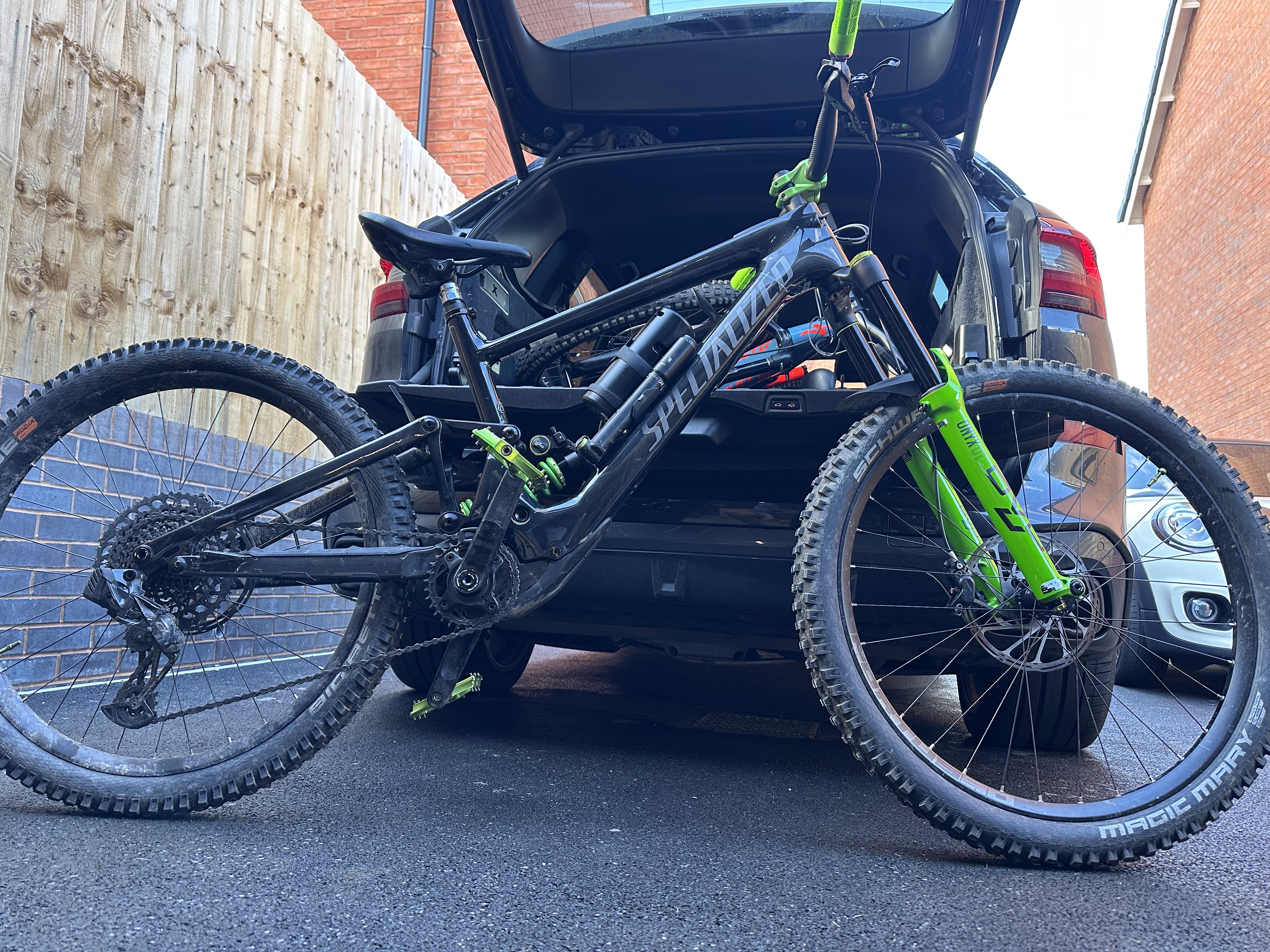

This is mine, Changed my mind on the colour once I saw the Brown, I’ve worked for UPS for 27 years so I maybe indoctrinated 🤣
S4 with AXS GX and lyric ultimate. I have to fit my AXS dropper in the morning when I pick it up.👍🏼

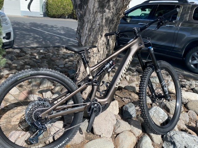

I picked up my Levo SL II Comp today, size S3. Riding it back-to-back w/ my 20' Levo SL, I can attest that the s1.2 motor is indeed noticeably more quiet than the S1.1 motor. gone is the mechanical whine at high cadence, I would put the new motor, sound wise on par w/ the Levo Brose 2.2. motor or quieter, which for me is plenty quiet. The Increase in torque and power feels spot on! Diggin the Diappolo Brown Sand color also. It's like a matte UPS brown. maybe a tad darker/ perfect!

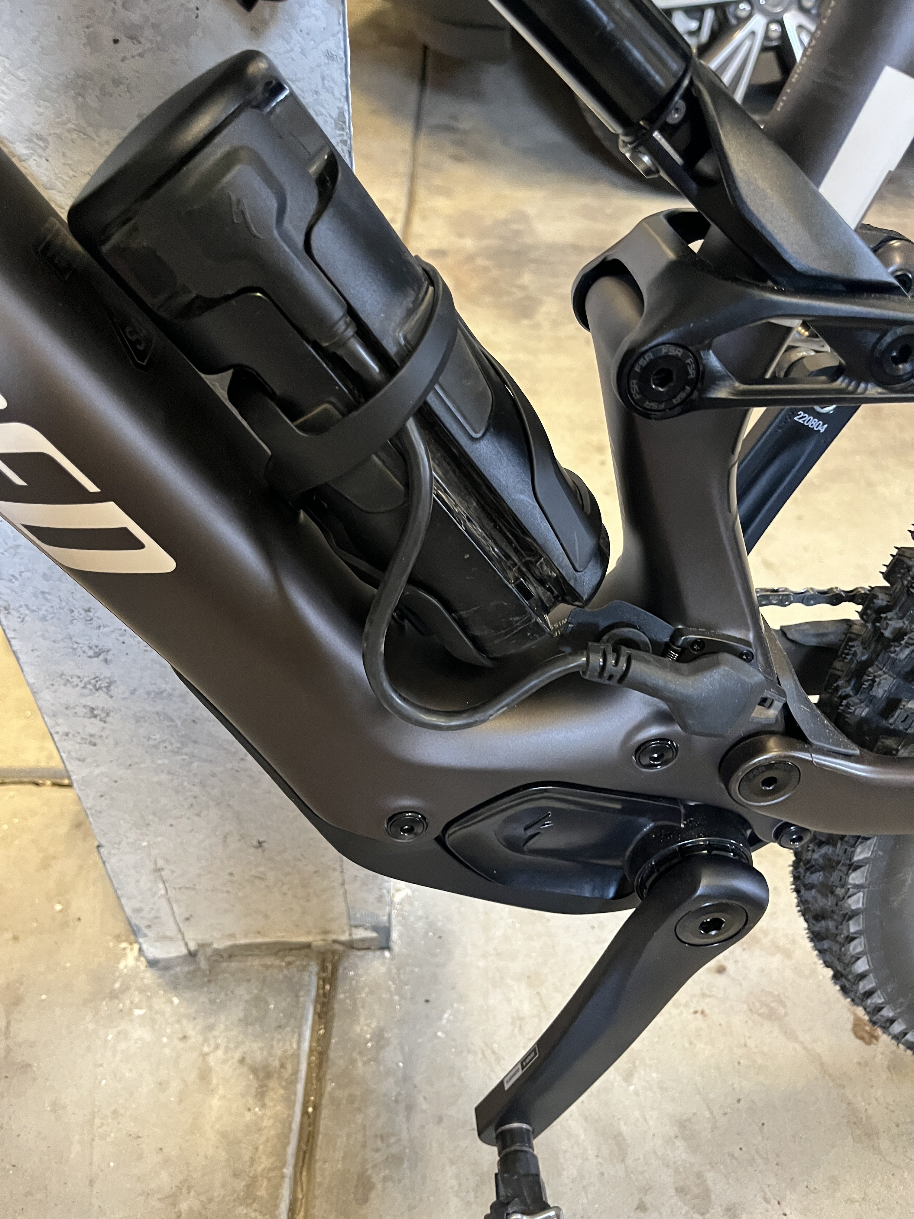

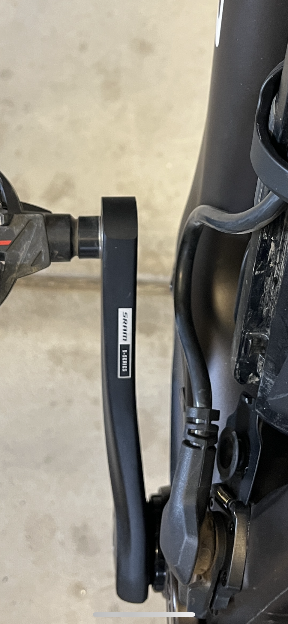

Here is the 160mm (i.e., the old one) range extender cable on my SL2. It's workable. I called Specialized Denver and there are no 145mm cables to sell me at this time. All the 145mm cables went with the S-Works bikes.
If you have an S-Works, I'd love to see what the 145mm cable looks like when it's connected.
View attachment 113685 View attachment 113686
Here it is.
Source: New 2023 Specialized S-Works Turbo Levo SL first ride review – The new benchmark in the light eMTB segment?
