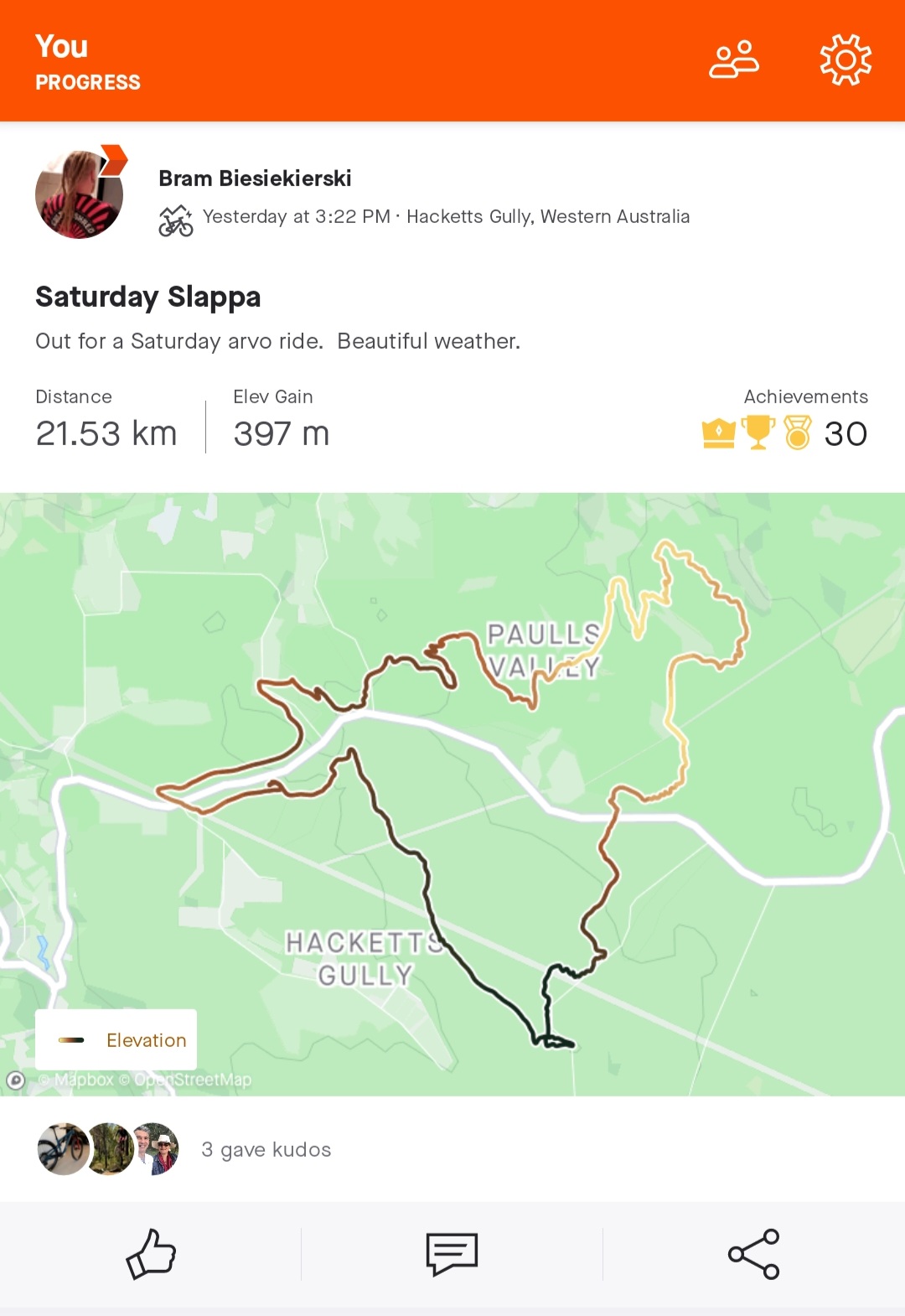

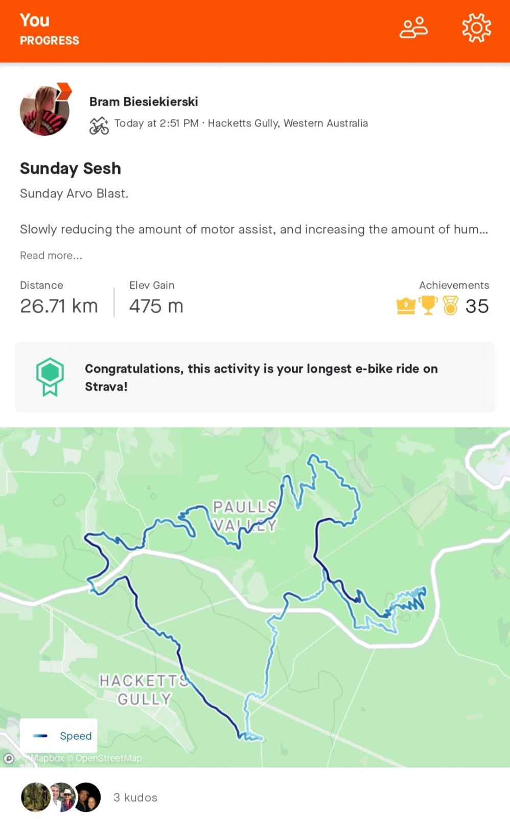

Just clicked over 200kms on the e22. Got out for a ride on both saturday and sunday this weekend. Good to blow off some steam after the hectic work week. The box prime cassette is definitely toast. Was starting to skip pretty bad in the 4th and 5th gears, at full power. 6th gear was still good, so I found myself using the higher gear more, even though it felt a bit too high at times, just to avoid 5th gear. That means I'm averaging 100kms per cassette.
These 2 rides I did use lower assist, keeping it in level 2 most of the time. Also reducing the amount of throttle im using. Got 25kms out of the battery charge on the Sunday ride. Which is nice compared to my usual 15-20kms.
I feel my cardio is improving, and I am using more legs over motor.

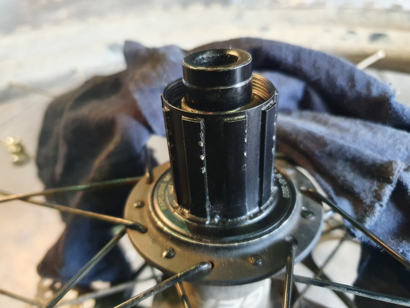

I did also pull down the worn box prime #2 9spd cassette. I didn't end up fitting the box prime #3, as the cassette is a different design.
The #2 has an alloy flange that connects all 4 of the lowest gears together, and distributes thier load. But the #3 has each gear independantly keyed to the freehub splines. And I know from experience, doing that on a shimano HG splined freehub is a completely shit way of doing it. These gears will just destroy the freehub and chew the splines up in no time.
My freehub has some minor gouging already from the 4 or 5 highest gears, after just 100 odd km. (The freehub was brand new before I fitted the box prime 9spd) I actually had to pry the old cassette off the splines, because of the damage they had done. The section that had the alloy boos for the 4 lowest gears has absolutely no wear at all. Because it distributes the load over a much larger area.
So using the box prime #3 would only make this so much worse, as each gear is separate, and very thin.
I also compared the chain with a brand new box prime chain, and there was basically no wear in the chain that I could measure. Maybe 1-2mm over the entire 126 links. Which is bugger all. So that is good.

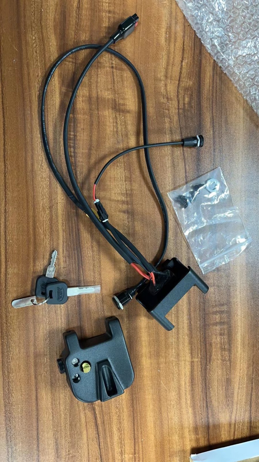

Hi,
I've finally received the frame. (y)
But it did not come with the battery docking and locking mechanism nor did come with the charging connector. (n)
I've contacted Dengfu (Mia) and they say this is normal because I did not order the battery from them. :mad:
Is this normal? I did order the frame only with no battery, so I guess this is what happens when you do so. But still seem kinda stupid. Not to mention I asked them several times what accessories and parts would be included and all they said was headset and thruaxle. To be fair, they did change correspondant mid conversation. (Melody was replaced by Mia).
Anyone know where I can find this elsewhere?
bram.biesiekierski
Apr 18, 2022
424
258
Perth WA Australia
Hi,
I know Melody made mention of this when I ordered my frame. I bought the battery and motor from dengfu all at same time, so that wasn't an issue for me.
But a similar thing happened with the shock mounting hardware. I ordered the complete frame, headset, thru axle, and even ordered extra derailer hangers. When the frame arrived, I noticed there was no shock hardware. I contacted Melody, and that is when she mentioned it's separate. Facepalm!!! Perhaps they could mention this to the customer, and enquire if they will also require the shock hardware?
You could try DingTai Battery, or try Green Bike Kit. They both sell the batteries, and may also be able to source the mounting hardware.
Cigales
May 19, 2022
45
28
France
Yeah they really suck at customer service. I guess that is what you get when ordering "cheap" stuff from China. I tried my best to ease the conversation so that I could get as much information as possible. It's just not simple when you've never ordered a frame only before, you need to know these details.
Luckly I did receive the rear shock mounting screws, all I need now is the bushings.
I've contacted Herbert from DingTai Battery, i'm waiting for an response. Good idea to contact GreenBikeKit, I shall try them right now.
Fyi, It seems I also have the screws for the battery mounting brackets which excellent.
EDIT:
Anna from GreenBikeKit responded very quickly and told me she may have them and will check tomorrow.
She also provided me with a picture :giggle:
