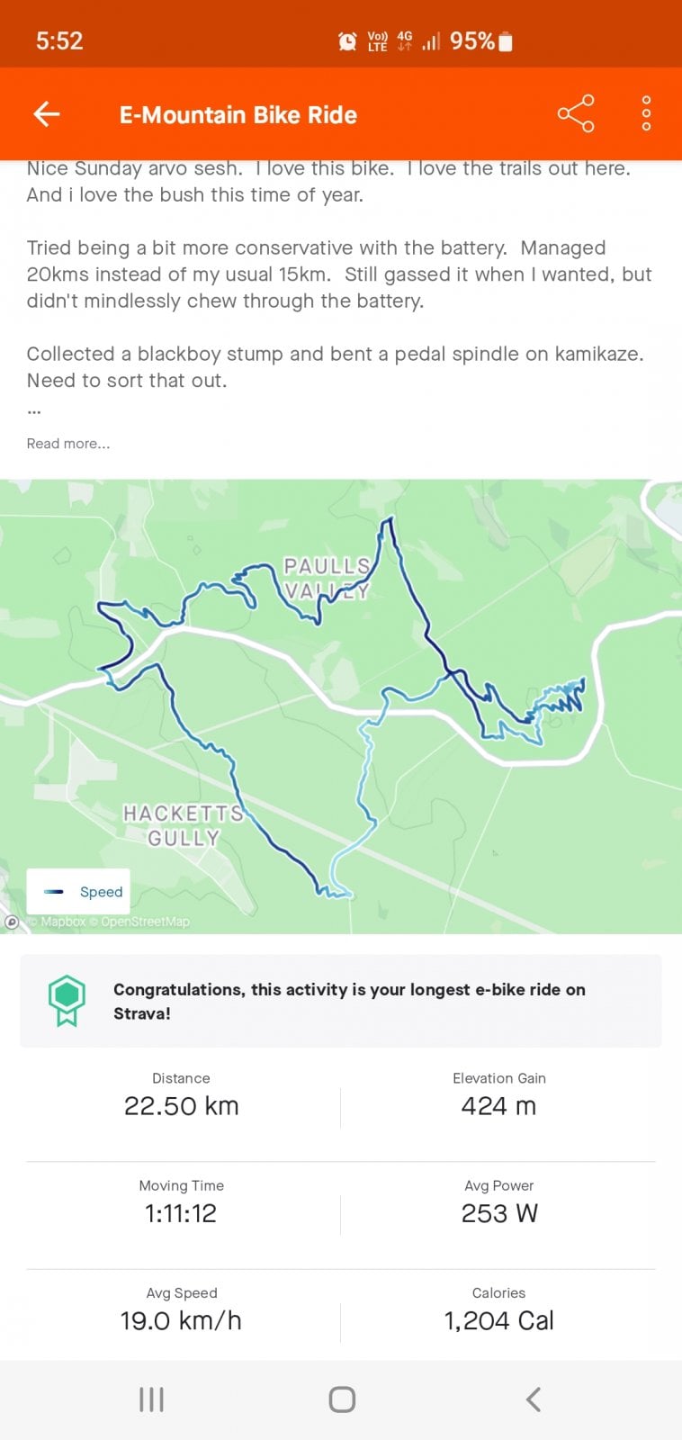

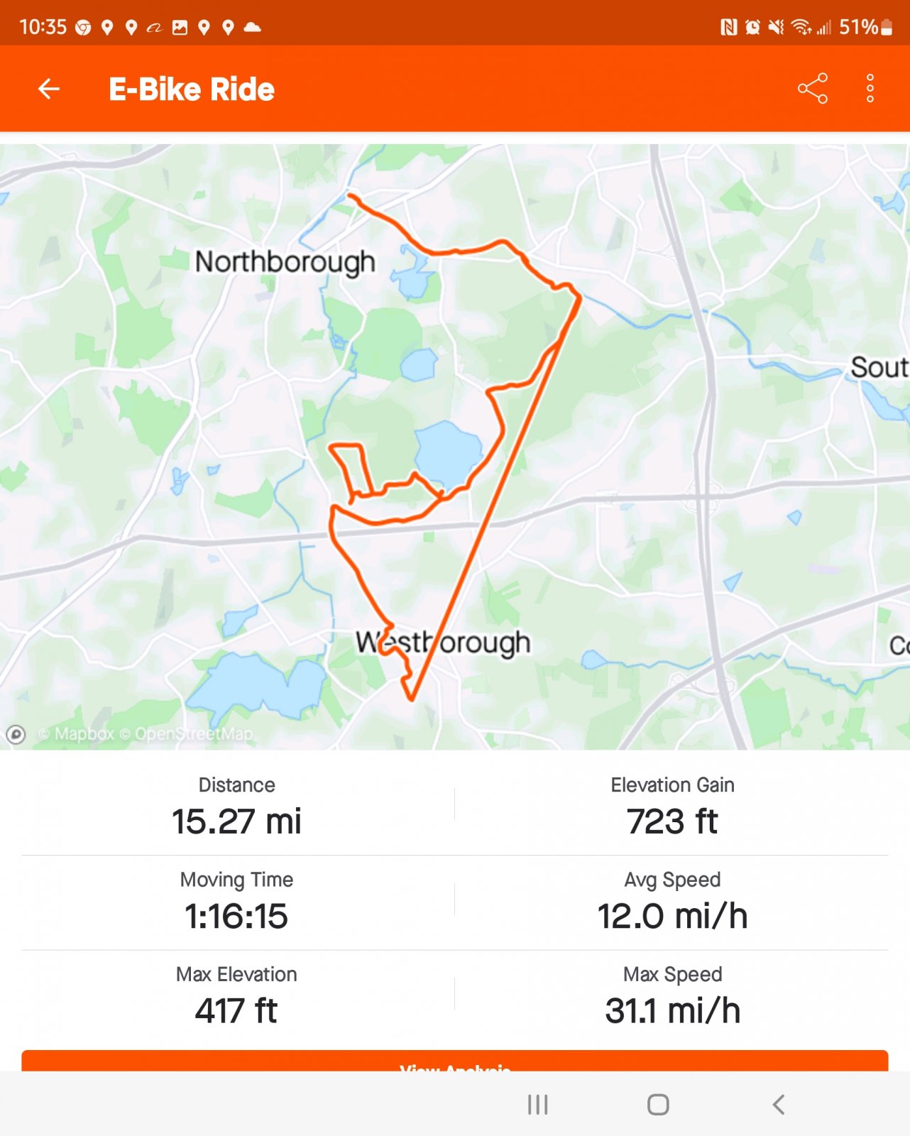

How did you get the wattage and calorie to record ..? .. I'm completely new to Strava. I took a short ride today and it only had distance elevation speeds and time.
bram.biesiekierski
Apr 18, 2022
424
258
Perth WA Australia
I think it automatically calculates it based on your weight, and bike weight. You have to enter this into your profile I think. Then it just looks at the GPS data, elevation, speed etc and calculates it.
I think if you have power meter on cranks (more for road cycling) then that info can be also entered/logged. Same with heart rate etc from sports watchs etc.

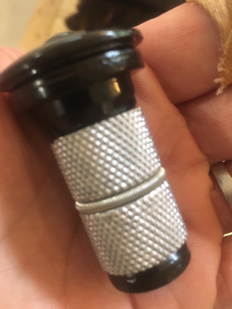

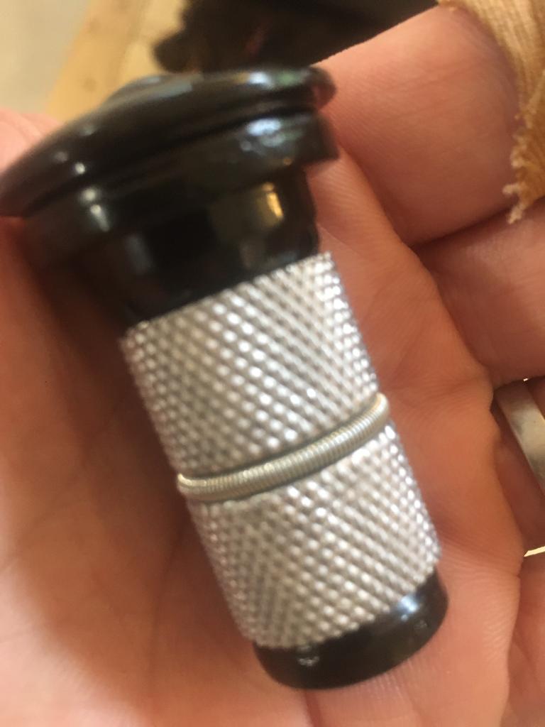

Hey Folks
I've just opened the box containing the headset that came with the frame, not seen anything like this before...is the idea that this effectively gets away from the need for a star nut? If so is it any good (and will it'll bugger up the steerer? I'm thinking about getting one of these nifty EDC setups at some point).
Cheers

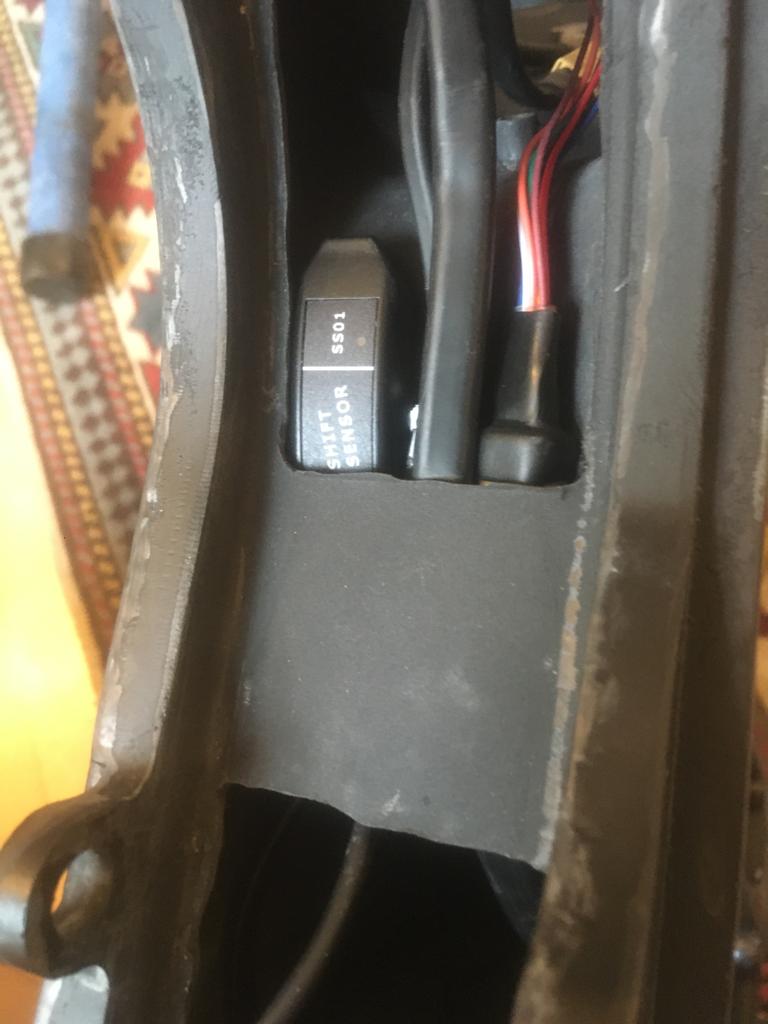

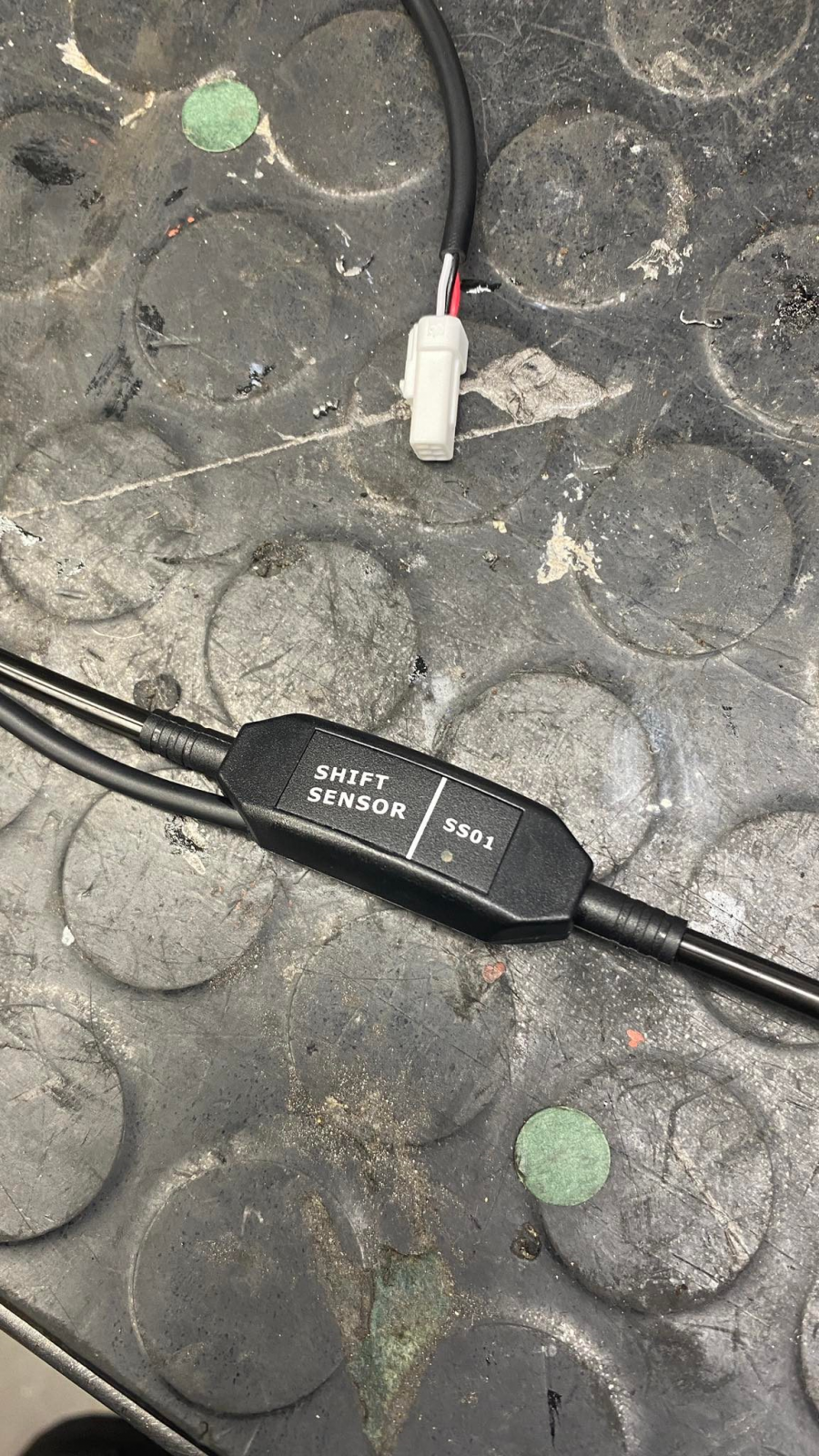

I am mounting my E22 and I have doubts about where to place the shift sensor.
I've thought about putting it inside the frame, where the shifter cable runs over the battery box.
Any ideas?
What did you figure out @Tomteam? Just looking now myself and pondering a solution, current thinking is this:

Hey Folks
Cheers
[EDIT: ewwww, horrible focus]
My headset kept coming loose and I finally figured out that was the cause. I replaced it with a properly set star fangled nut. Problem solved. I think those are mainly used for carbon fiber steerer tube forks and being a CF company DengFu sending them out that way kind of makes sense in all but practicality.
cheers, anybody else using this stock part without issues?

Hey Folks
Cheers
Thats called a compresson nurl, at least in the US we call it that. I used the star nut that came with my fork . If you have a fork that uses that then sure if not I would go by what your fork manufacturer recommends. The stock headset screw works fine with a star nut.

I don't use the shift sensor at all just takes a little learning on how to shift when not under load. To me it's just a added thing that can fail and if it's buried in your frame you hoofin home. Just my mho.
Hear you, but there really isn't much to go wrong.
I mutilated cassettes on my BBSHD before I fitted one of these (perhaps because my riding is totally unrefined). I got used to the cut in motor power during shifts really quickly, probably because I was coming from a conventional bike. My lazy logic is that not fitting one is like driving a manual without a clutch, doable, but not the brainless option.
I like brainless. Each to their own.

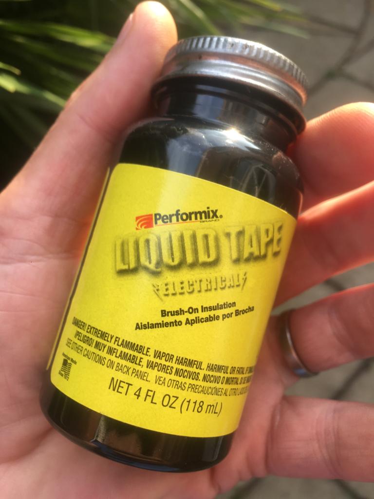

Use Self-amalgamating tape!
It will keep moist out and bond it all together.
Ha! not seen that before.
I've got an unhealthy obsession with this stuff, I used it to waterproof my quadcopters back in the day. Its amazing stuff, a gloopy paint on liquid, which cures to a rubbery insulation and can be peeled off cleanly. I love liquid tape.
I'll be slathering anything vulnerable with this goop before taking the bike outside...that said, it doesn't rain anymore in the UK... :)

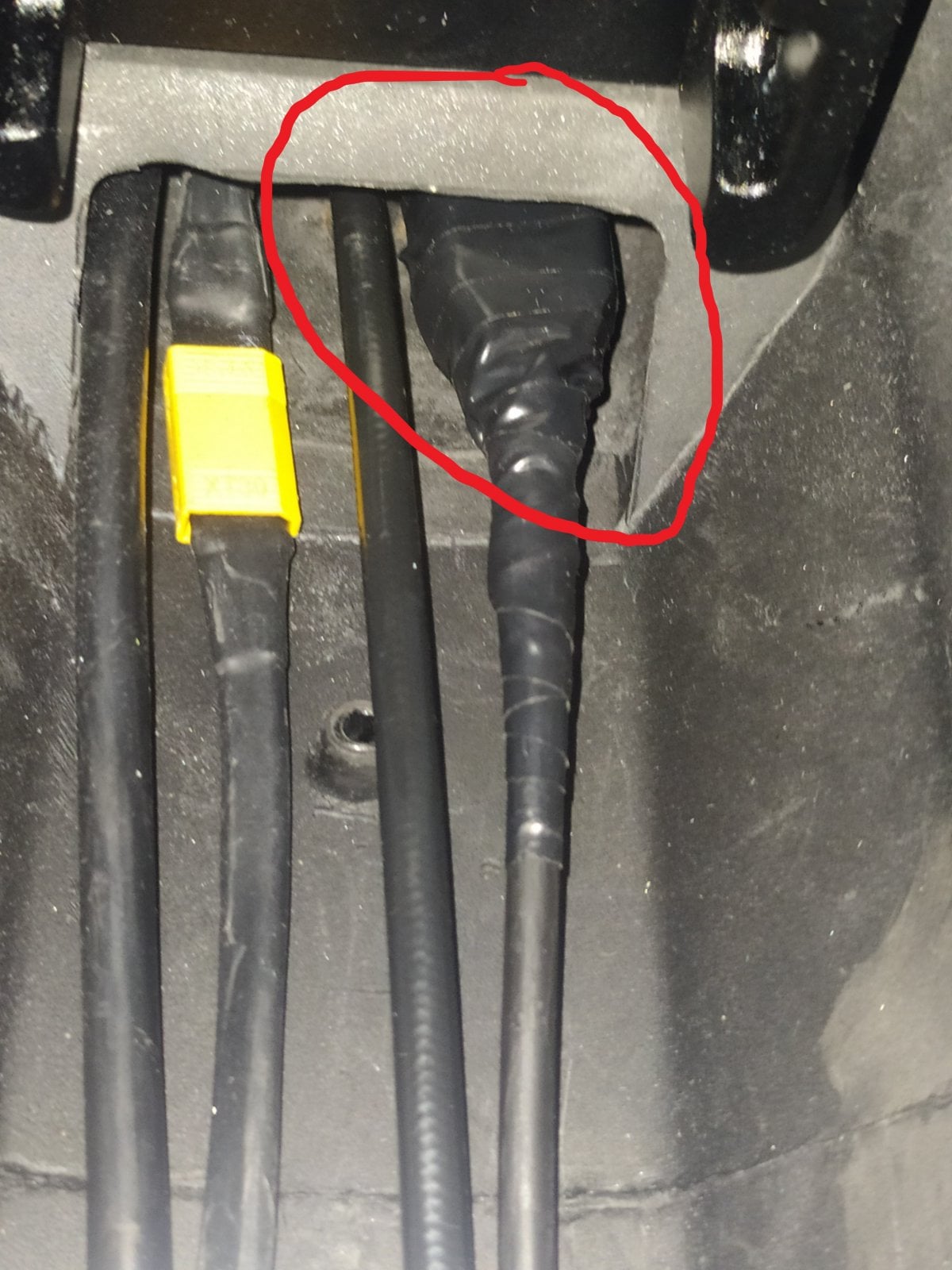

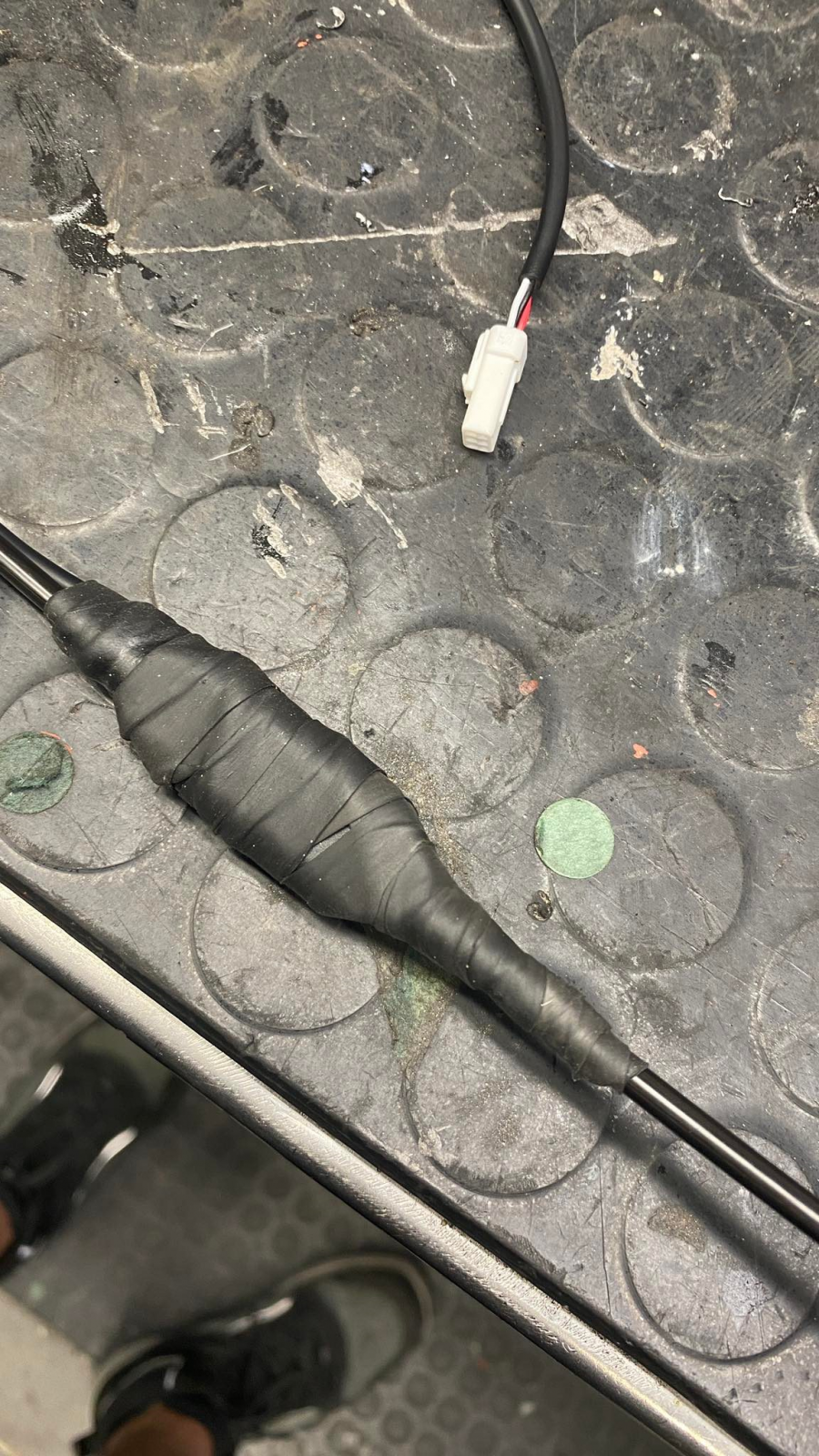

If you really want to seal something up from the elements, use denso tape. We use it on underground machinery to seal up sensitive electrical connections etc. It's like this thick oil/wax soaked cloth. Wrap stuff up, and it builds a water barrier. It's nasty stuff to use and apply. But it works. And for inside electrical connectors, Di-electric grease like senson grease.
