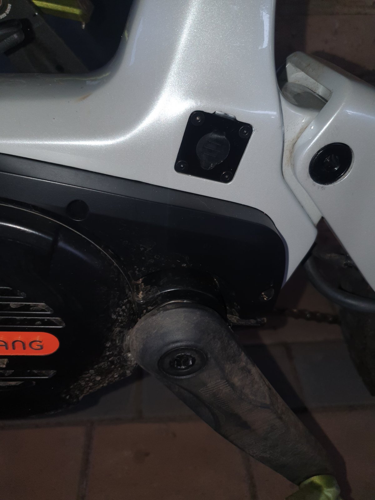

I was told by Mia (dengfu employe, Melody's replacement) that they have round and squared charging holes on the frame. I've never noticed any squared ones on any of you're pictures.
Has anyone seen that before?

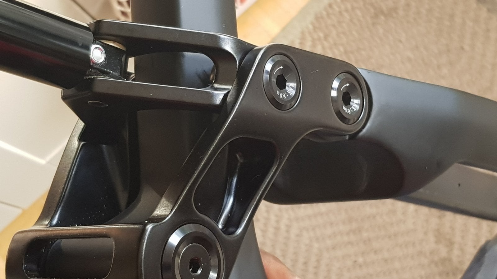

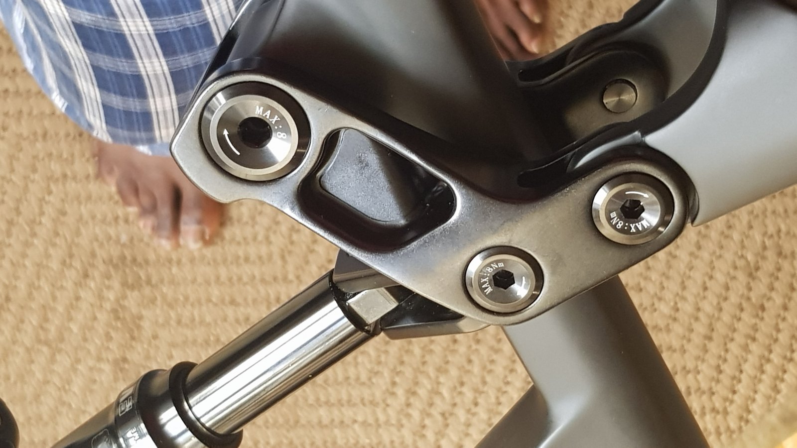

They supply the bolts for the rear suspension, but not the spacer hardware needed to fit the shock. I think you need to ask for the shock mounting hardware when you order the bike.
Although the design of the dengfu shock hardware is not that great. It's a 2 piece design spacer, with a split right in the middle of each mounting point. Which puts all the bending load on the bolts directly. I think its much better if you can find hardware with a 1-piece sleeve the full length. (Prefferably made of hard steel) That is a much stronger system, and reduces the bending force on the bolts.
As for the charger port. On mine, there is a small square cut out in the side of the bike, just above the motor. It is recessed and takes the charger port, mounting in with 4 small screws. The socket itself looks like a pretty standard circular co-ax charging socket.

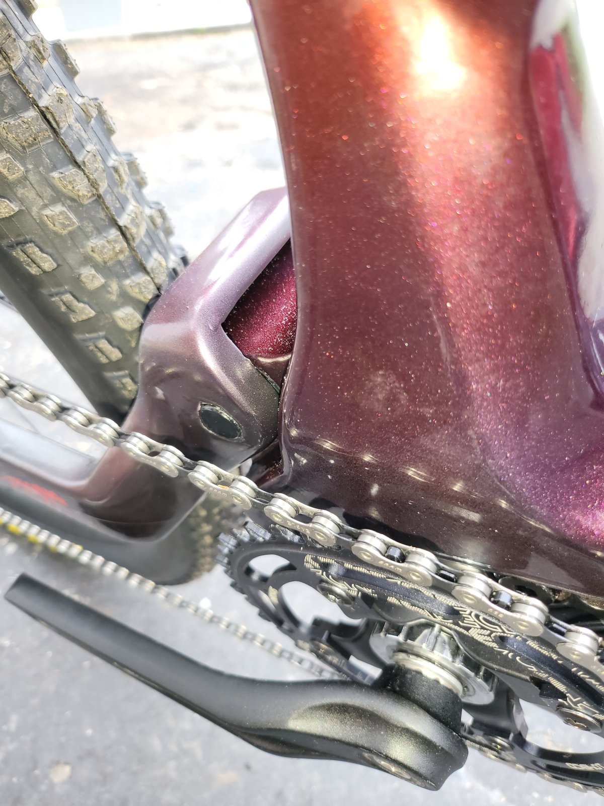

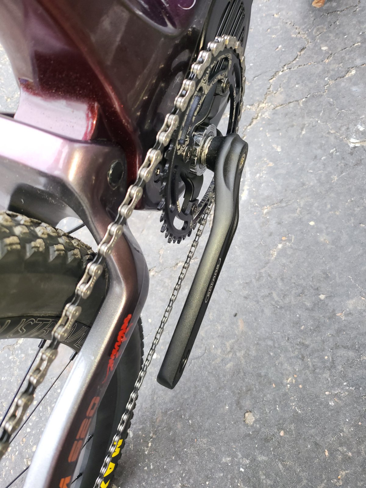

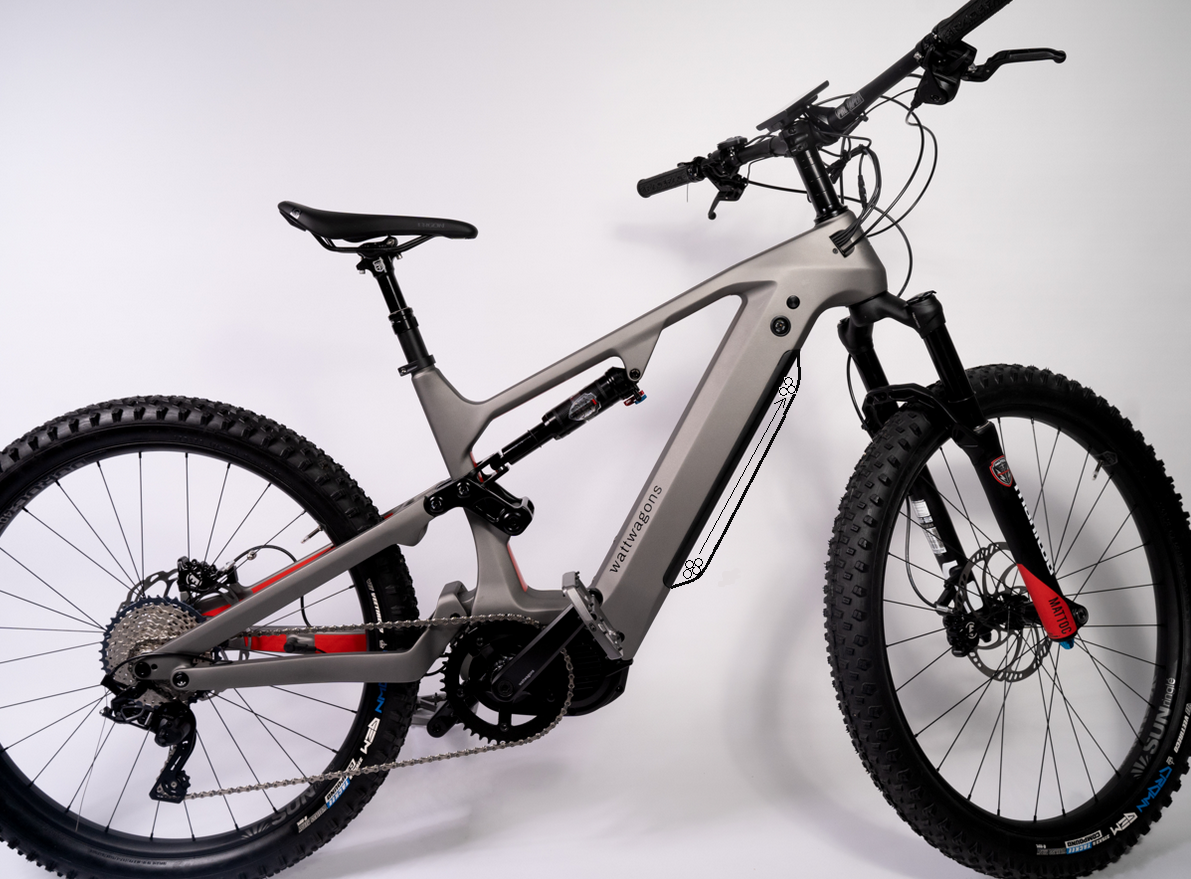

Just looking at your bike. Looks great.
I noticed you don't have any chain protection on the chainstay. You will def need to do something there, otherwise the chain will shred the chainstay.
On my bike, on my first ride I had nothing there, and the chain slap tore up the fresh paint. I then put makeshift protection made of automptive electrical split convoluted tube on as a temp fix.
I have since removed the makeshift protection and wrapped the chain stay with some self amalgamating tape which seams to do a good job, and is much neater.
You need to do pretty much the entire chain stay, especially up near the main pivot where it has that dog-leg bend as that area really cops it. Also won't hurt to do the mid section of the seat stay, as that also cops a small bit of slap when your riding chunky stuff. I didn't worry about the seat stay, as it's on the lower side where you can't really see.
Thanks for the info. I was never offered any of these accessories when ordering the frame, apart from the headset & thruaxle. It's the kinda things you would expect to be supplied or at least offered.
I'll look into what you mean about the bushings & spacer. Someone here talked about the site offsetbushings.com. I'm going to contact them at some point and ask them if they have the right bushings. What do you think of this design:
The square charging port looks alright. I ended up choosing the round one because they have that frame in stock at the time and could ship earlier.

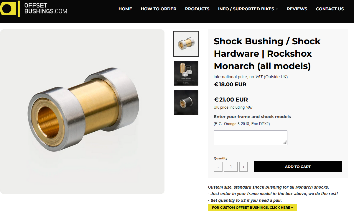

I am using offset bushes from this store in my bike, they works perfectly.
Thats what I ended up going with. Took a little while to arrive in Australia. But they did the job perfect so far.
I actually use an offset bush in the yoke, and a regular bush in the frame side.
The offset bush in the yoke end is oriented so that extends the effective shock eye to eye length by a couple of MM. This allows me to run a 230x65 shock in the frame, which slightly over strokes it.
Because the offset bush is orientated to increase the effective eye to eye distance. I have drilled the yoke and bush, and pinned it so that it cannot rotate and cause frame fouling.
I actually bought both ends of the shock as offset. But you only need to use 1 offset bush in order to run a 230x65 shock.
Thanks for the heads up, I was actually thinking about chain slap that last night looking at the chainline.. from just looking it seems very susceptible at the pivot point as you said. Do you use the christini chainring adapter .. ? And what size chainring do you have. I started with a 32t wich after mounting was ridiculous, so I went with a 40t and also mounted the chainring on the outside of the christini. This improved the clearance and chain line greatly. I was thinking adhesive vinyl for protection..but maybe needs something more substantial

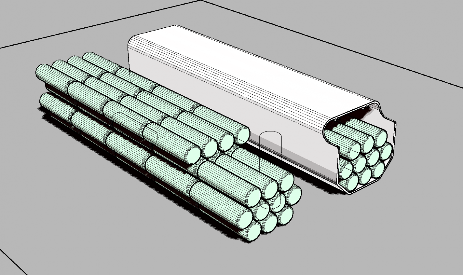

Guys you can’t simply add extra batteries to fill a void. They have to be in multiples of for example for 48 volt systems, 13. So you get 13S3P = 39. 13S5P = 65. Adding 5 extra batteries to make 70 will simply add weight.
That's not the suggestion. I was looking to make a 14S5P battery, that requires 70 cells, 52v.

Why not modify the battery cover in order to make a bigger battery case? It may not need to be as big as I drew here, but just enough to get the right amount of cells.

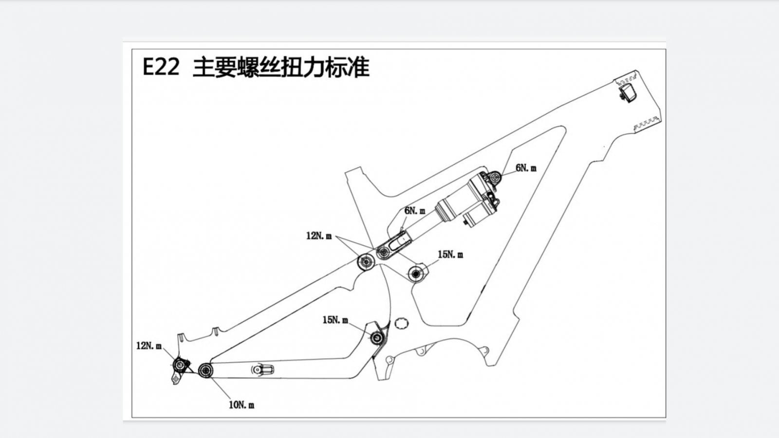

For those interested, Mia from Dengfu shared with me the frame's torque specs.

Neeko DeVinchi
Dec 31, 2020
1,039
1,381
Curious,
My frame came with the torque specs written on the bolts & hardware.
I wonder if they've changed the bolts and hardware?
Back aways in this thread I posted about the same possibility as it makes the most sense. However I couldn't get DengFu to recognize a need for it. If someone had a 3d printer I would imagine it to be totally possible but seems like it would be alot easier for others if they just made one?
