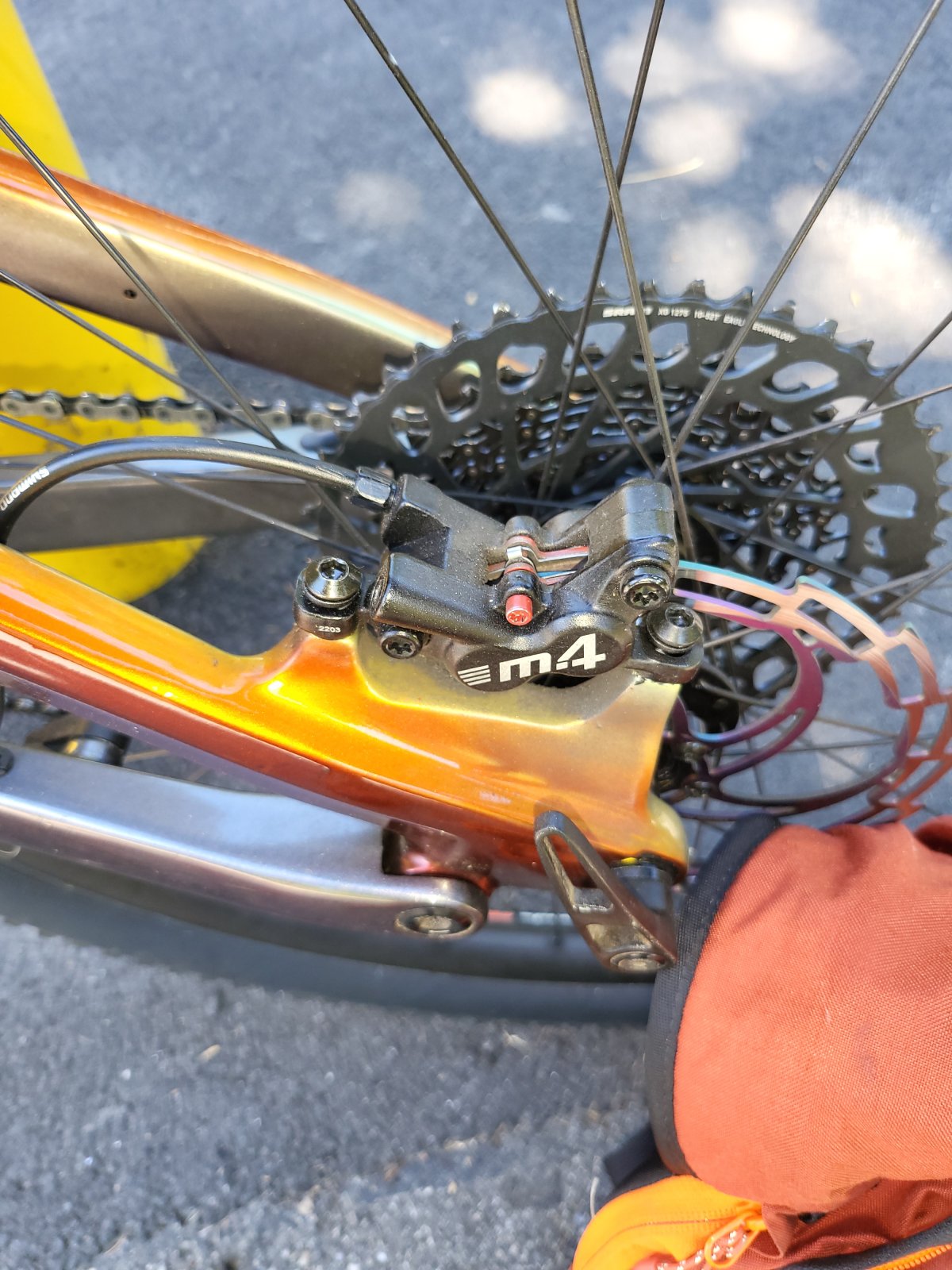

They are the Meroco 4pot brakes (mineral oil). The calipers are similar to the Tektro Orions or Clark M4s.
The levers are similar to Shimano Deore (so they can use I-spec).
I did have to buy a longer brake hose for my Large frame and re-bleed the brakes. But I swapped out the stock resin pads and went with sintered for consistency.
The rotors are Shimano 205mm. With the Shimano 205mm brake adapter.
Overall, they're not bad for the price.

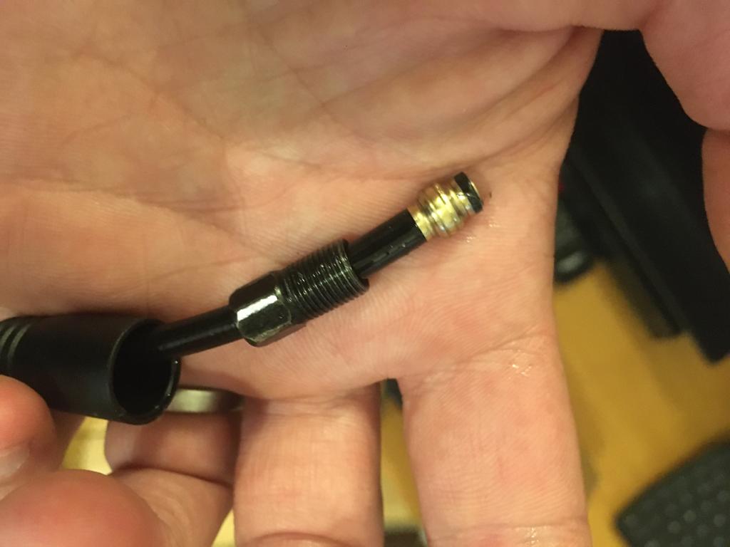

Hey @Neeko DeVinchi I got these brakes in the end, bargain. I just went to fit them and the hoses are waaaaaaaay to short for my medium frame.
I started by looking at chain reactions brake hose kits, but not sure which standard I need. Do you recall which it was, or can anybody else point me in the right direction?
CaptainBobt
Jun 23, 2022
87
45
Usa
I have these brakes and use standard shimano barbs and olives work fine..

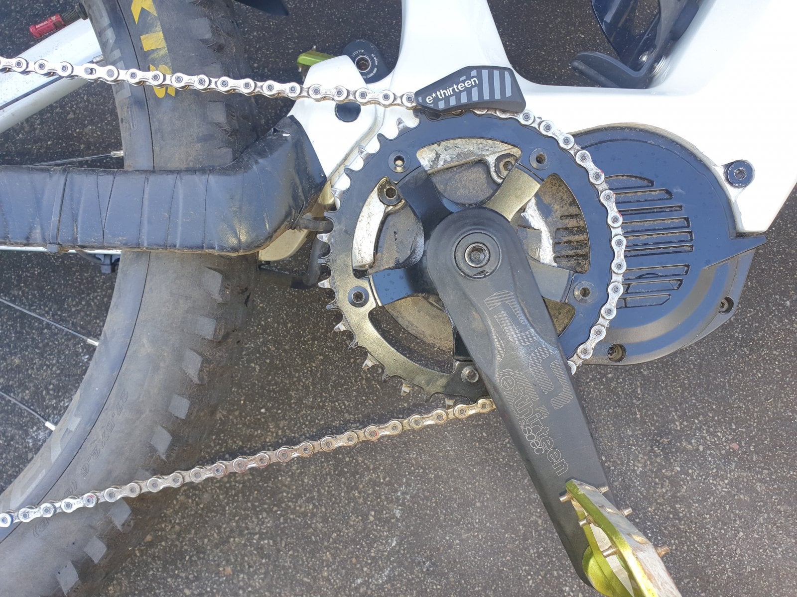

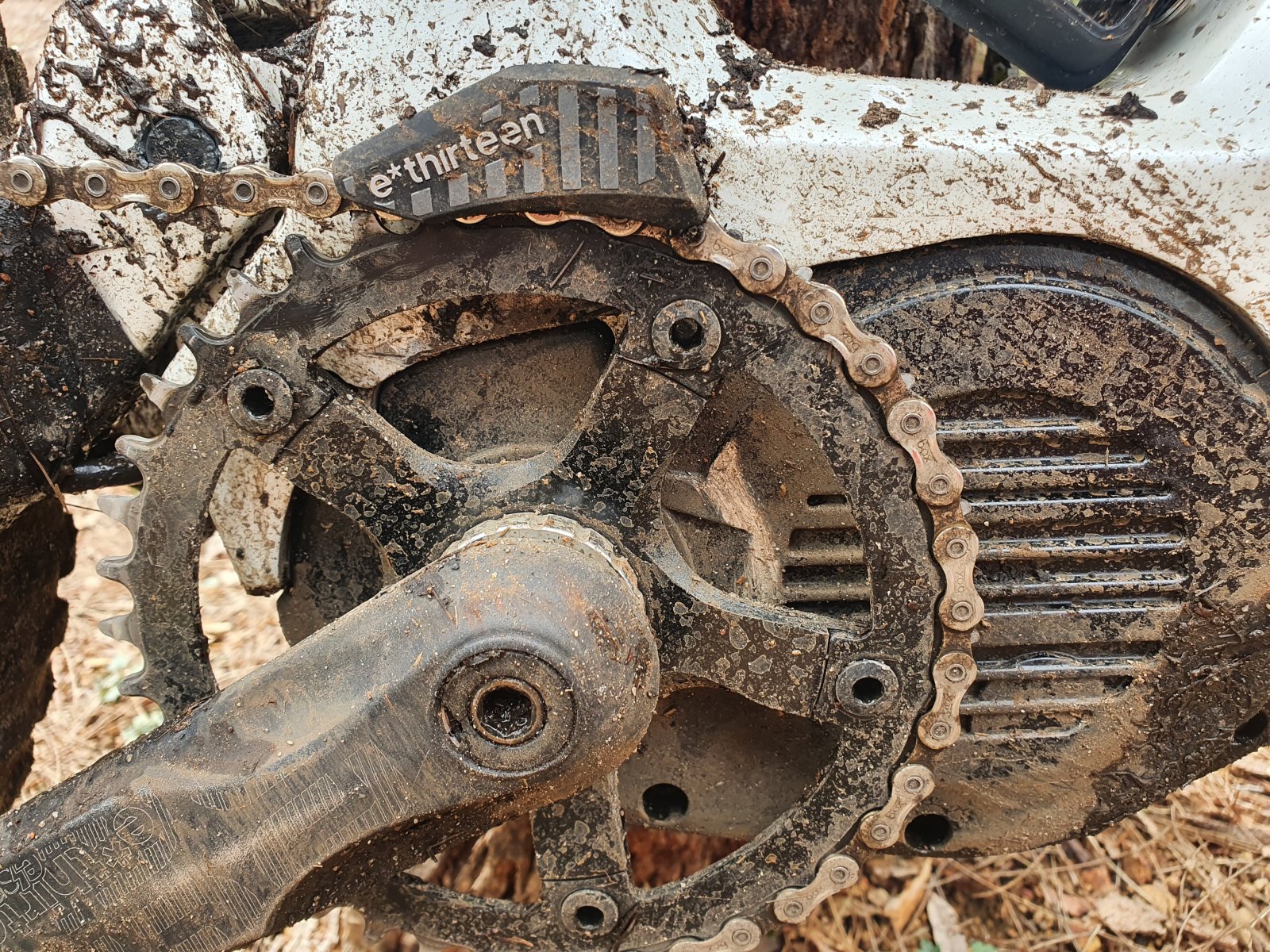

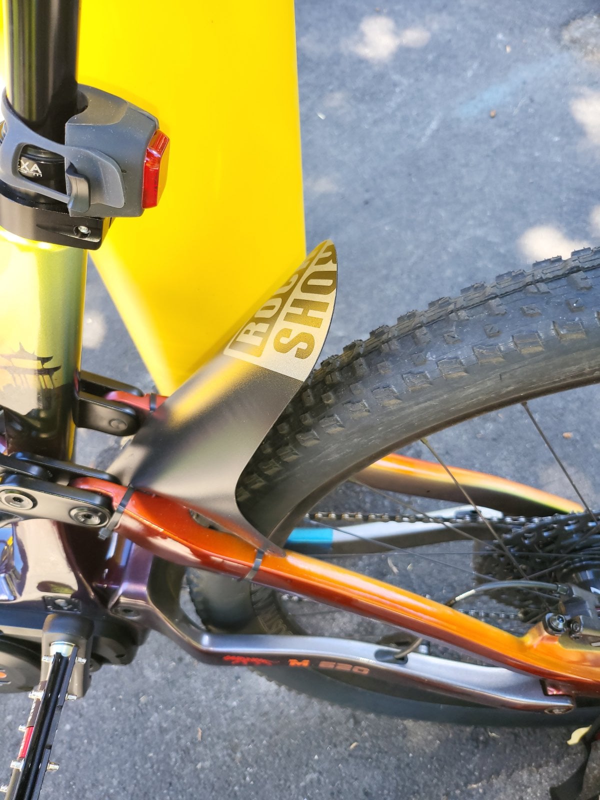

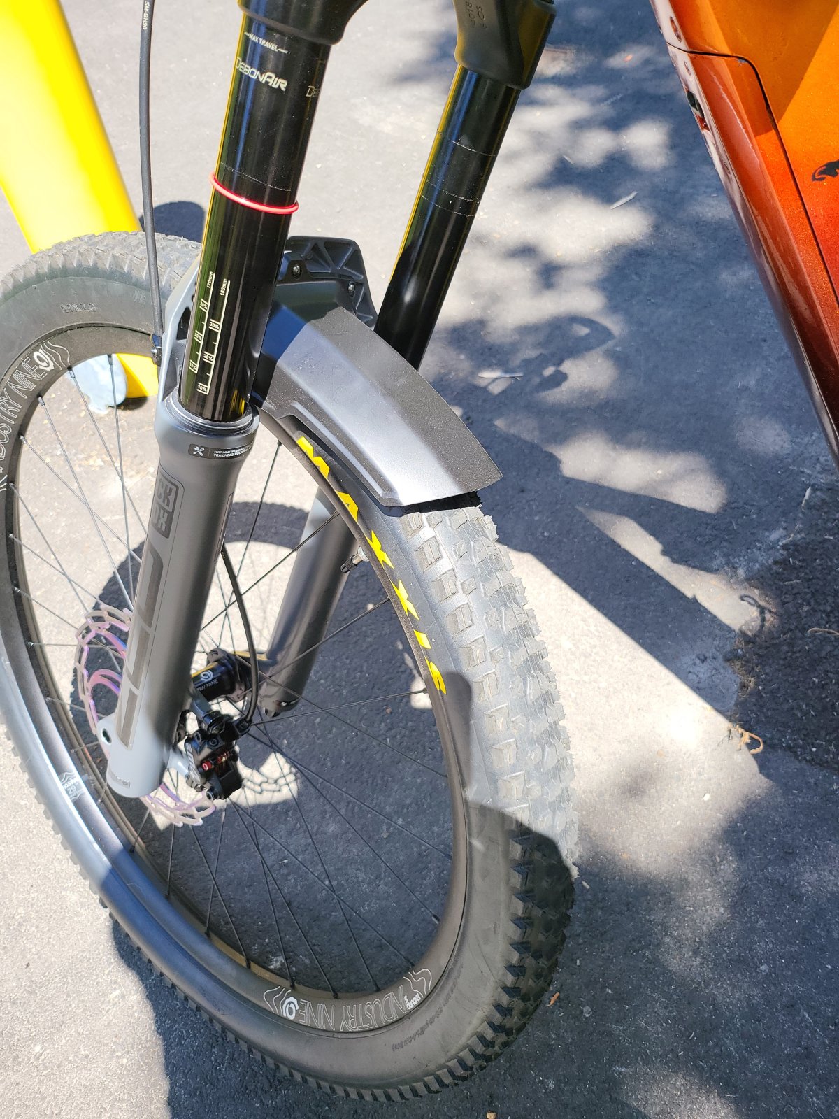

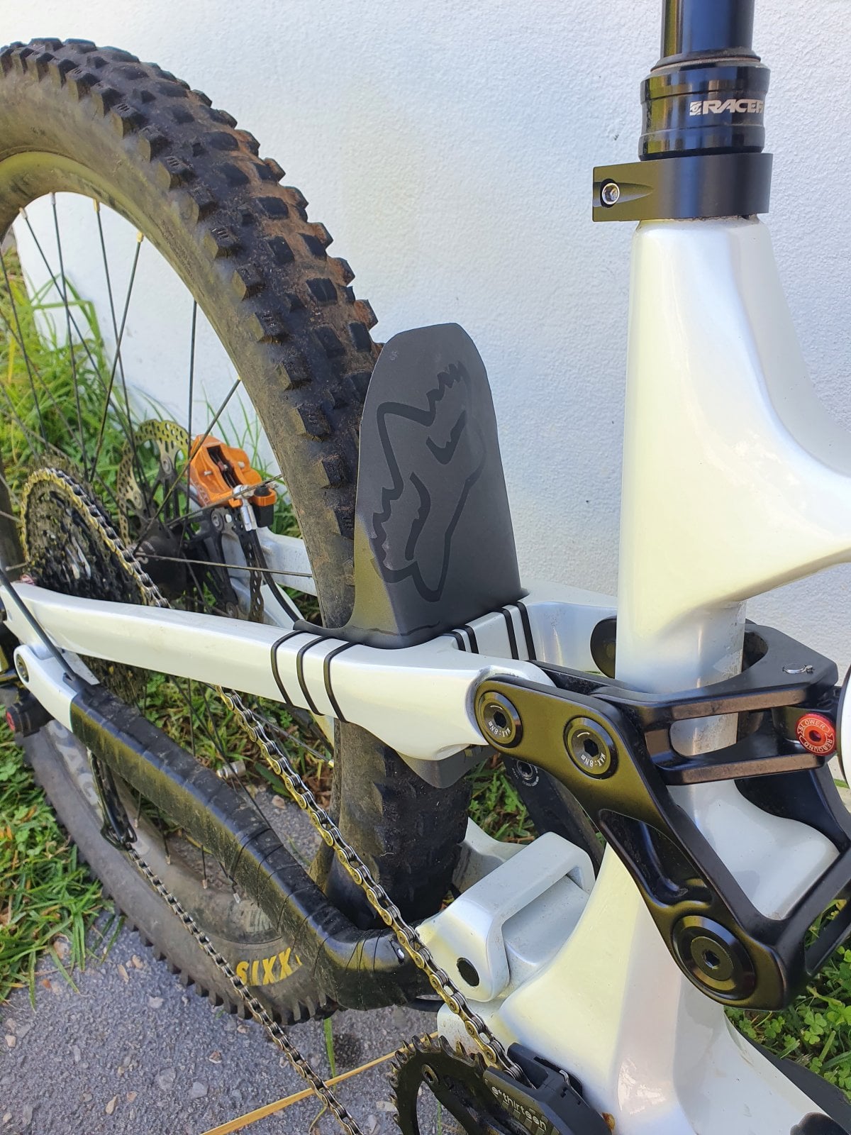

A few little mods.
E13 chain guide and some old mudguards. The chainguide works brilliantly. Haven't dropped a chain since I fitted it. The mudguards not so such. I'm sure they do something, but you still end up coated it mud.
If you look closely through the chainring, you can see some damage caused by dropped chains.
Mabman
Feb 28, 2018
1,138
1,865
Oregon USA

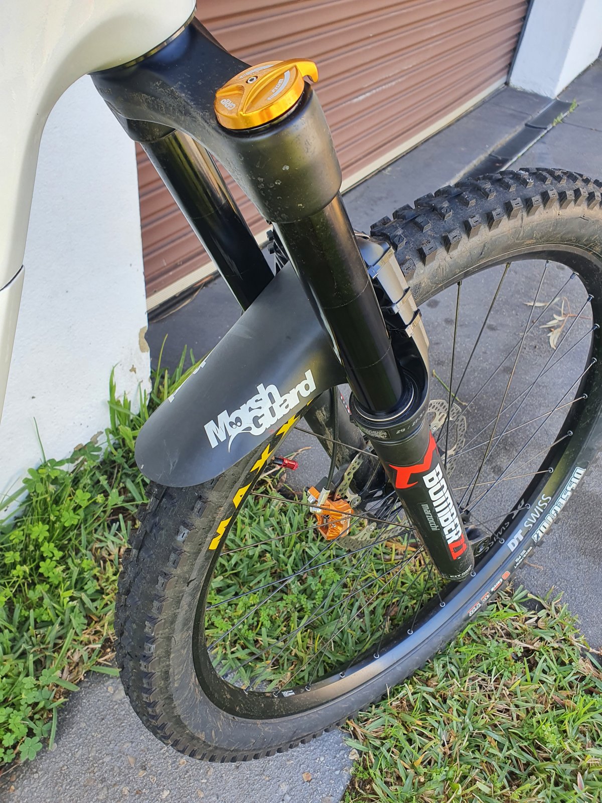

Never understood the postage stamp fender craze. Where I live you either have fenders on in the wetter months, and the fuller the better, or take them off when the weather is nice. Just the way it goes.
Apologies for the delay @BonBond.
It looks like @CaptainBobt answered the question.
Shimano olives, work fine with the Meroco 4pot brakes.
Quite recently, I swapped the levers on my E22 with Shimano levers and noticed that the power had tremendously increased.
So I am a fan of the calipers, as the running cost to keep them going isn't expensive 👍🏿

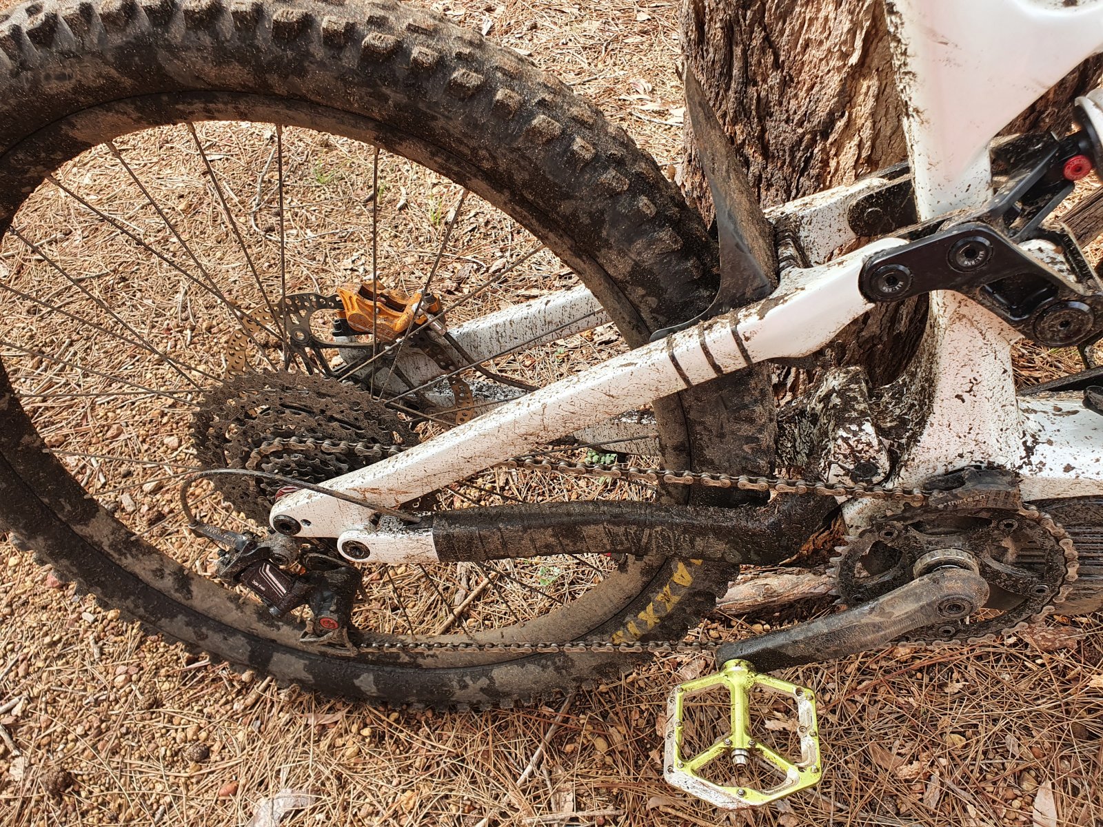

A few little mods.
Nice👍🏿
Keep us posted on your chain guide solution @bram.biesiekierski.
If you're satisfied that it performs without issue, spread the word on how others can make their own. Or, start mass production and make a little bit of money on the side (I'd buy one off you👍🏿).

A few little mods.
I'm assuming you drilled and tapped to mount the chain guard what size..?

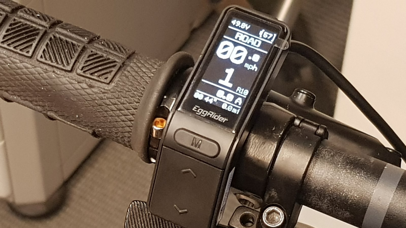

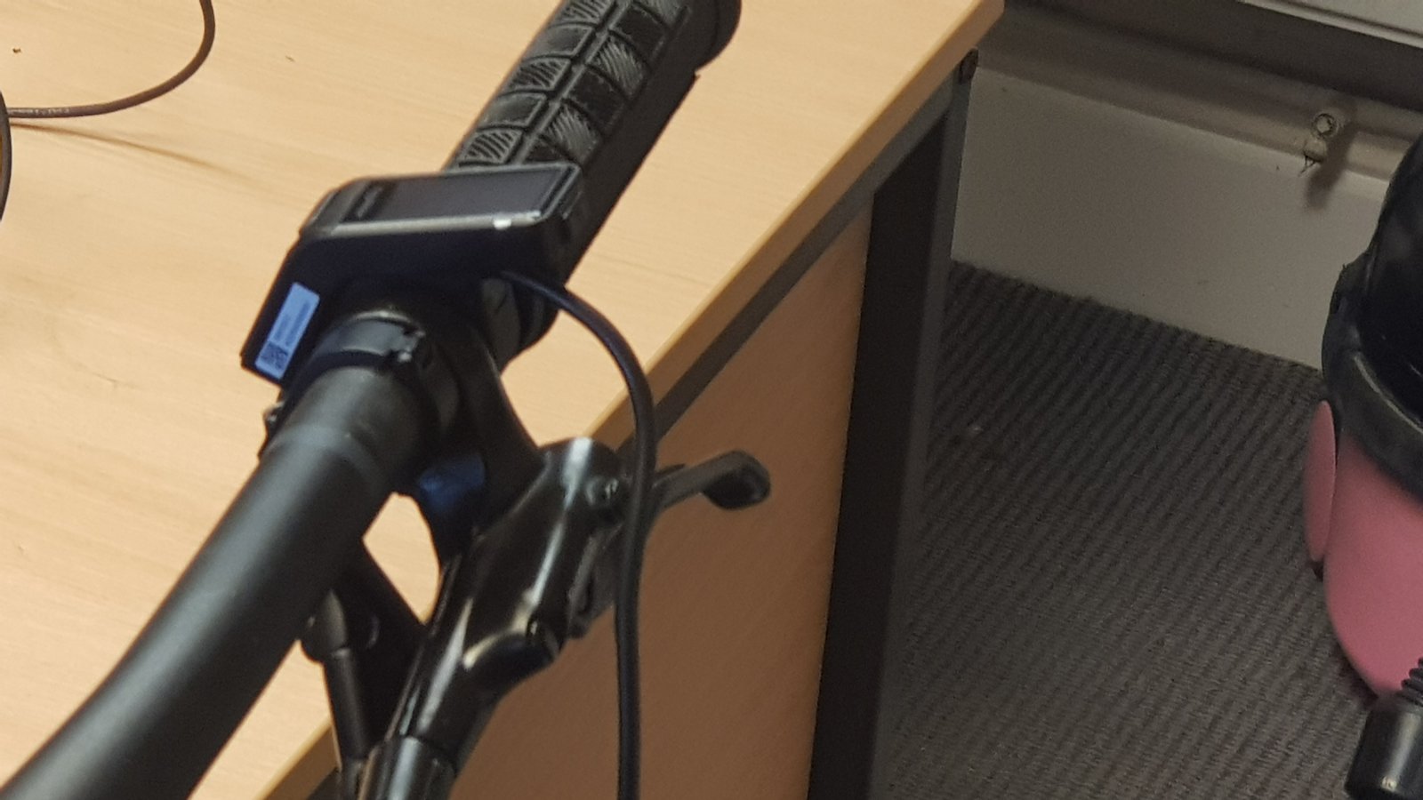

So, I've been messing around with the Eggrider v2 display on my E22
At first, I thought some of the functions the display/app offered, would be overkill for EMTB. But I am truly impressed with the ability to examine rider data after each ride. Not to mention, it is the smallest display for Bafang ebikes. And the ability to export this data and upload it to third party services like Strava, is not lost on me 😄.
Huge shout out to Eggrider for the hook up. At present, they are out of stock but I'll do my utmost to keep you all posted on stock availability.
A full video and written review coming soon 👍🏿
Yeah, glued and screwed. I just used a single m4 screw. I figured the smaller the hole the better. I used a countersunk head screw as it can sit flush and not foul the chain. And I put it right through the middle of the e13 adjuster screw hole. I crudely drilled the adjuster to give it the countersunk recess. And put the 2 or 3 washers behind to give the correct chainline. The glue I used was a very tacky sealant adhesive I had laying around. It sets to a very rubbery finish. It's very strong. But not so strong that it can't be removed.
Only 1 ride in, but so far so good.

Nice👍🏿
There would be no money in it for me. All I did was take an existing product, and attach it to my bike haha. But yeah I'll keep everyone up to date with how it works out.
