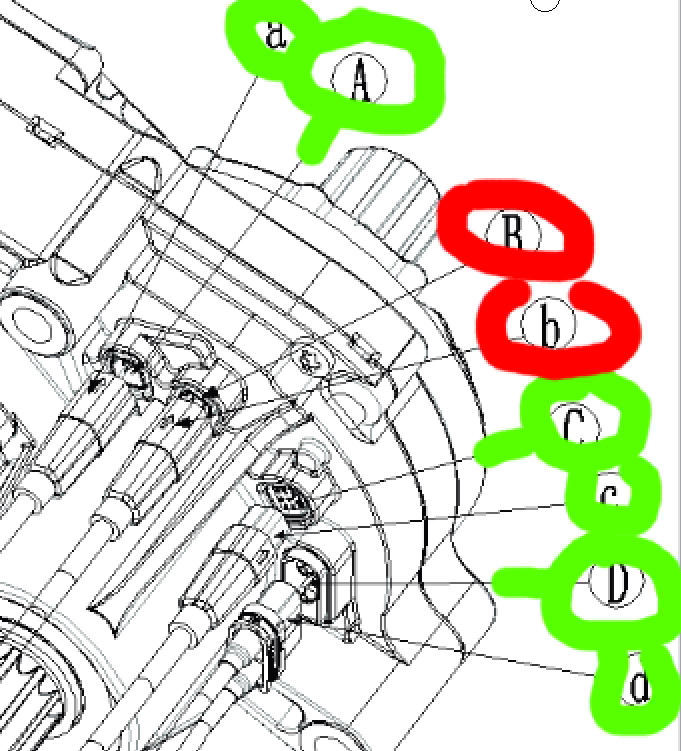

Guys can u pls help me! i cannot get my bike running. I plugged and unplugged all cables (not the red)
the "B" is empty right? The button on the Frame is pushed inside, but when i click on the "on" Button nothing happens... what can i do??
THANK you
THANK you
You need to push the connectors REALLY HARD into the engine and the display connections. Use some silicone grease and ensure that they are really properly installed. I had the same issue, could not believe that there is another 2-3 millimeters until fully inserted!

seen multiple half inserted bafang connectors,therefore its better to use pliers to insert really hard. check correct orientation before applying pressure.
battery comes with 50-60% of charge (usually), so first charge is max 2-3hours. non-working mean wrongly inserted connector usually.

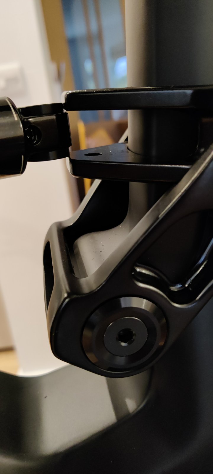

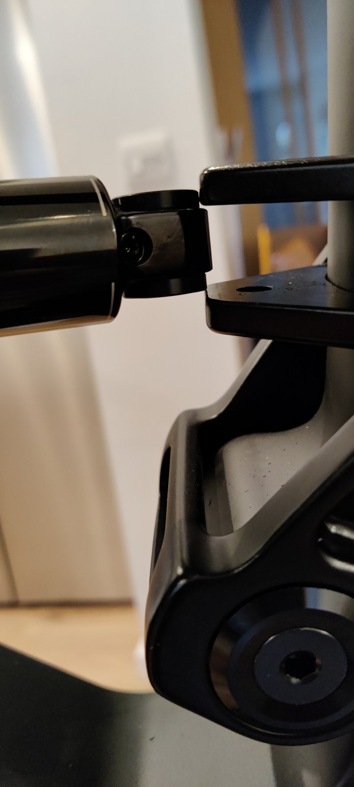

Hi guys, I have my bike built and the old part I can't fir is the suspension - the rear bushing where it *should* fit onto the downtube the space is too narrow by about 3mm, I have 2 sets of Rockshox 210*55 super deluxe ultimate and both are the same.
Is this where I need offset bushings - I was under the impression that was only for geo correction
Thanks for your help

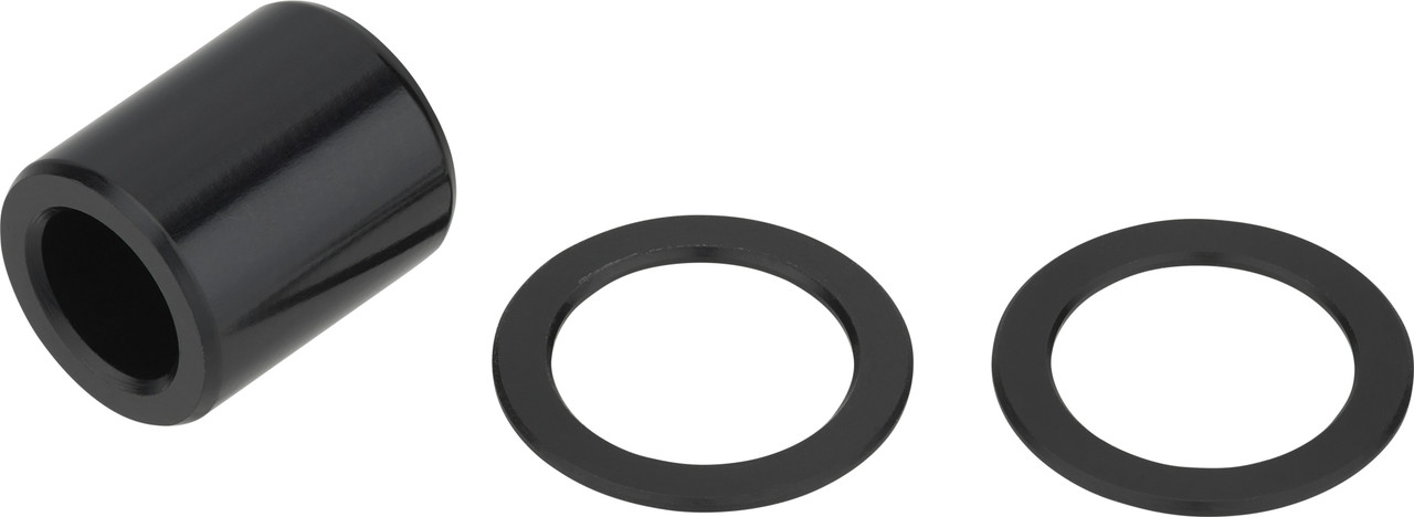

yes
i have the turn, but you can find dedicated bushing (without off set) from UK supplier

Thanks, I'll go that route

looks like the dimensions of the collar changed ...or you got the wrong bushings delivered ....
Best is to measure the inside diameter and order a new bushing with the right size ...
Do you have a calliper you can use to measure ?
Mine was 16 mm only ...

then those are the wrong ones .... you need to remove them and replace by 16mm bushings ...
You can use a special tool RockShox Rear Shock Bushing Tool For Slide Bushings
or a hammer and the right inserts or sockets from a socket wrench to hammer them out ;)
