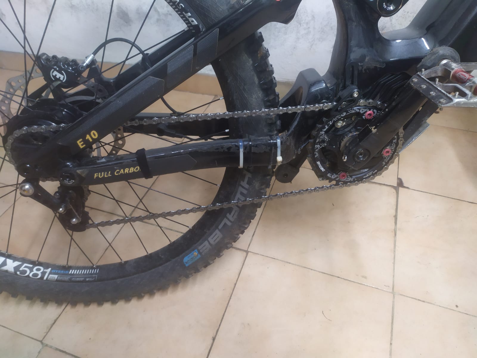

The UK is in real mudsville terrain at the moment and I've been having some trouble with the standard Bafang front crank ring catching the chain when full of mud and wrapping itself fully around the ring ( chain suck ). The chainguide has consequently taken a beating and finally after tightening it again for the umpteenth time, I fully removed it and fitted a standard 104bcd 36T narrow wide front crank ring.
Been good so far and not had any problems with derailing nor chain suck. Do we need the chain guide, possibly not.

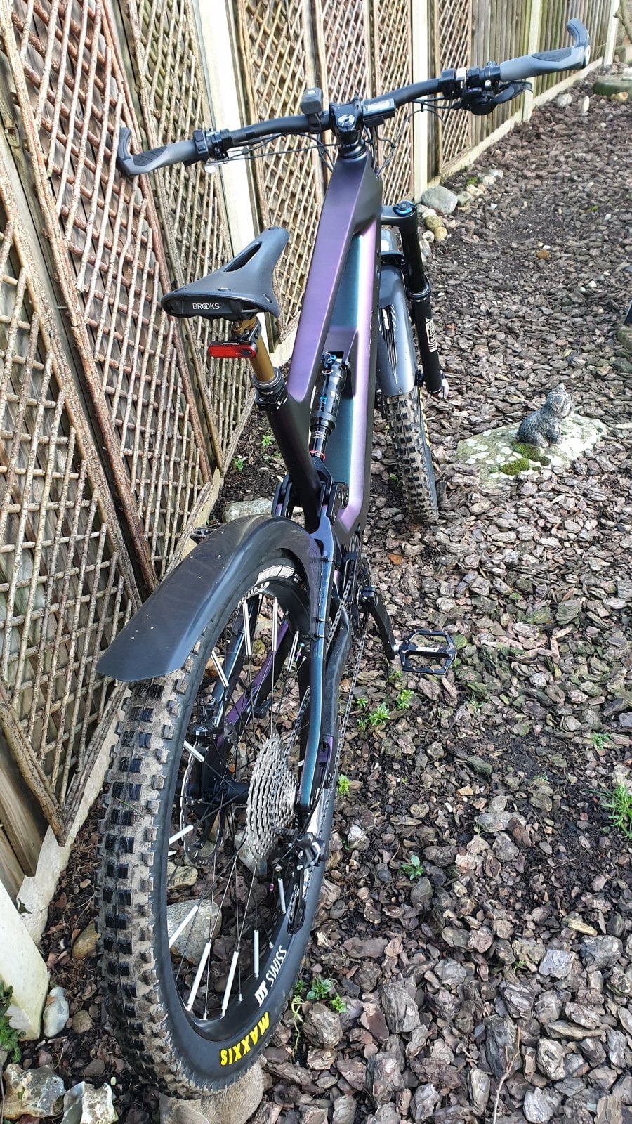

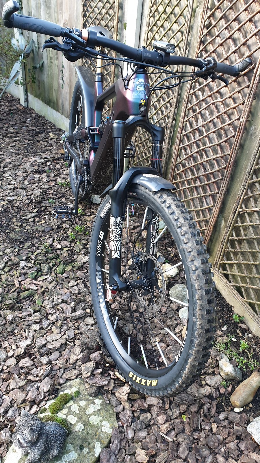

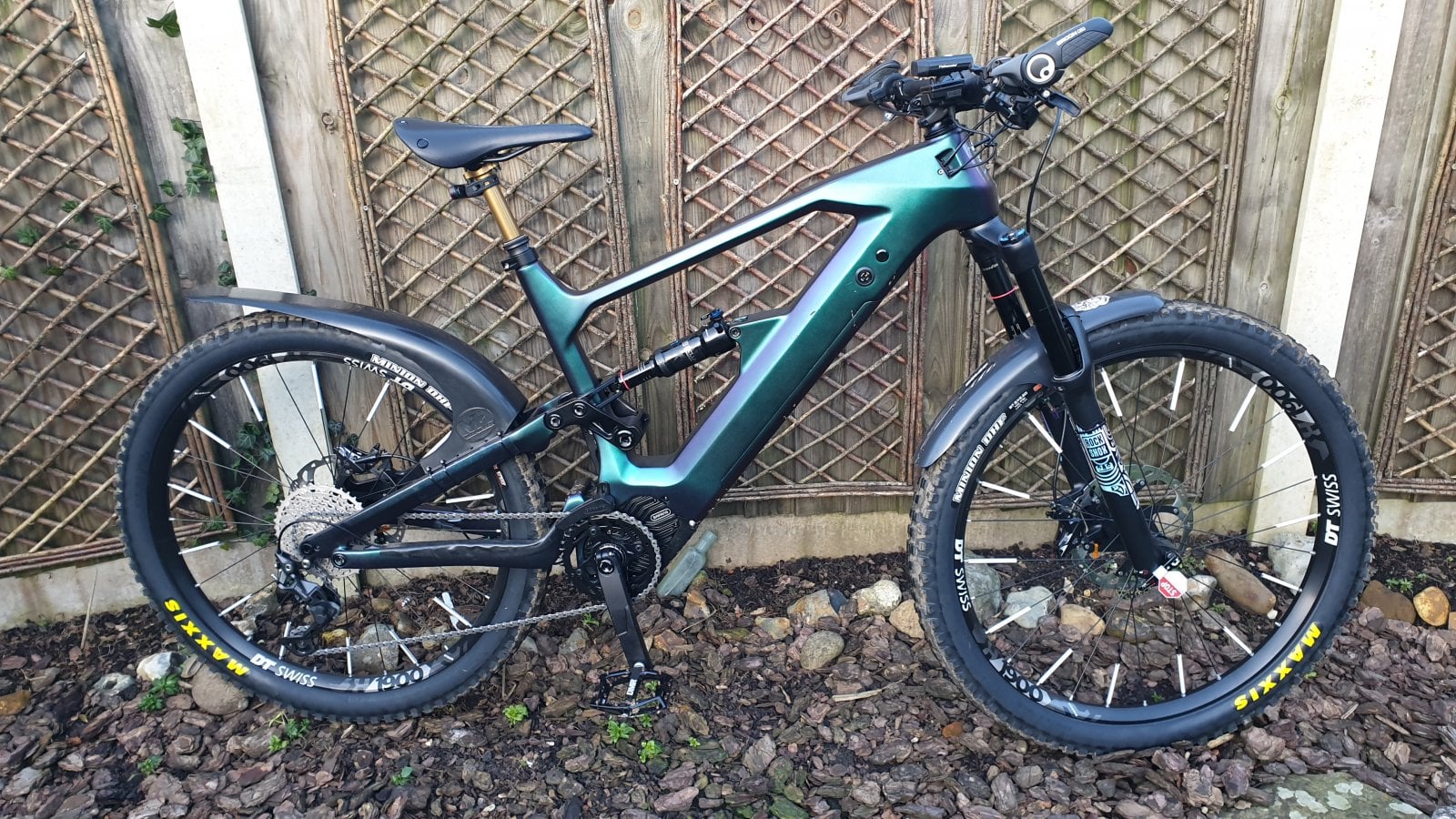

I did it. Took her out for her first run. Been doing the final touches over the last week like mudguards and chain guide. I will post all the specs later but its the Bafang M600 on the E10 frame with 27.5 wheels front and back, Rockshox Yari fork, Fox seat dropper, 11 speed cassette, Brooks Cambium C15 seat. Very comfortable ride, a few pedal strikes. Rear shock needs stiffened up a bit. Motor very responsive and quiet. Got to 34 kph on flat with throttle. Motor made some noise at top speed. Cant wait to try in on some trails, though these country roads are almost trails, potholes, mud, field muck, etc. Really enjoyed building the bike. Thinks that need tweaked are the rear shock and spongy rear brake.
jtran69
Jan 9, 2021
73
19
CA
Nice chameleon!

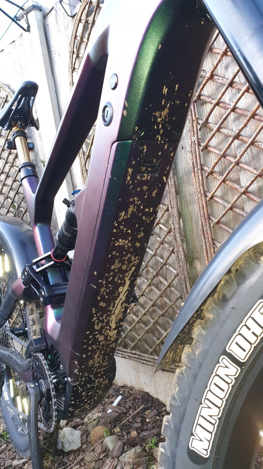

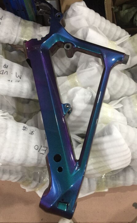

does somebody know the pantone code of this color ? does it existing pantone code of this kind of paint (chameleon) in color more clear ?
jtran69
Jan 9, 2021
73
19
CA
It's not listed on the pantone code. Sale rep can show you a few changing paints option and mine is also chameleon :)
