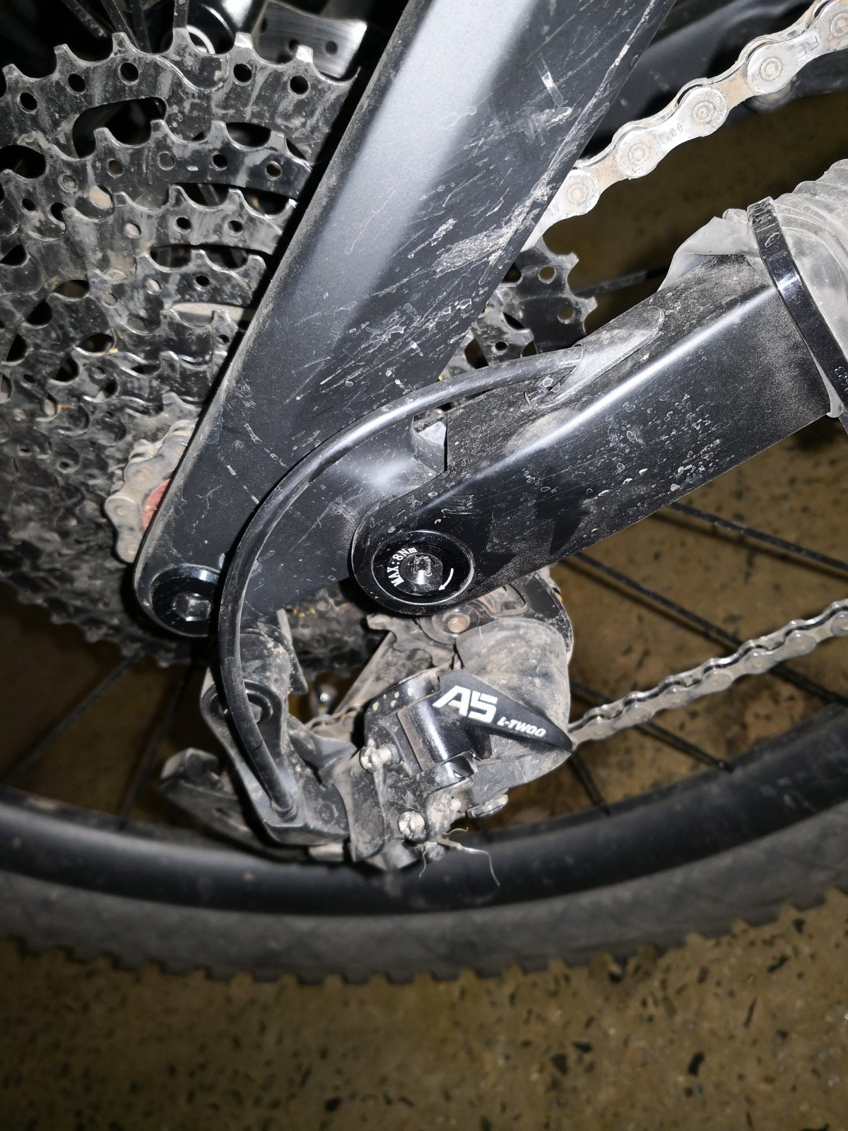

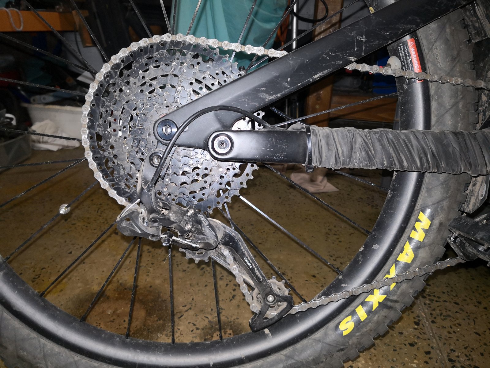

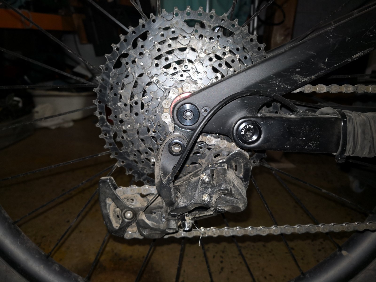

Please can you detail with which items ? pics of your derailleur position ? necessary to use 12V derailleur ? i have tried with several ZTTO cassette (not find other in 11/50 9V), sram EX1 derailleur, sram X0 9V shift lever. It work corectly at workshop but the 2 taller pignos jump 1 teeth ofen when i apply strong torque to climb, alike if casette is worn out. i haven't find why ? in add i have broken several KMC 9 speed chains (bad quality, badly crimped). I ended by reinstall the 11 speed. But i will apreciate tio use 9 speed, it is enough for M600
I have lengthened the 9 speed chain to I think 20 links. It's a Shimano chain. The derailleur is a long leg unit from alliexpress. It does sit low and picks up twigs a lot. Also it skips 4th but that is the cable stretching.

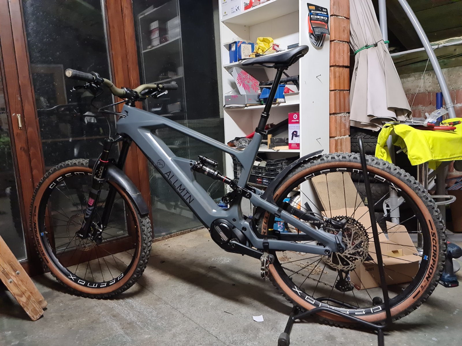

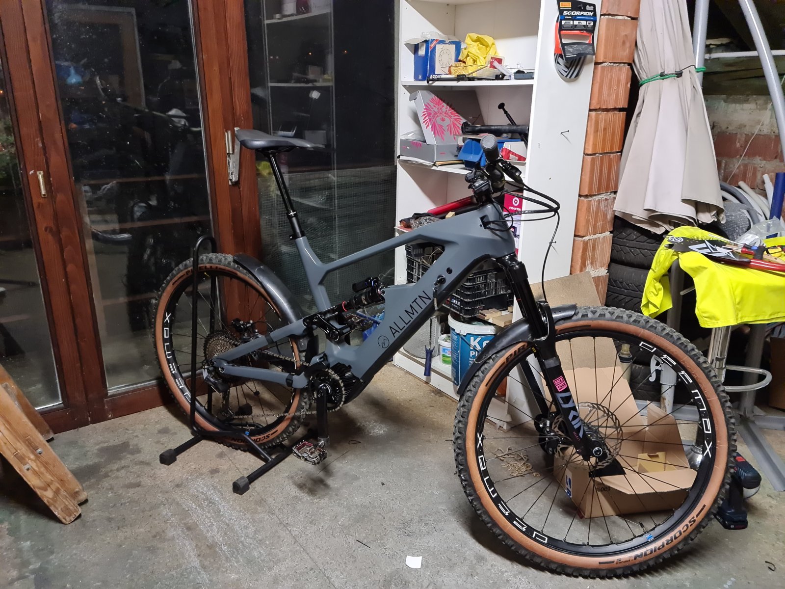

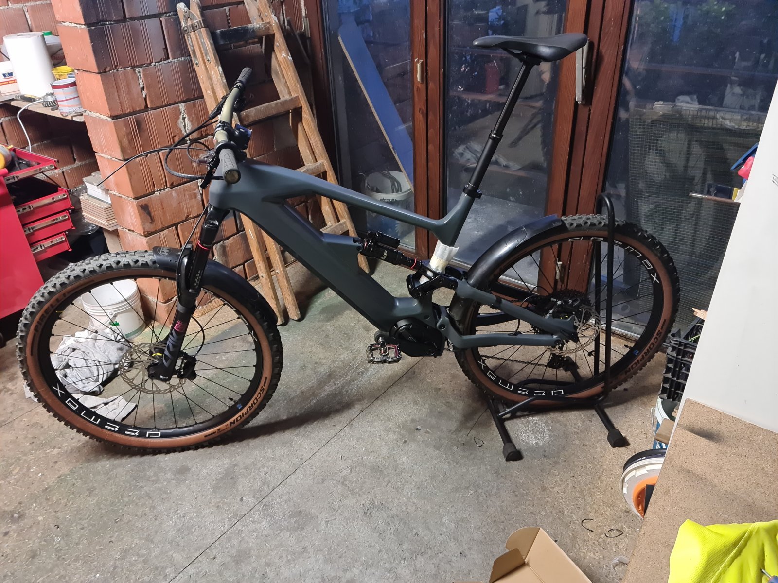

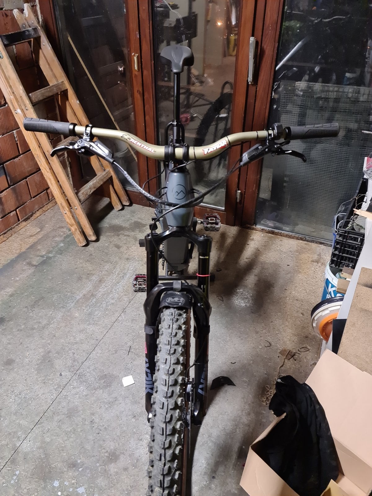

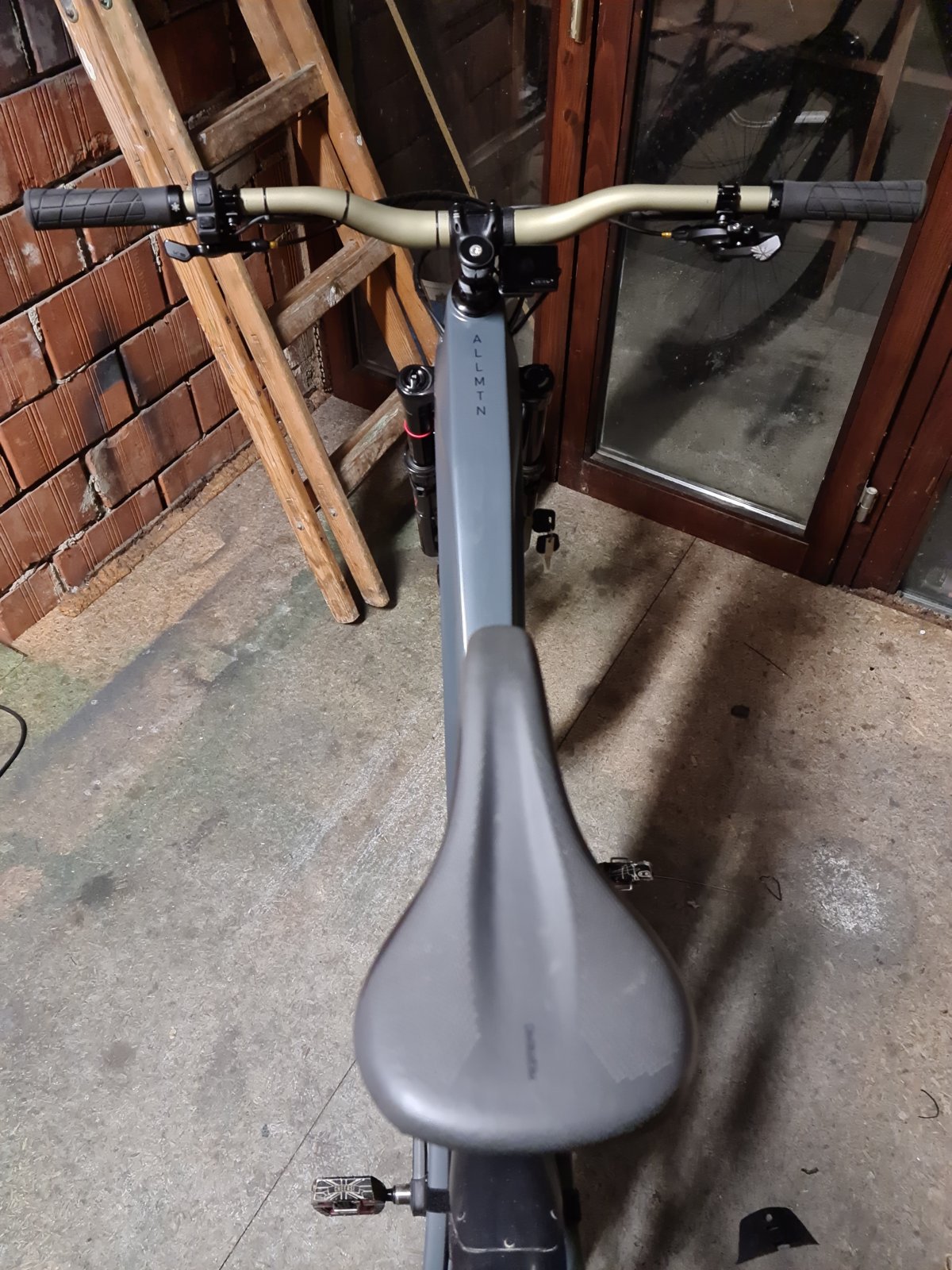

greeting. here is the first picture. I'm just missing the dropper handle, I hope it arrives tomorrow, so I can install the seatpost. short description: frame e10 xl, m500 engine. lyrik fork 160mm (ready rc 2.1 charger damper) ultimate, super deluxe ultimate rct shock 210x55, sram code r brakes, rotors ztto 203mm, sram gx group, cassette vg sports 12 spd 11-52, mavic e-deemax 29 "wheelset, pirelli scorpion 29x2.6 front 29x2.4 behind, ks lev is 175mm dropper, front sprocket praxis 36t,
I know they were already a question. how do i change the wheel size settings to 29? thank you
What mudguard is that on the back?

From experience the front mudhuggers only work sort of on the rear, best to go full monty.
Now these do work well.

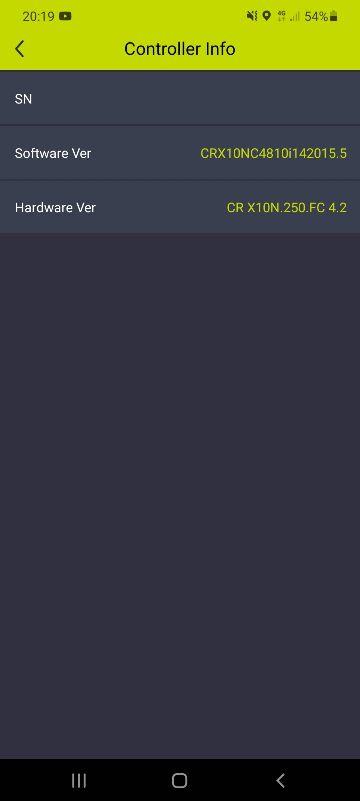

I was on a test drive today. forest trails uphill. the engine is weak for such rides. I was expecting more than 95nm! should i upgrade the firmware, maybe it will help?

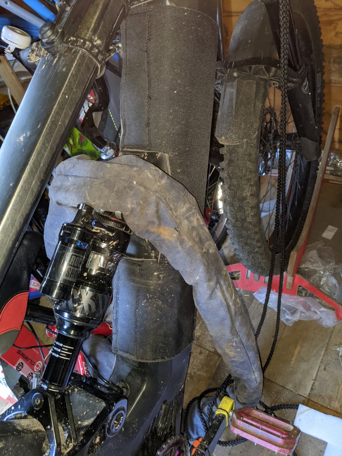

I too have made a fabric cover for the battery compartment area (although your's looks significantly neater than mine).
I had some proper trouble with the needle getting gummed up by the adhesive on the closed cell foam that I put on the back of the cordura though.
It also billows out a bit where the shock mount bit is, I can't work out how to stop that short of sticking velcro to the frame too (which seems a bit of a dumb idea). It has definitely kept out most of the muck and the catch doesn't get stuck anymore. Plus it's easy to take off and clean.
Just came back from a quick 40 minute blast in the local woods during an unseasonably dry UK Sunday.
