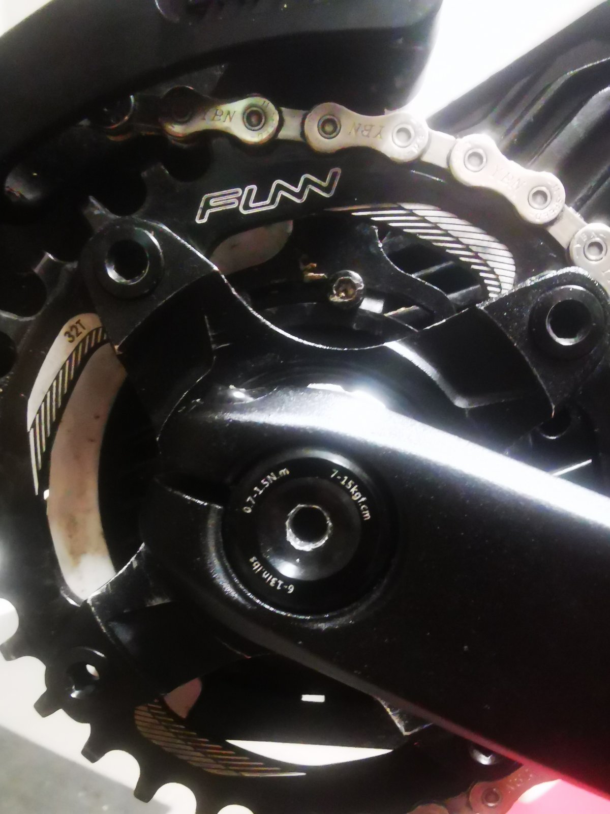

Ok I take all that I said back. Took the bike out today. Good hill climb, tech trails, down hill trail. Loved it. Some bedding in needed so tightened up the head set. The derailleur cable. Only problem is one very irritating issue that I am sure is not unique to me. The speedo jumps to 50 or 60 kph. So the motor cuts out. I am only doing 5 or 6kph when this happens and it was happening a lot. Anyone else have this issue? There is no error code so can only think it is either the magnet not close enough or perhaps a connection issue. Any ideas please. Other then that it is an awsome bike. I do have to say had a lot of peddle strikes. Need a shorter peddle arm maybe 170mm.

It is occured on mine after 3 exit. bafang and other guy on endlessphere saied me that it is necessary that the magnet of speed sensor need to be at 1cm at less of the sensor (8mm on mine). I have checked my sensor and the wiring (it have working 3 time without problem). I have constated that i have losen the rubber cover of the fixation screw of the sensor.
As the screw is in steel, i have replaced it by one in alluminium (not magnetic). problem do not occur more. I can't explain but it is my experiency.
Why you need shortened crank arms ? you are in 150 travel and 27.5 freont rear ? no problem with mine in 160 and 27.5/29

I'm currently riding a bike from a local store with this frame. They've participated in designing the E10. Sudden jumps in speed reading is very likely due to wheel magnet. Seems it needs to be carefully placed, doesn't take much before it's out of position.

Thank you all. I put my bike up on the stand and turned the cranks, then the Speedo jumped to62kph. So I moved the magnet the wrong way then back again. I can't see any different in the placement but looks to ok now. Cheers
I run 29/27.5 160mm front fork and 210×55 rear shock. So not sure if that is 150 rear travel or not. Anyway lots of peddle strikes. Thanks for the info on the magnet will be playing with that next. Cheers

Ok with 210x55 you have +- 350mm of BB height no ? normally enougth, may be you have too many sag ?
I have 216x63, +- 360 of BB height and no problem with crank arms. The only way to reduce cranck arms length is to drill another hole on OEM arms (or purchase those done by LUNA), that give crank arms +- 155 mm. Too short for my point of vue.
Thanks mate, I agree 155mm is to short. Sag is 30% but I only have rockshock rl deluxe so not exactly a great rear shock. Front is a yari so not so good either. Anyway can upgrade these later.

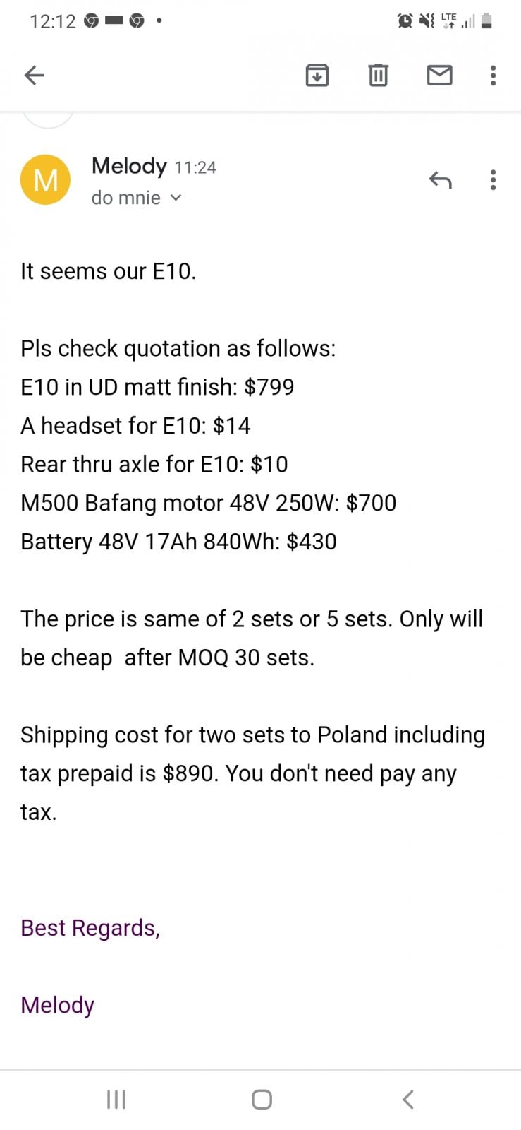

How much you pay now? I have a answer from last week 3000 $ with shiping to Poland.
The price has not moved much. It really comes down to the exchange rates. Anyway not sure what the prices are in Poland but here in Australia it is only cheaper if you already have a bike you use parts from. My E10 cost $3334.84 Australian as per your quote. And total build $6118.53 as I didn't have a doner bike. A mate just bought a KTM 2972 for $7000 Australian new from the shop with warranty and arguably better components.
I am very very happy with my bike and love that I can service it myself but in reality the savings are not that great.
In Poland I can buy completly bike exactly the same as here one for about 4200-5000 $
So the savings are not there for you my friend. I would not do it again as I said the bike is great the frame as far as I am concerned is very very good but I would buy from a shop next time so I have a warranty etc. I must say though the befang motors are proving themselves to be pretty good and if you do burn it out because you are climbing in too higher gear it's a cheaper motor to replace then the mainstream motors. An fellow rider burnt out his Yamaha motor and cost him $2000 to replace. Anyway good luck with which ever way you go.
