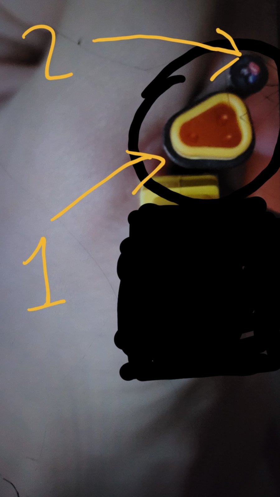

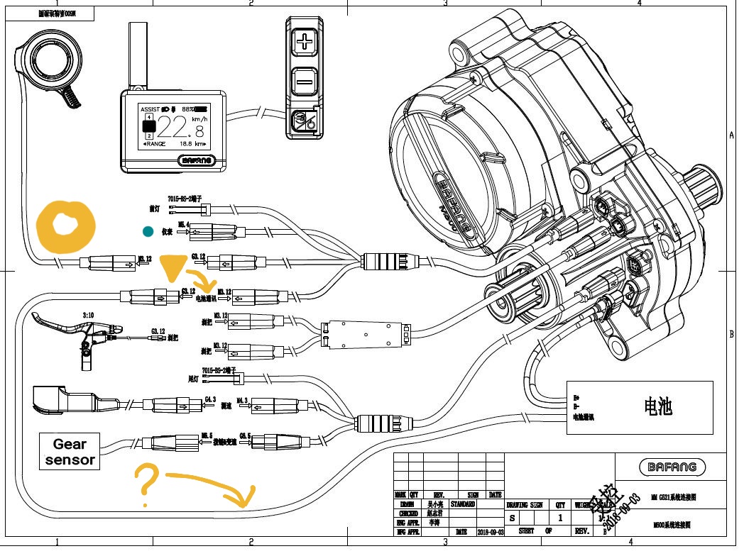

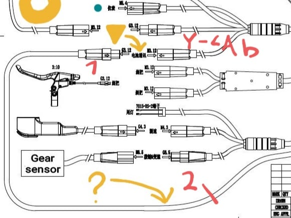

Hi guys, could U pls help me to understand what is wrong with the connection? I wanted to test battery/ motor but a display is not working and a throttle does nothing... The power button on the frame is enabled. The battery is charged. Thanks for any advice.
Hi guys, I need your help, seems I have found a root cause. Due to I have bought a frame and a motor from different sellers I have stock wires for the motor. I need to connect Y-wire higo 3pin orange male to female. But the question is where should I connect the other cutted side with num 2 on the picture below to? Thanks in advance. 20210611_091411.jpg IMG_20210611_131936_474.jpg

can you cut this cable "marked as 1" and indicate what color of wires are there? This cable goes to to the bus, or to the display?

My assumption that the side marked as 2 should go to on/off button. Because when the button "off" it shows 47v, when "on" 52v. Maybe the button only stops supplying the display with 5v in "off" mode?
