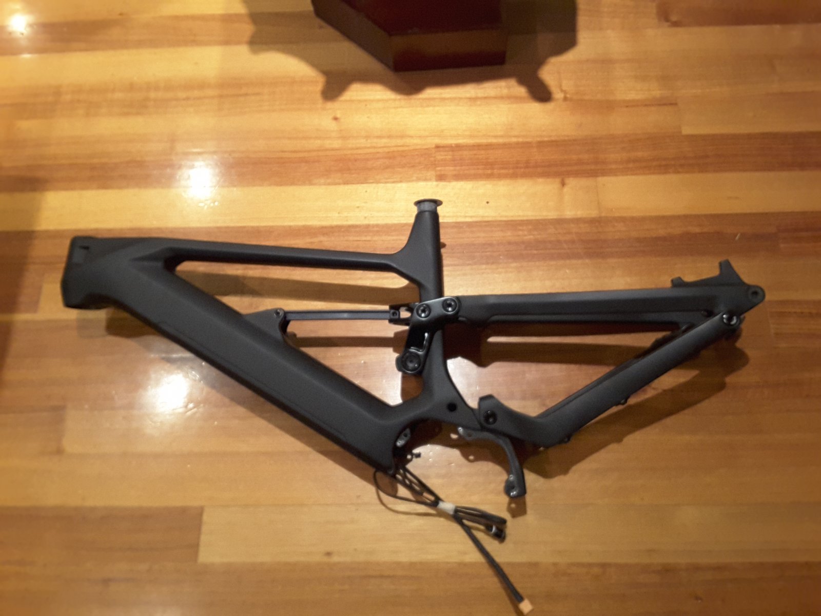

Well frame turned up today. Didn't expect it to look so big. It is a medium (17") looks ok though. 120mm HT.
That's everything I ordered from China. Now just need to build it up. You can see the charger hole is on the left side now. There is a key to unlock the battery aswell which I like. Anyway hopefully my healing from the fall and the build will coincide. I like how thick the frame wall's are too.

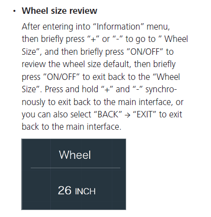

Yes, you can change the amount of level assists from 0-5 to 0-9 [and 0-3 for those that live on Mt. Everest].
On the display, go to Settings [press + and - at the same time] and scroll to Settings, then scroll down to the last option, Assist Mode and select 0-9.
Wheel size change would be through the besst toolkit, unless you pre-order that config through your dealer. A search on besst reveals a few topics on this forum, most say you need to order through a dealer. Same for the wheel size.

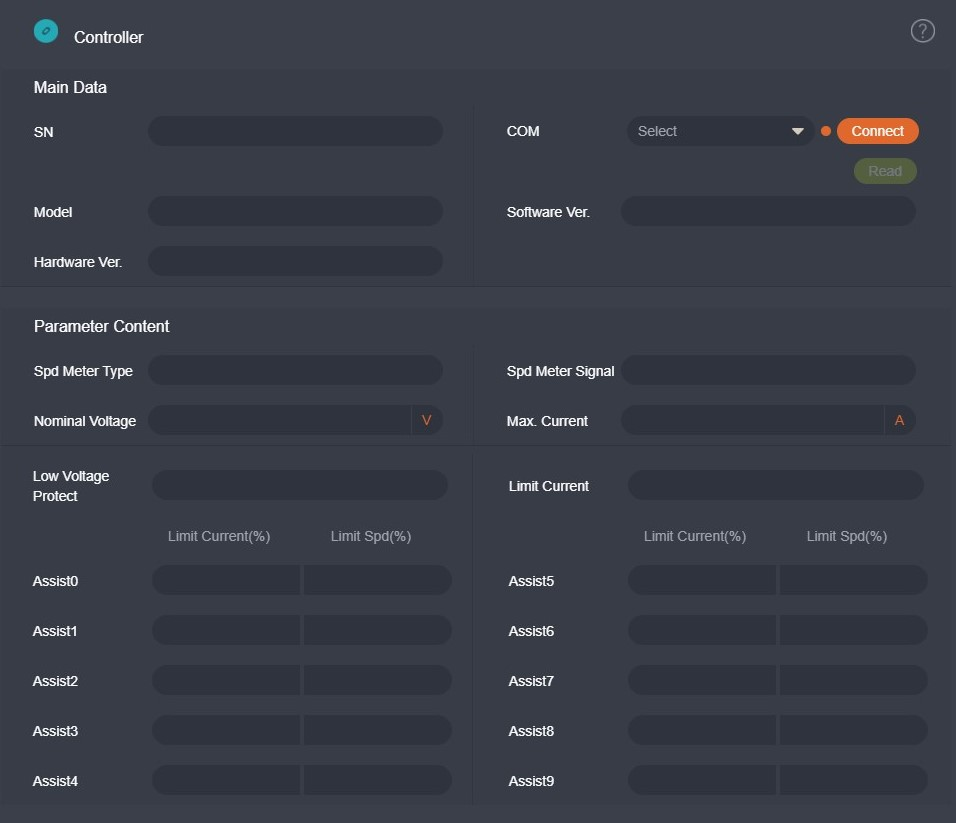

I just made the spreadsheet to illustrate a point. The BBS motors have completely user programmable levels and the array of settings that the selected level points is for 9 levels. This saves space on the controller and makes the logic easier. It's a pity that the M series don't or maybe the way the level is mapped means that the 1st level always points to the higher power setting. I've not tried mine yet as I'm still waiting for the frame, but if it is problematic the only real solutions would be an alternative controller (messy) or accessing hidden settings using the documentation on endless-sphere and a BESTTOOL canbus module.
I think there are also other firmwares versions floating around on endless-sphere too which might be worth a try.
M600 thread
Found this image in that thread which suggests you can alter the assist levels (from bafang besst tool software). Although it may well be inaccessible depending on how the supplier has had the drives setup according to that same thread :-(

In the M600 you can change the wheel size via display & also it have assist mode.
here it is the bafang m600 display instructions
