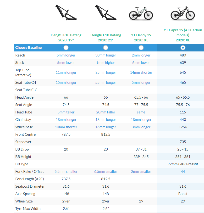

I know there have been questions about sizing, I'm 6'2" (188cm) tall and was looking at the 19" E10 but I see the Cheeb is the 21" frame, does it seem big to you? I ride an XL 2020 YT Capra at the moment the geometry geeks site when comparing shows the cheeb as bigger in most aspects but the rider height recommendations are smaller.
E10:
19" = 178 - 185cm
21" = 185 - 193cm
YT Capra/Decoy:
XL = 181 - 191cm

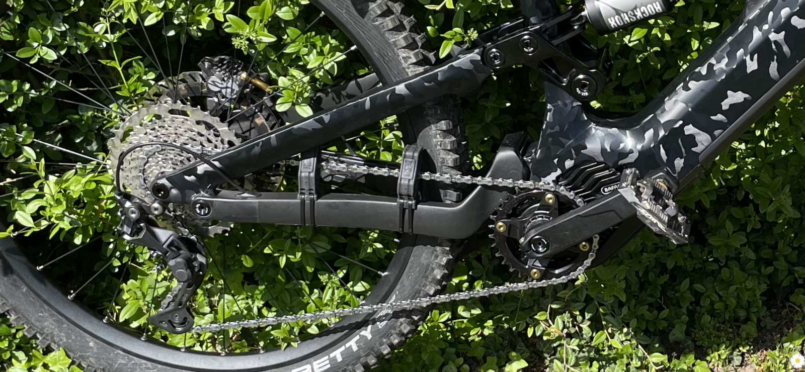

Is anyone using a 32t up front. I have fitted one, but it looks very close to the chain stay. Still trying to work out how long the chain should be. I think some one here said 22 links. Does anyone know any different.

I run a 32 chainring with 11-46 10-speed cassette and 116 link chain. Perfect! The STFU chainguide works also very good, but I had to adjust the front one to an appr. 2cm higher position as of the photo. Bike is very silent with this type of chainguide.

Thank you. Like the STFU nice. Will be looking for them. I run 9speed 11-50. I like climbing with or without power. Don't know why just do, and steep?. I have tried 116 but to tight.

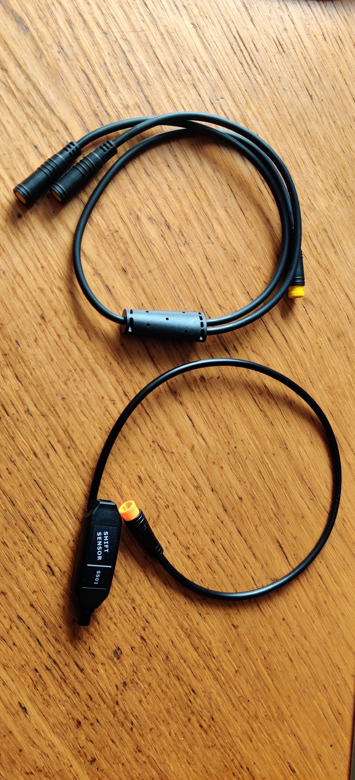

Has anyone fitted on of these shift sensors to M600 or M500 bike? Only 12 GBP off Aliexpress for what you see in picture. Just want to make sure that it is compatible with CAN system on M600 before I cut gear cable housing

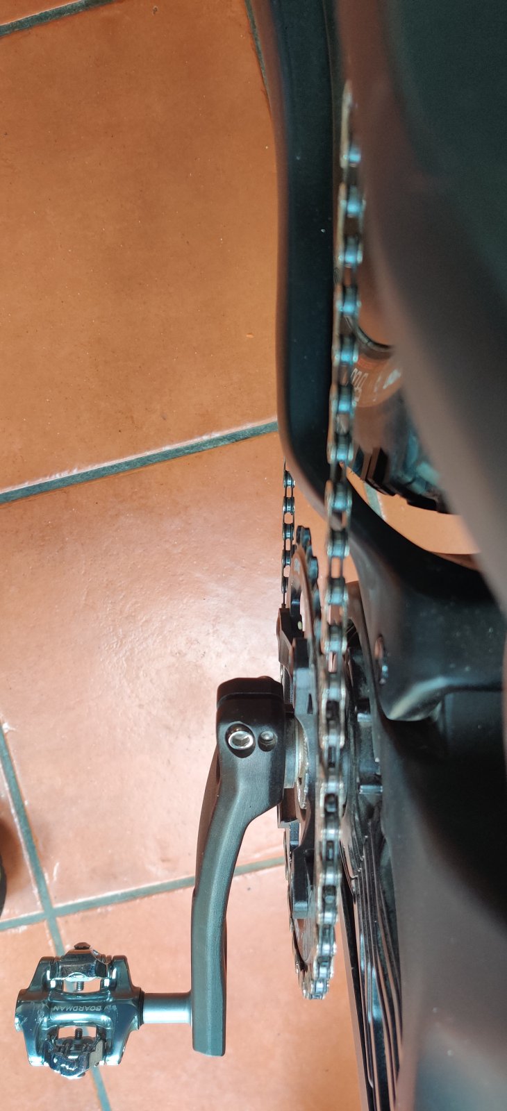

It comes with steel 38T ring as standard, 104 BCD, I changed mine to cheap Deckas aluminium ring but I keep it at 38T. I have M600 motor which can assist up to 45km/hr, if you want to use that speed then I would say 38T is minimum, I may even try 40T, looks to be just enough room (see pic which shows space with 38T) . Of course it depends what terrain you are riding. For me the local area is quite flat, so I appreciate extra speed, but when I take the bike to a trail centre I will change to smaller front ring. I am loving the M600 motor, especially on level 5 it's so fast!
