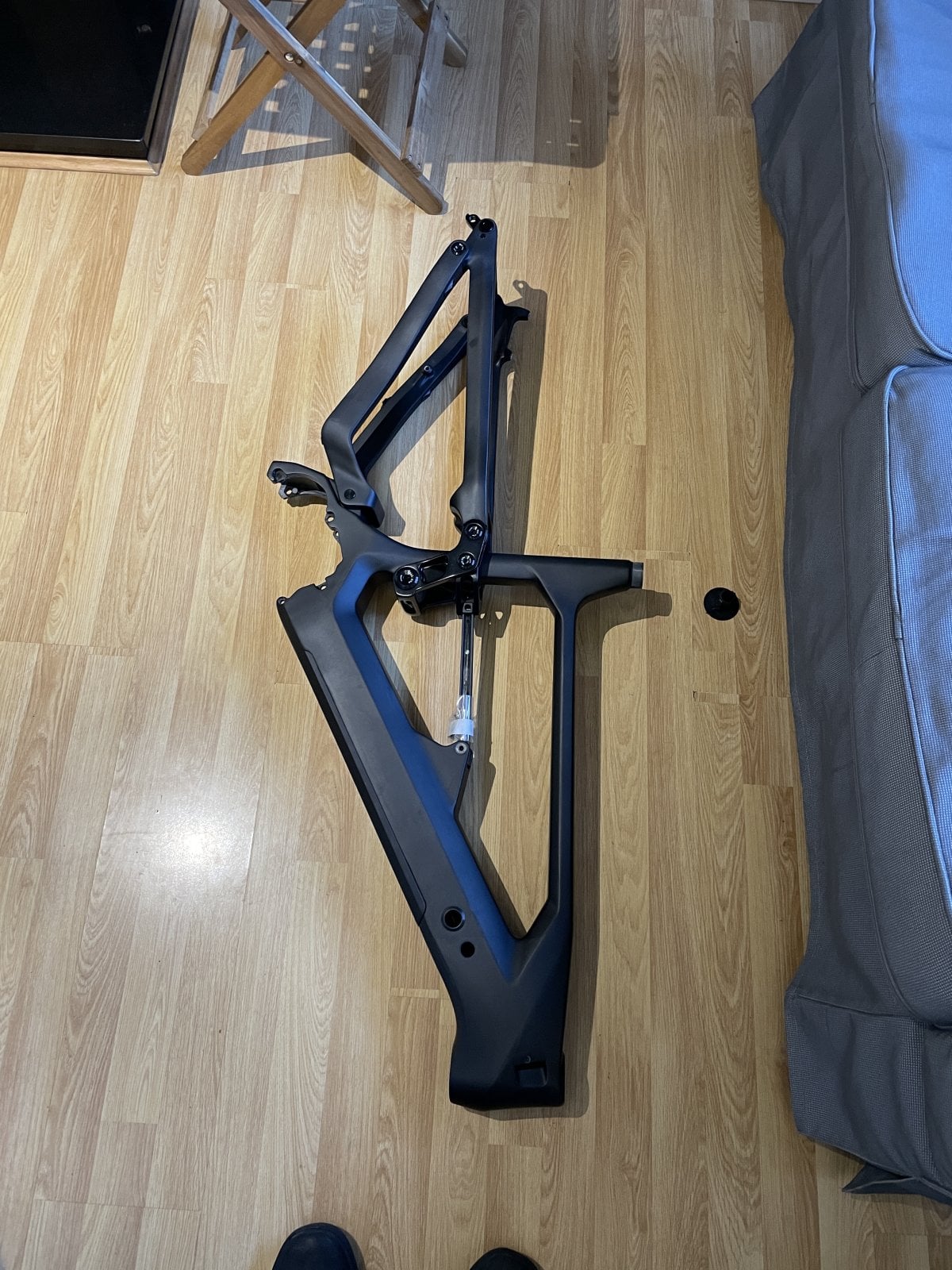

My frame has arrived today, but without a battery.
Dose it usually arrive separately or with the frame?
its standard. They seem to ship everything separately. I got the frame first, then 3 weeks later the motor and still waiting for the battery.The reply I got from dengfu was that battery is delayed as customs are all over packages from China. Should be too long

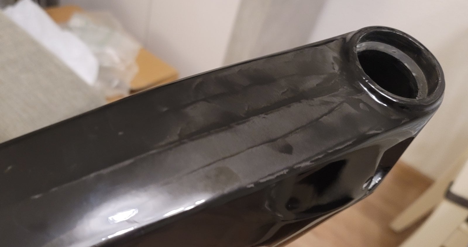

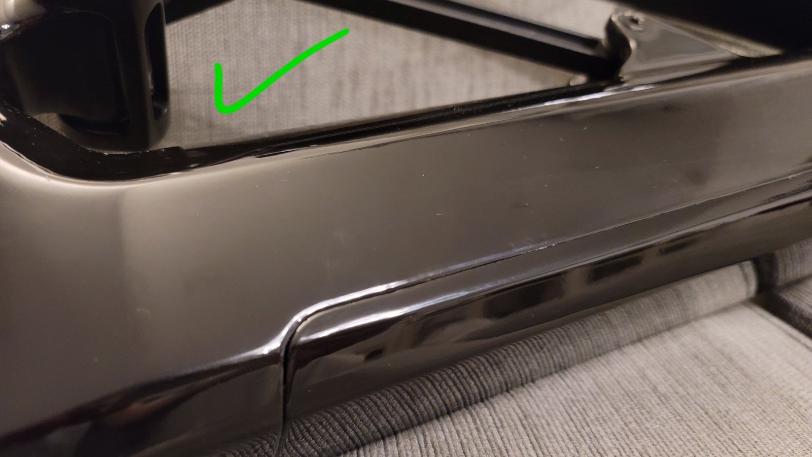

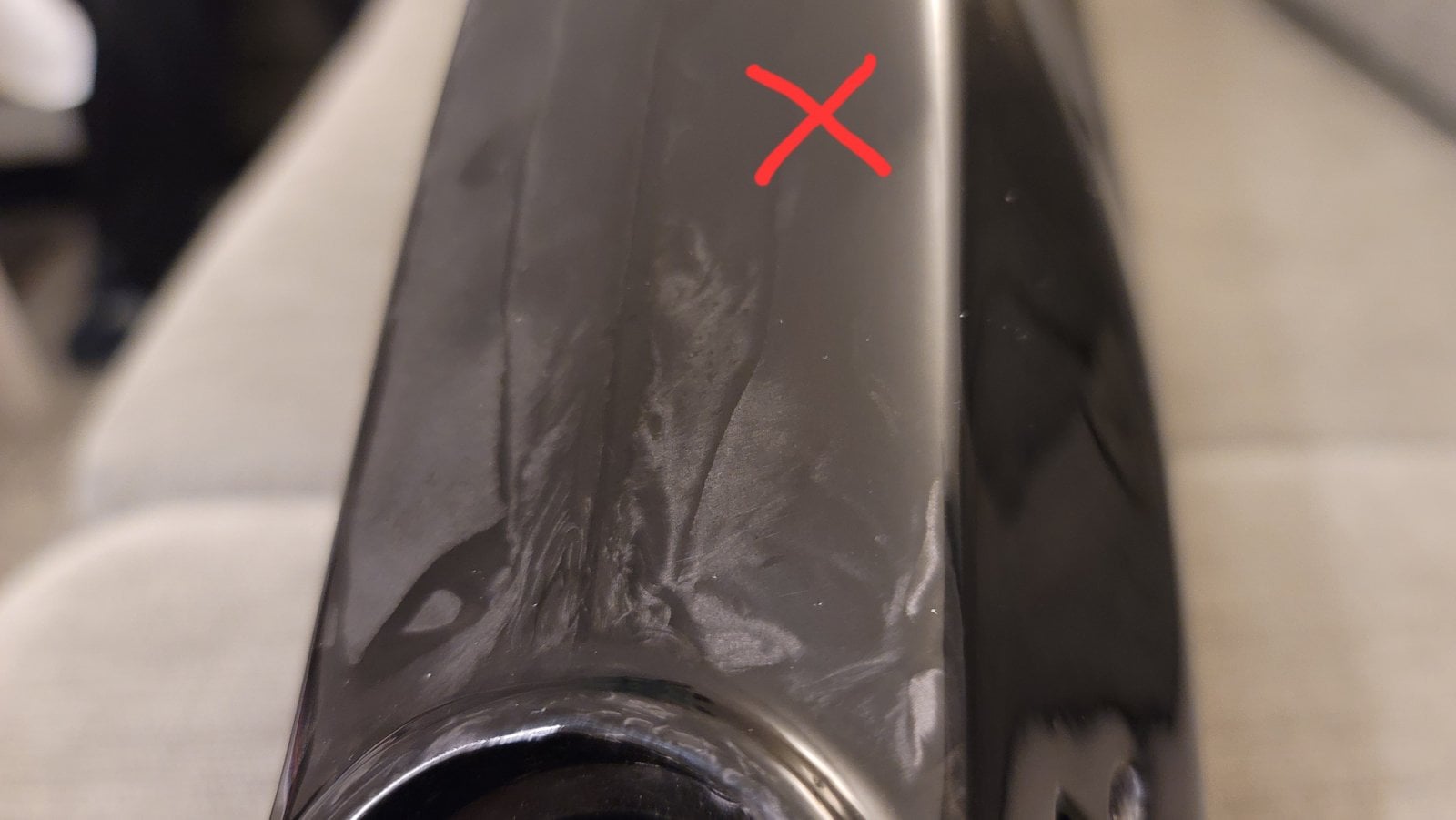

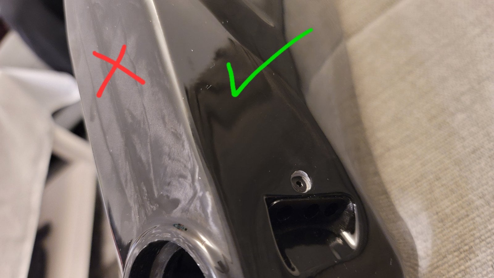

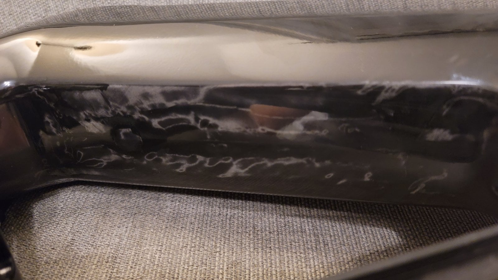

The frame is painted very badly, is this normal or just the frame they sent me?

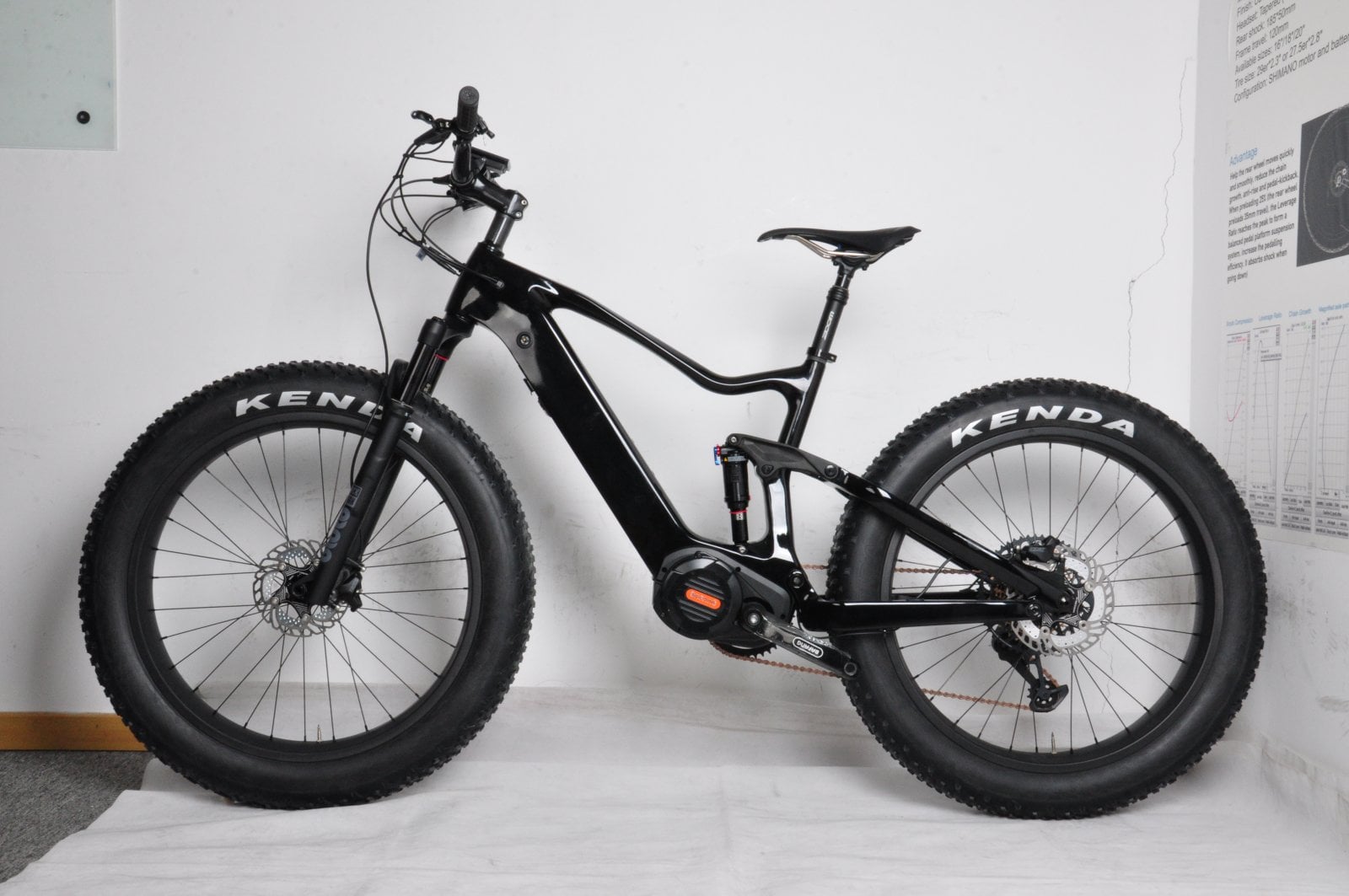

This is Dengfu's response:
It is not bad painting, but UD carbon weave. UD glossy is just like this.
I find this frame so unacceptable, it looks distorted.

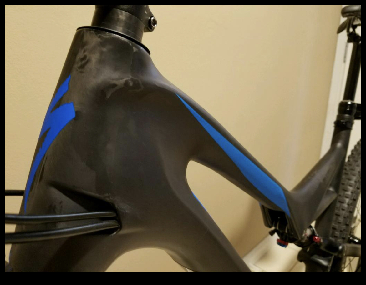

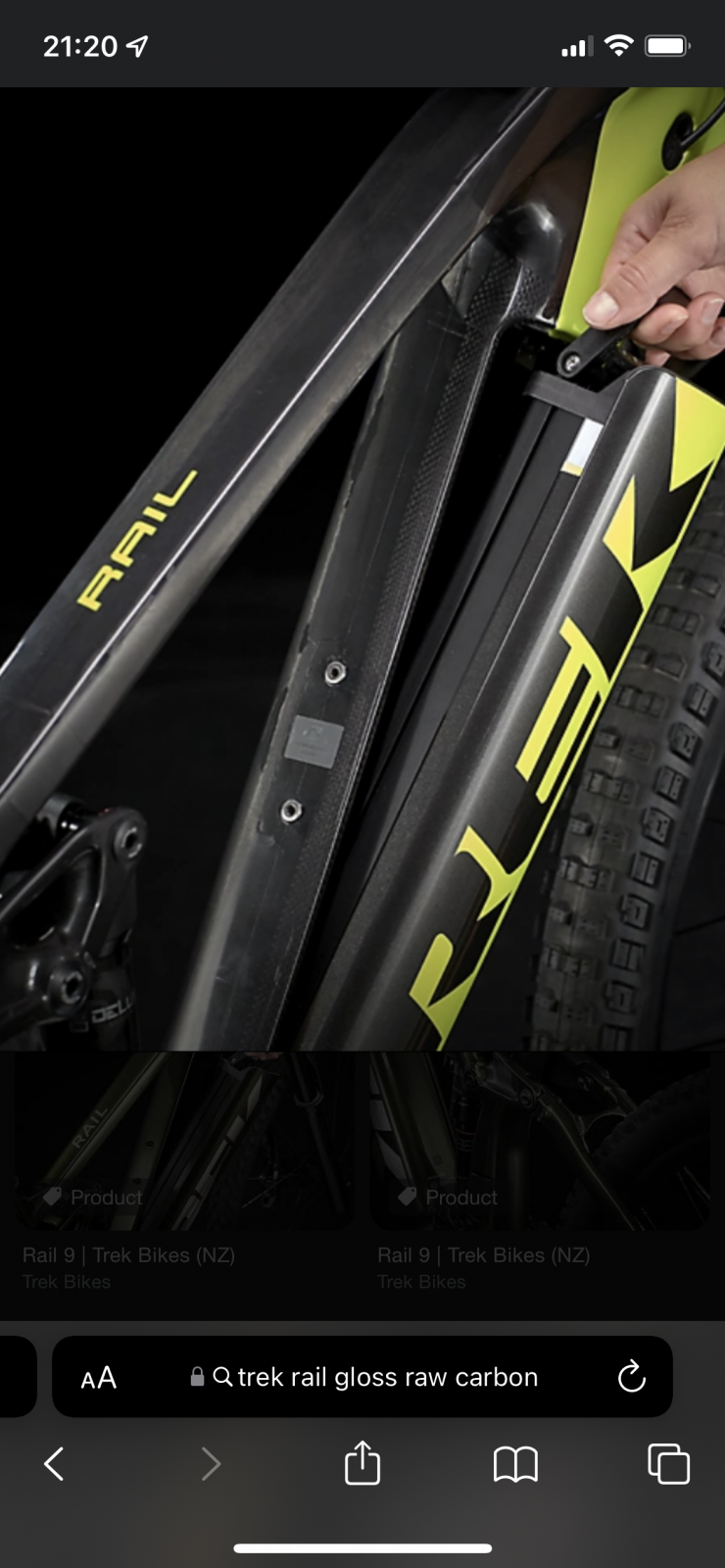

I personally think you might have chosen the wrong finish or you might be confusing Uni directional carbon for a conventional weave carbon. Im not defending Dengfu here, but this is the standard glossy finish on this type of carbon. As I said to you previously OE manufacturers make the bikes in the identical finish. I have personally seen Specialized in UD carbon finish. Something like the photo below.
Yes, you are absolutely right.
Maybe it's my fault, I had a different perception I didn't know glossy carbon would look like this.
But this is a half-truth.
When I asked Dengfu what the glossy carbon frame looked like, they sent me this photo, which does not match the frame that was sent to me:

Sorry to hear that anyways. If it makes you feel better, I have the matt version and I will still be painting in a different colour. I just think they look very plain in carbon black. This is the colour I will go with.
ps: not my photo, saw this on FB

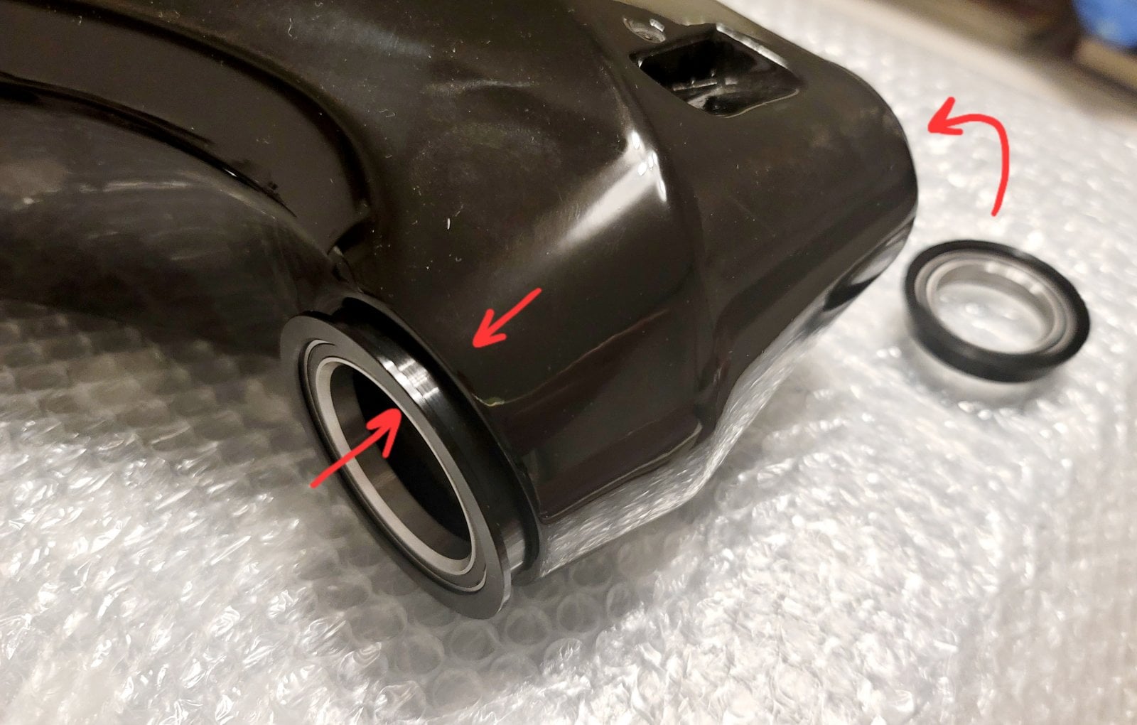

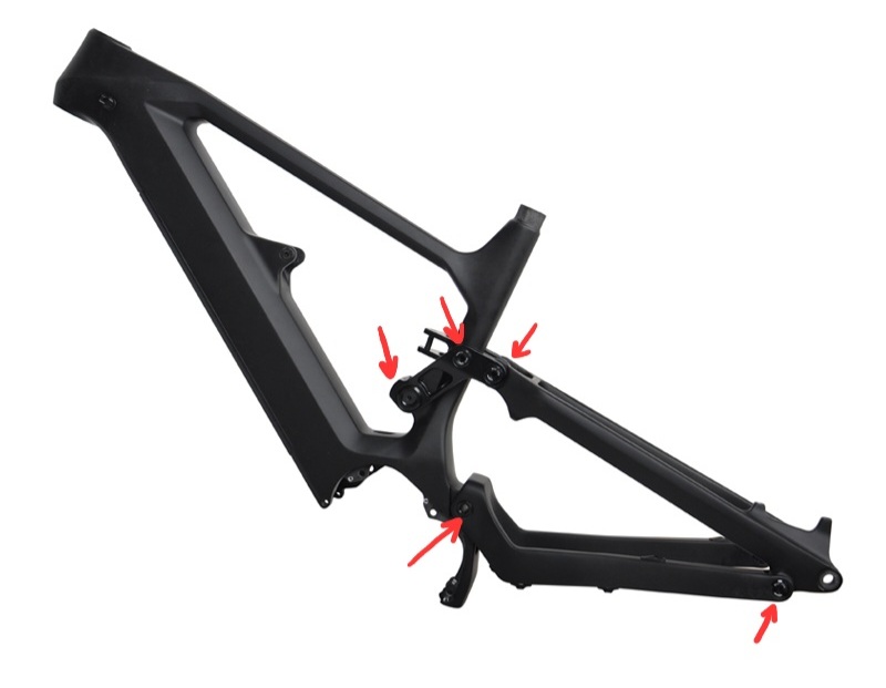

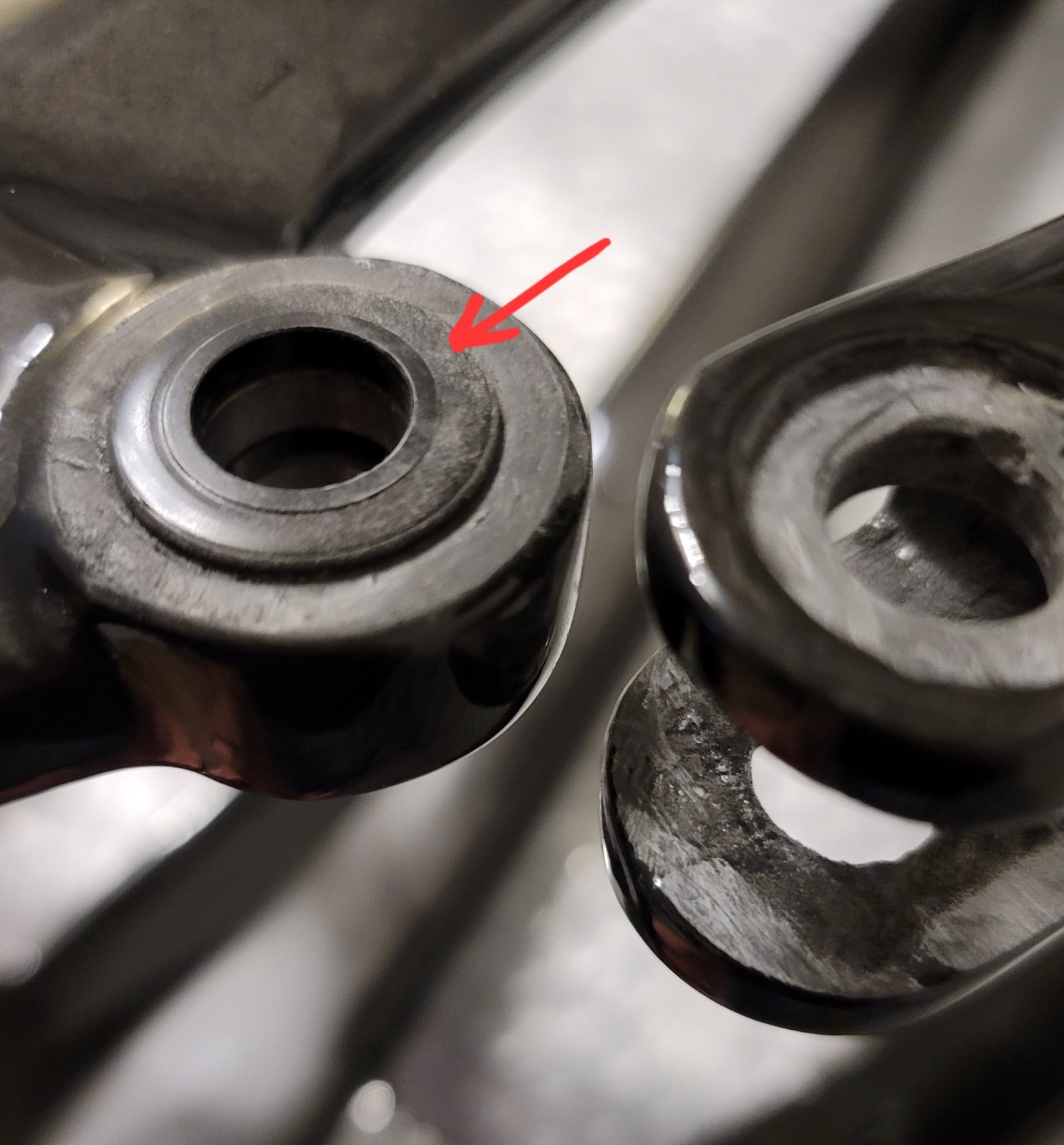

Thank you, I also noticed that the screws were not tightened to the maximum torque. For example, a screw with a maximum torque of 8 Nm is tightened at 5 Nm. Should I tighten the screws to the maximum torque or a little lower to preserve the carbon frame?

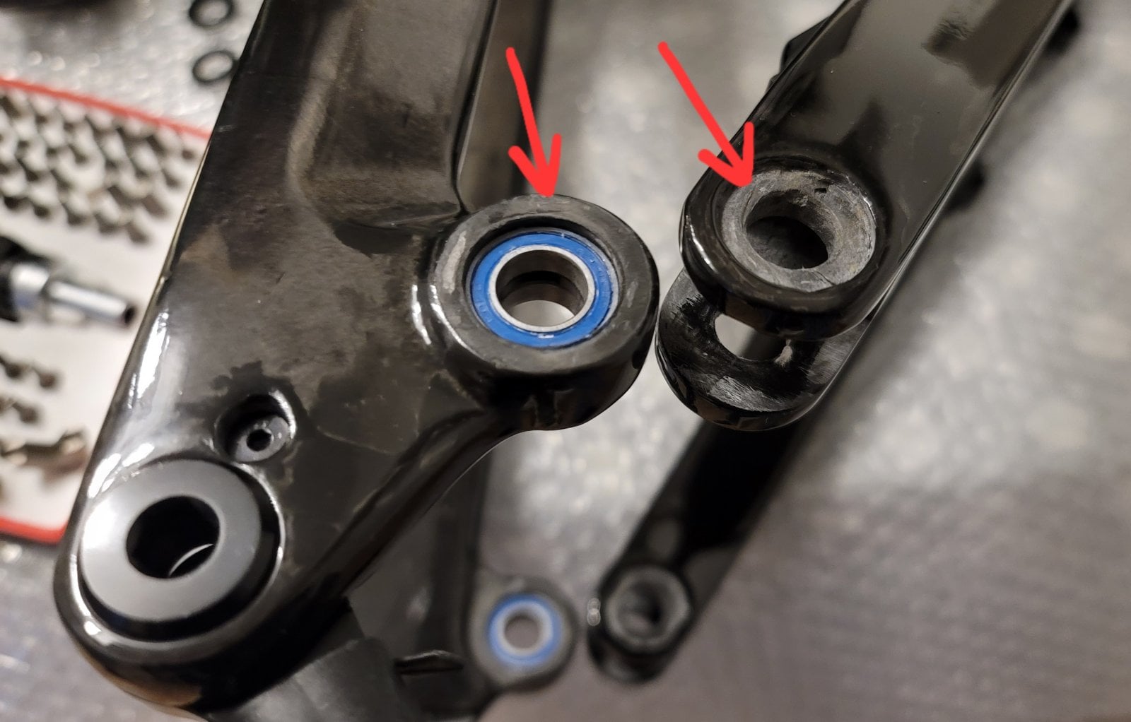

I discovered that there is no grease in the screws areas, should grease be applied to these areas or is this intended because the frame is carbon?
Why would you put grease on the outside of the bearing seal or am I reading your question incorrectly. All the action takes place within the bearing where only a light smear of grease is needed as its a low speed movement. Technically if you fill the void between the bearings then all you are doing is attracting dirt which eventually will get under the seal and damage the internals.
Personally i prefer to intercal a few silicone grease between the bearing and the washers to prevent moisture insertion and bearing grease washed. I have constated the effiency yesterday when i have dismantle link to check (+-1 year use and low pressure karsher wash). Clean, grease present and no dust sticked (but 1 bearing change needed), but i don't ride in muds. Of course i don't put grease between bearings and contact surfaces.
