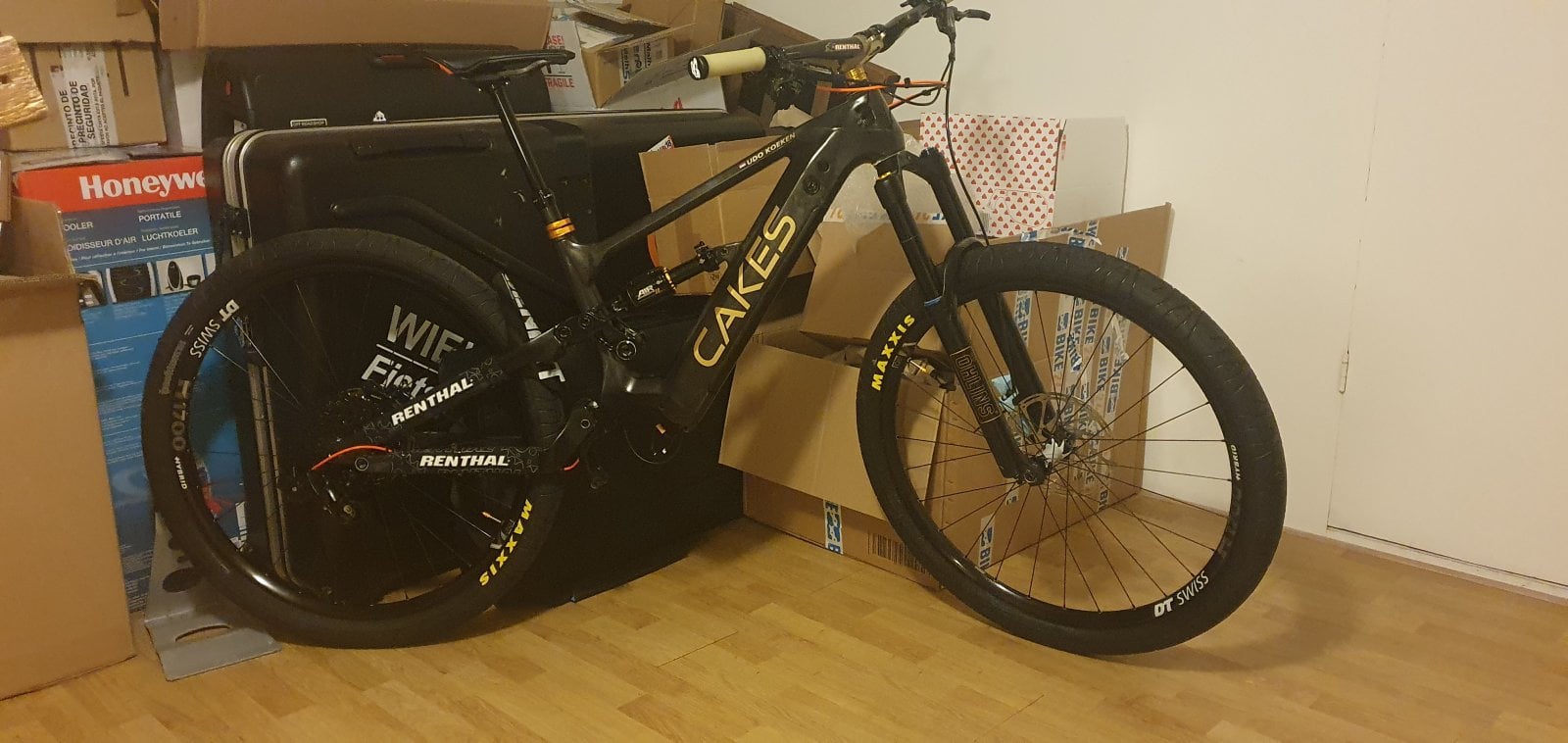

Hello everyone,
To be thankfull for all info and just reading, a post off my project so far.
Love to hear your thoughts off course. And excuse me if replies or not short therm some times.
Cheers Udo

A lot of beautiful (and expensive) parts on youy bike, i think near 21kg at the end.
my return on renthal stem. i have twisted one (but i have 100 kg wheigt)
Hello,
Your wright about the parts. But with patience and searching it is also not above 5K total. Got some discounts and there where parts in sale.
We will see what the scale says and performance will be. The suspension setup now is suprising me in positive way. I like setup options and there are plenty and in a good range.
I hope i will not experience failures to much. But off course it can happn.
Hope you did not got hurt yourselves.
Cheers.

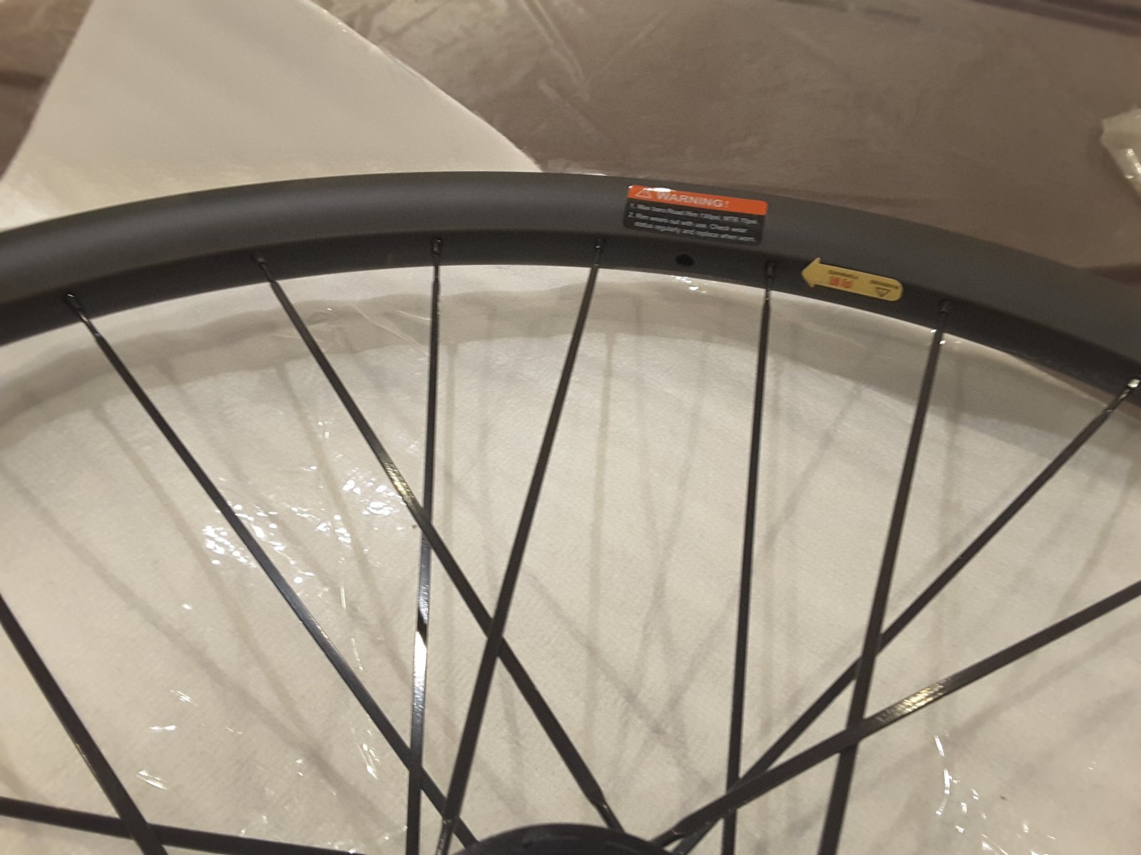

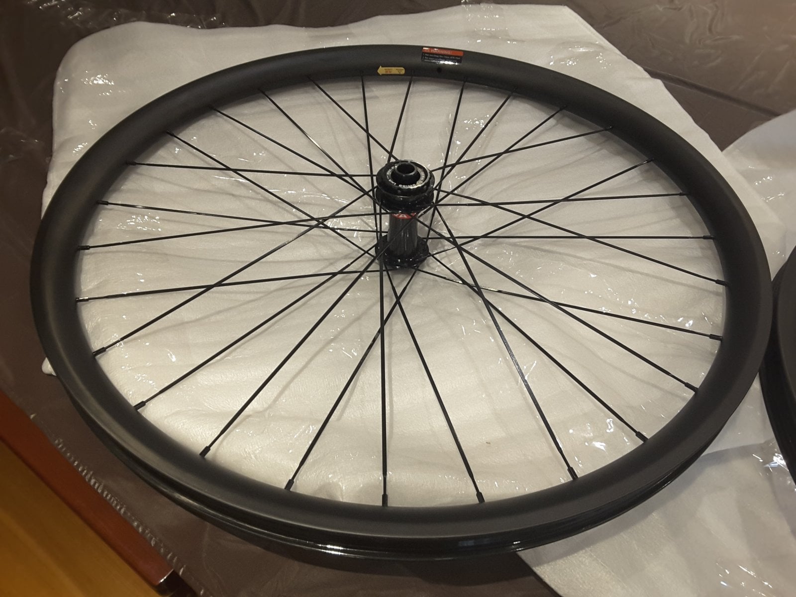

Well my chinese carbon wheels have arrived. 29 and 27.5. I have no idea what I have purchased. The rim shape is odd. Nice curve one side then steep the other. They are described as asymmetrical clincher mtb wheels. I also don't know what the brake set up is. I'm old school so this set up is new to me. Note the valve location in compare with the spokes. Anyway they look the part. I would be grateful if someone would be kind enough to tell me how the disc goes on.

Well my chinese carbon wheels have arrived. 29 and 27.5. I have no idea what I have purchased. The rim shape is odd. Nice curve one side then steep the other. They are described as asymmetrical clincher mtb wheels. I also don't know what the brake set up is. I'm old school so this set up is new to me. Note the valve location in compare with the spokes. Anyway they look the part. I would be grateful if someone would be kind enough to tell me how the disc goes on. View attachment 56549 View attachment 56550
Hello,
Asemetric is for spokelength. If this is as even as possible spoketension is also even and therefor the wheel is firmer.
Also the reason off rimshape. I should be able to see spokes are not in the middle of the rim.
For brakes.... google centerlock. There is only 1 type if i am not mistaking.
Cheers
"old school" whould mean old man ? may be you prefer most confortable ? I have tried carbon rims, the bike working well but the rigidity is strongly felt and the win in weight not really, i prefer alloy rims for my old bones .
Which width ? 30 mm for me is the best to use with 2.4 / 2.6 tires, I have tried more width (40mm) with 2.8 tires, but too many constraints on spoke and i have crack several (never occur on my other rims)
Not old, only 63 ?. The wheels are mostly an experiment. At $669 aus at the front door I thought why not. They are 35mm external 29mm internal between the clinch.
29 internal is the good choice if you whould use 2.4 to 2.6 for my opinion. 669 AUD for the two is amazing price for quality complete wheels. for exemple i paid my carbone rims from china (BTLOS) more than 230 AUD each
