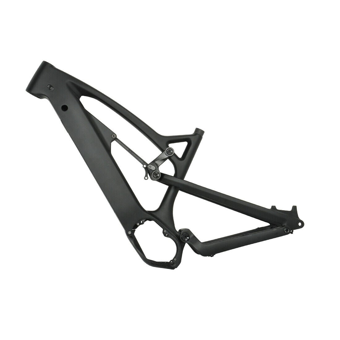

Hi I notice on Robs frame , CHEEB , the frame is flared in at the top of its headstock whereas the headstock on the one I’m thinking of purchasing is flat ,E10 below, is it the same frame .?

After checking Dengfu E10 info‘s again, its pretty much clear now that the frame is designed for 29“ wheels, and 150 mm suspension travel front and rear. This fits to the geometry change that Rob provided, with mullet setup and 170 mm fork. My assumption was that the frame is designed for 27.5“ wheels, that was wrong and caused me some headache :). So I will go with mullet setup as well, 180 mm fork, and 216 x 63 shock and offset bushings to fine tune installed shock length.

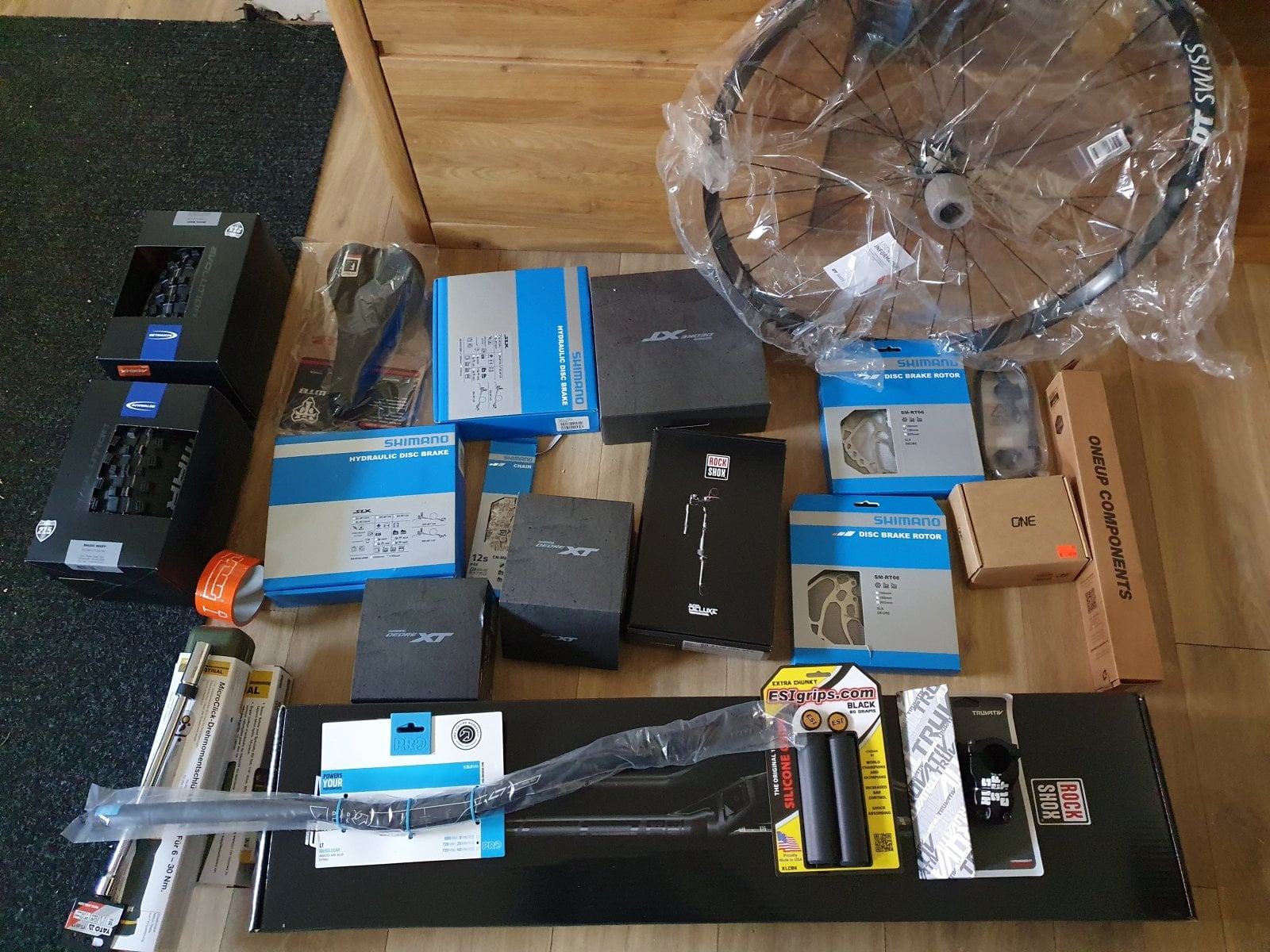

Parts are coming in dribbs and drabbs. Forks came today that raised the question does the E10 frame come with a head set? I'm guessing not. So no idea what to get, any advice please. Also I thought as I was going the so called cheap Chinese rout I would try carbon fibre wheels aswell. I shall let you know when they arrive. Not sure how wheel hubs work as the price range is crazy. I have a concrete grinding business and normally have to replace bearings (Chinese) with new Japanese bearings. I am assuming this is possible with wheel hubs aswell. Anyway perhaps not. I am enjoying the journey so far.

Plan is to order the Zeb Ultimate 29“ 180, the Vivid Coil ((Super Deluxe is not available in 216 x 63) or the Vivid Air, from wherever available at best price in Germany. Offset Bushings directly from offsetbushings.com in GB, link was provided by Rob in the build thread. I ordered bushings before there, with no issues. Completing with XT 1x11 drivetrain, 34 chainring and 11-46 cassette. MT 7 brakes, Bikeyoke Seatpost, Handbuild Wheels, Schwalbe Big Betty and Magic Mary 2.6, tubeless. Cant wait to start!

Just be a little aware how slack the head angle all ready is, I'm running 150mm approx front and rear on 27.5 fat 2.8" tyres ( almost the same OD as 29 " 2.4" and for my X Country stuff I do, the frame already is verging on getting that dull steering feel on tight slow single track you get with too much head angle. You start pushing up the front further and yes you will get longer travel but you will loose some of the nimbleness together wiith the higher BB creating that on the bike rather than in the bike feel. Just a personal take on things I guess.
I calculated based on Dengfu geo chart, and the assumption this geo is based on a 29“ wheels with 2.6“ tires. With that, the longer rear shock and the longer fork, the headangle will be at 64.2 deg., BB hight at 358 mm. So far thats the theory ?, if this turns out to become reality, I‘m fine...
