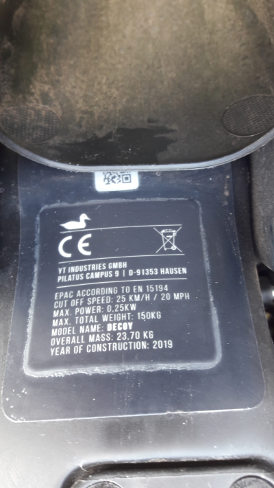

I have mailed EBIKE-MTB and explained that I have an YT Decoy 29 that does not have an CE mark sticker on the ebike, like SCOTT, nor a CE declaration in the YT documentation, nor can I find the word EPAC in the documentation.
Correction: while searching for a frame number I found the CE mark at the motor-mount but facing the rear-wheel. You can only read it when you remove the rear-wheel. Looks like the sticker is for all Decoy models.
