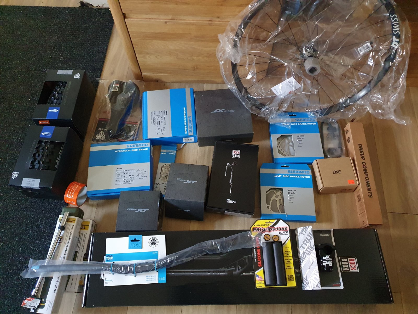

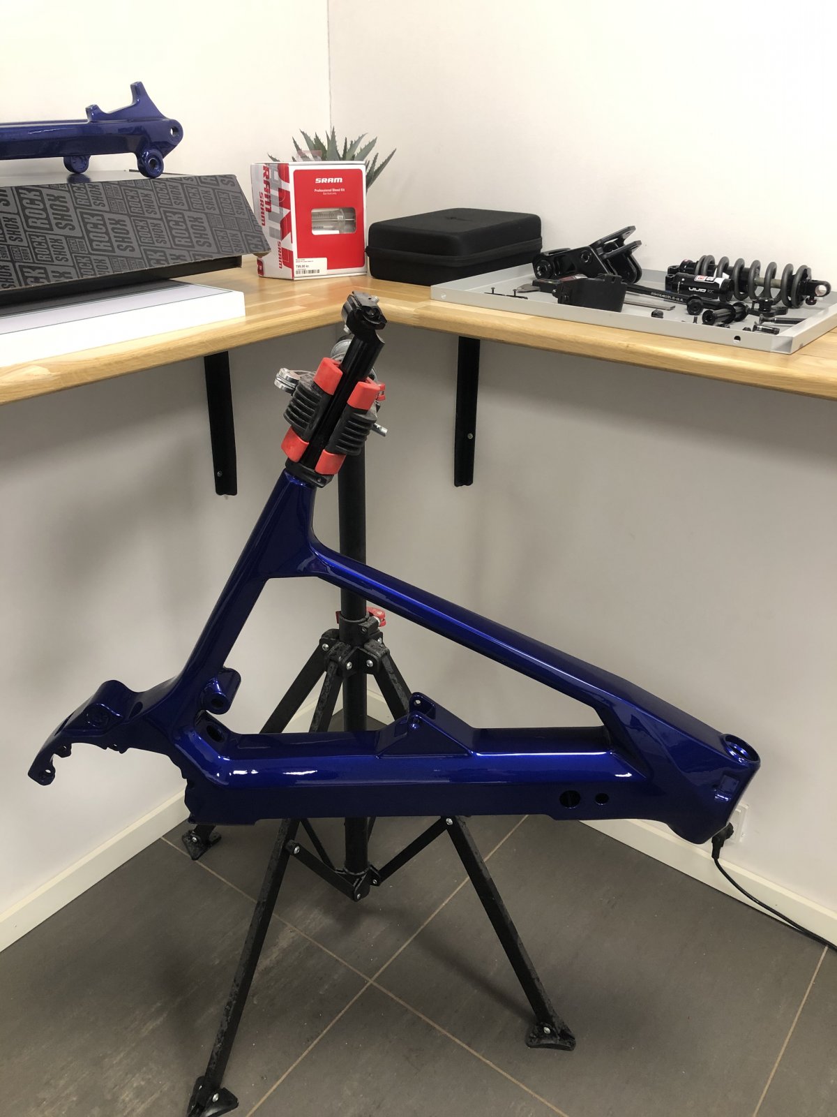

Hm, all parts here, only frame & motor are missing to start. And also offset bushings, but i expect them this week :)
PS: for builders -> situation on sale market with parts is becoming more and more problematic. Be prepared!
Same here ?. Frame, motor, battery and fork with shock missing due to delivery delay ? (wheels for mullet setup not in the pic but ready)

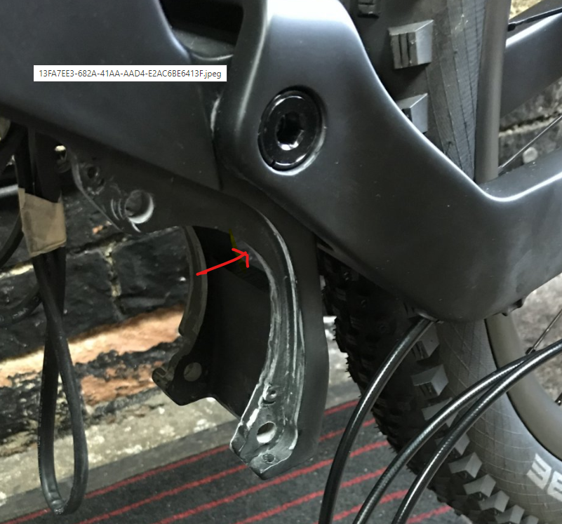

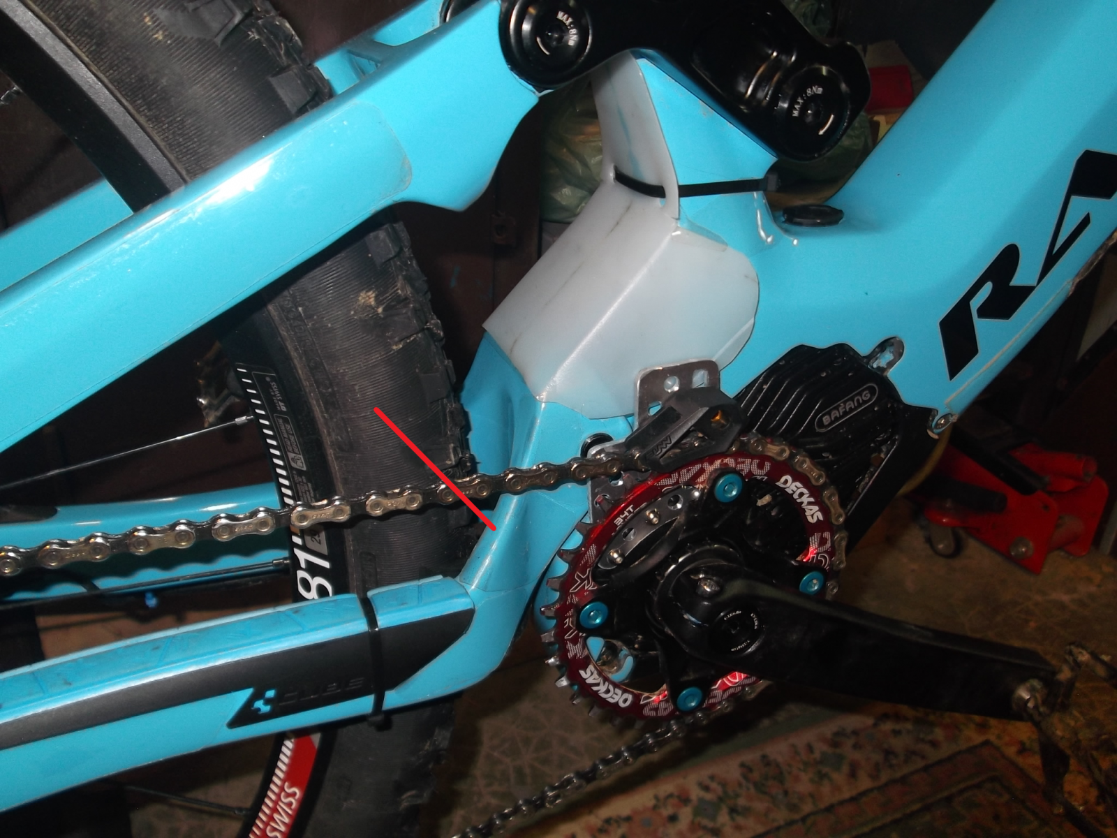

if you estimate modification necessary to prevent failure, do it. Personally i have add plastic tape to avoid cut on angle and carbon frictional wear. I will check later and if necessary i will add aditional hose around brake hose and derailleur sheath.
Additional recomendations for E10 builders. In addition of lower base protection, it is absolutly necessary to protect the part showed by red straight. I have add 2nd layer of tape, I have several impact of chain on it
I notice you're running a chain guard/device, looks like it's just bolted to the motor is that correct. I don't suppose you have any CAD drawings for that?

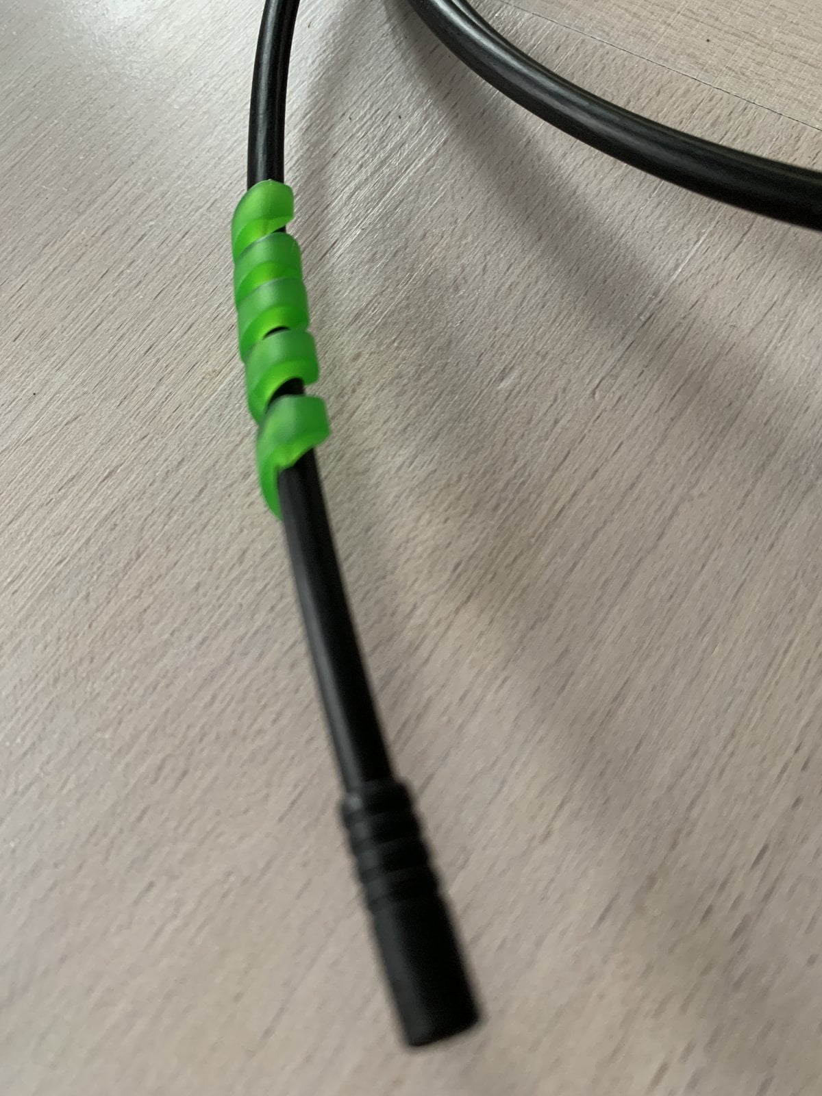

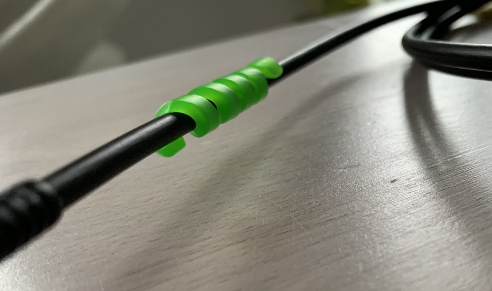

as usual, thank you very much for all your tips and tricks, @patdam !

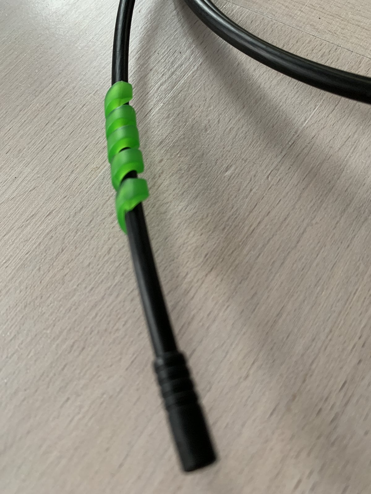

What do you think of a twisted rubber protection like this for cable and brake housings?
I will try to put some Viton Tube over (cannot say if there is enough space) - head a bad experience with those twisted rubber - it moves/stretched apart and cable/tube can then be damaged

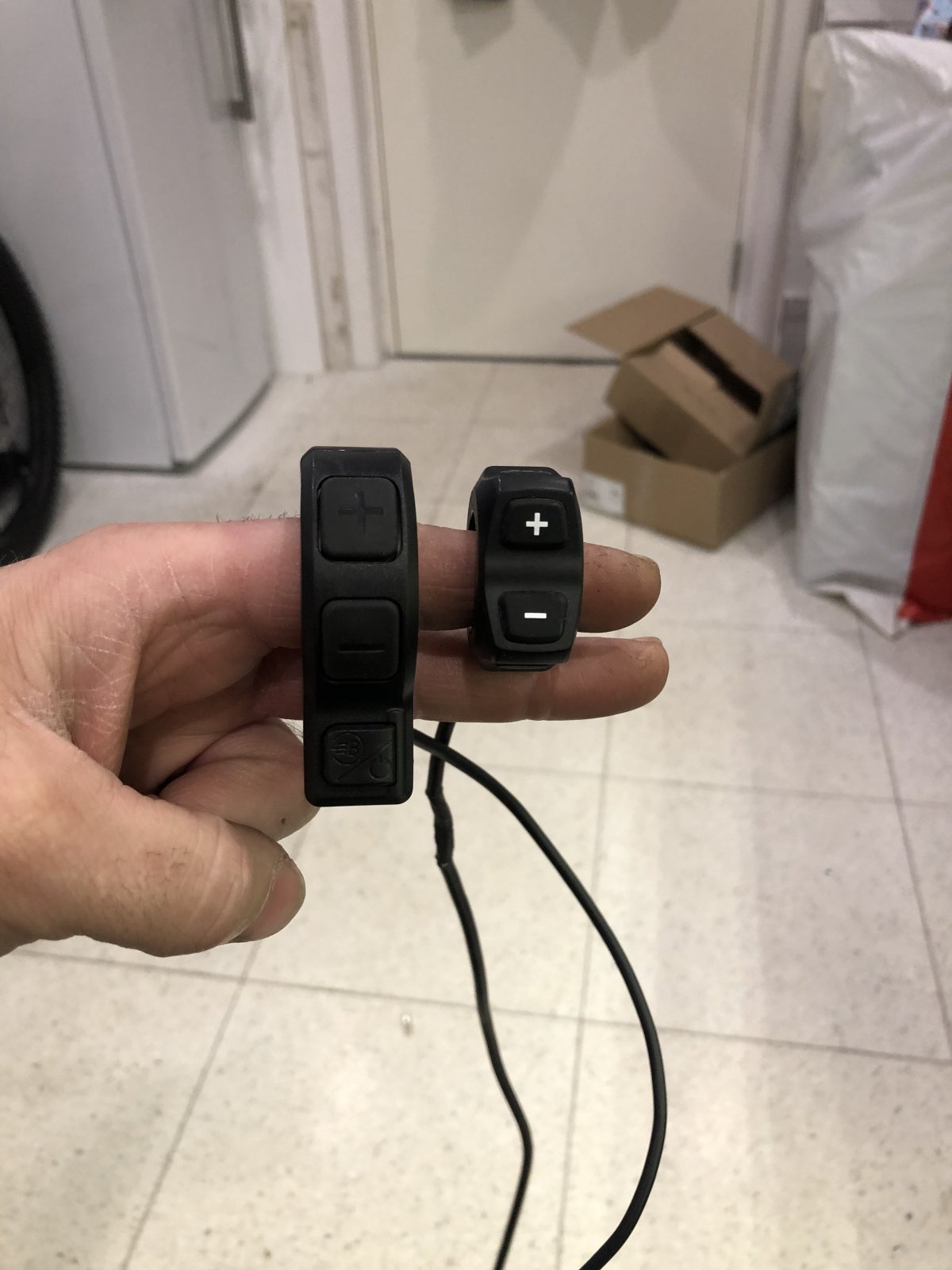

Is there anyone in here who has a wiring diagram above the buttons.
i want to replace the big ugly button with a spare part from specialized.
