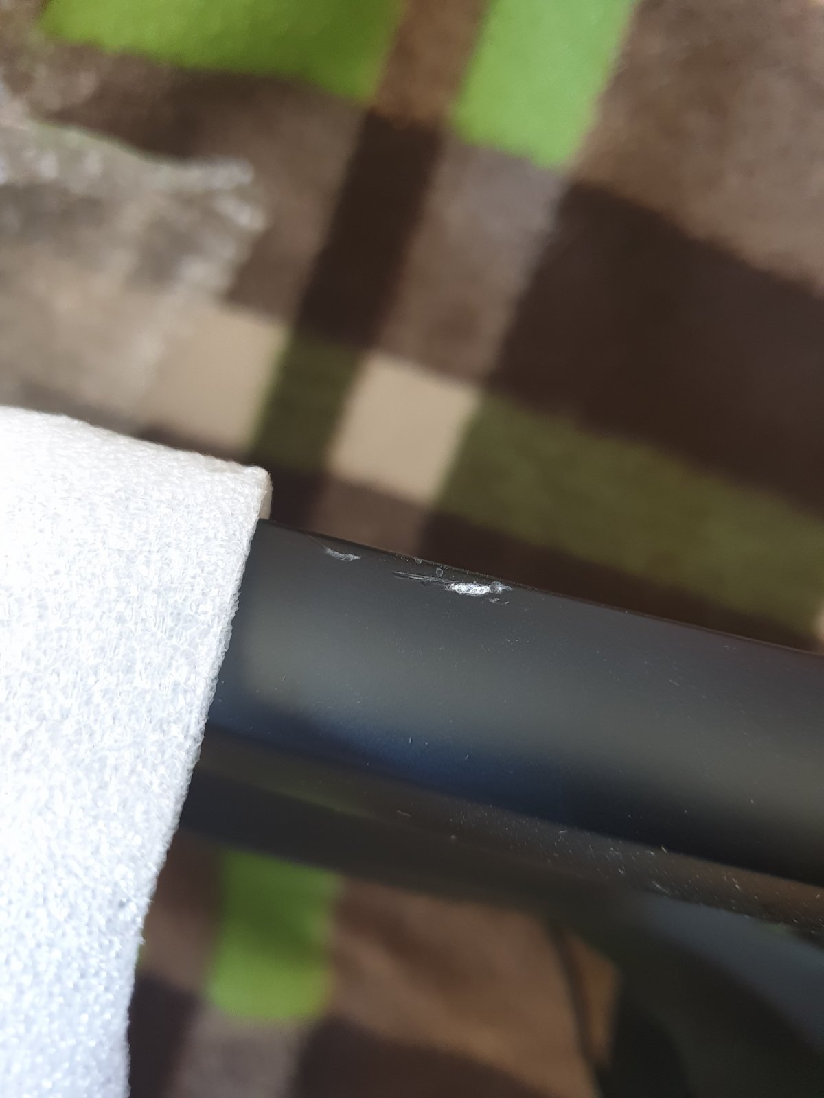

bought a whole bike from Tosa bikes.So far i like the m600, although a bit loud but not intrusive,i will improve on this.Biggest problem is that i have a scratch on the swingarm.Not sure during the transport etc ,Do you thing it is a major one?

Its nothing. If you "land" into rockgarden with bike multiple times, you will find a bunch of those. As colleague said, epoxy/primer, paint&forget. Its from shipping, but make no sense to ask for replacement :)

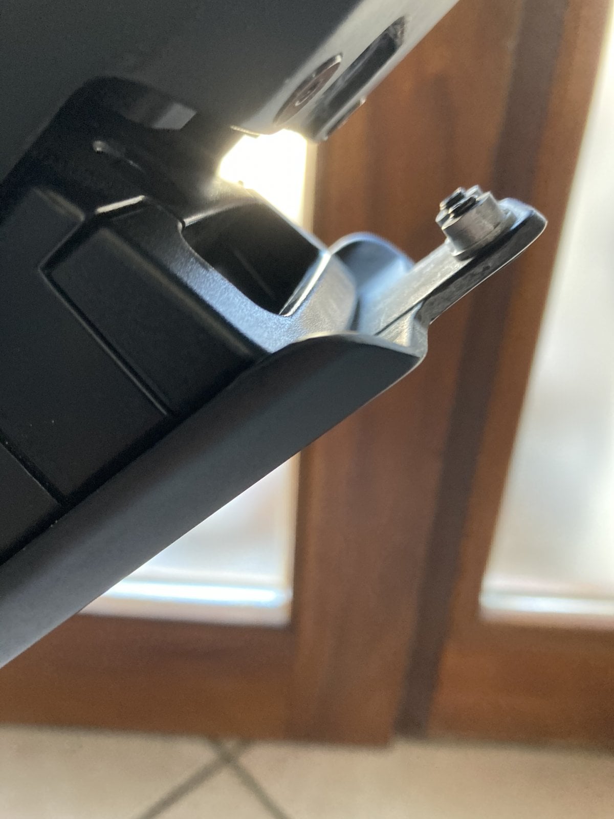

Looks like the Ali inserts haven't been bonded into the carbon correctly or possibly you have over tightened the bolts in the warm of your garage and then gone out into the cold ? Can you take a photo of the area where the inserts sit in the carbon as if its a clean fracture of the bond and the inserts will fully sit back into the recess, you could just super glue them back in or better still use one of the specialist epoxy glues designed for the purpose

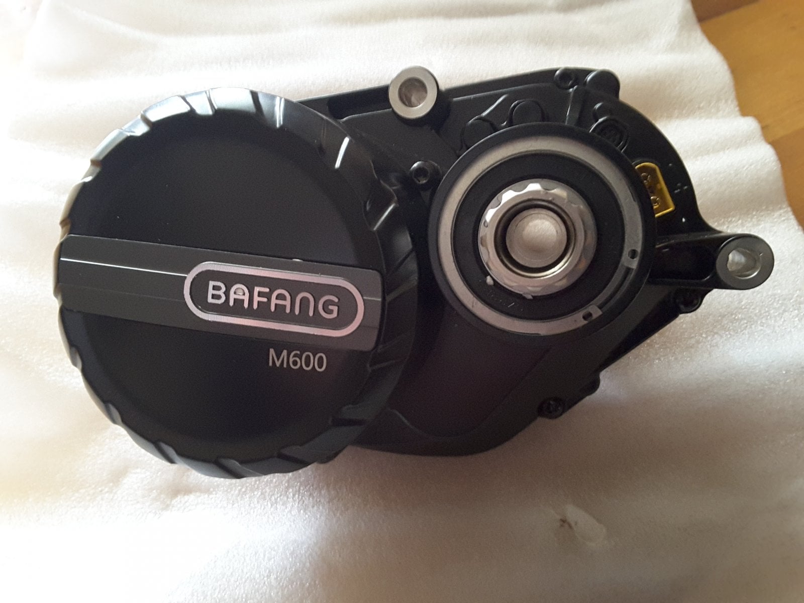

I got M600 motor last week and for comparison there is my motor Nr. MM G521.500.C11 and on controller CRX10N.500.FC 3.2 (Software version CRX 10NC4818il32 046.7) - if someone would compare those numbers with his M600 motor to check what version is it. I don't know if I got the newest with hardened nylon gear (I'm a bit sceptic about nylon - PEEK is there normally much better).
Frame should be finished this week and I got question if I could take 16Ah battery and not 17,5Ah since this can be delivered quicker (no answer until now how much quicker).

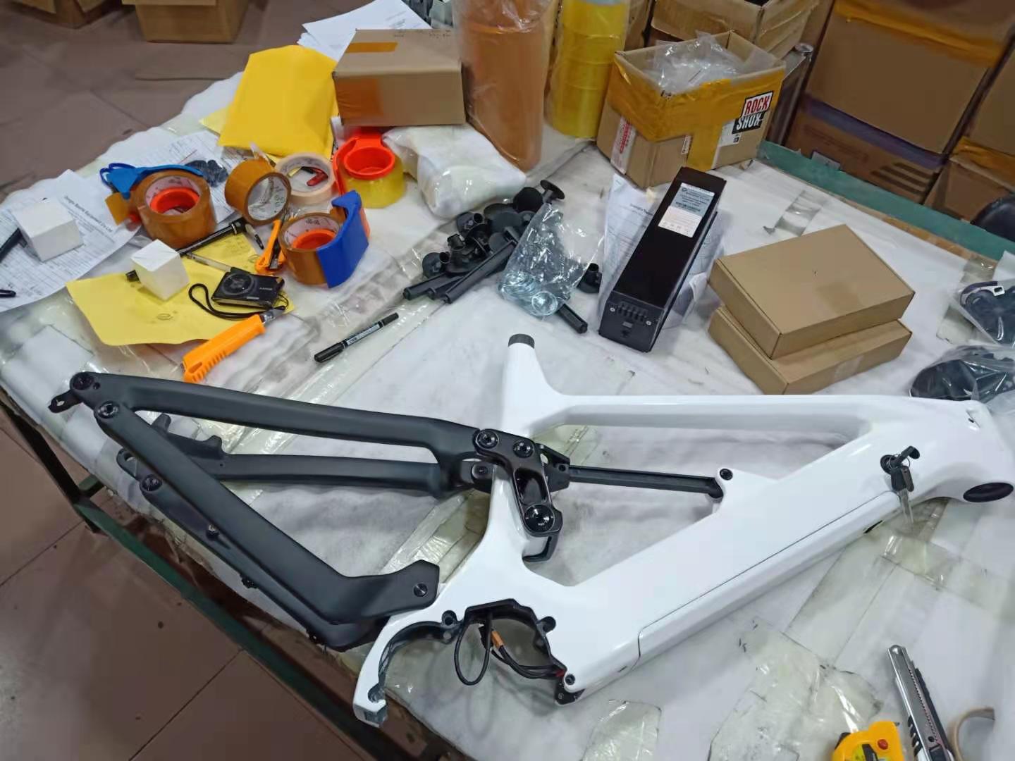

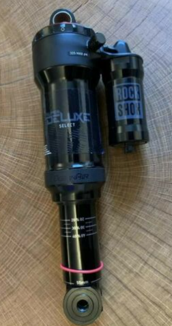

So finally my framset is painted and will be shipped within today. Looking forward to assemble my new bike :). Does anyone know if a Rock Shox Super Deluxe select + from a Santa Cruz hightower carbon cc with 210 x 55 mm will fit without problems or is it just a model that fits in certain bikes? My ordered shock was a Super Deluxe Ultimat RCT DonAir 210 x 55 mm but they do not know when it will be available. What shock is the better one? Thanks guys

If it's similar to the one I got on ebay, it's not compatible without changing the damper body for a standard instead of bearing eyelet (this is what I bought wrongly and it's too wide by a long way).
The damper body from the the standard one is swappable, but when it came to replacing it with a standard one, there was a long lead time for the standard damper body, so I bought a deluxe with a standard body as a donor and paid Sprung Suspension in the UK to change it over and service it (same price as standard service).
