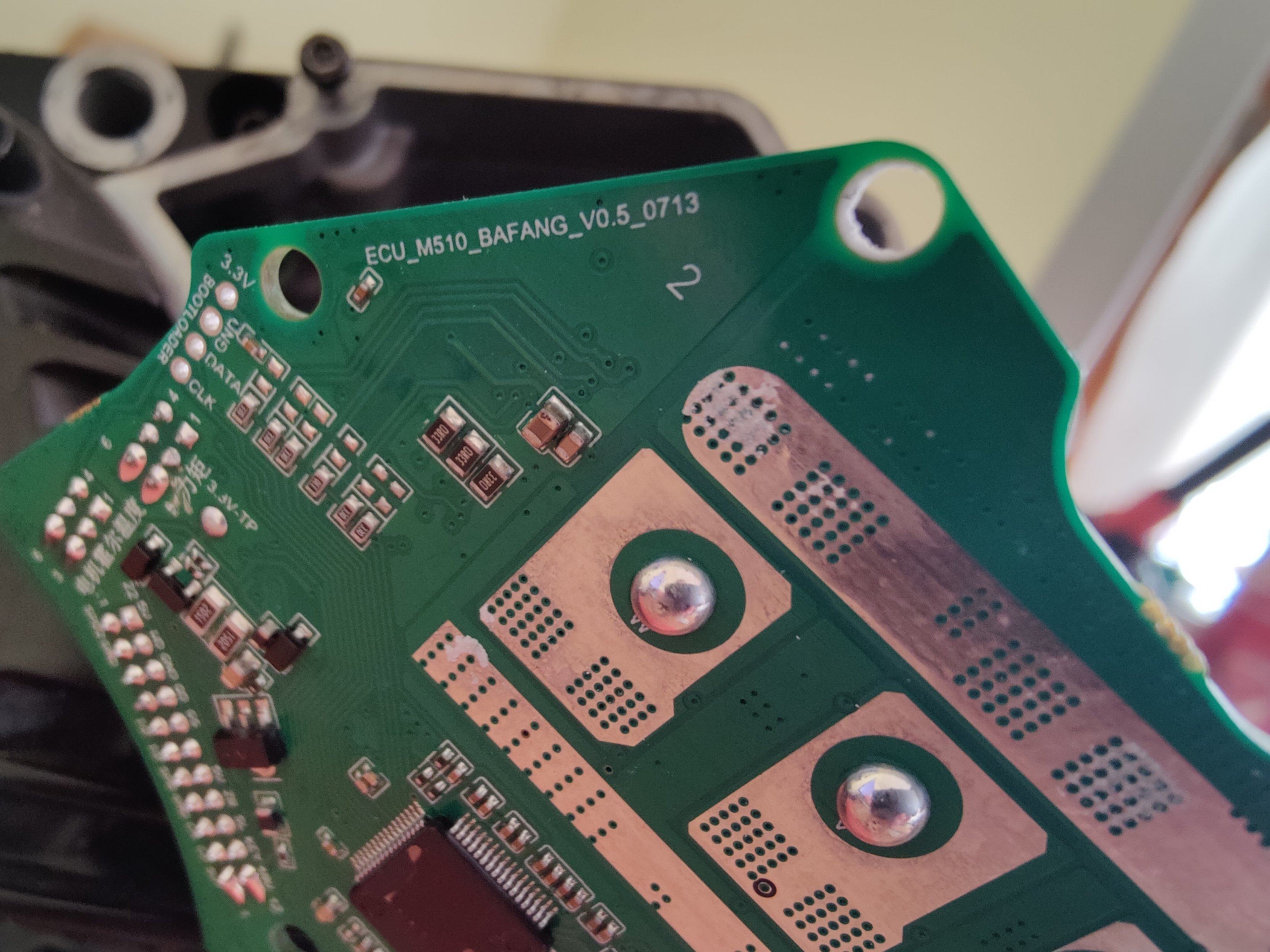

No update yet. It was loud and overheating.
Would be good if 500W version would use Nylon gear.
In next revision I am awaiting new controller - in first test batch there is M510 controller. ;)
And lets see if bafang manage to run it at 750W nominal. I guess temperature will raise to 100C quikly (it is 1200W peak)
Guys if anybody has some firmware for M560, please share. Have the beta test firmware v7.4 - 500W
Anybody tried to experment with bootloader? I see pins for onchip flashing in the picture. ;) Just we would need to have a bootloader file.
