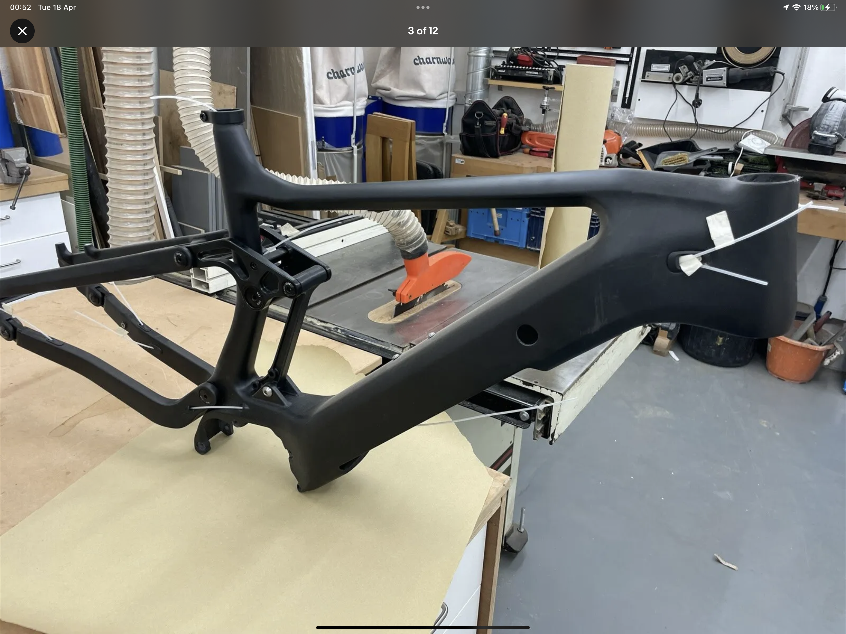

I bought this frame off eBay.

It’s for my first e bike and the deal wasn’t bad. I don’t think I have overpaid for it.
The bike will be for mixed road and light off road use. Nothing too extreme.
The controller seems quite rare so I figured that will be worth something if I change.
Im not convinced it will turn up tbh. I thought it was a scam for the first few messages, still suspect it might be.
I figured eBay buyer protection is good so took a chance.
