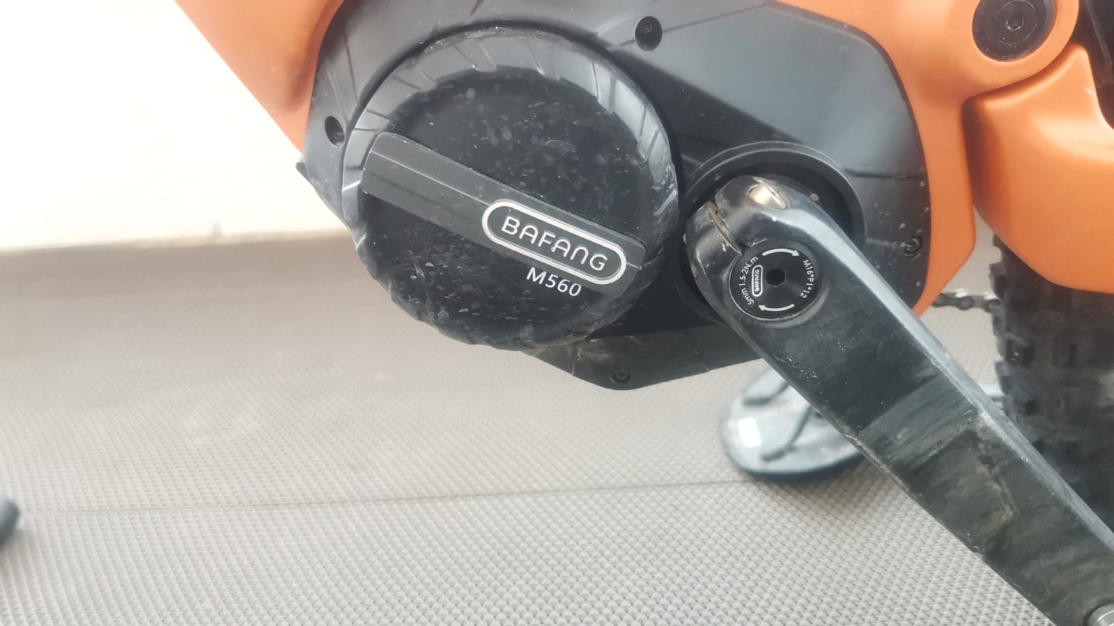

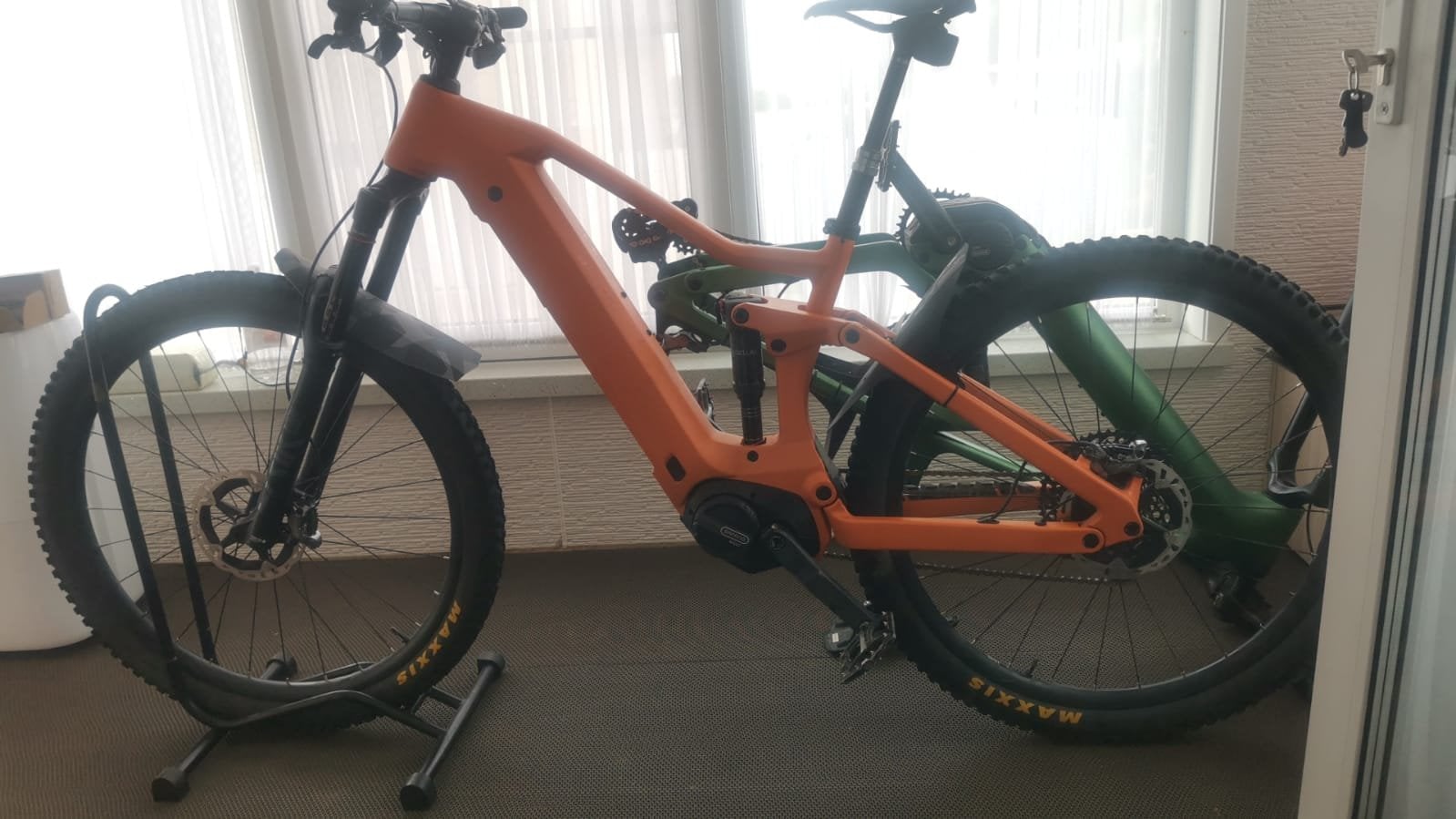

You were sold a defective motor. I've been driving the M560 and CEF49 for two weeks now. I hear a noise. My M560 is quieter than the M600. I don't have any metallic noise. I really like its power and how it rides.
WhatsApp Image 2023-09-26 at 16.37.27.jpeg WhatsApp Image 2023-09-26 at 16.37.36.jpeg
