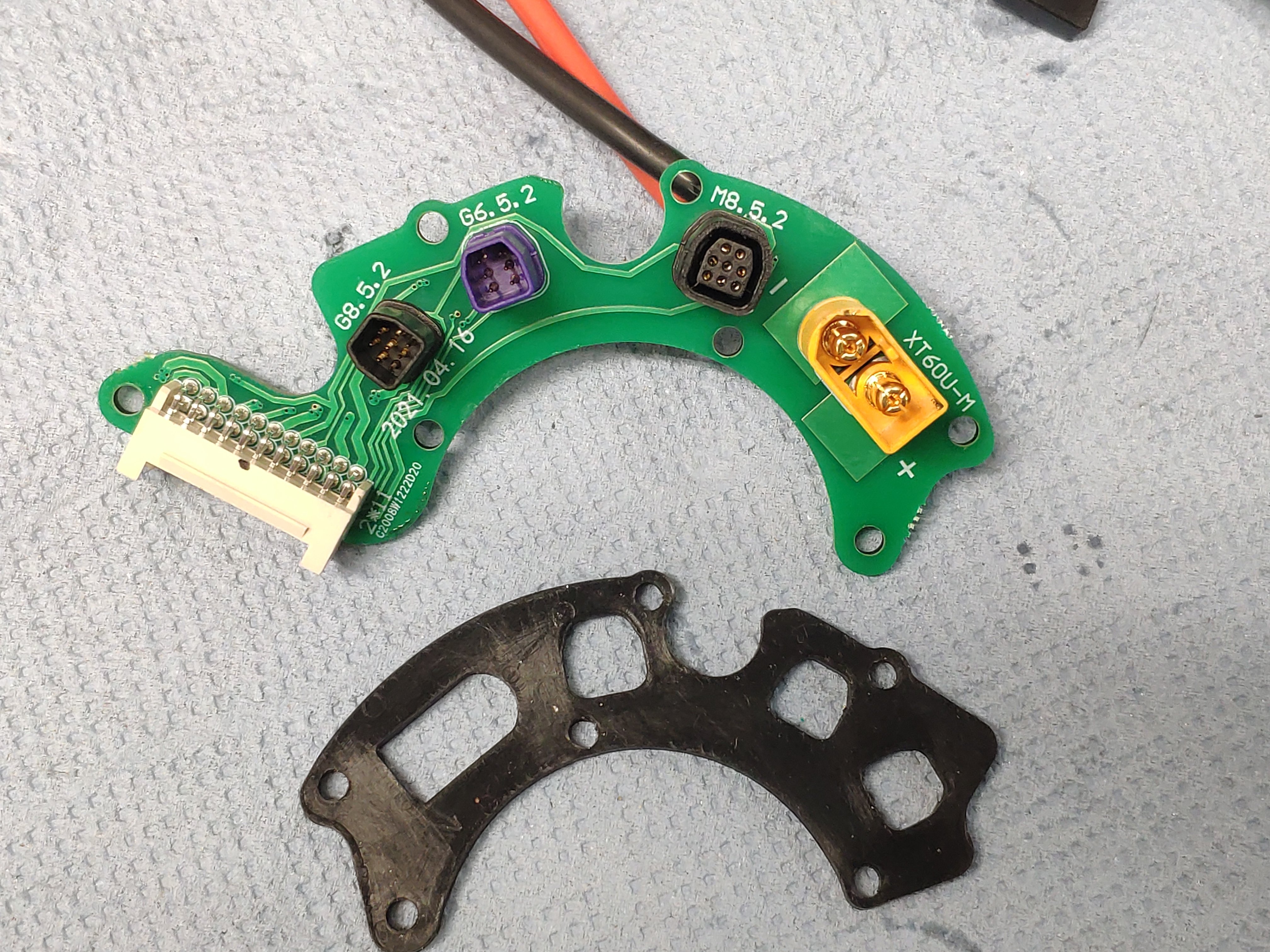

Difference between M560 500W and 750W is only firmware. In Boost it has a lot overshoot and can be dangerous, from what a few people reported. 750W peaks with about 1500W and can run with 52V battery without the need to charge it to only 58.5V.
In fact the first batch of M560, we can currently still get from dealers like Chili Shen, have controllers labeled as M510! The following pictures are from M560 500W.
MCU: GD32F303RCT6 (basically STM32 alternative/clone)
FETs: 12*CRSM033N08N4
Hall: MT6818

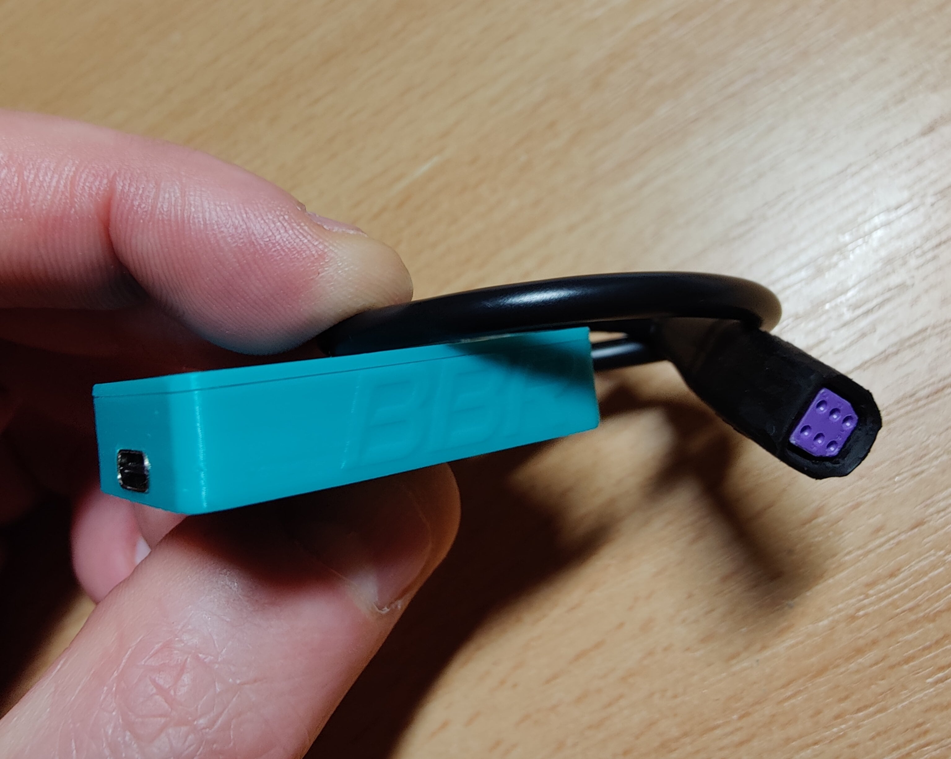

Very good question and u read my mind. Just working on this. New device which would trick battery. ;)
It is tricky, as all firmwares behave differently, which makes me some wrinkles. M510 FC1.0 with CAN battery - motor is switching from SOC 10% to power limitation (otherwise cca from 25%). M510 FC2.0 has without CAN battery limitation from 25% and firmw 10.1 even does not limiting with CAN batt, only after motor power off/on with battery under 25% - strange, would say some bug.
K1 BBR - Black Box Racing
- Low voltage cut-off can be set. With 3V per cell you can get 10% to 15% more capacity.
- You can avoid power limitation by cheating SOC %. Will freeze at 26% and then will jump just to 1% when battery empty. ;)
- You can have battery Voltage on your display - without decimals though.
- Some info under Battery Info: Voltage, Motor temperature, Controller temperature, Remaining capacity, charging cycles, Energy counter (auto reset at fully charged battery)
- SOC percentage will be OK when using 52V battery and 48V firmware. Or 48V batt and 43V firmw. (M510 FC2.0 peaking 830W then and u can feel it :) Saying OK as not easy to estimate SOC accurately just from voltage.

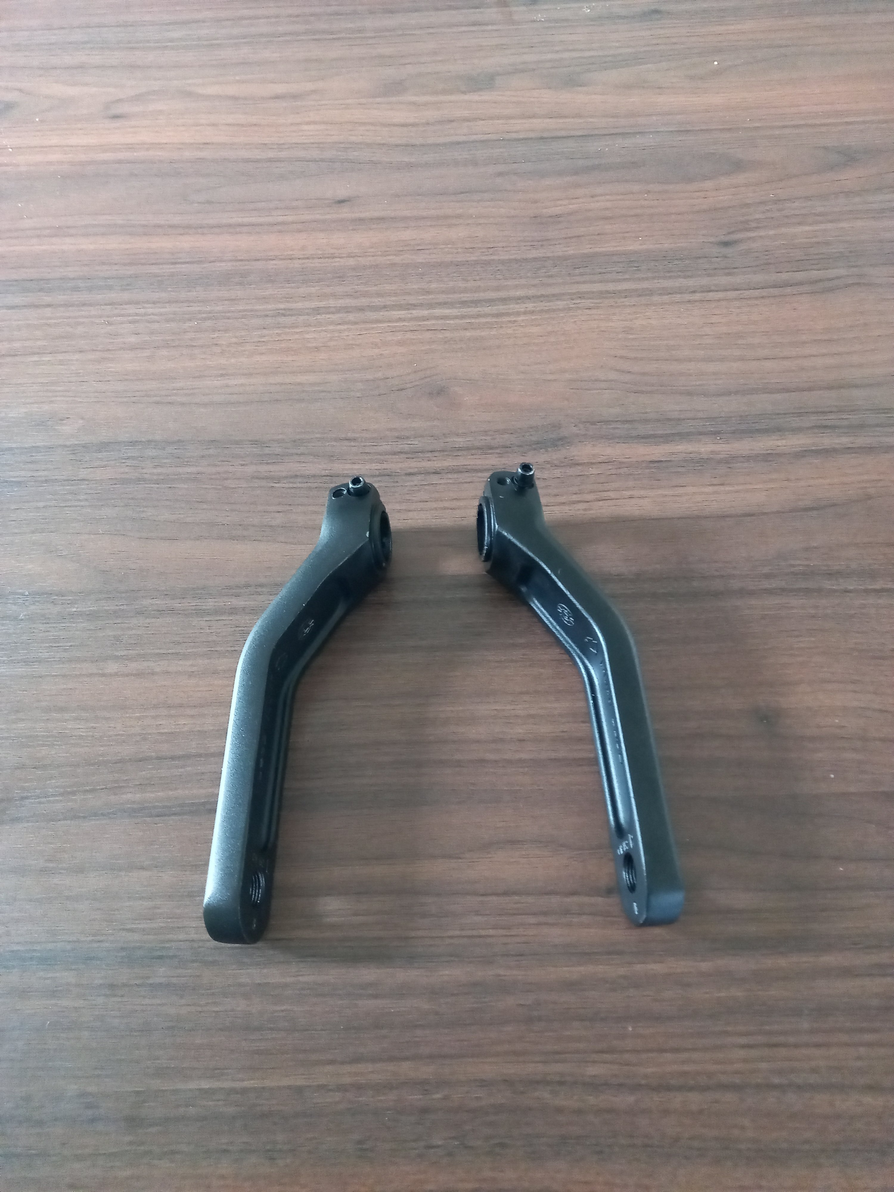

Can anyone please post a link to the schematics of the M560? I can't make out which Q-factor these cranks will actually result in.
The only thing I was able to find out, is that the total spindle length is apparently 154,8mm, total length of both cranks is 114mm, but I can't find out how deep the spindle is inserted into each crank (20-25mm?)
TIA!
TIA!

Thank you very much, I found them on ebay. They do look like having a similar offset (around 42mm) like the cranks from 4leaf.
Would you mind measuring the actual Q-factor, when the cranks are mounted on the motor? I would expect something around 225-230mm?
TIA!
Are there any normal (non-fat) short-ish aftermarket cranks with a higher offset than usual?
Miranda's Q16 will likely be to narrow for a fat bike, but Q35 (which aren't even available for the Bafang mount, AFAIK) likely has a lot of clearance, even for the fat bike chainstays.
TIA!
Is it confirmed, that most/all M560 are that loud?
I just received my fat the cranks are short 152 mins super and the weight of the fat ultra ultra-light I will soon post photos and the description of the fatbike-light

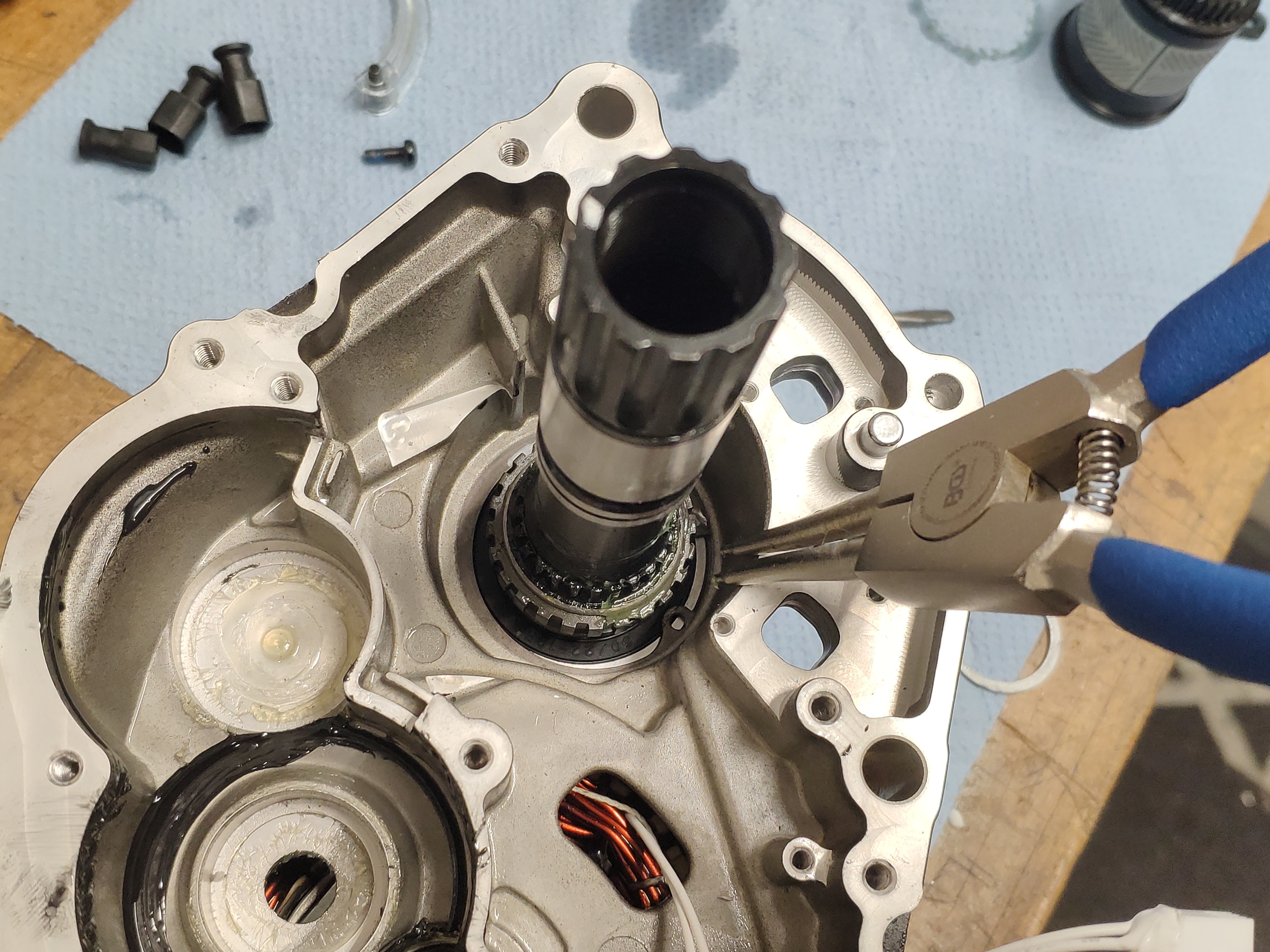

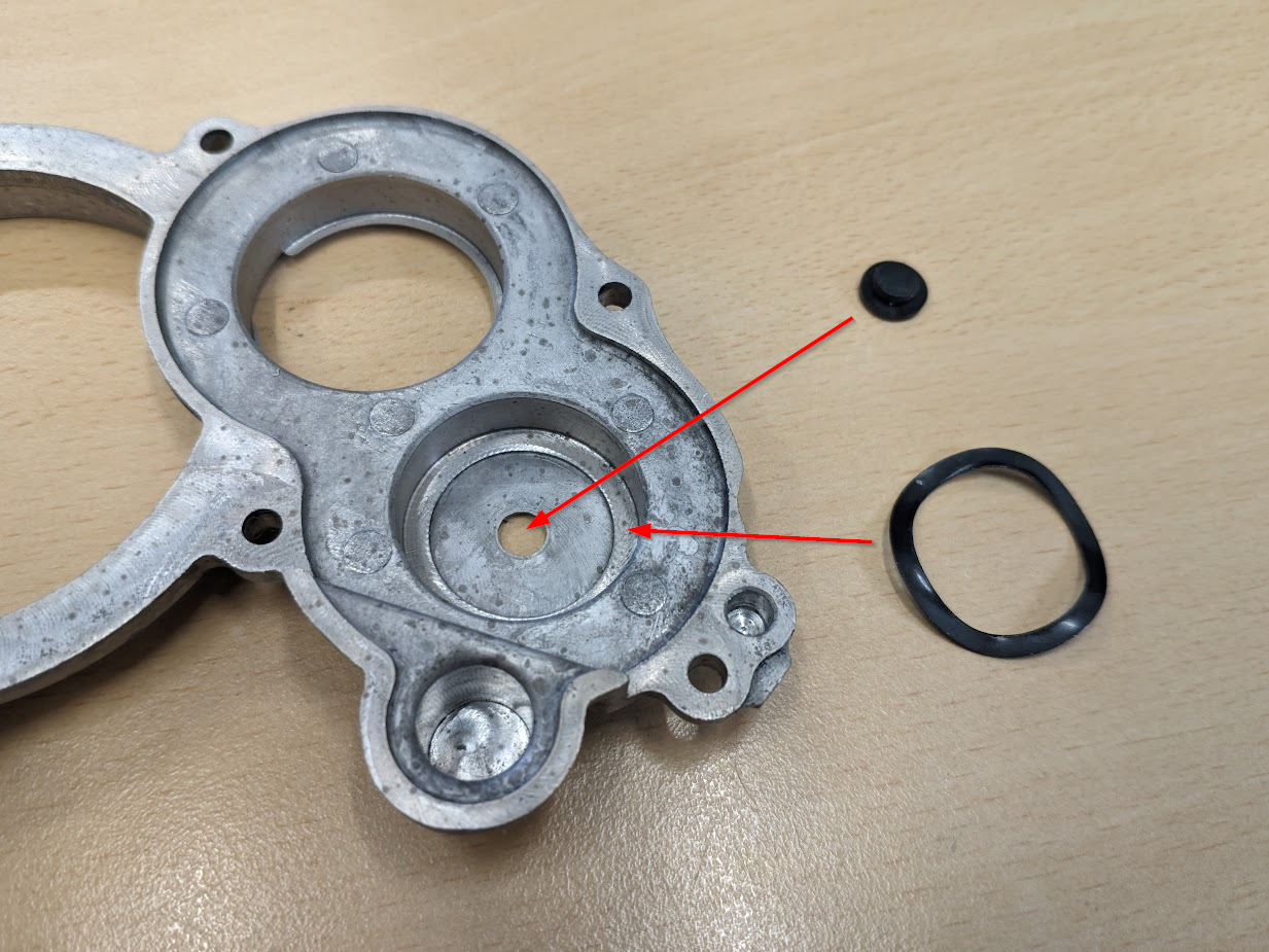

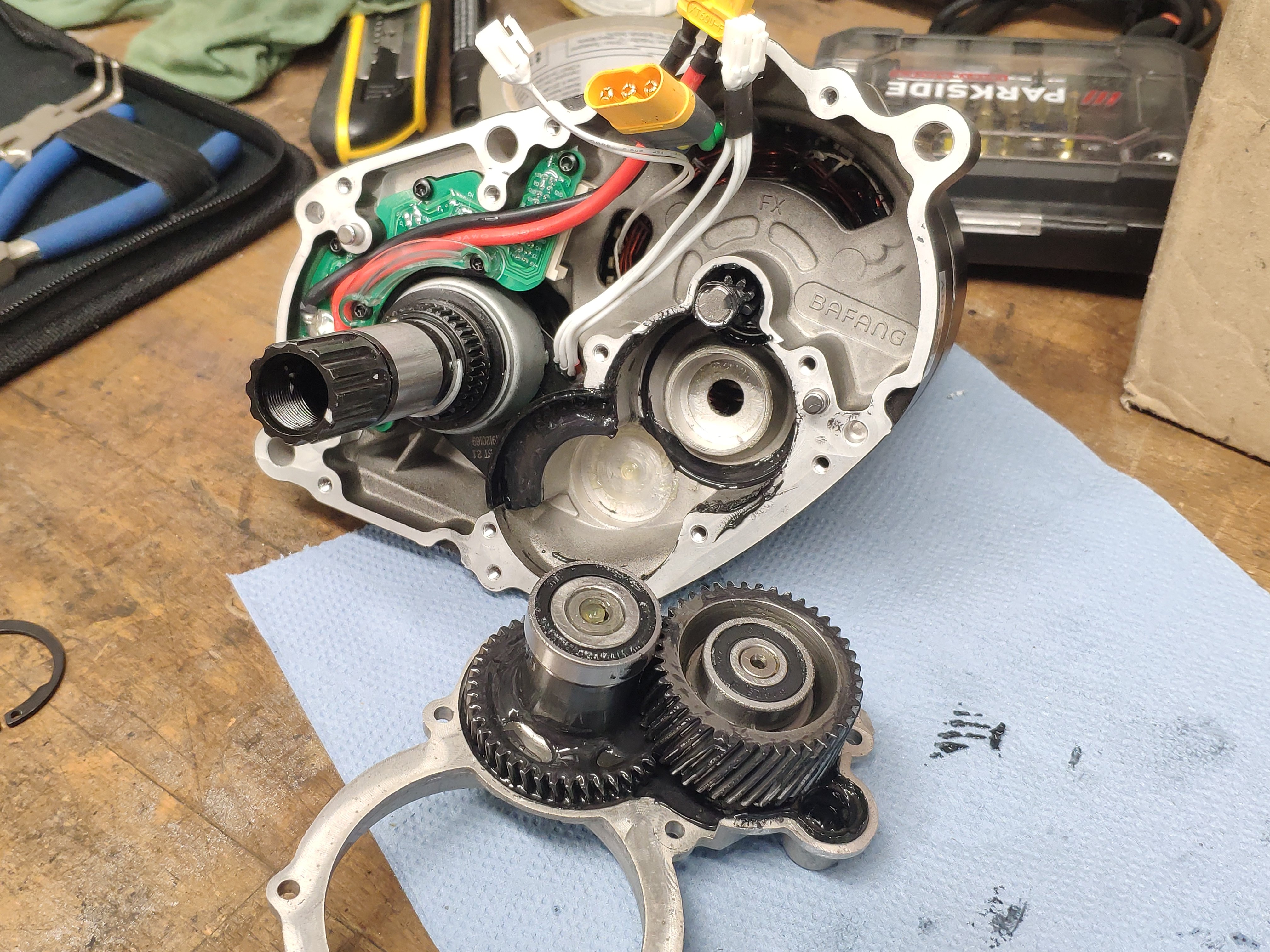

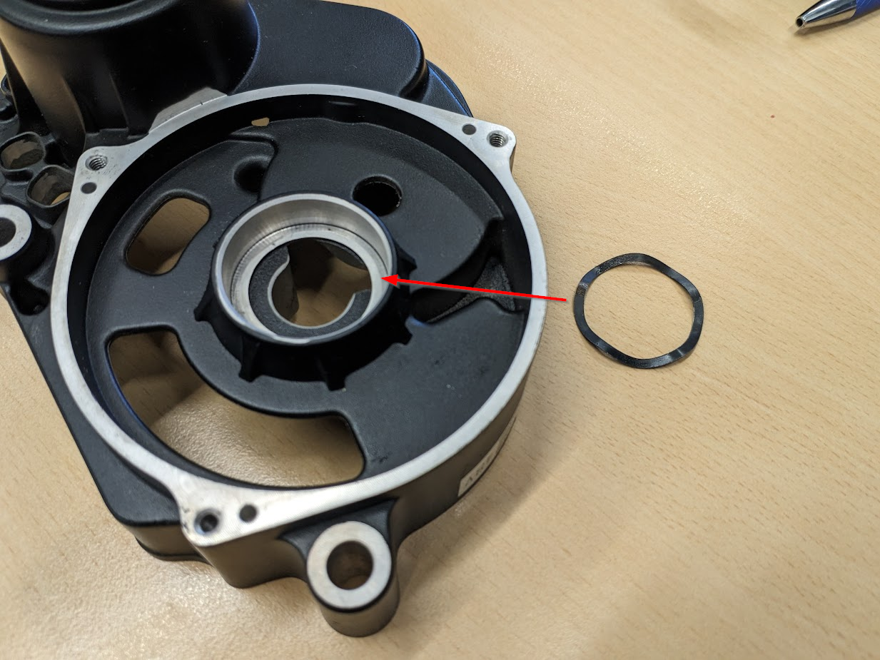

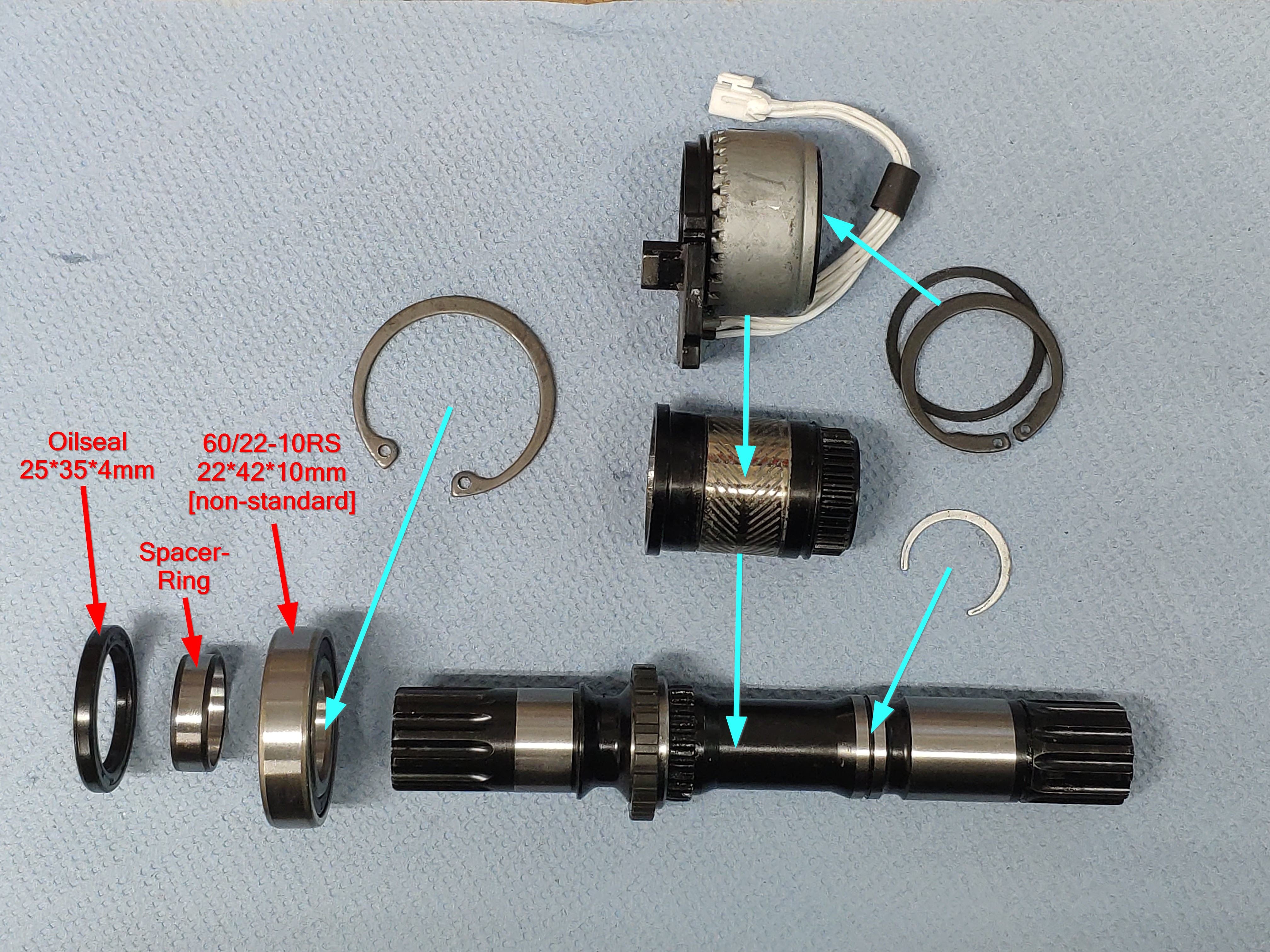

I was searching for better quality ball-bearings for my M560 and discovered, that "Silnt 60/22-10RS 22*42*10mm" is a non-standardized bearing and proprietary! If this bearing dies, there is no easy replacement! Should be identical for M510-motors.
El Topo
Jul 23, 2022
139
53
Germany, Bavaria
Looking forward to your findings. :)
I was searching for better quality ball-bearings for my M560 and discovered, that "Silnt 60/22-10RS 22*42*12mm" is a non-standardized bearing and proprietary! If this bearing dies, there is no easy replacement! Should be identical for M510-motors.
Is your own M560 as loud as the other engines, that are shown in this thread? I am still wondering, if I should roll the dice on the M560, instead of swapping the M510 to a M560 later.

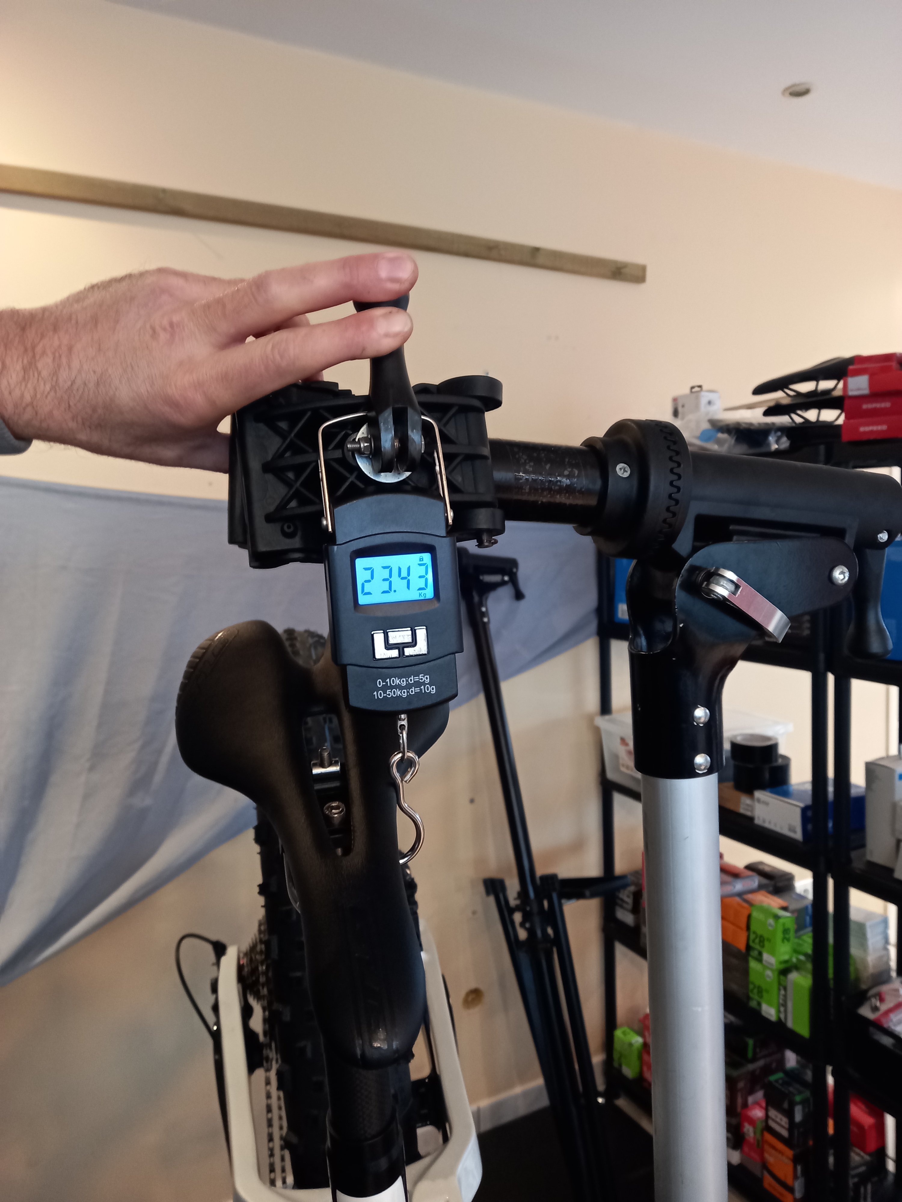

Today I just fitted the tires. I'm going to try the fat tomorrow
El Topo
Jul 23, 2022
139
53
Germany, Bavaria
Wow, that is light, thanks!
I think my heavier components won't weigh more than 3.5kg extra, that is still pretty light for a full suspension fat ebike. :)
The reason why I started disassembling it was, that I read about the noise levels. I did not ride that thing yet and took my brand new M560 appart and de-greased it in order to examine the gears and bearings closer. I'll order FAG/SKFs soon and replace them. The bearings on the M560 (mostlikely M510 aswell) are nearly identical to the ones on M600.
