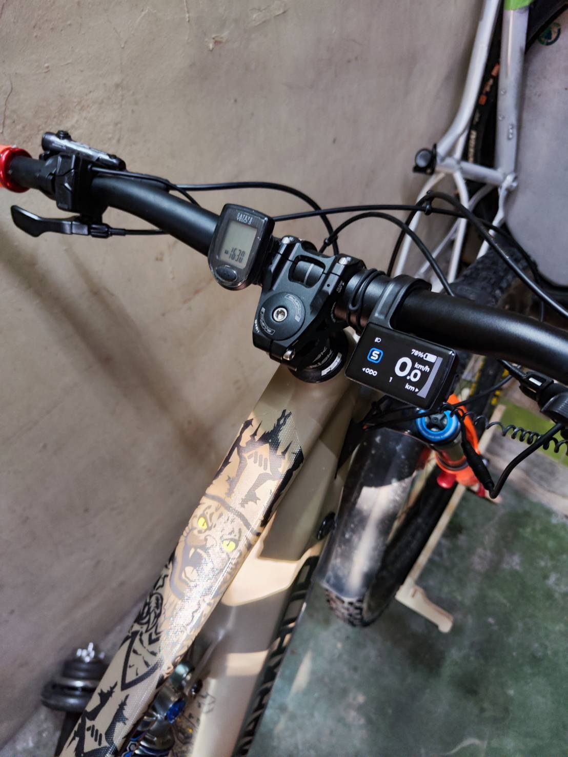

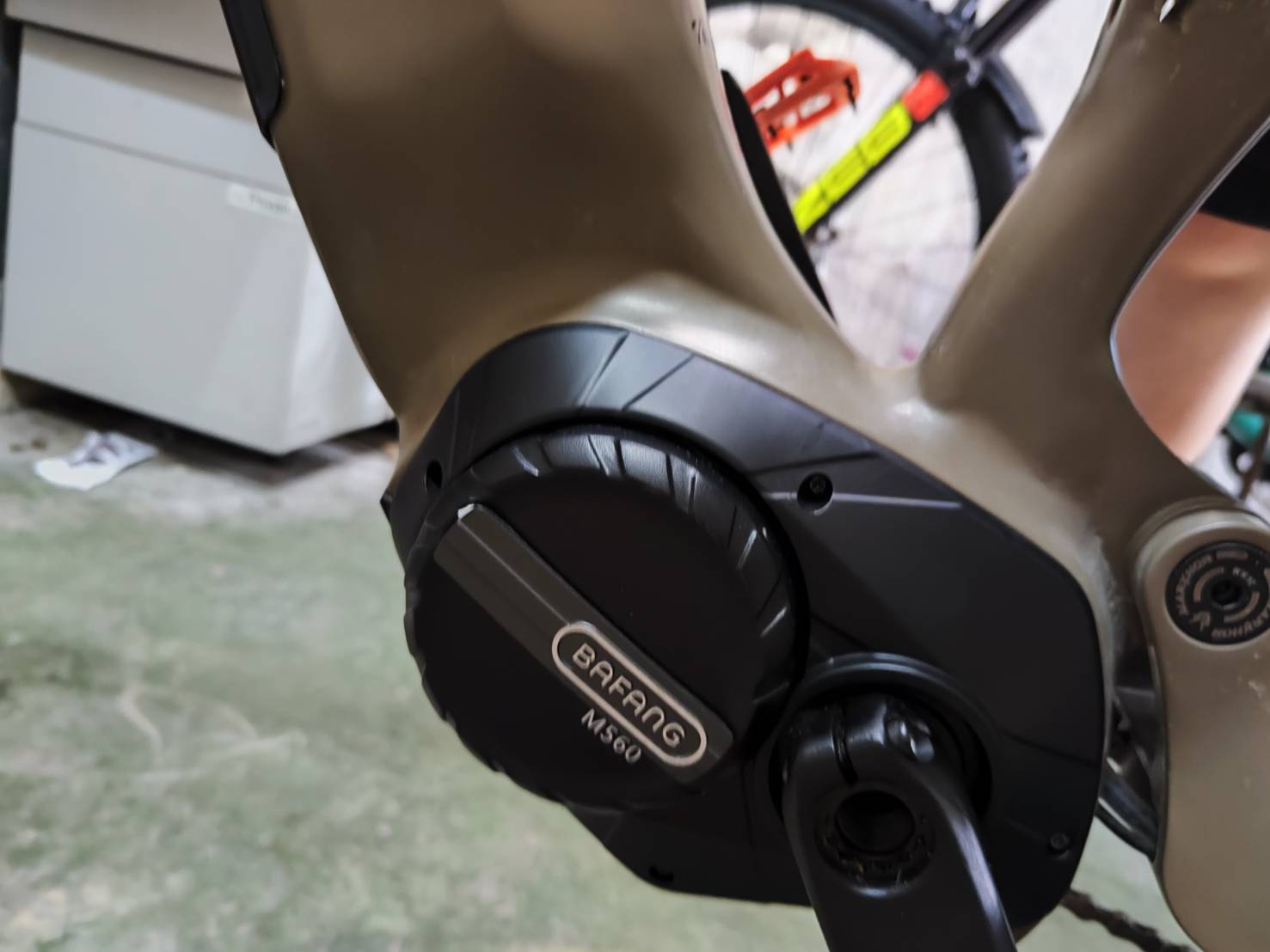

Tested the M560+245 on the mountain today
1. It’s true that the sound is obviously louder than the M600, but I don’t mind it too much.
2. It is much more powerful than the M600. The 3rd gear of the M560 is already approximately between the 4th and 5th gears of the M600.
3. The motor of M600 will stop immediately when the foot is stopped, but the motor of M560 will still move for 1~2 seconds after the foot is stopped. I think it is a bit dangerous.
4. 245 is still easy to see clearly in the sun
5. I don’t know if it’s an illusion or something, but my friends and I traveled the same distance in the same car. My friends used the M600, and I used the M560. At the end of the trip, they had about 20% of the battery, and I still had 35% of the battery.

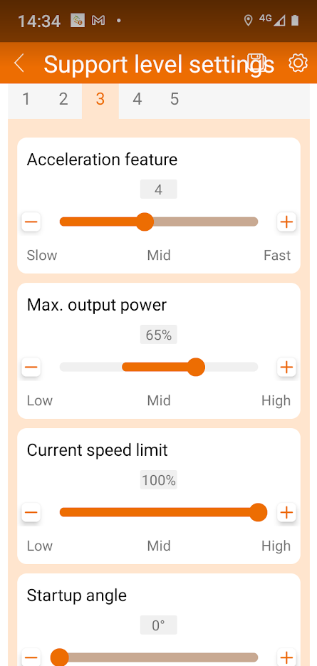

2. Cant be such an difference as motors have same peak power.
You maybe feeling it this way as in M560 is Support level parameter. And I guess on PAS3 is allowed max power 100% (same as on M510). So when you push into pedals (and no need even hard) you getting up to 1000W. I would definitelly set this power levels lower.
3. Delay after stop pedalliny - It is a bug and I dont understand how Bafang can not get rid of this. One firmware has longer delay, other does not. Getting sick of it.

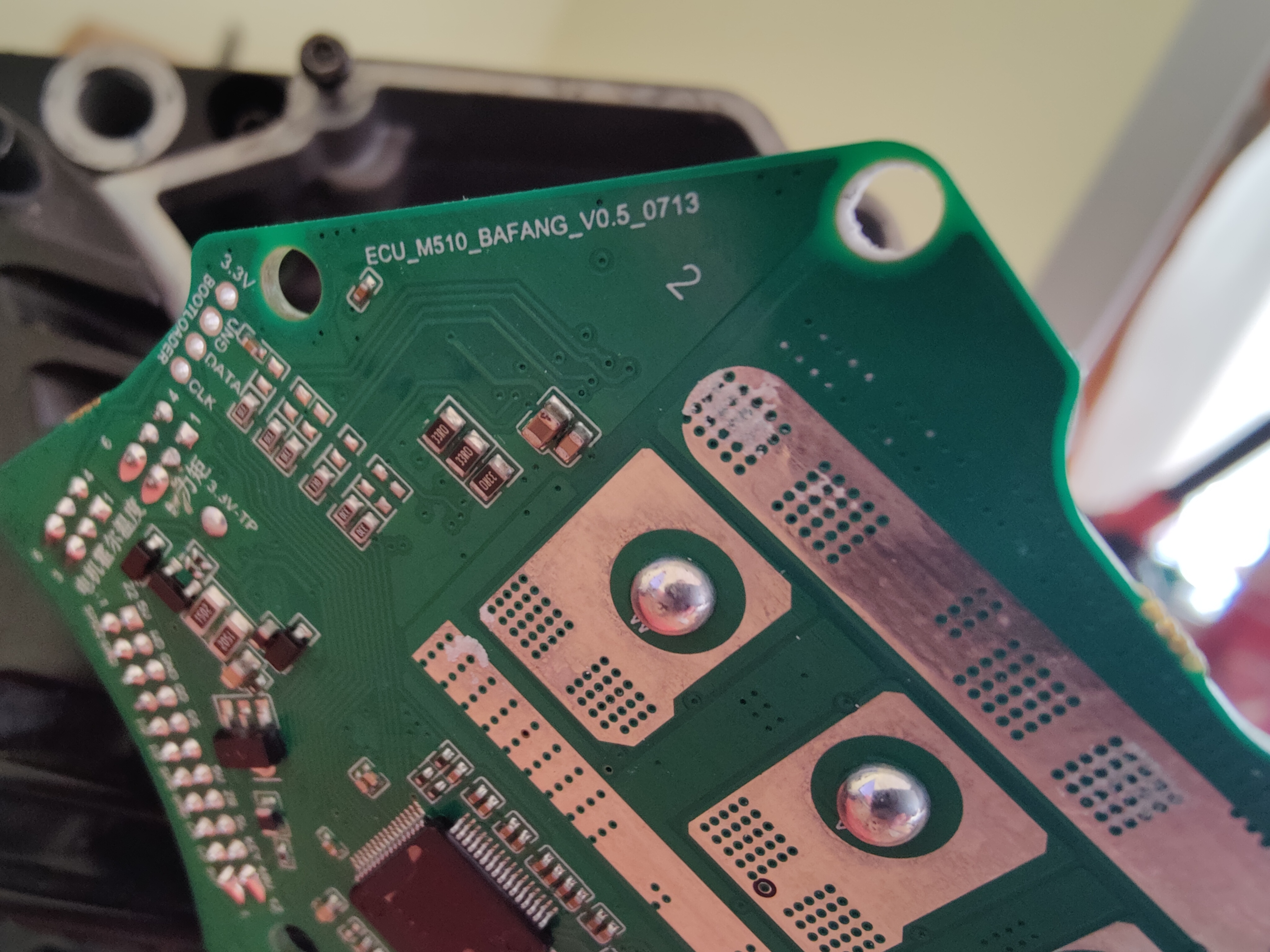

No update yet. It was loud and overheating.
Would be good if 500W version would use Nylon gear.
In next revision I am awaiting new controller - in first test batch there is M510 controller. ;)
And lets see if bafang manage to run it at 750W nominal. I guess temperature will raise to 100C quikly (it is 1200W peak)
Guys if anybody has some firmware for M560, please share. Have the beta test firmware v7.4 - 500W
Anybody tried to experment with bootloader? I see pins for onchip flashing in the picture. ;) Just we would need to have a bootloader file.
