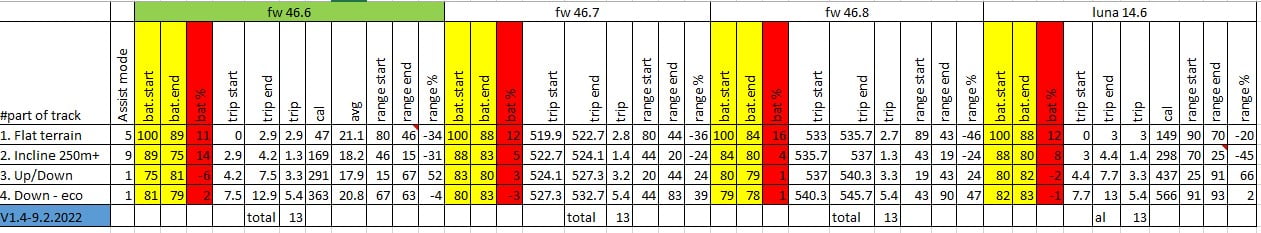

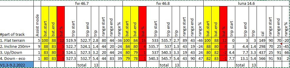

Here is my comparison with 46.6 fw (Mainly against Luna 14.6)
= more agressive ramp up/down , but not as violent as on 46.7
= stop after propelling in 1-2 seconds, which is OK. Depend on PAS level used.
= going uphill is more fun then Luna fw, but calories burned (at least value from computer) is less on Bafang fw.
I added calories burned and avg speed value, to compare for future tests as well.
Only downside i found on 46.6 fw is range calculation, which is varying a lot. looks like strongly depend on battery V/temperature and is not relevant. Recovery rate is much more then other fw. (luna, bafang 46.7+)
Luna fw looks like very eco oriented, good for people who want:
- use own "manpower" for propelling as high as possible
- for distance gaining
- for difficult terrain, where adhesion is more important than just pure power
myself i prefer 46.6 more to fit my style.
I will recompare with longer circuit to zero battery, but this need higher parts out of snow, so i must wait a bit.
Have you tried the 46.9?
In your opinion the L5 on 46.7 weaker than on 14.6 or stronger?
Anyone tested when power is starting to be reduced on 46.9? (its also 30% or different?)
