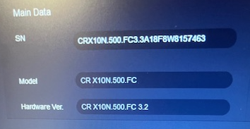

BESST Pro compatible 46.2 firmware found!
Here is the flashable 46.2 firmware that can be adjusted with BESST Pro 😎 Have fun!
Be aware, all "Max. Power" levels are on 100% by default! You need to adjust them yourself!
Please report any issues, you might encounter with this firmware, in this thread!
It looks like M600 48V firmware, doesn't it? Anything interesting for M510?

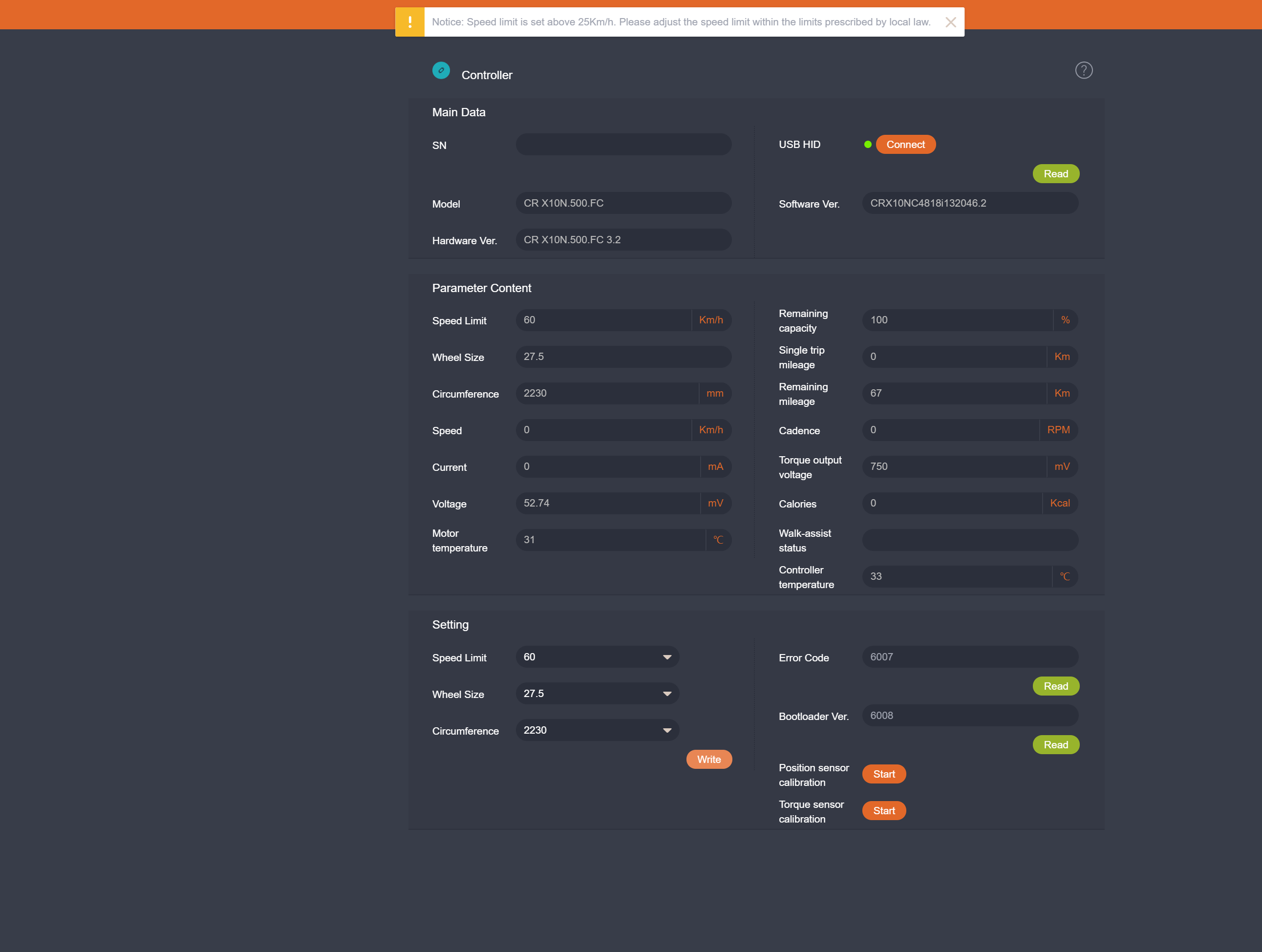

Here is the flashable M600 48V 46.2 firmware that can be adjusted with BESST Pro 😎 Have fun!
CRX10NC4818i132046.2

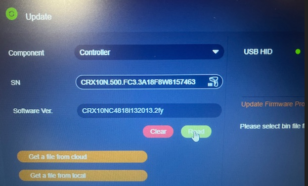

Thx almos there ...... any idea ?
boom boom
Oct 20, 2023
25
pattaya

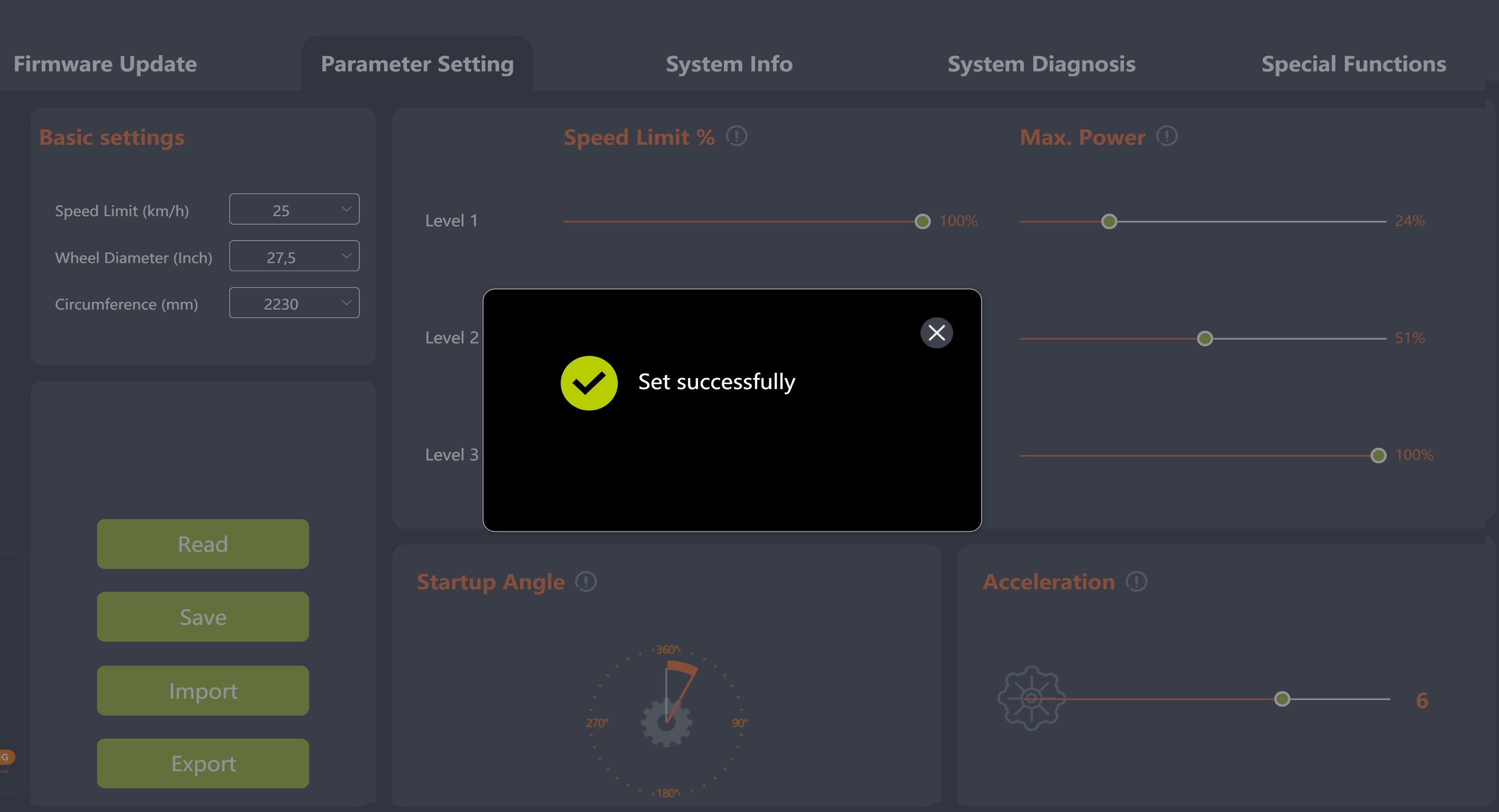

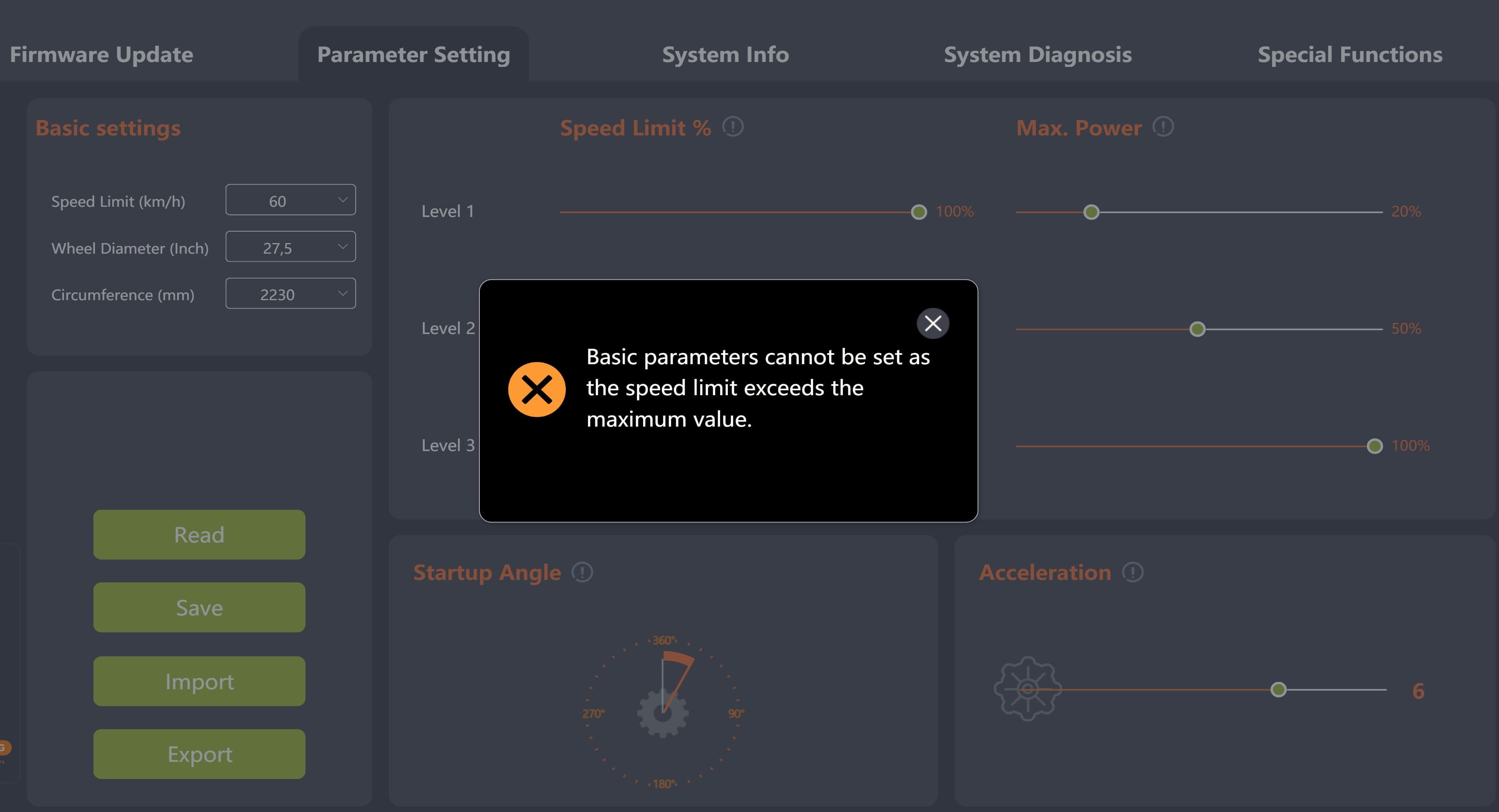

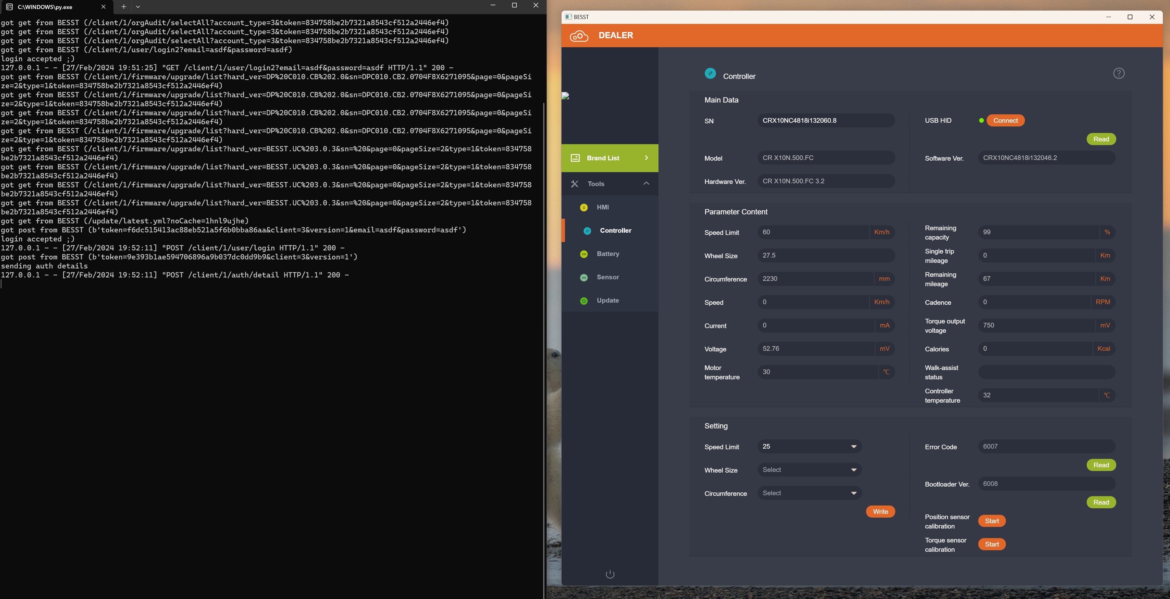

Ok found the answer on a other post . That s work .
But a hell of work .
Have to do the twice on different Besst. Set speed to below 27 and adjust parameters on Pro. Exit and proceed to old beest to raised speed. Its PITA but thats the only possible at the moment. Unless you have a superuser account login.

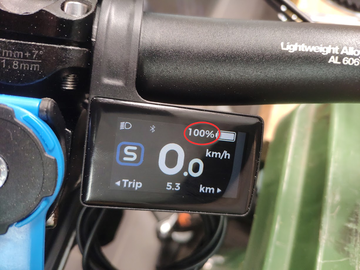

Ok so i test today this firmware and no it s not working .
The first 2 or 3 second on level 1 i go up to 500 watt then after that i m lock to the power i put (for me 150 watt ) .
The target is too always be lock at the power we set up .
On the paper this firmware was amazing but on the reallity is not working for me .

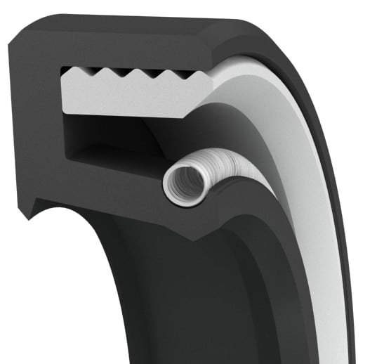

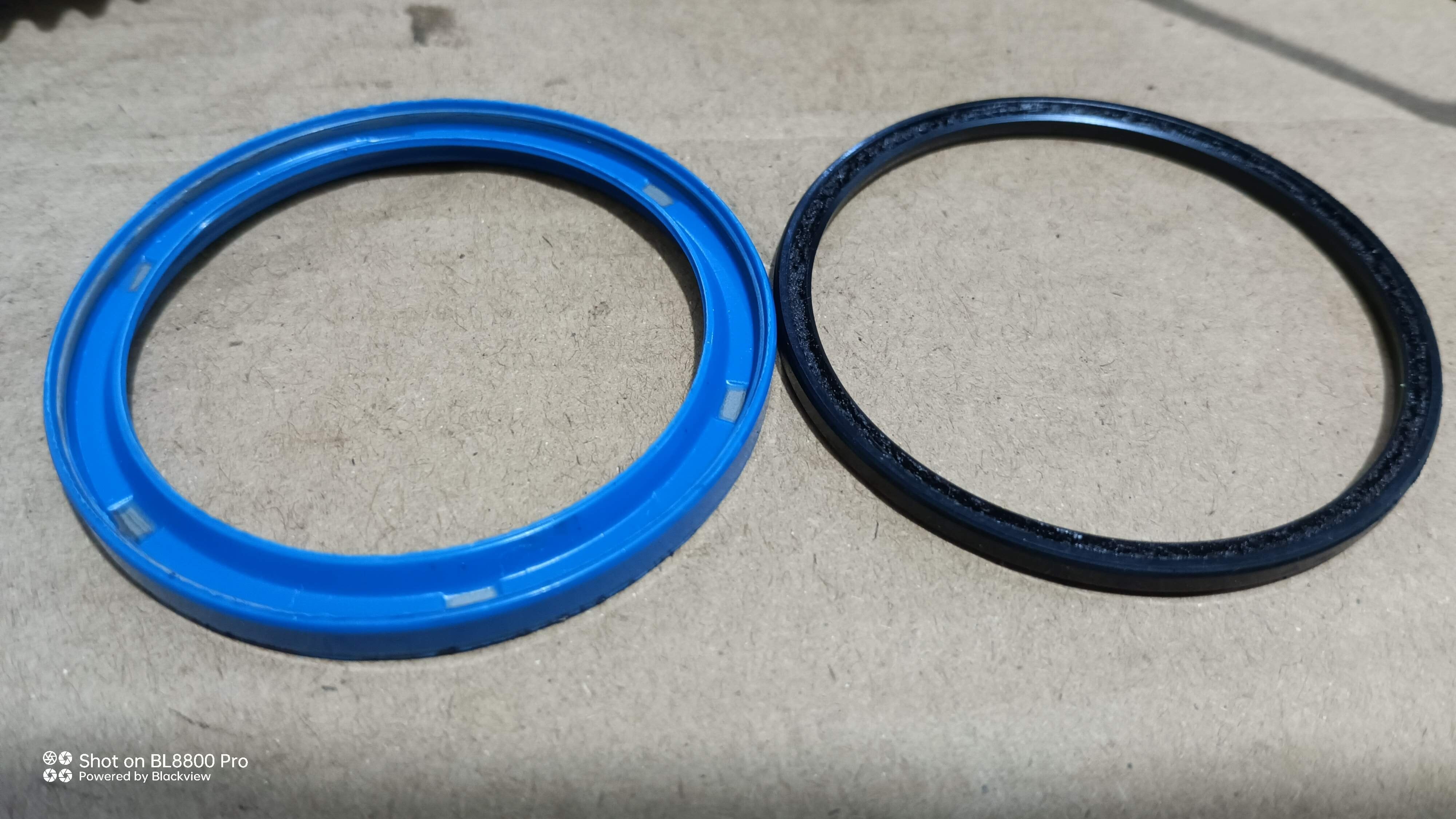

I've just pulled my M600 engine down and largely for the really harsh environment of the UK winters where I'm riding in wet, muddy, sandy, rock strewn conditions for possibly 6 months of the year, for the 3K kilometres its done, the motor has really only the drive side which is totally trashed ( water ingession into the main bearings and sprag bearing on that side ). All the other bearings and seals are just fair wear and tear and without any water ingression.
So that means that principally its the one seal area which is posing the problem.
The poster you mentions seems to have increased the overall size of the problem seal by machining the cover to take the larger seal. But if we look at that from an engineering perspective, the inner section which is the mating interface that does the job of keeping water and grit out, is no different in size and remaining a single lip seal. Sure the larger seal will offer a more flexiable and slightly larger surface area. When it comes to water ingression, that will not make much difference ( I suspect a lot of the water ingression is caused by heat expanding the inner air volume forcing air out, only to pull moisture laden air and any pooling water back in when cooling ).
Most agricultural machines use what are called a double lip shaft seal ( as a primary easily changed sacrificial seal ), which not only has an outer running surface, but also a spring tensioned inner wider lip to take up any bearing movement from shock loadings and keep a longer term tension on the mating faces. Bare in mind that the main bearing also has a 2RS seal which should also keeps both water and grit out.
The downside of using these are surface friction which you all hate, as that means you are going to have to pedal harder in a non motored situation. But my view is that when you have 800W's of electrical power to play with, the probably only 3-5 W's of friction that seal would add, would save all the hassles of water ingression and by consequence, early worn out and damaged bearings.
Mmmm I may have a look later and see what can be done, but do consider that if I get 2K km out of a motor then I'm pretty happy, will the time to mod the motor be worth it ?
As a slight update there is a 7mm wide ( the Bafang seal is 3mm ) double lip seal available.

You have a display with BT. But not sure now if somebody was able to connect to Go+ over this display.
DPC245 v3 works. With older Go+ app. With latest app it is giving you error if you wanna set motor parameters.
Anyway, your motor does not support any powwer setup. It is all hardcoded. You can change only Speed limit, Wheel size and Circumference.
