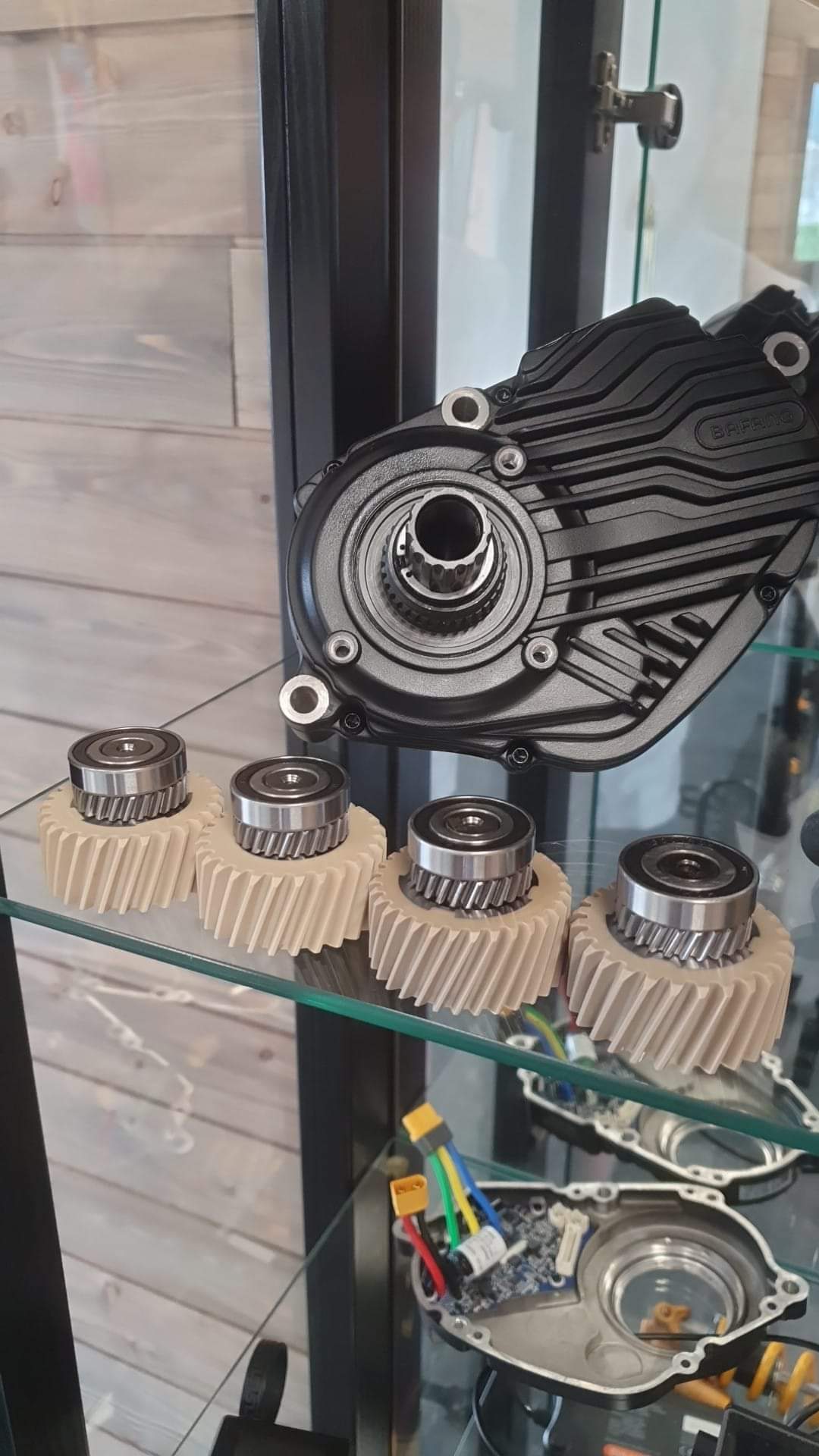

Oh no! After 2000km is my M500's nylon gear broken again :(
I'm missing two tooths again...
The really bad news is that I'm not able to find a store where to buy a new one... Everywhere is out of stock... (32teeth)
I wonder what is the Bafang's spare parts politics... Do they care about "old" model motors??
This is really frustrating.

This one is not good? Bafang M600 G521 Nylon gear with bearings for replacement-GreenBikeKit BBS, ebike batteries, Bafang M620, Bafang M600, Bafang M500, Bafang M510, KT controller with display-GreenBikeKit.com Does the higher temperature destroy the transmission? I noticed that with this FW there are also high A's with high support. You have to work with it carefully. How many teeth does he have? 27 teeth are common on aliexpress

no, that one has 27 teeth , I need 32 teeth :(
I would not say that it was due to high temp... I'm trying to avoid high temp and let the motor cool down when it is getting too hot. Maybe I was to rought.. rough terain, some jumps etc.. :(
I understand that something might break, and it is probably my fault, but I whould like to have possibility to buy a spare part when needed...
I hope that Bafang will be still producing 32teeth gears, otherwise I can throw the motor into trash... and that is a bad signal about Bafang support... :(

It should not break that easy.
I had nylon in M600, been riding it hard, still full throttle and nothing happend.

Do you know if it is possible -if it fits, to buy a M600 rotor+stator and mount it on M500?

You just need new nylon gear and new stator, to match the teeths.
I just checked mine gear (M500 from 2021 and it have 32 teeths).
Personaly its first i heard there was 'later' version of M500 with same gear as for M600.
M600 stator will not fit. Its too long. You need to look for 'new M500' stator.
Try to contact Bafang directly and buy the 'new set of stator+new gear' or few nylon 32th gears.
Here is the set with old 32th gear. You may write them only for gear that you need.
I did not know about the 'later' version of M500 either. I got to know from this description :
Funny is that M510 has also 32 teeth... so no spare parts either for M510

Thats pity the Bafang cant provide basic spare parts.
This nylon gear is not even a spare part, its maintenance part, like an air filter in car.
It will break soon or later.
