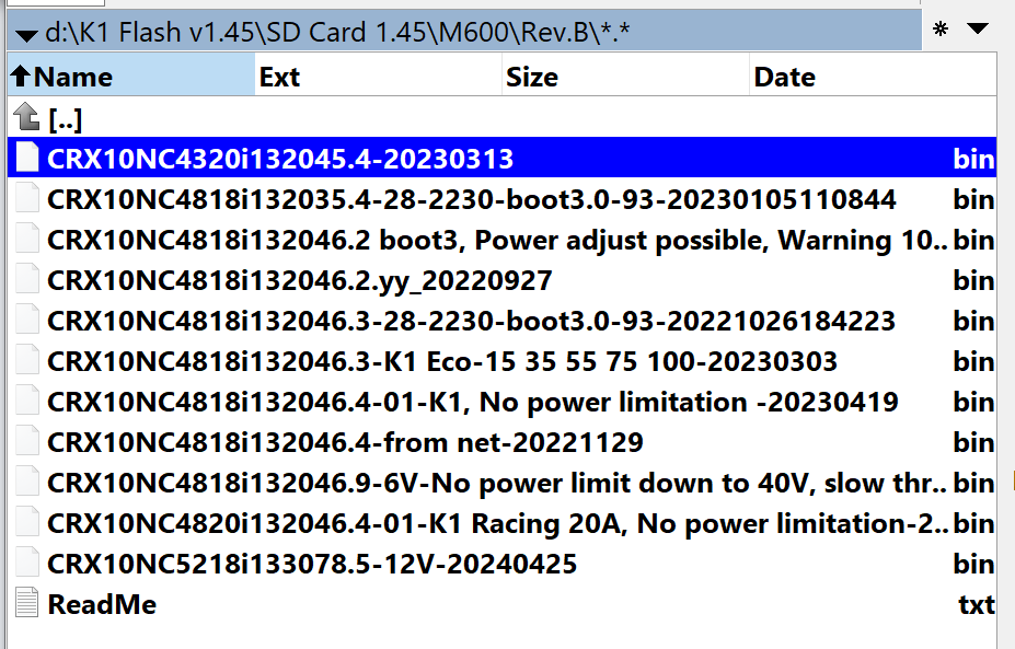

Hi, have an issue with battery range after changing firmware.
I have M600 motor, 43V battery, C245 display that connects to Go+ app.
Just updated the firmware to: CRX10NC4818i132014.6-20191126
I charged the battery to full and connected it to bike, display read 60% and dropped to 20% in about 5 miles and cut back assist and so forth.
Could this be a problem because I uploaded 48V firmware to a bike with 43V battery?
If so, is this correctable in BESST? Thought I would ask before adjusting anything.
Dado
Jun 28, 2022
739
501
Bratislava
Hello. You can upload 48V firmware but then of course would show wrong SOC as you writing with 43V battery.
Go with 43V firmware. You wont get anything with 48V firmware and 43V battery, just less power (as 48V firmware has less max. power)
Put there attached 43V firmware. One is for oldM600, one for new.
  • CRX10NC4320i132045.7-28-2230-20200115.bin
  • CRX10NC4320i132045.4-20230313.bin
YZDude
Aug 28, 2022
42
33
Eagan, MN USA
Thanks for providing these.
I did load 45.7 back in, is that for ‘new’ 600? That one has the bike taking off like a rocket, a bit too fast for trails here. I can try 45.4 if that might be more calm.
Also, not sure if I can tune better with Go plus app, it seems a little difficult to work with.
Dado
Jun 28, 2022
739
501
Bratislava
Only one u will be able to load into your controller. And no, M600 does not have any possibility to tune. Just to set speed limit, wheel size and circumference.

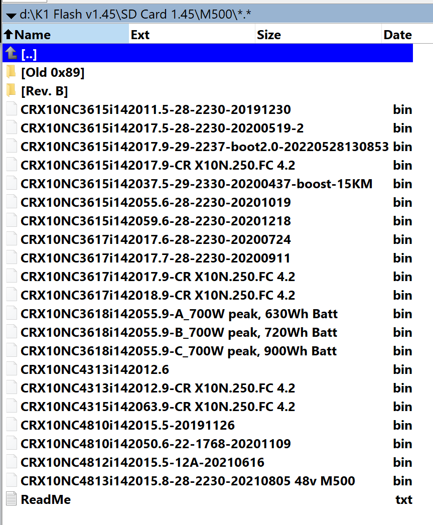

Hello, does anyone know where I can get this firmware for the Bafang M500? CRX10NC3617i142018.9
It's the one I have as standard on my bike but I want to have a backup. Thanks and regards!
Dado
Jun 28, 2022
739
501
Bratislava
It is here. ;)
Did you find some bug or some strange behaviour with this firmware? What about overrun?
  • CRX10NC3617i142018.9-CR X10N.250.FC 4.2.bin

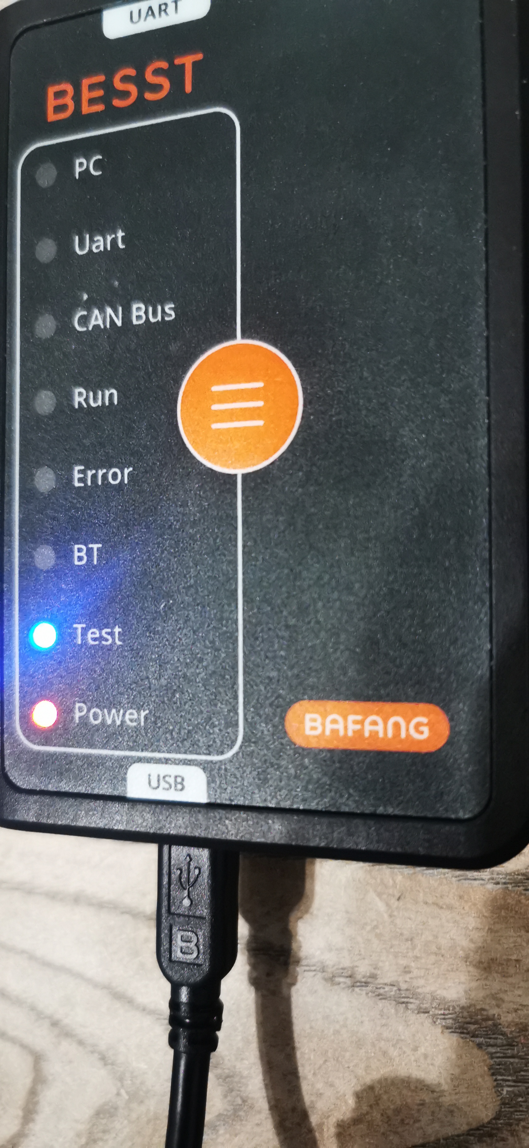

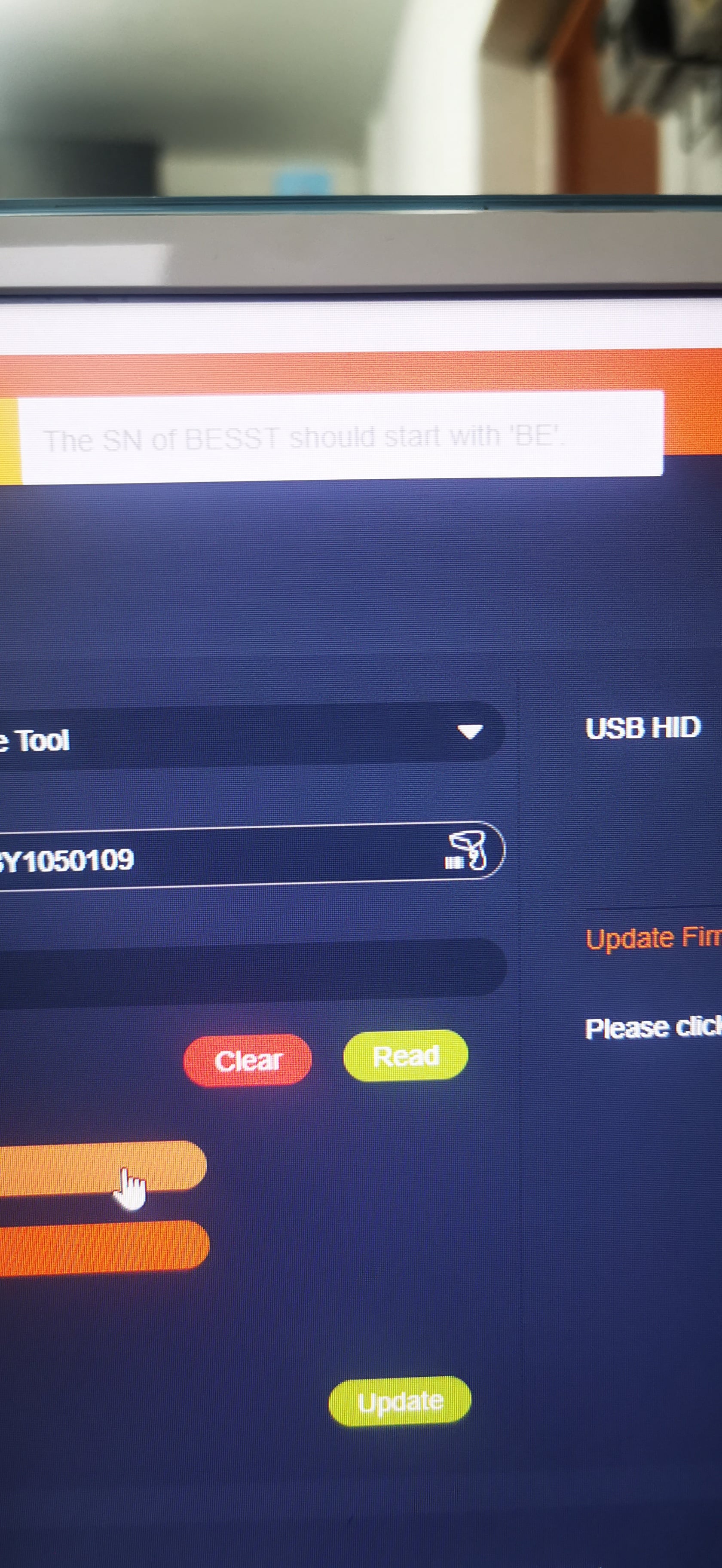

Hello, during today's update of the Besst Tool programmer, the process did not complete successfully. I need the firmware for this device because the cloud displays an error message about an incorrect serial number. Maybe someone from the group can help me with a .BIN file?
Dado
Jun 28, 2022
739
501
Bratislava
So your Besst is now bricked?
Dado
Jun 28, 2022
739
501
Bratislava
Never updated Besst firmware. Not sure if is good idea. ;)
But word "zepsuty" is great. Rozumiem ti, som slovak. :)
