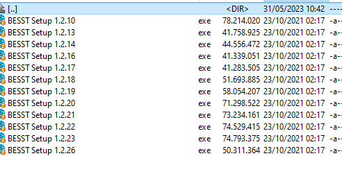

Hey guys,
I tried to change the max speed limit from 25kmh to 32kmh in BESST, but I recieve the notification:
"Notice: Speed limit is set above 25Km/h. Please adjust the speed limit within the limits prescribed by local law."
I am using the account that was provided by the motor seler. My understanding is, that that acount is not permeted to change it above 25kmh. What can I do about it? If I use python script to logon, will it work then?
temon10
Feb 8, 2022
677
567
Malang, Indonesia
Hey guys,
use old besst software version, will work.

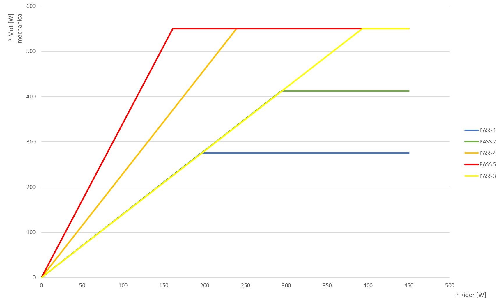

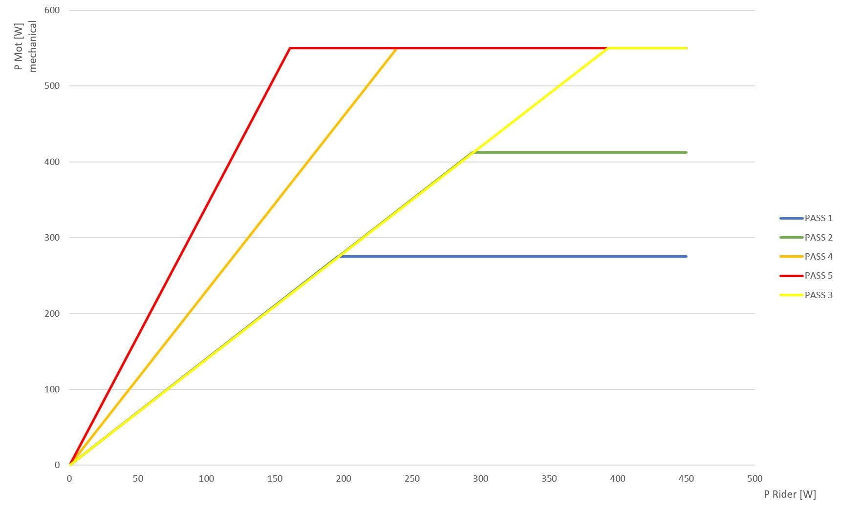

This can help you to figure it out.
Support level is incline of characteristics (aka human power multiplication), max current is max current. :)
This is default settings for M510. PAS 1 to 3 : 140%, PAS4: 230%, PAS5: 340%
PAS1 max current 50%, PAS2 75% , PAS 3,4,5: 100%
dvng
May 21, 2021
106
44
Malaysia
I believe there should be a better way of explaining this. The curves does nothing to me
Dado
Jun 28, 2022
725
487
Bratislava
Mate, thats your problem you can not read the graph! Nothing complicated, even basic school student would understand. On x is leg input power, on y is motor output power. I have tried to help...
And if you not ok with "human power multiplication", you would need to write to Bosch for explanation, as they using this term also!
