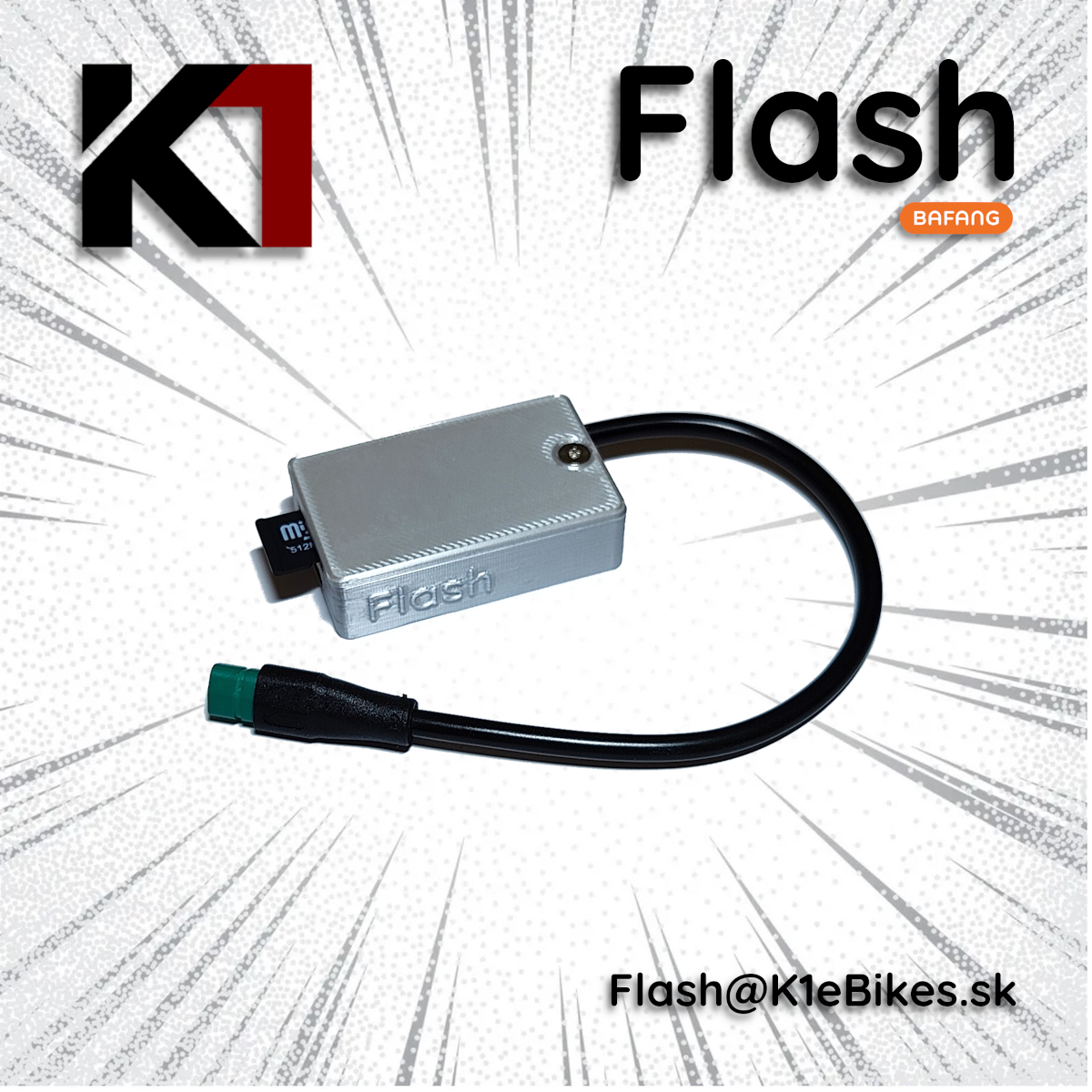

Hello guys.
A quick preview. Working on simple firmware flasher, you can flash firmware just by plugging in motor and inserting SD card.
More details here:
