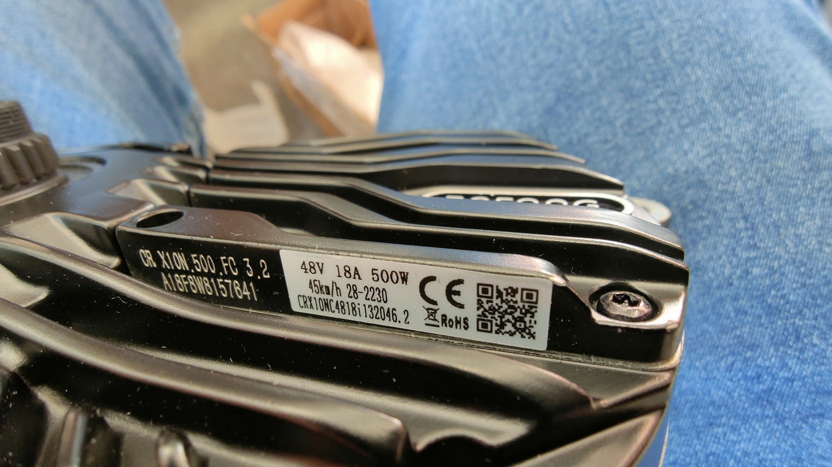

Does anyone have any idea why I can't install any other software to my m600?
I have the factory software version 46.2
CRX10NC4818i132046.2
There is no possibility to adjust the power on each level there.
I want to install different soft but it is the same every time. Aoft is sent is BESST TOOL (one beep), I disconnect and reconnect the cable from the controller, then nothing happens. Installation to the controller does not start.
Everything else works, I can read and change parameters.
I'm using software version 1.2.23 and 1.2.18, and it's the same on both.
The exact version of my m600 as in the attached photo

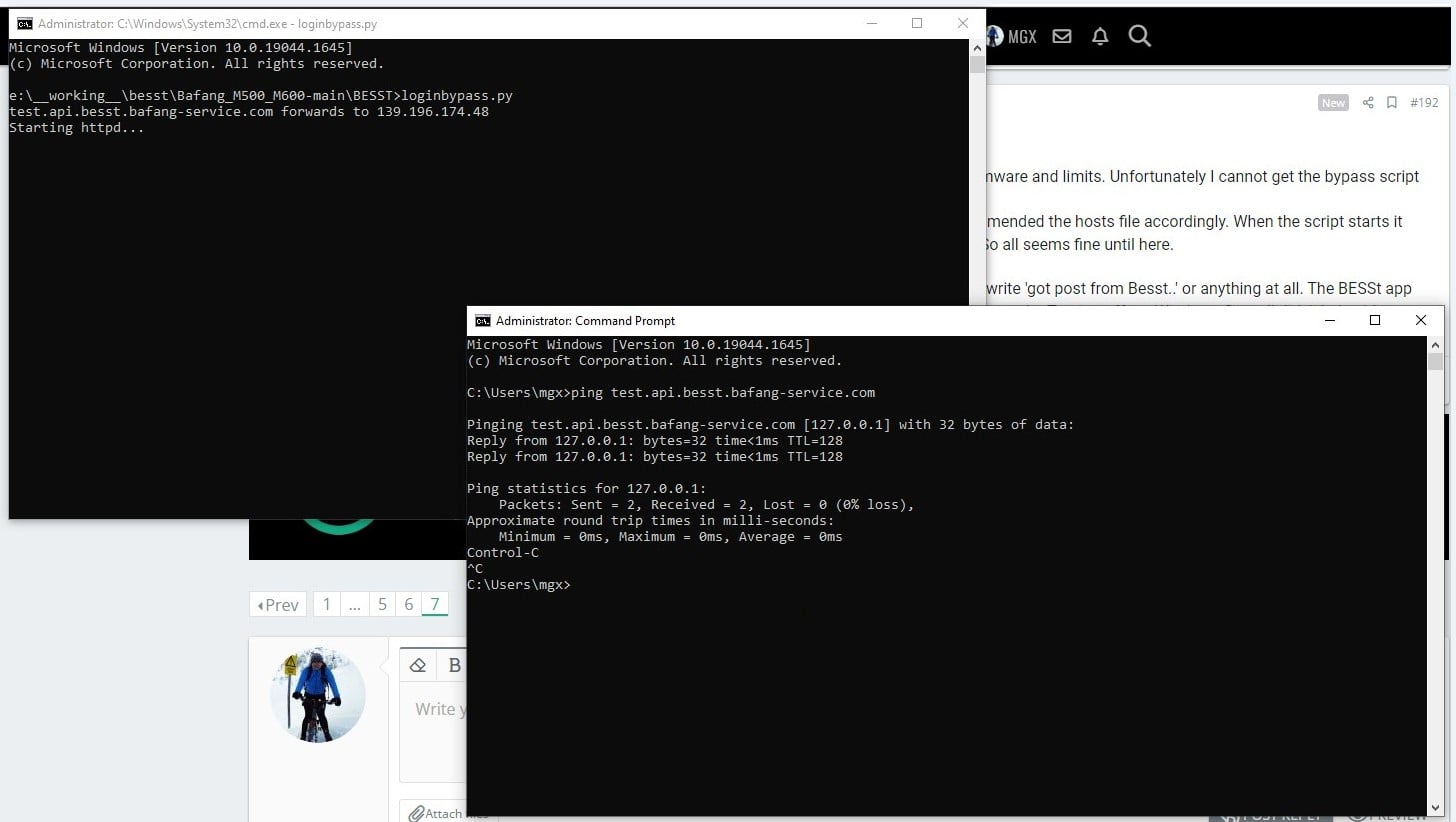

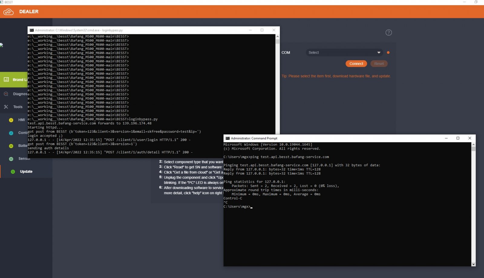

First check if your python script is running and not showing any module errors. if yes, you need to fix them. start python from cmd.exe
-> see check_begin
then launch beest, enter random login/pass
in python there is auth.logs visible.
share them
Hi do you have a link for the python the link in here comes up not found

Thanks mate but when I go to the login password py it won't let me down load it
I just copy data and paste into text file, then save it as loginbypass.txt and then change file extension from .txt to .py
Unfortunately it is not allowed to attach python scripts here

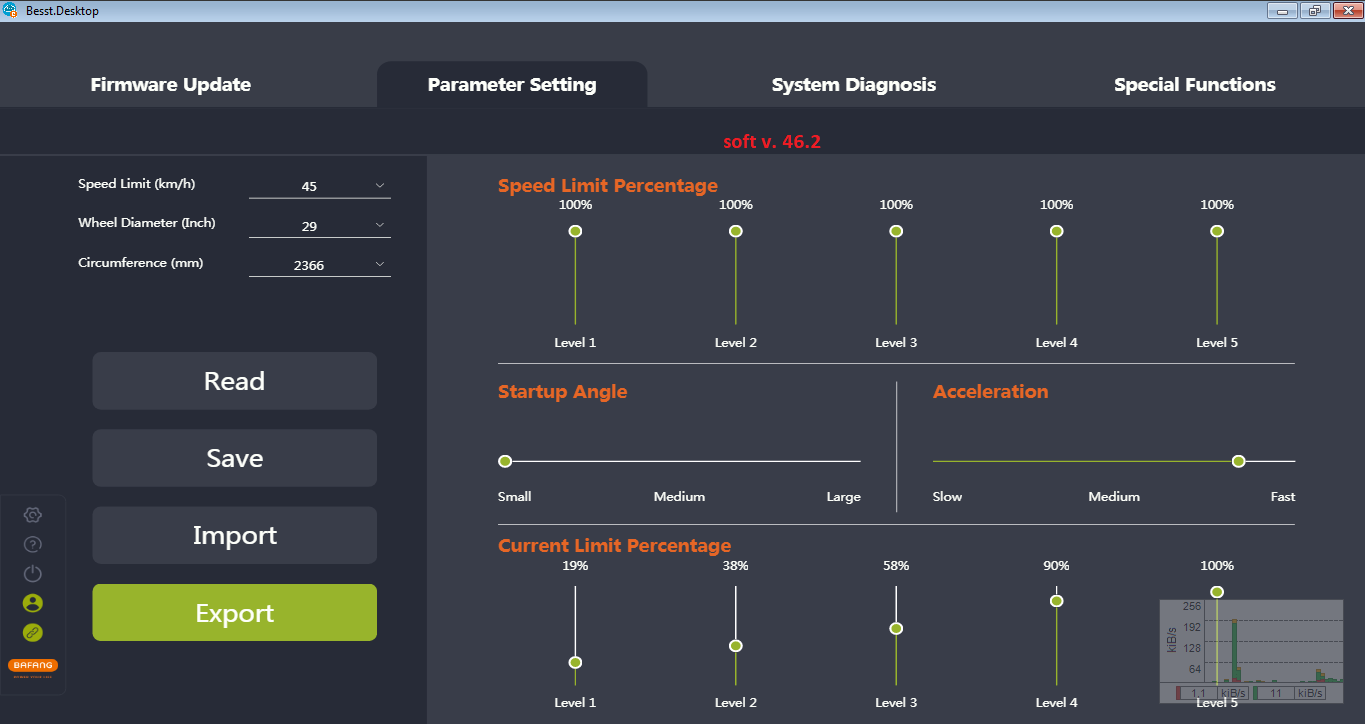

I was able to connect to my m600 version 46.2.
You can indeed adjust the current limit percentage in this software. Unfortunately, this does not solve the problem of hopelessness of this engine. They compare this engine to the bosch it works tragically. It doesn't have enough reactions to my leg strength. m600 works like my first old e-bike only with PAS sensor.
Example, I'm riding on lev1, I have a constant 120W when riding evenly, all of a sudden I push with all my force on the pedals and I still have 120W. It works badly and has no responsiveness. Until there is a software with access to the control "cycling parameter" and "support relation" this engine makes no sense and sets development back several years.

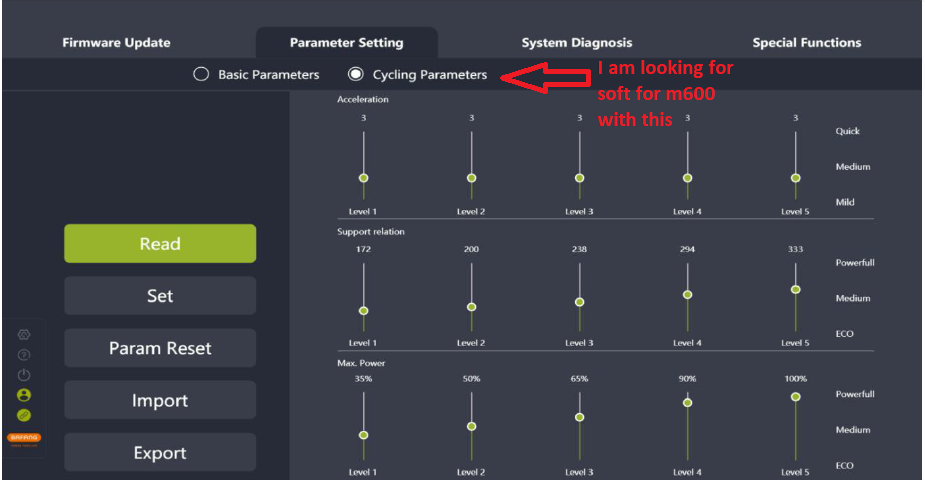

Do you know of any more soft versions under the new hardware? Currently known is 46.2 and 46.3 Is there anything else?
46.3 I tested and in this version you can not change any parameters.
View attachment 109764 View attachment 109765
U can only change the basic parameter. I have 46.2 controller and it works. But indeed this M600 not as good as M510 FC 2.0 that is so responsive to our leg pressure and all parameter can be tuned.
