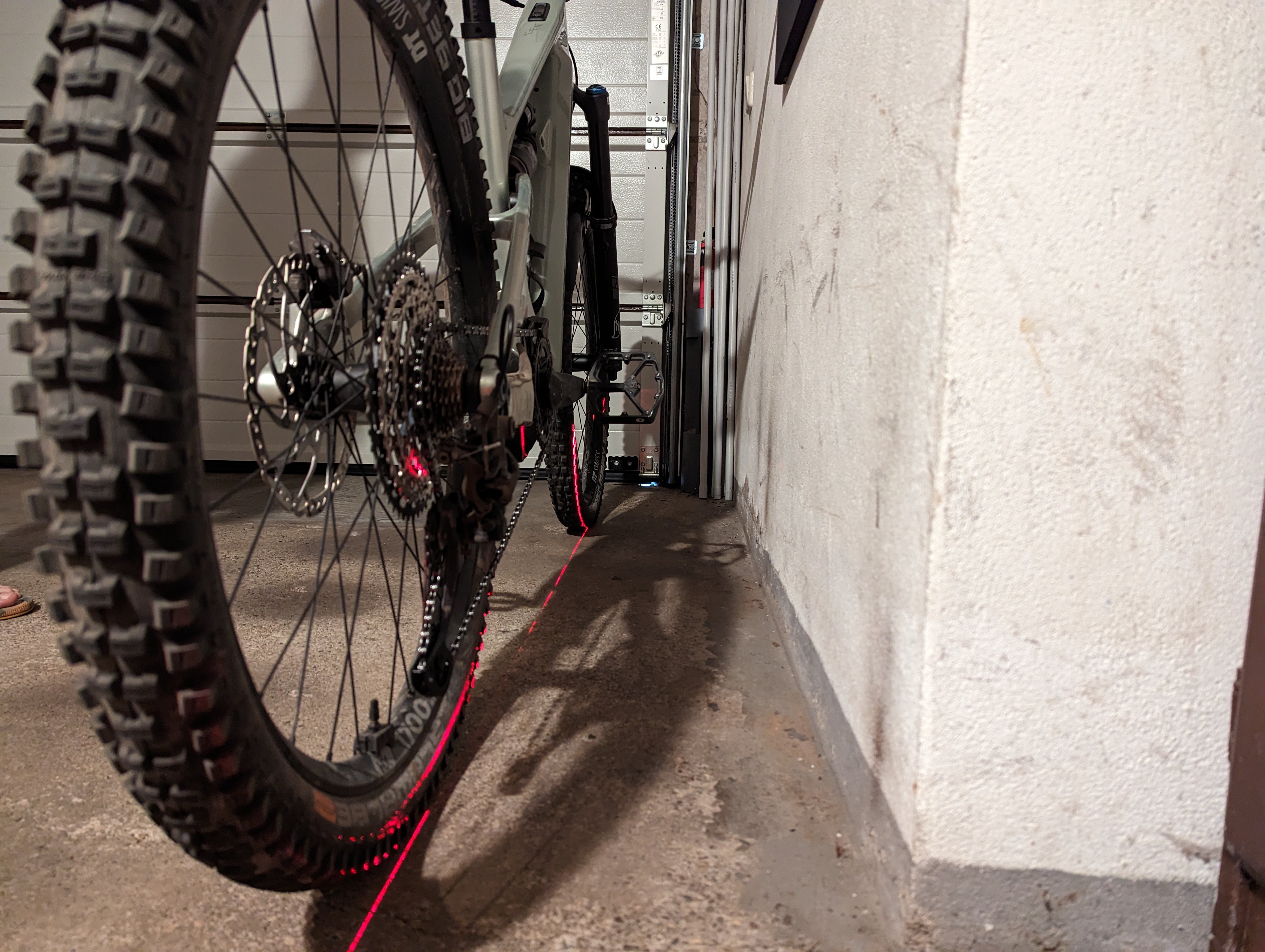

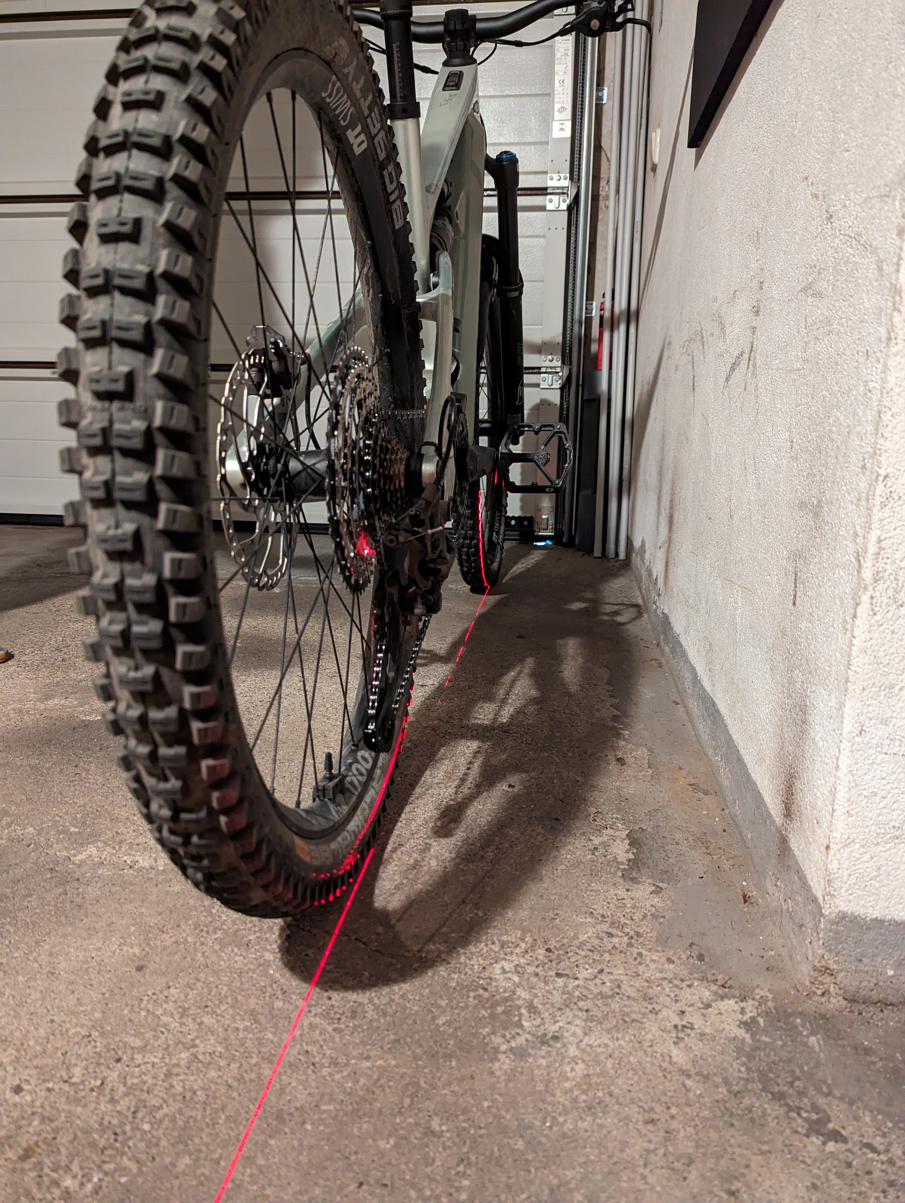

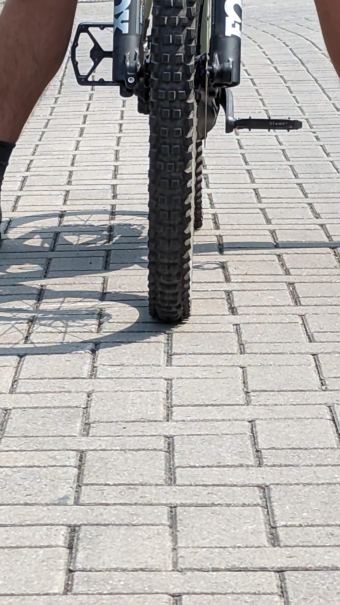

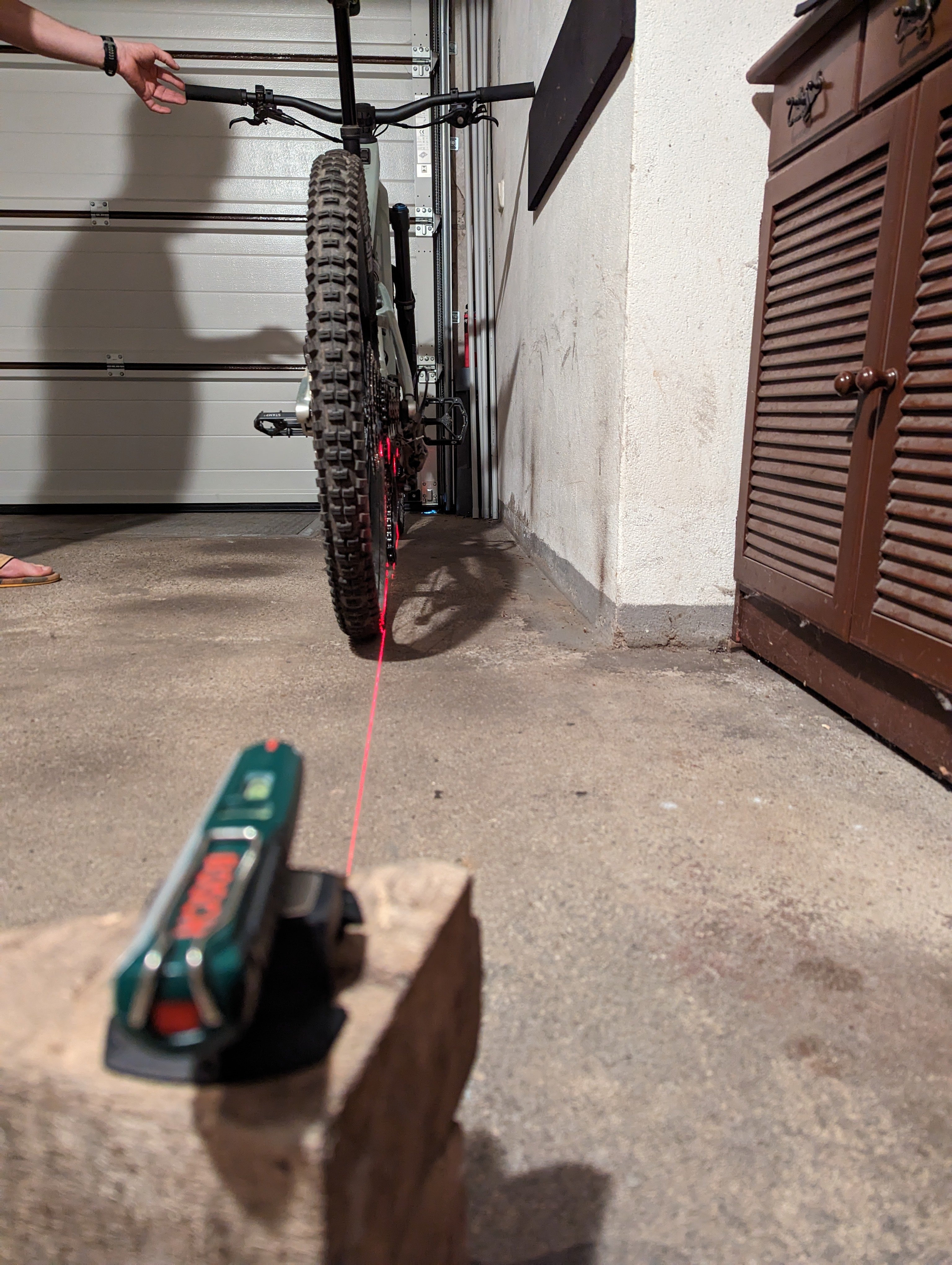

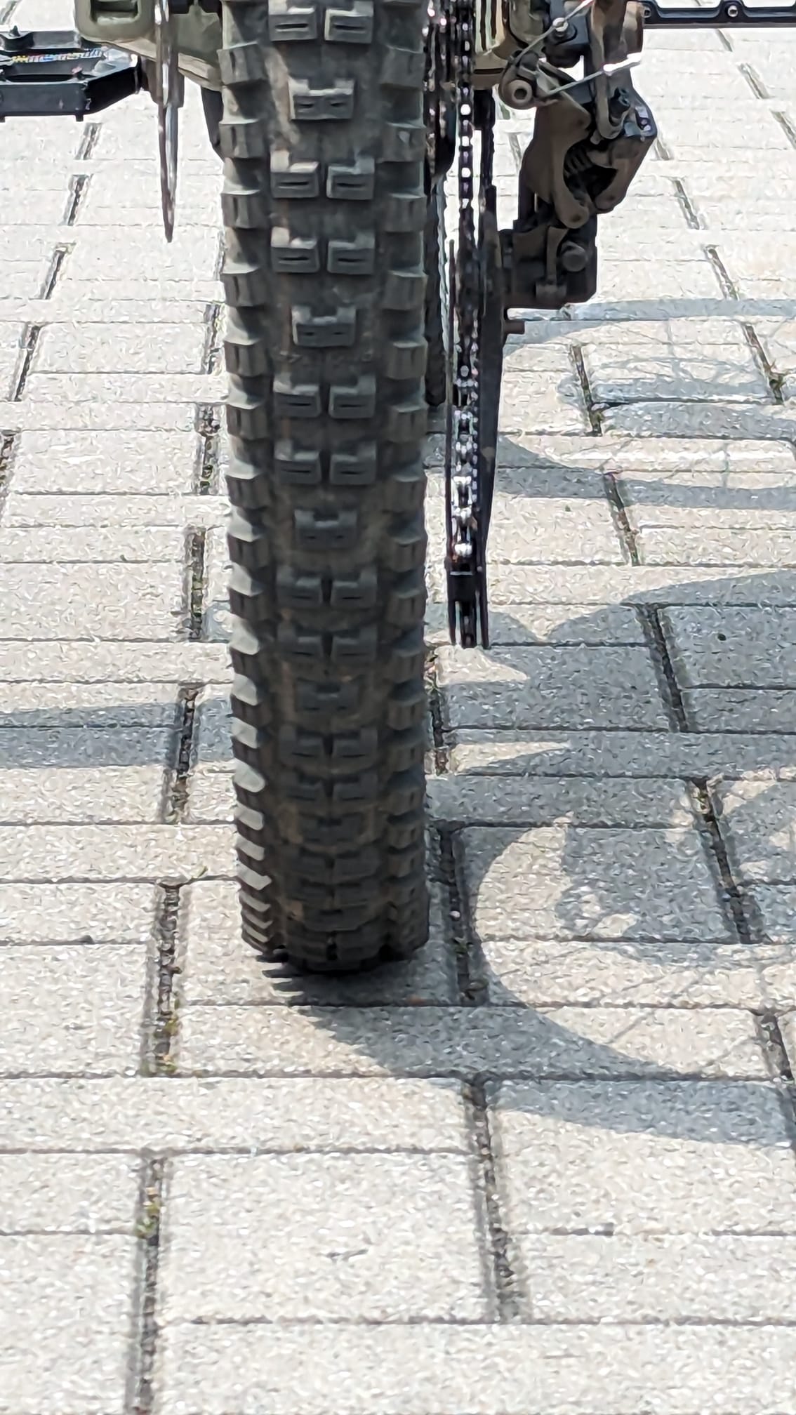

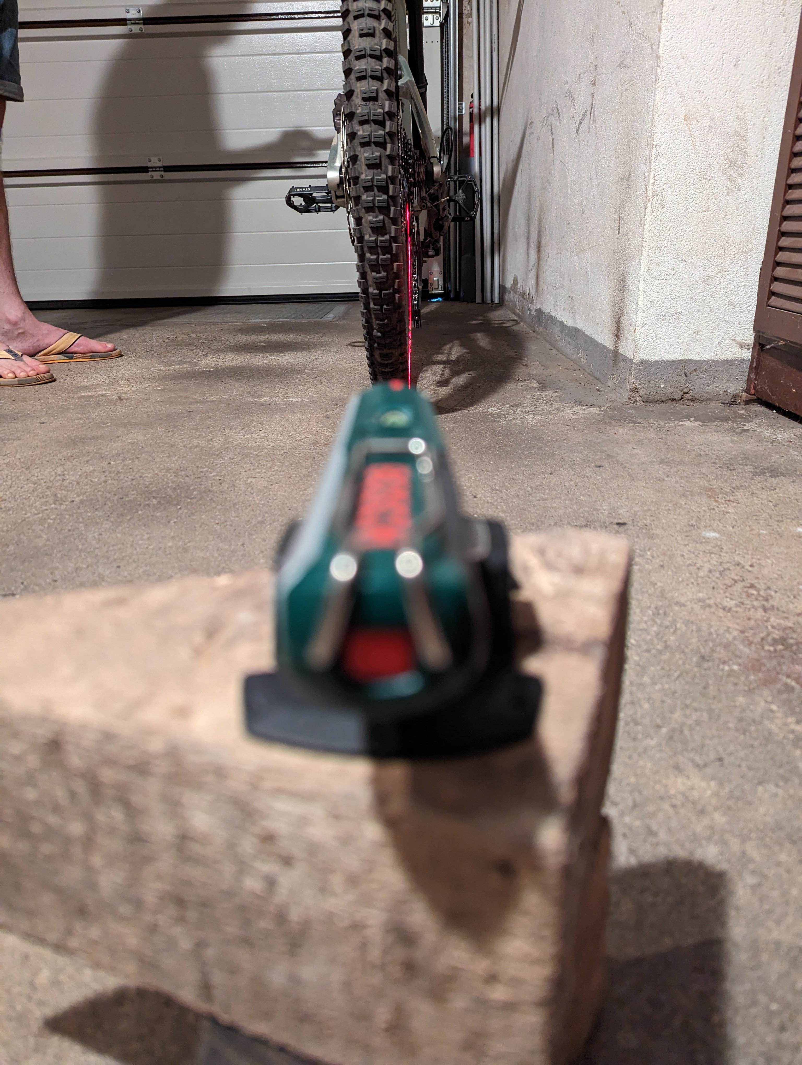

After assembly my all new canyon Strive ON CFR and the first ride, I noticed that the front wheel is not in line with the rear wheel.
Does anyone have an idea?
View attachment 117526 View attachment 117527 View attachment 117528 View attachment 117529 View attachment 117530 View attachment 117531
I'd be bringing this up directly with Canyon before getting advice or making any home remedies. A bike this new is still well within the warranty and responsibility of the brand

Yes everything is fine with both fork legs and the searstay
Agree it’s most likely a wheel dish issue. I’ve encountered this with stock build wheels before and manufacturer reimbursed me to get it fixed up at the local shop.
Tires of course aren’t perfect either.
The front tire is:
  • Maxxis Assegai 3C MaxxGrip
  • Width: 2,5"
Rear tire is:
  • Maxxis Minion DHR II 3C MaxxTerra
  • Width: 2.4"
So it's normal that the laser doesn't align itself.
Have you measured the gap between the front tire and the inner part of the fork stantions? it should be equal.
If it's not... then as all say it's the dishing of the front wheel.

The front tire is:
  • Width: 2,5"
Rear tire is:
  • Width: 2.4"
Not sure if I’m seeing different to you guys but it looks like when the bike is plumb and vertical, one of the wheels is set at a different angle to the other. Assume if you put a level on the back wheel when it’s perfectly level, the front one will be an angle. Not dished evenly one way or the other but leaning over to one side is how it looks to me.
hansfrans
Jun 28, 2020
51
42
Earth
This. Exactly what I meant when I said I don’t understand his pictures. Couldn’t tell what they want to say.

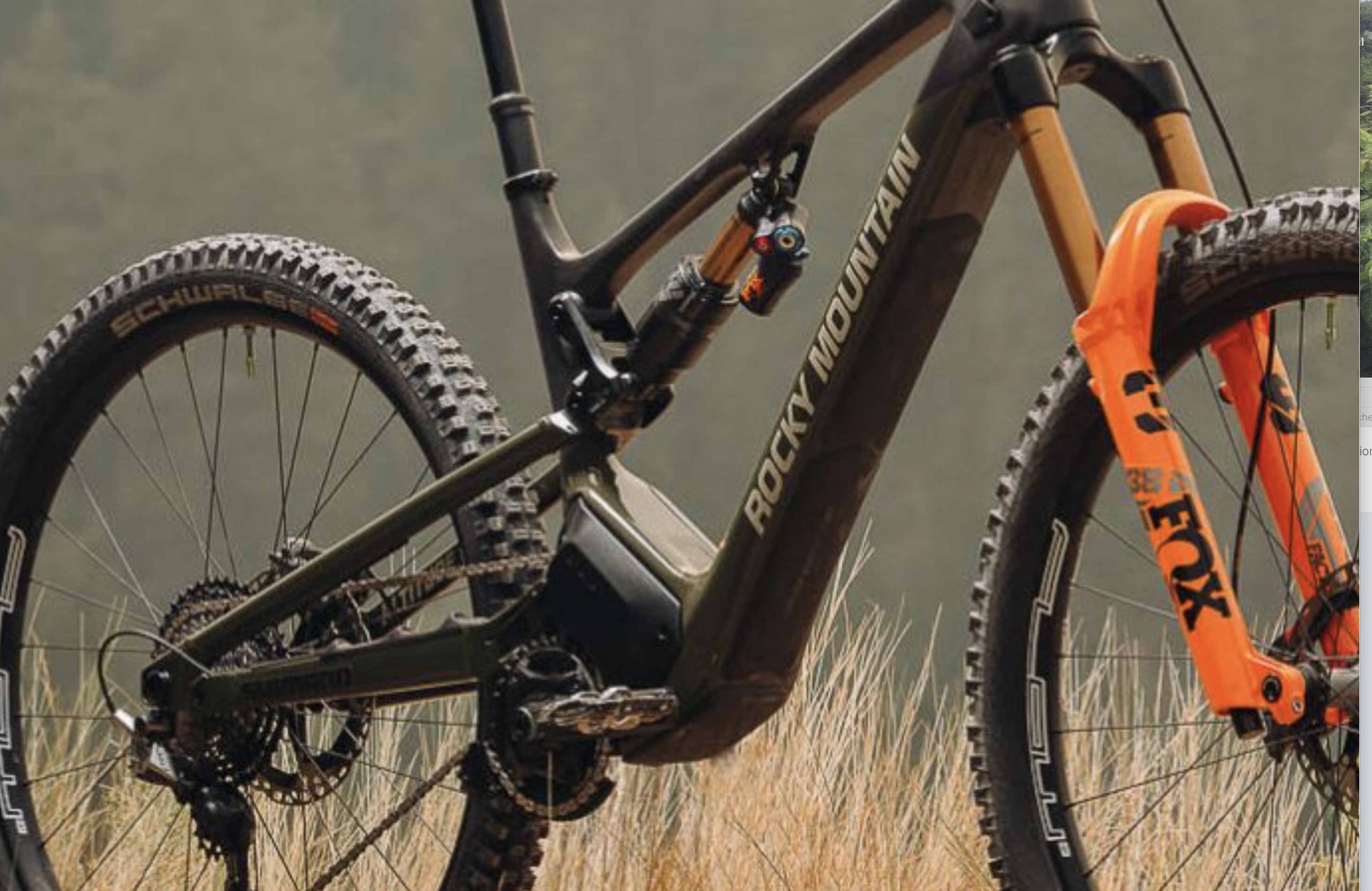

Mars2
May 16, 2023
116
85
La Ciotat France
Rocky Mountain powerlpaly altitude down tube protection look good wider than the nuke proof that rob did use, but they only sell it as a kit with the engine protection also.
Maybe I'm going to design one and then 3D print it.

The front tire is:
  • Width: 2,5"
Rear tire is:
  • Width: 2.4"
I switched straight to Schwalbe tires. Both at 2.5.
Gap between the front tire and the inner part of the fork stantions is equal.
