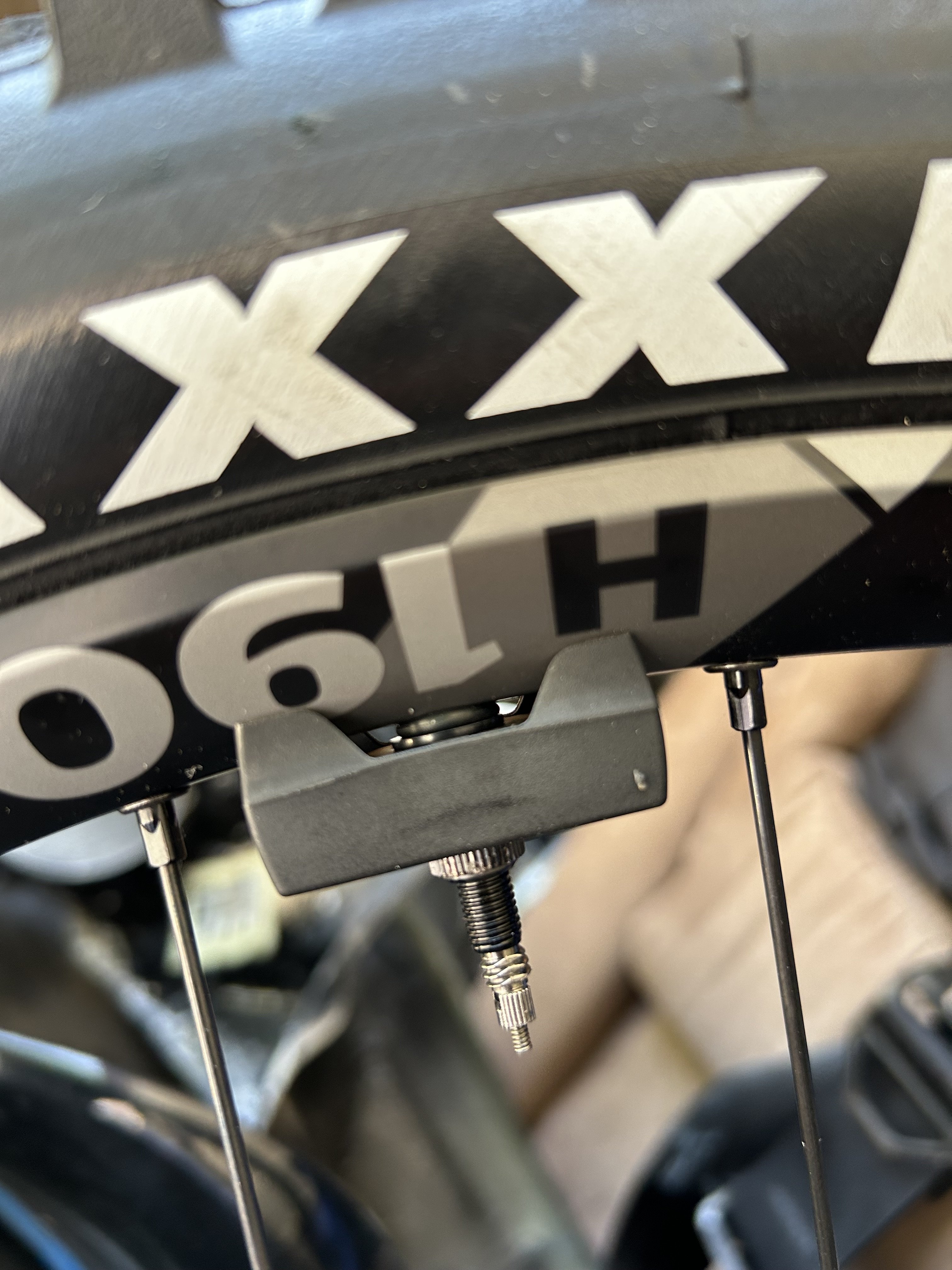

The muc off valves have a wider and thicker nut that cannot sink in the hole of the magnet so the magnet is sitting on the nut and is not secured against rotating when something hits it.
But maybe I was thinking wrong. I now put the sealing ring, then the magnet and last the original nut and it seems to be airtight.
I can also inflate air without issues, so hopefully no need for a longer valve.
Is that 40mm or 60mm Muc-Off valve in that rear wheel? 🤔

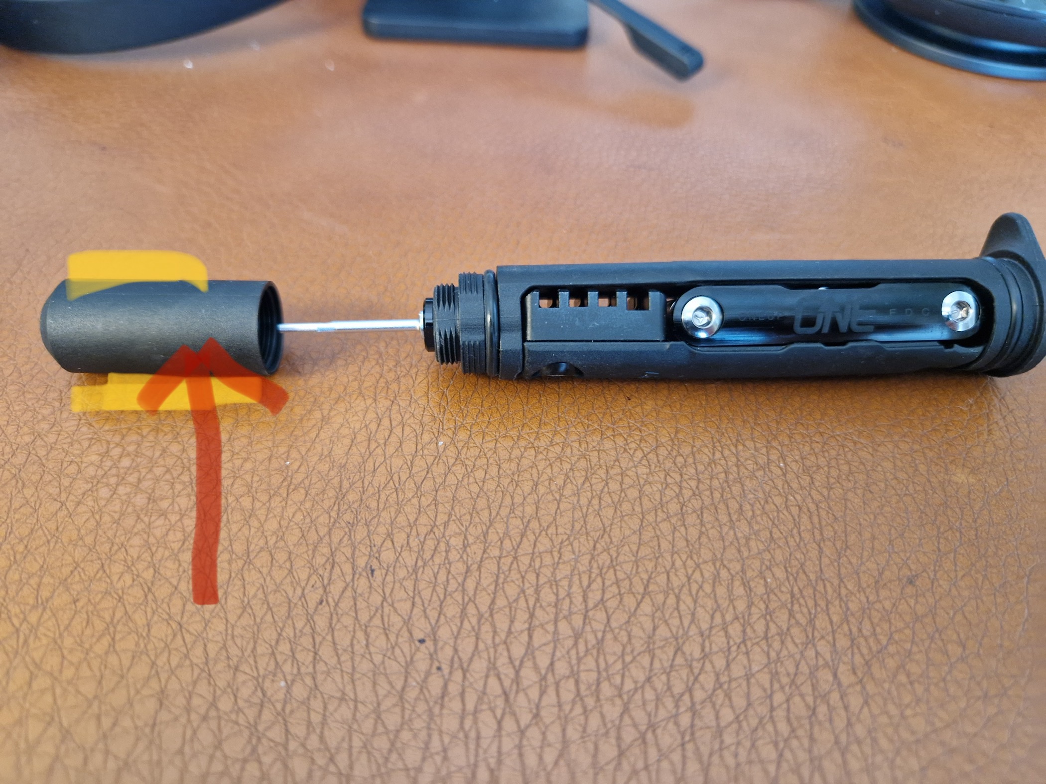

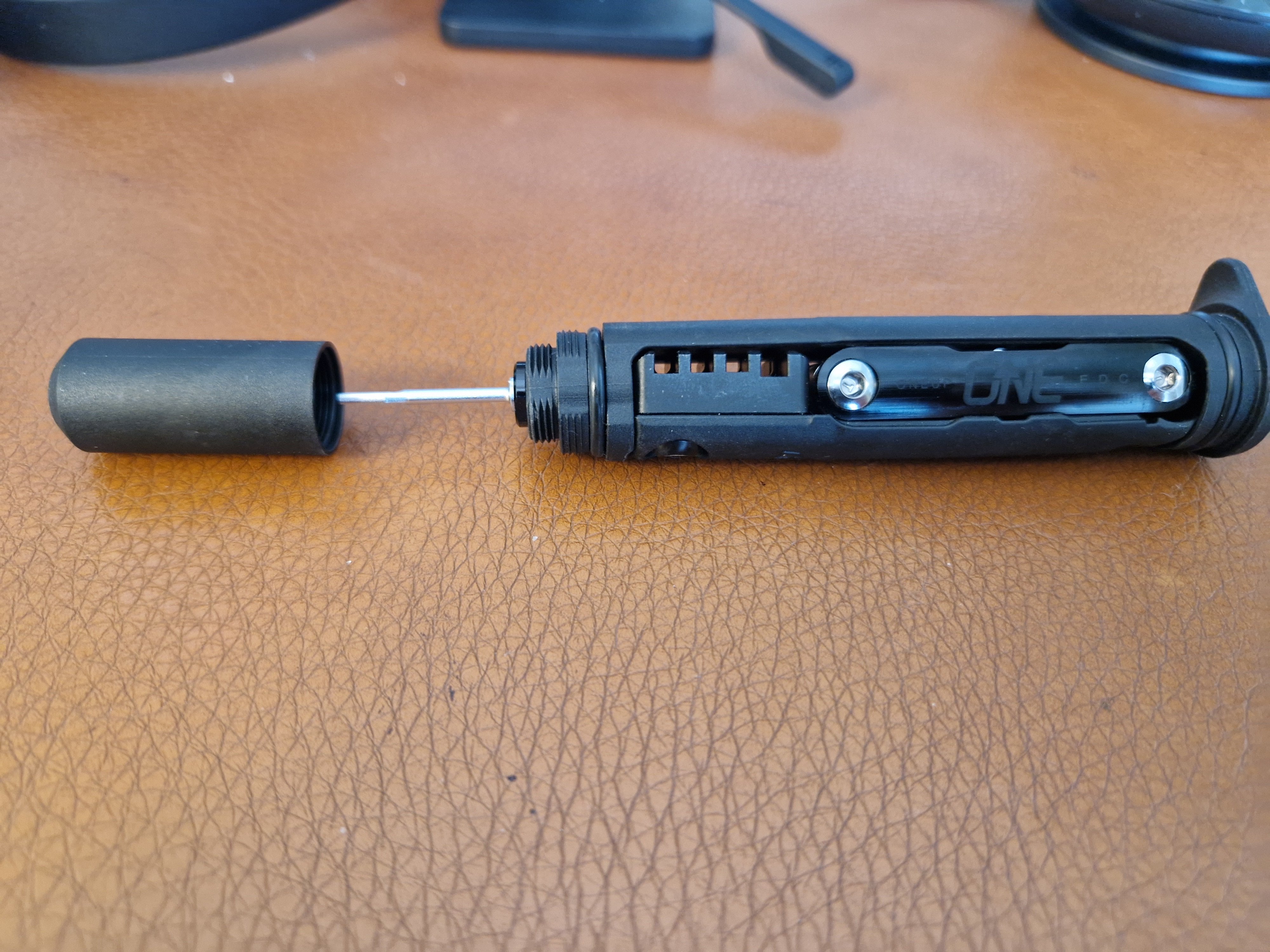

Anyone can post a picture or just explain where the Oneup needs exactly to be shaved to fit fully in the Strive head tube?
Also the bottom plastic plug does not fit. I guess one can live without.
Rob Rides EMTB
Administrator
Staff member
Jan 14, 2018
6,271
13,742
Surrey, UK
Need to shave this down to make it fit. Run a blade and remove the width of the plastic until if slides into the steerer without jamming on the steerer.
