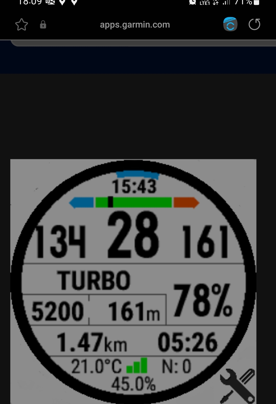

Out of interest, once they link Garmin to the Bosch, could your watch show bike battery level, speed etc? I'm wearing a Garmin Instinct Solar as we speak...
Yes. This is how it works with the Levo / Kenevo. It’s nice seeing your pedal power in watts and the bike battery percentage (and I think it even shows AXS gear too).
Ah nice. Maybe I'll hold on for that then, although part of me likes having it right in front of me without having to take a hand off the bars to look, or fish my watch out from under my sleeve in winter.
Also, can someone with the CFR model please confirm if the Fox 38 has gloss or matte paint? Pretty sure it's matte, right?
It looks like this on the Garmin Fenix
