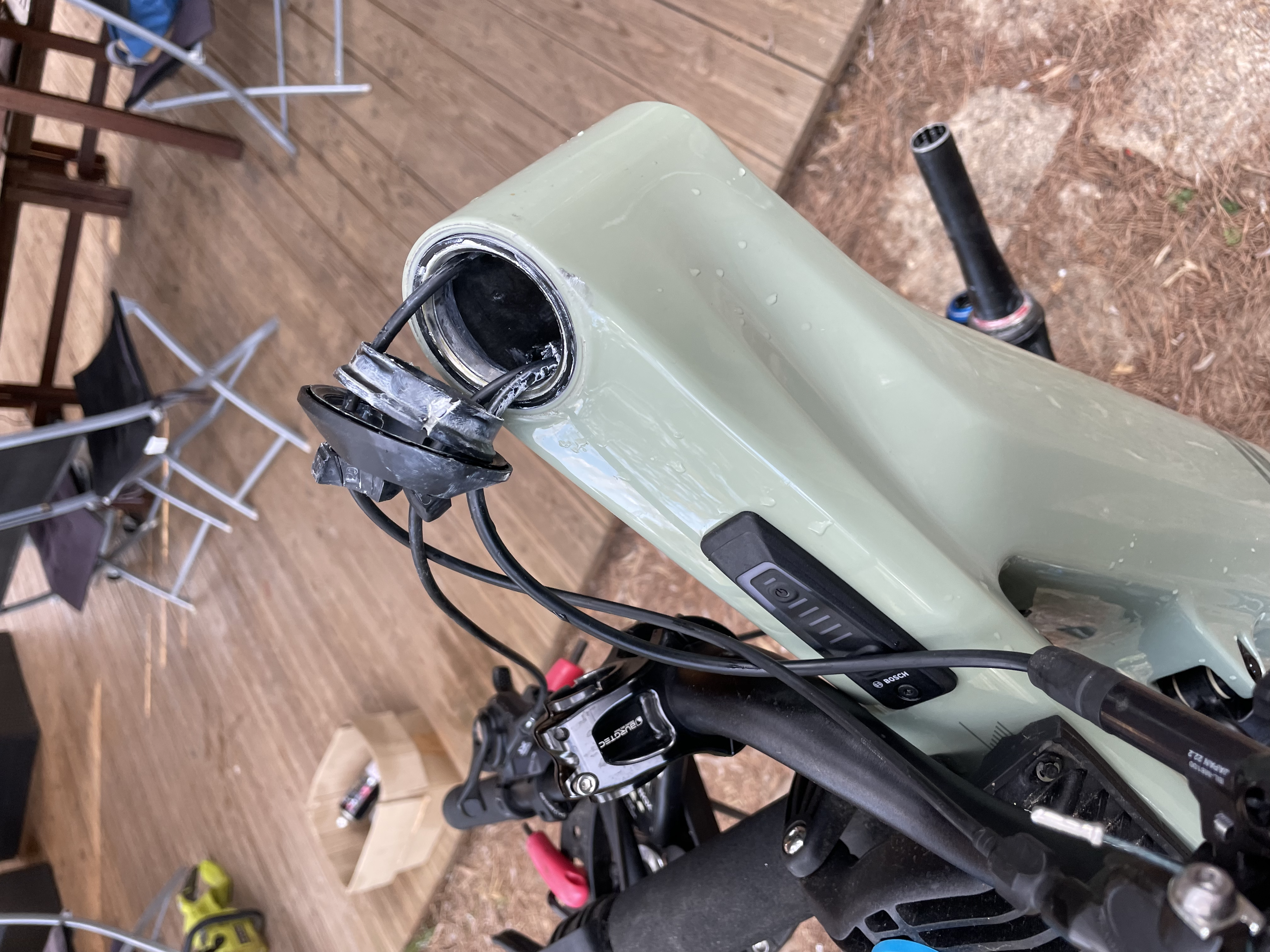

Yes I have spectral: on, I haven't done any headset bearing service yet, as bike is fairly new but I know sooner or later I will have to replace it.
So there are 3 cables that are routed through upper headset bearing: derailleur-shifter cable, rear brake (hydro cable) and dropper cable. *there is also 4th cable (steps screen) but it can be easily disconnected.
To take out upper bearing completely you need take out shifter and dropper cable then unbolt hydro cable from the rear brake lever.
After replacing bearing obviously you need to put all together, dropper, shifter cable, set shifting and bleed brake. This is time consuming much more than it is on a bike with "classic" cable routing where cables go through ports behind headset usually on the down tube. I know that's not something you do once a month but still, for me I would prefer classic cable routing where cables don't go through headset bearing but nowadays almost every brand using headset routing 🤷‍♂️

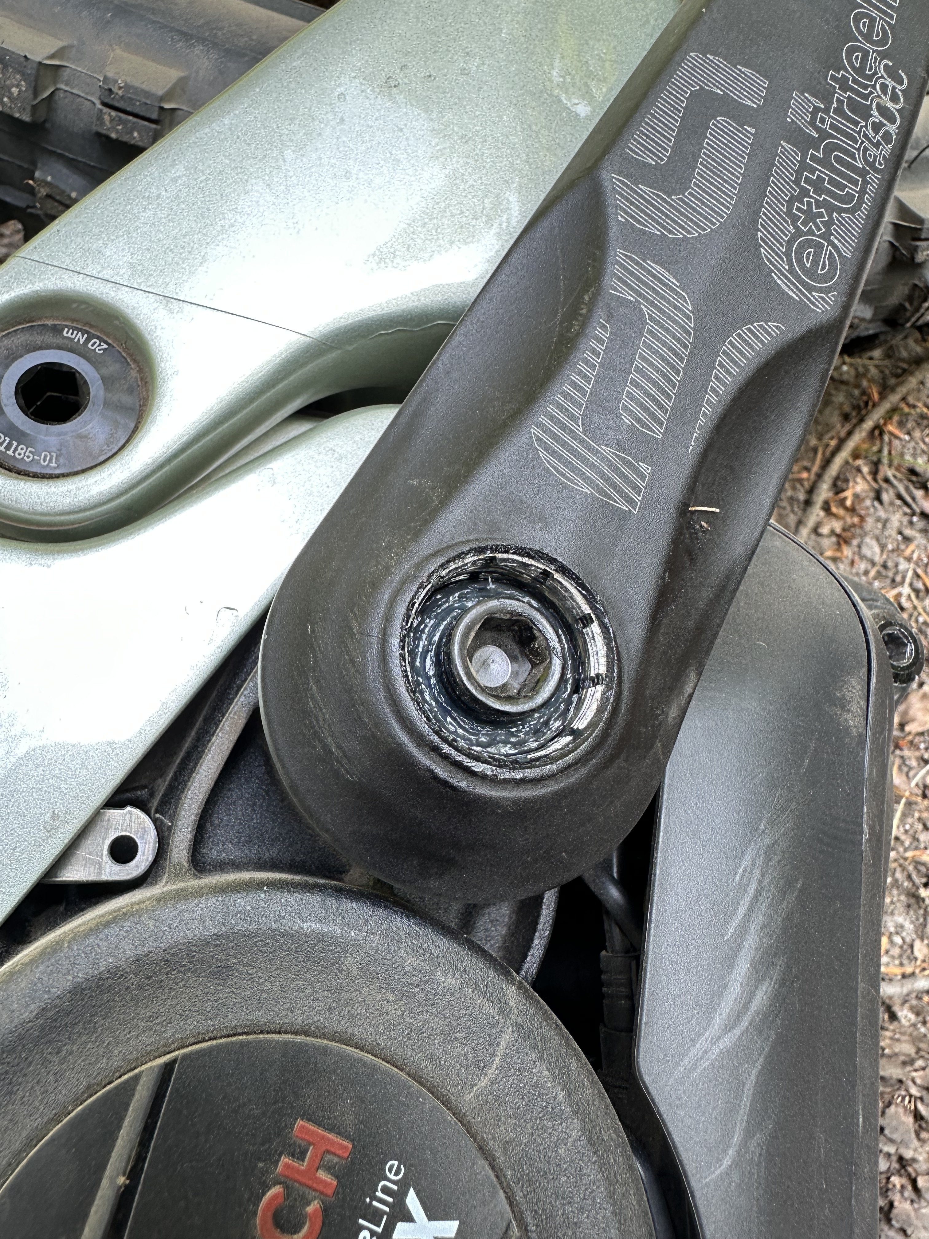

Hi folks, hope you're enjoying your Strive:ONs 🤩
Just remember to check if your cranks are tightened properly ‼️
The left crank on mine just came loose today on the trail; fortunately, I caught it early and tightened it.
It turned out that the drive-side crank was also loose.
I contacted Canyon, and they admitted they knew about the problem (sic!). They asked me to contact them through the website so that they could somehow fix the problem.
Hopefully, they send me the washer I lost because of that 😅

Happened to my canyon road bike on the first ride

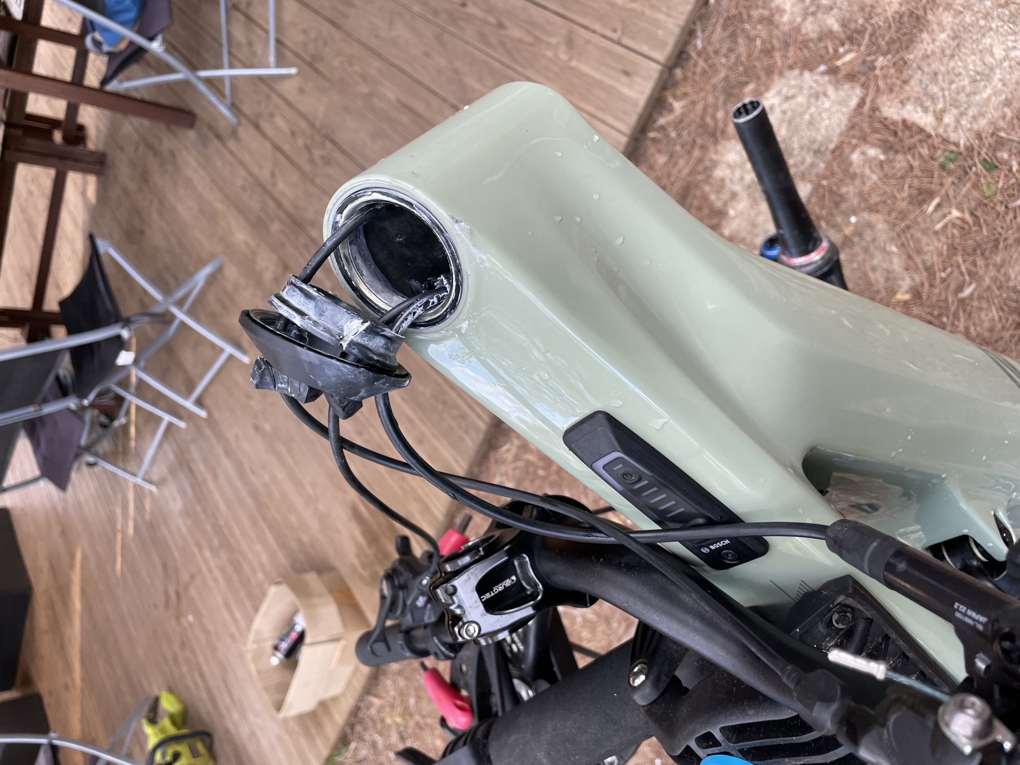

Mars2
May 16, 2023
116
85
La Ciotat France
I don't know if we are talking about same thing... :unsure:

You don't need to remove any cable.
Like on any bike you remove the the stem, then drop the fork. then you can lift up the ring where the 3 cable goes through and then you have access to the bearing. what is the problem? The cable don't go through the bearing they pass on the side of it. so no cable to remove!!!
Mars2
May 16, 2023
116
85
La Ciotat France
Doing this I discover something.
Last weekend after landing from a jump bit too fast I could not avoid a tree that was their just after landing area.
My bar turn 45°.
Now when I dismantle it I see that all the pin on the plastic washes are cut. No more pin but the system still work great.
This make me think that maybe I did not need to make the groove in the Burgetec stem to make those pin go in.
I could just have cut those plastic pin off.

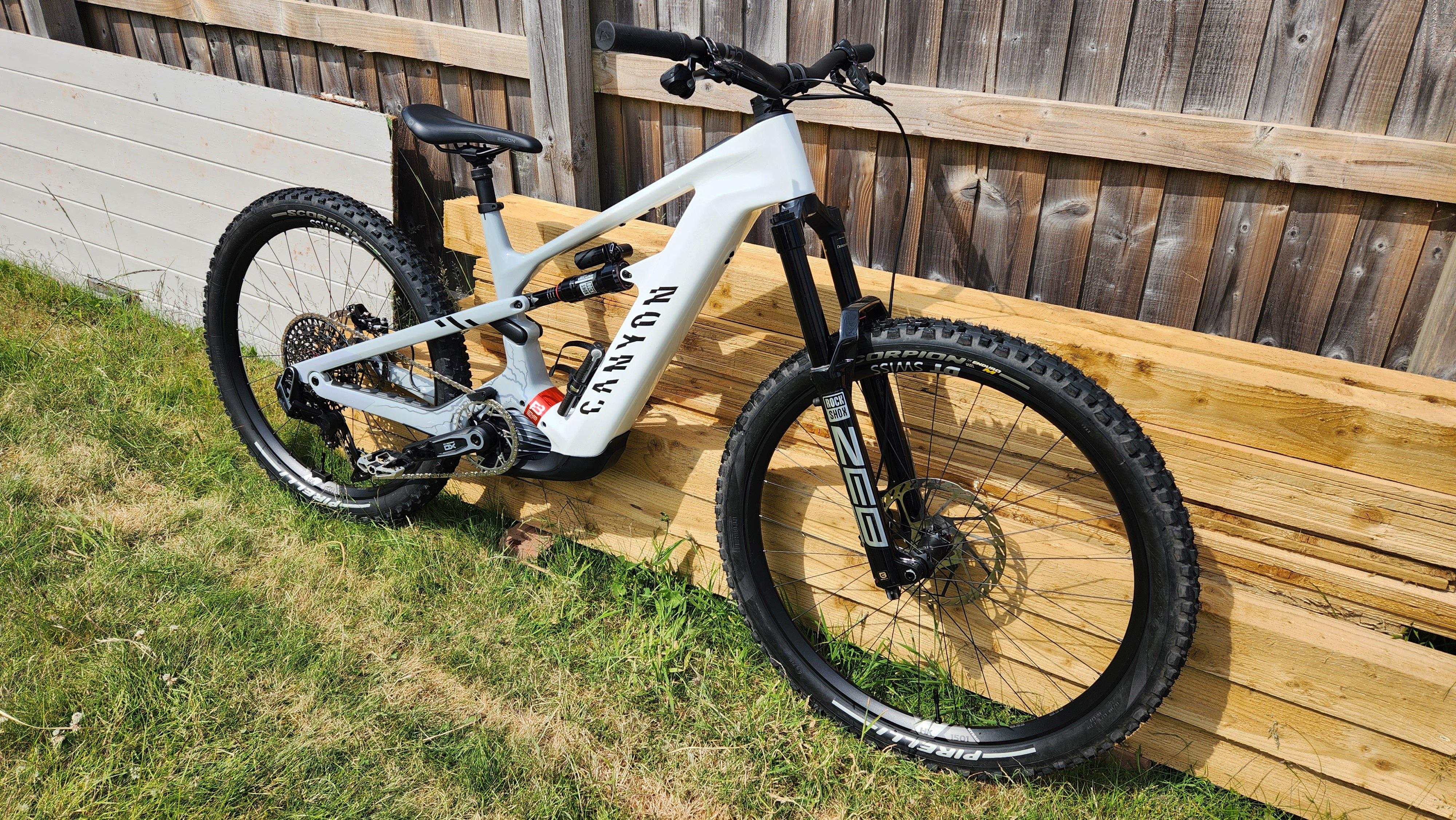

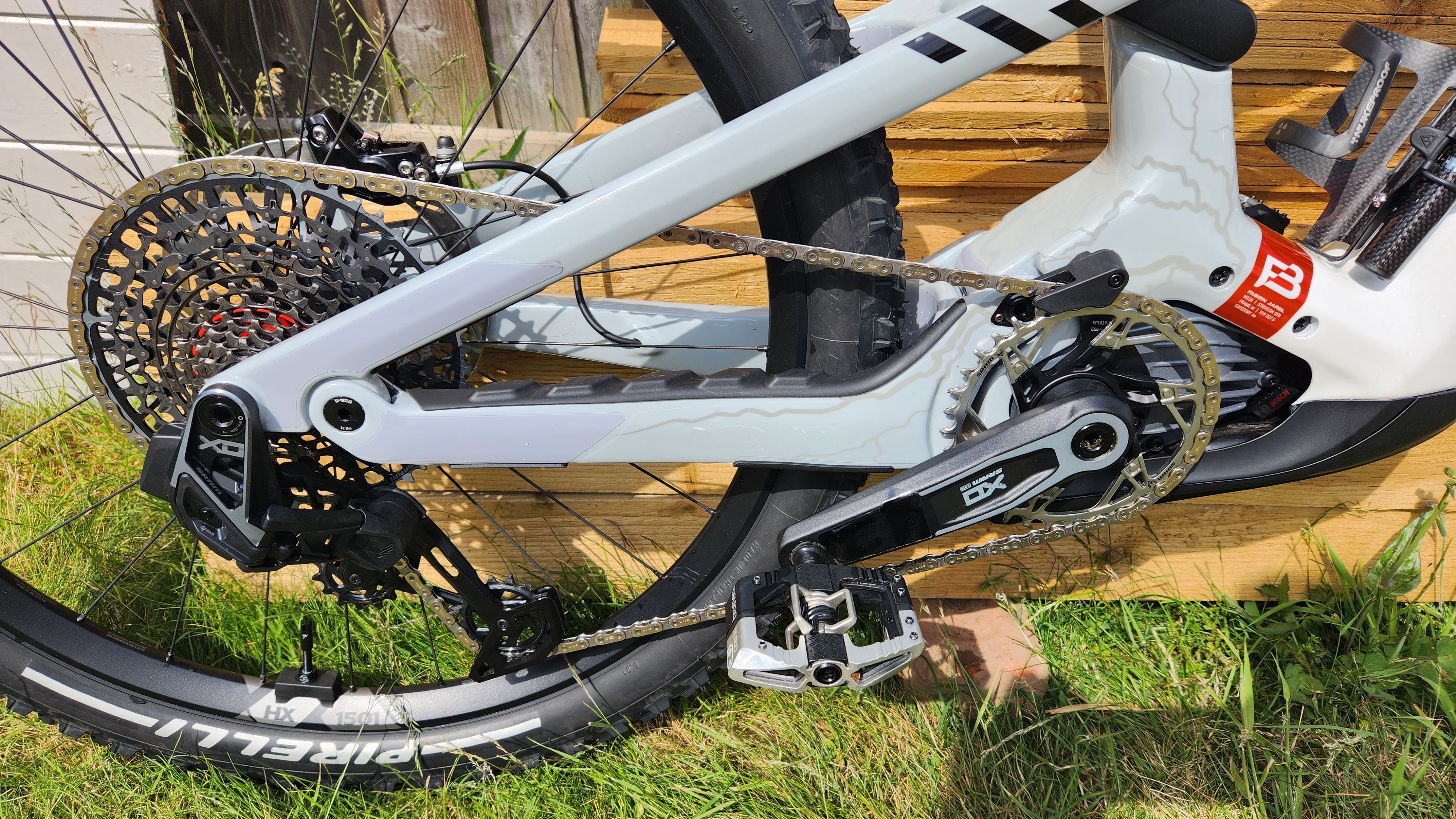

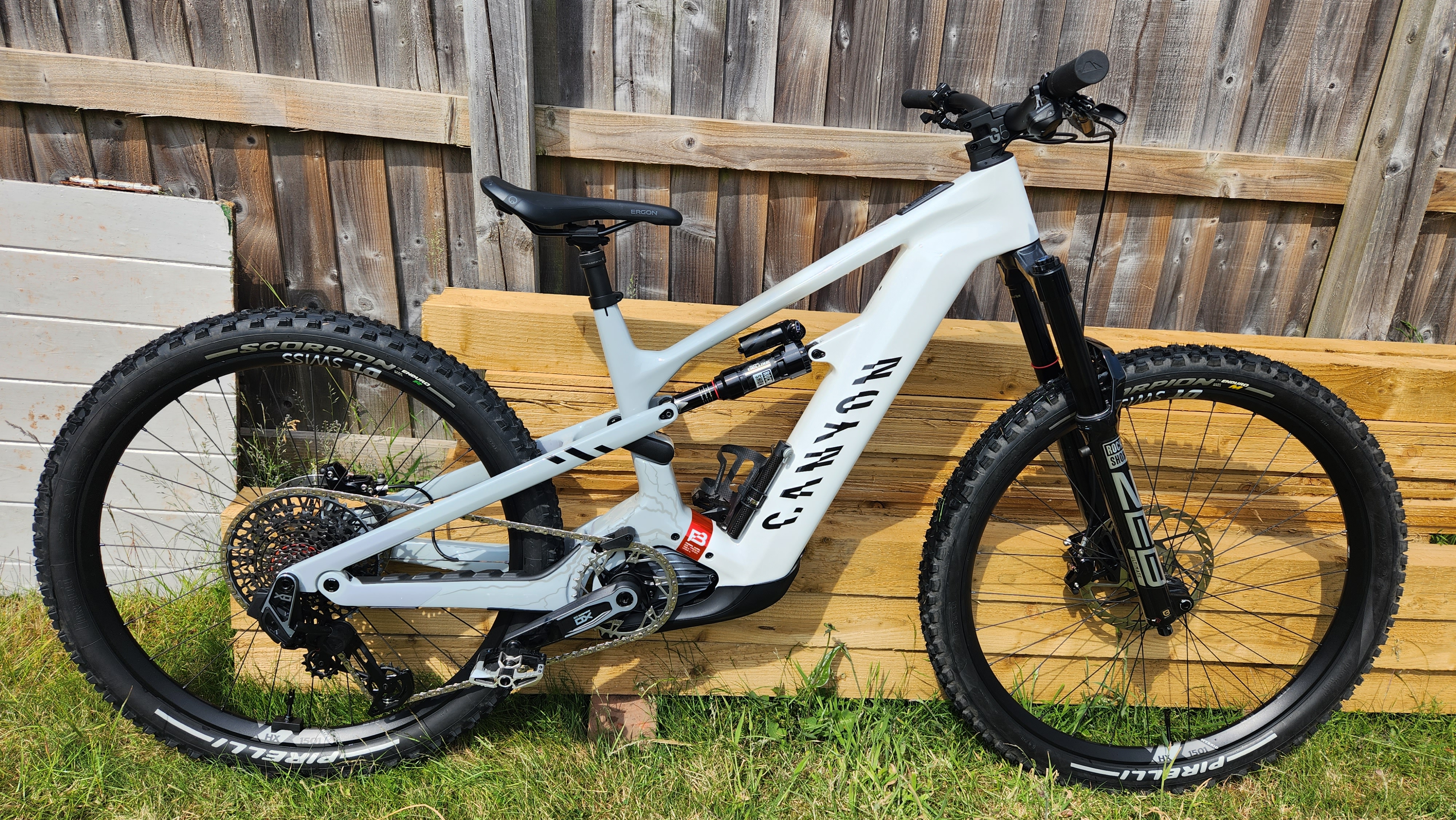

Bike finally arrived on Wednesday, UPS failed on Monday & Tuesday, not the best for sure.
Spent Thursday doing the Invisiframe, tubeless set up etc.
Eventually got out for a ride earlier,rode from mine to the nearest place which is more xc/trail than enduro but good enough for a shake down ride,plus I was short on time.
Did 26k with 726m of ascent in 1hr 52 using mainly embt+ mode with a bit of turbo.
Anyone sat on the fence can rest assured its an excellent all rounder,makes everything fun,don't worry that you'll be "overbiked" it's not an issue, handles trail riding exceptionally.
I did have a play around over a few jumps & some steep stuff both up & down & it's a weapon for sure,munched up everything in its path I was clearing 3m gaps with ease,doesn't feel heavy at all,very poppy & flickable.
I felt comfortable on it almost instantly, feels very similar to my 2022 Bronson,which is what I was hoping for.
Only time I noticed the weight was when I had to lift it over a few gates.
Gotta say I'm very impressed with the spec everything is spot on,you won't need to change anything much with it.
I'm not a fan of sram brakes,but after setting up the bite point & reach they felt good.
Suspension feels great, will dial it in to my taste over a few rides.
Canyon dropper works very well,very impressed.
Cherry on the cake is the new sram axs groupset,wonderful piece of tech,haven't ridden a bike with the old axs on so I can't compare the 2,but this new one was so easy to use,very bling but quality none the less.
So first ride was a great one,looking forward to ride no 2 on Sunday, which will be on more challenging terrain.
