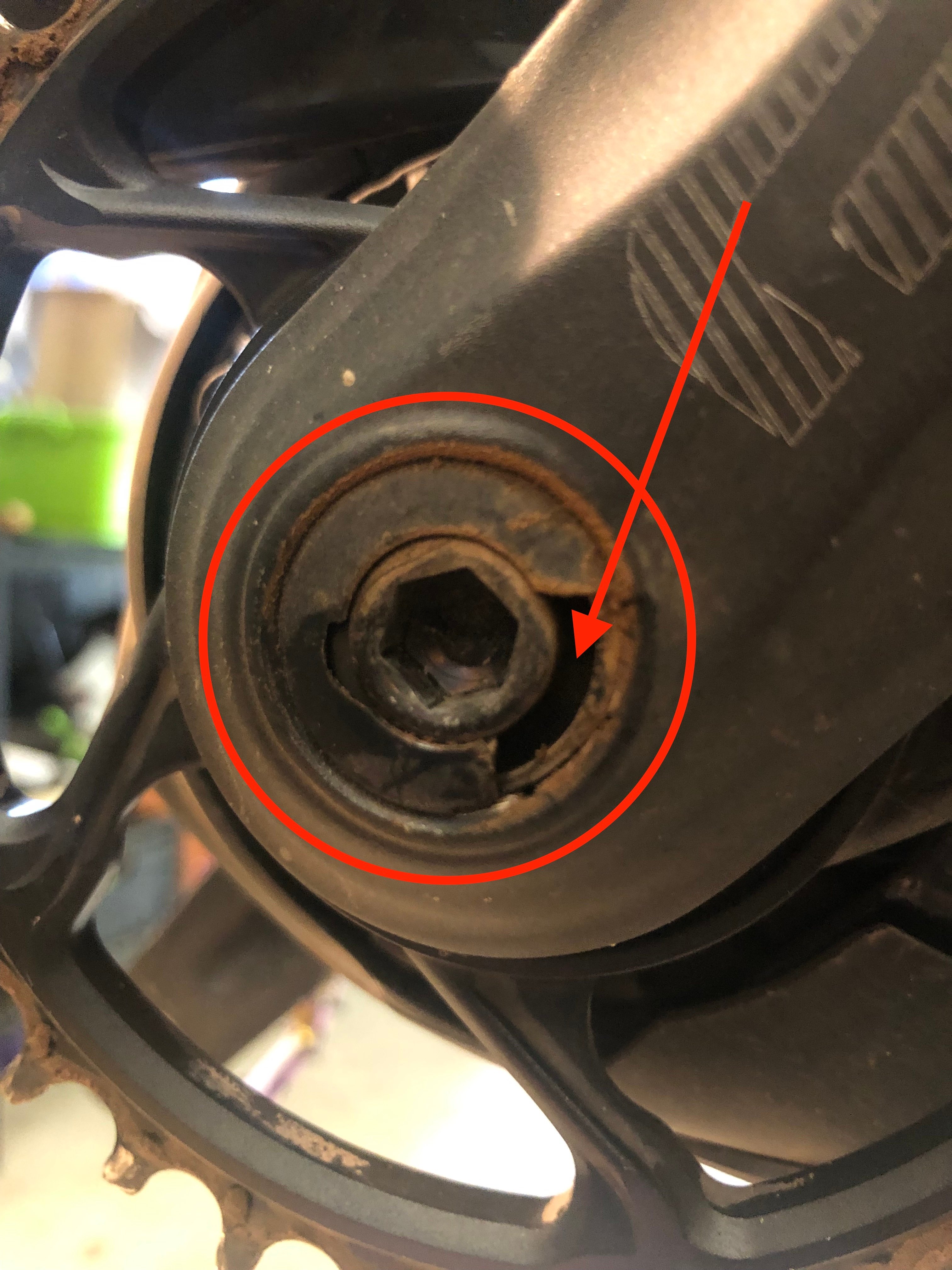

Hi all, if you see the attached photo, there's what seems to be a bit missing from the crank bolt from the chain ring side of the exe, maybe also a crack? I can't remember what it's meant to look like. Anyone else had this issue or can provide guidance? thank you
Plastic on mine cracked, but not near that bad. More of a hairline fracture. Thing still intact. E*13 confirms it's cosmetic.
At least for the very first EXe's that arrived last Sept/Oct, something weird is going on with the cranks and bolts. I tried to source a replacement because I'm OCD like that and I was thinking it might create some creaking.
If you went to E*13 website, bolts that looked like they should fit were CSS30-113. But they don't fit. Pitch is correct and they screw in, but plastic around bolt head too large and they don't sit flush. E*13 confirmed these were the correct bolts as far as they were concerned. This was about 4-5 months ago. Haven't checked or inquired since then.
Called Trek about an app issue about a week ago. Asked them about the bolts. They said no bolts available, and that if there was an issue, the solution would be to get with your dealer and you'd likely get a new crankset!?!?
Love Trek for giving us this amazing bike and super grateful they abandoned stupid proprietary shit like reactiv and knock block, but it seems like they still snuck something stupid in under the radar . . .

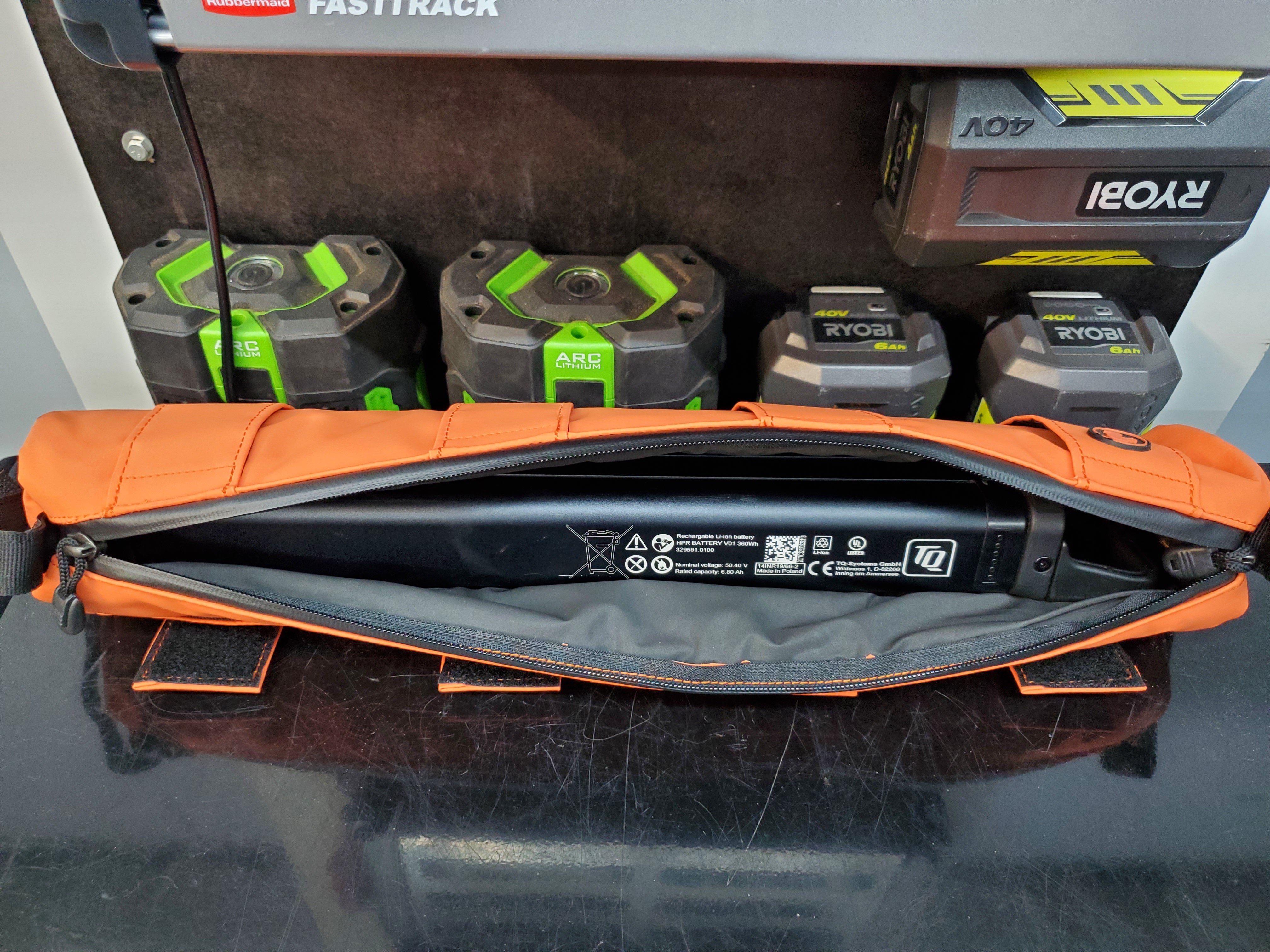

For those with a full size battery (not range extender), I've found the perfect carrying case for it; even better than the battery case included with EVOC e-ride packs.
It's originally designed to carry 4 beer cans, which equate to the length of the TQ battery. It has waterproof zippers, insulated/padded, and has lots of configurable straps on every side. It's also very well made.
I think it's a pretty good price for what it is.

Do you keep it on the top tube?
You certainly could but I keep mine in my backpack for long rides. Gives me extra security with the padding, waterproofing, and minimizes heat/cold exposure. I know the battery is IP67 but I don't think the exposed connection plug is.

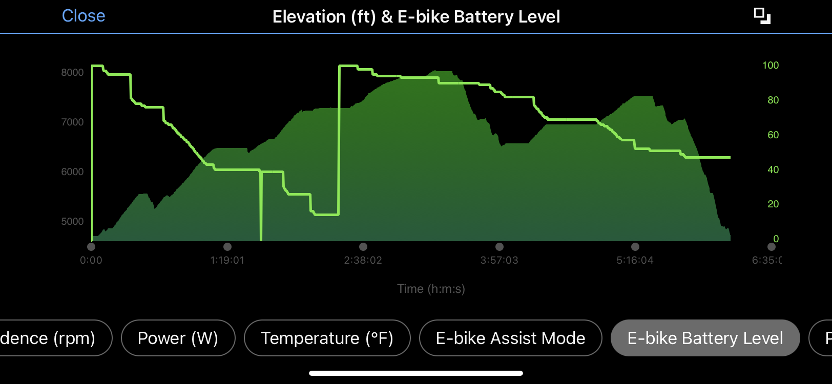

I brought my bike to the LBS last week after approximately 1000kms. I still feel drag when pedaling without assistance when the motor is warm or when I biked a bit longer without assistance. Switching it off and on doesn't result in a solution. On longer and steep climbs the motor didn't deliver the full 300w when selected and became too hot to touch. There was no notice on the screen. Waiting for 15 minutes to cool down the engine resulted in full power again. But when it was hot again, there was again not more then 200w. I'm fairly fit and do deliver 250w myself for longer time without any problem. Lately there was also a clicking noise coming form the TQ motor. The LBS claimed a warranty at Trek.
The TQ display screen that shows rider watts/assist watts is good to check here. While climbing a 5500' ride yesterday I felt like the motor (and myself) were suddenly, seriously dragging, even in boost. I went to that display page and it showed me as putting out 0w (I was at nearly max effort) and the motor was putting out only 50w in boost. This lasted only a moment, then suddenly everything was fine- the motor and I both were putting out 150w+. Everything worked great for the remainder of the 5.5hr ride.
I think the display showing 0w probably indicates an error with the torque sensor. Either that, or it's sort of an overheat mode. If it's a temporary, intermittent issue I'm not worried, but I am going to keep an eye on it, and also check in with my dealer. Perhaps the torque sensor can be recalibrated via a firmware update (?)
Did you do 5,500’ on a single battery, or is that with both of your batteries?
Emailsucks98
Nov 12, 2020
365
438
Bellingham Wa
I used both batteries, used 90% of #1 in eco/trail mode. Once I put #2 in a was in boost for the rest of the day. AQI of 110 and 8000’ elevation, was not feeling awesome but we got it done!
I rode with a dude on a sweet new transition relay. He was fitter than me and was able to get the entire ride done with the one 430w battery. We concluded the bikes had pretty similar efficiency though.
The drop in the #1 battery is where I had the assist drop & tried restarting
