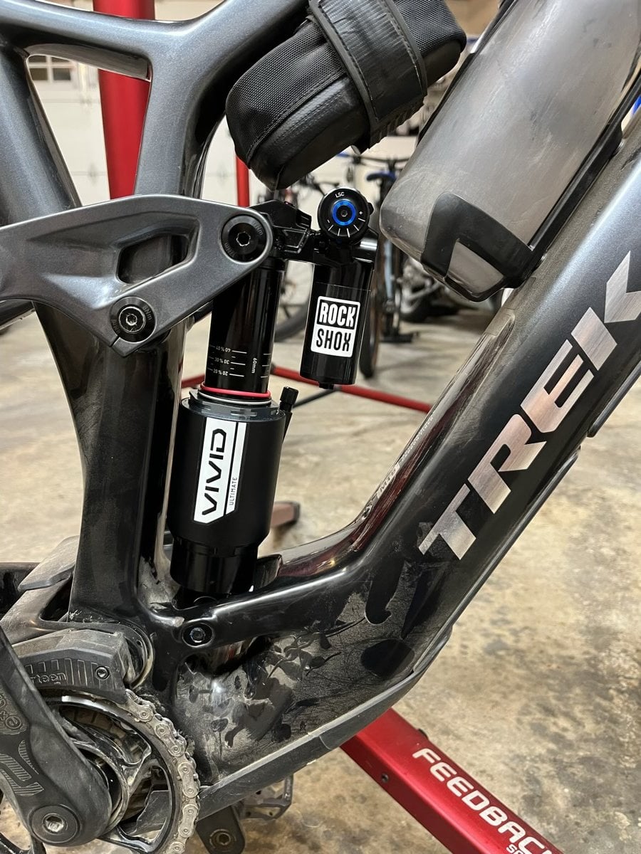

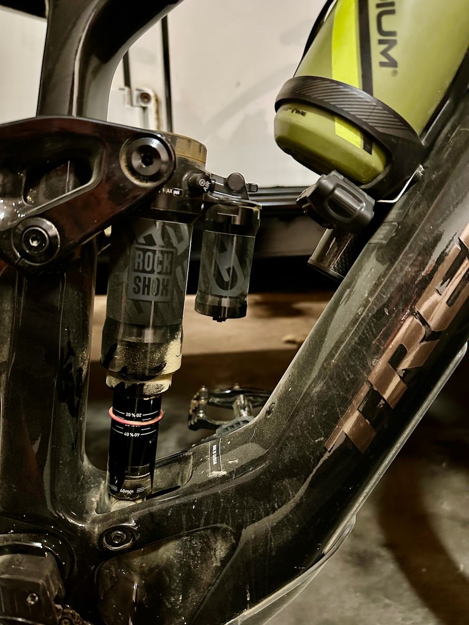

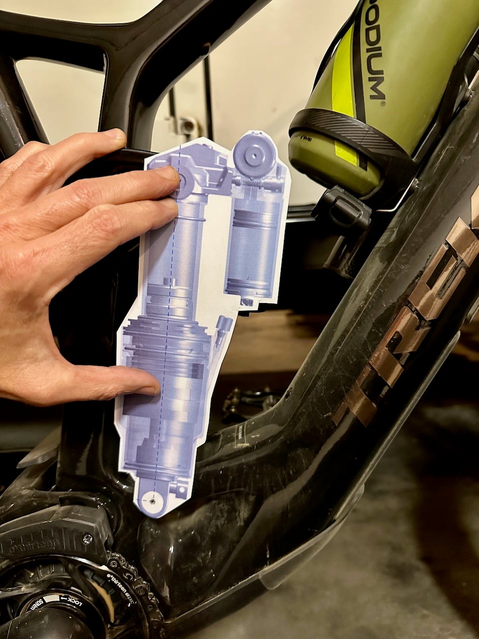

Hi All, Following the release of the new Rock Shox Vivid, this is a pic of a roughly scaled cutout (205mm eye to eye) against my frame. There will be some possible interference with the bottle mount / tool as the remote reservoir rotates forward on the rocker.... but it looks like there will be a clearance problem between the massive inverted air can and the seat tube. The do make the shock in the applicable size and configuration for the bike, and they sell specific tune shocks for the Slash and Rail, any word if it will fit the Fuel EXe? I think the Fuel Ex won't be an issue either, as the lower mount seems further away from the seat tube? Anyone else looking into this or have access to a Vivid for sizing? I've asked the local Trek Importers for feedback too, let's see if they have any feedback. Would be a shame if one can't fit it, looks like a great shock option. Attached pics of cutout Viviid and stock setup...

agree - looks like the air can will foul the frame at the bottom.

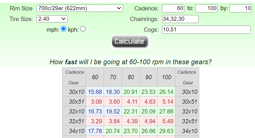

The stock ring is 32T. (unless something get swapped)
30T would keep you out of that maxed out gear.
in 30T-10T you'll be over the speed cutoff by 75 rpms. yes, the EXe pedals well over the cutoff, but for overall assisted trail riding it should be fine.

Thanks for the info!
I looked at my bike and the chain ring is 32T like you said.
I googled the spec for it and got 34t. Just now I went to Treks website and found this for my exe 9,8XT.
Going from 32t to 30t is only 6.4% improvement. I wish there was a 28T chainring but I would notice the difference and prefer the 30t.

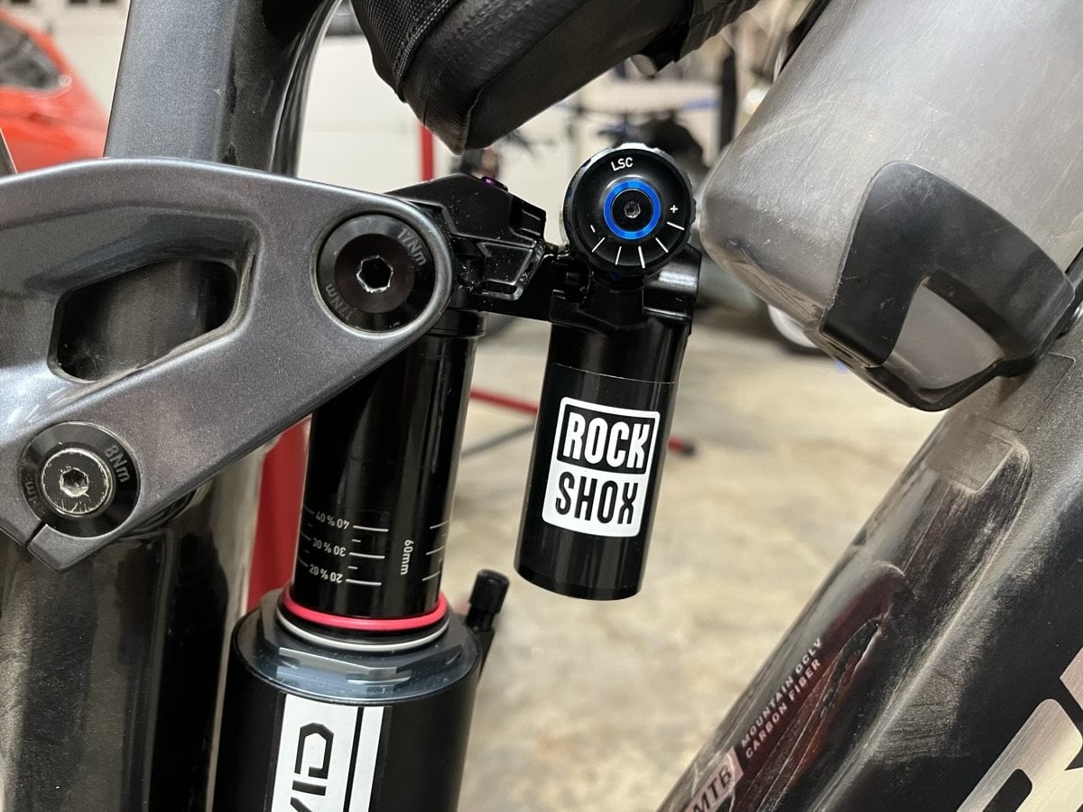

View attachment 123099 View attachment 123100
I have a large 9.7. Love the bike but really struggling with the Float X. Even with no tokens, I am only using 70% of travel and that is with 36% dynamic sag on the shock wiz. I have a float X on my Ripley, so I know how these should work. Unless mine is a weird/messed up tune, I should definitely be getting more travel. The other explanation is that the geometry is very progressive and needs a more linear spring.
I tried a Mara Pro. I had a Mara on the Ripley too, and it was very nice. The stupid long piggy back on the pro hits the downtime, so no go.
I was going to try a coil, but when I saw the Vivid, I though, Hmm.

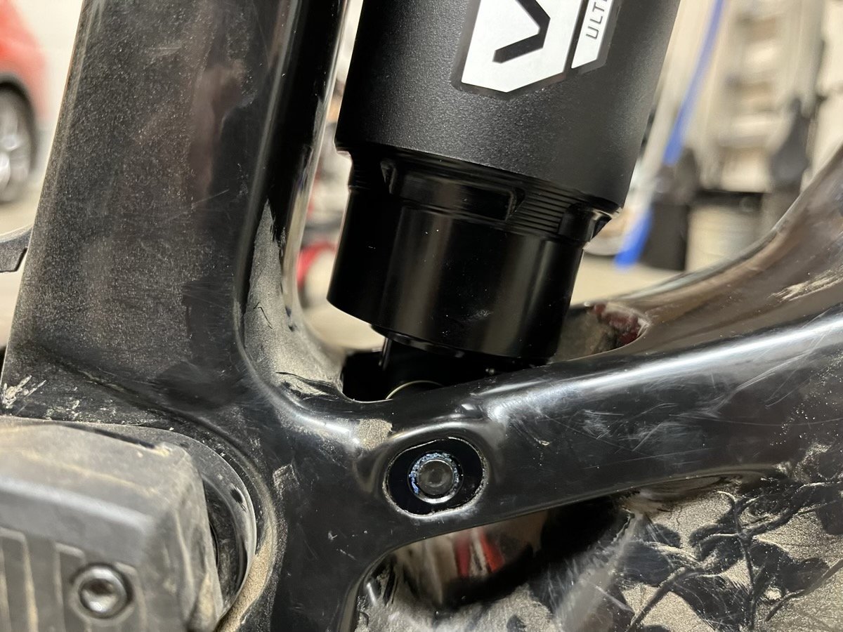

It fits on my Large. Barely. At full compression, the lower air can is within 1mm of contacting the frame. I went to the trouble of making a wood lower spacer to install the shock to see if it fit, before I committed to the install.
First ride will be tomorrow. Fingers crossed I get the tunability that the Float X did not have.
