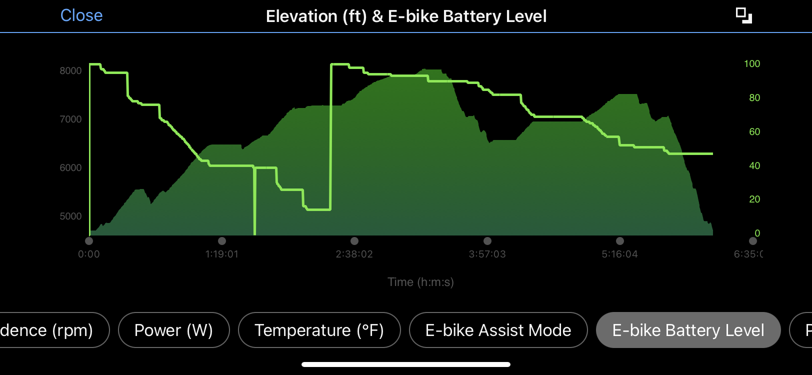

I used both batteries, used 90% of #1 in eco/trail mode. Once I put #2 in a was in boost for the rest of the day. AQI of 110 and 8000’ elevation, was not feeling awesome but we got it done!
I rode with a dude on a sweet new transition relay. He was fitter than me and was able to get the entire ride done with the one 430w battery. We concluded the bikes had pretty similar efficiency though.
The drop in the #1 battery is where I had the assist drop & tried restarting
View attachment 121982 View attachment 121983
Awesome ride and thanks for the info. I can do about 40 miles and 5,000’ with both my batteries. I only use mid level and boost.

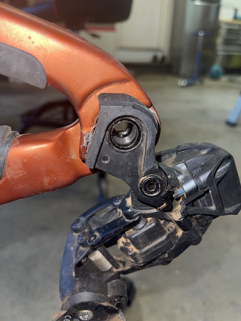

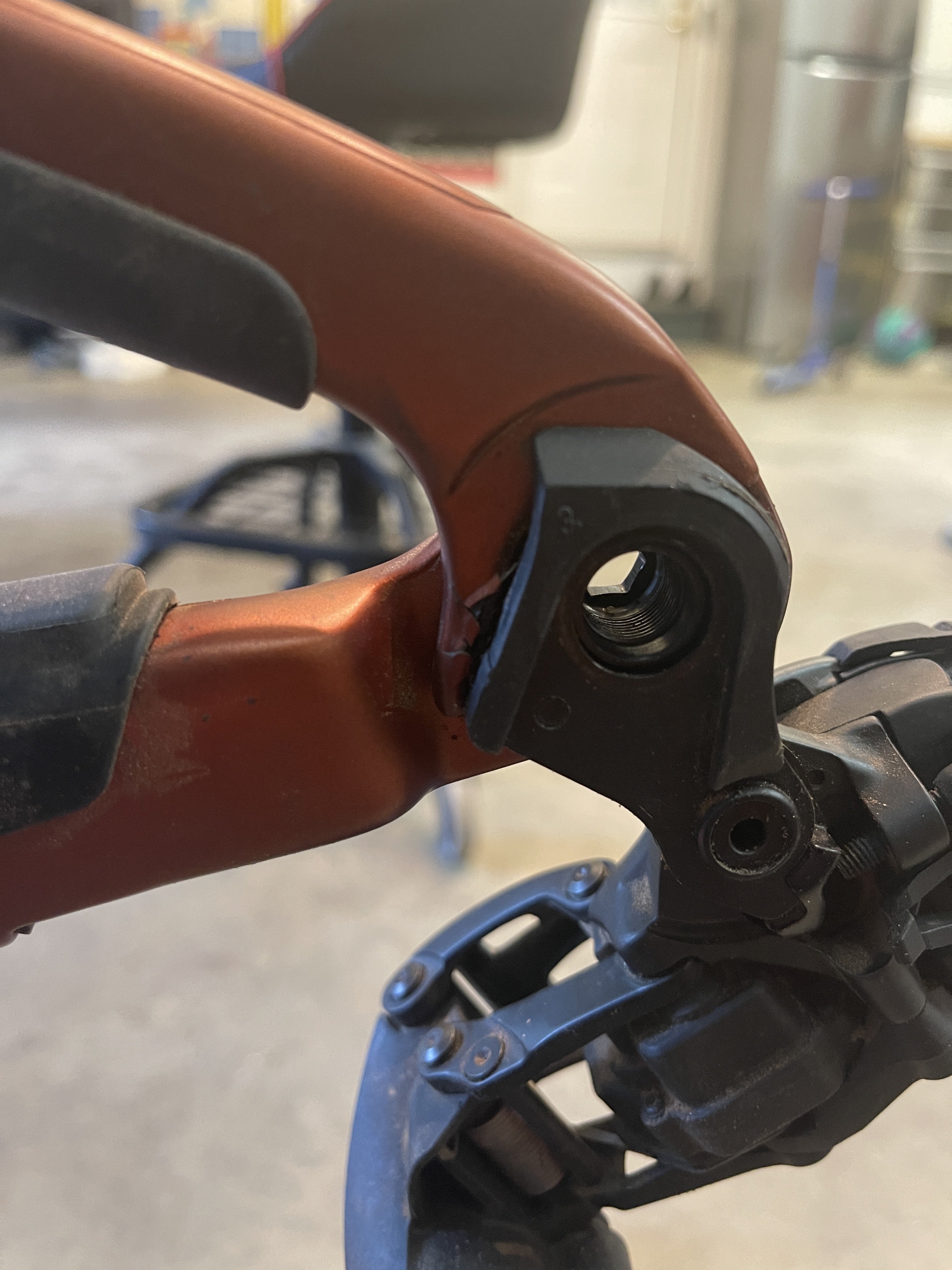

Just a PSA regarding the Sram UDH stop on the seat stay of the carbon frames - this part is very fragile. The UDH says 25nm torque, but I would not suggest that much. Enough where it doesn’t move and maybe hold the udh with your hand while torquing hand tight. The reason I say that is because I gouged my EXe 9.7 this way.
Corporate Trek local replaced it under warranty though - took about a week total.
I did use a torque wrench left hand threaded, but it seems like this was an issue on the Rail as well as I saw a thread on that.

I'm curious wow that happened. Was the UDH on the inner side not seated properly when you were tightening to 25nm?
It was seated against that stopper. I just began torquing down slowly (left-handed) and the UDH ended up pushing through the carbon stop (think counter clockwise movement like the left handed thread) before the torque wrench hit the 25nm. I immediately stopped when I saw the UDH move, but it was too late. In hindsight I should have 1) tried holding the UDH while torquing and 2) just torqued by hand as I realize now 25nm is a bit too much.
This thread shows some seat stay issues related to the seat stay hanger drop out area on Trek Rail
View attachment 122071 View attachment 122072
The joint design has too much going on. Those thin carbon blades look pretty weak. I realize that they have been doing it a long time and its their IP but its not great from a structural standpoint.
