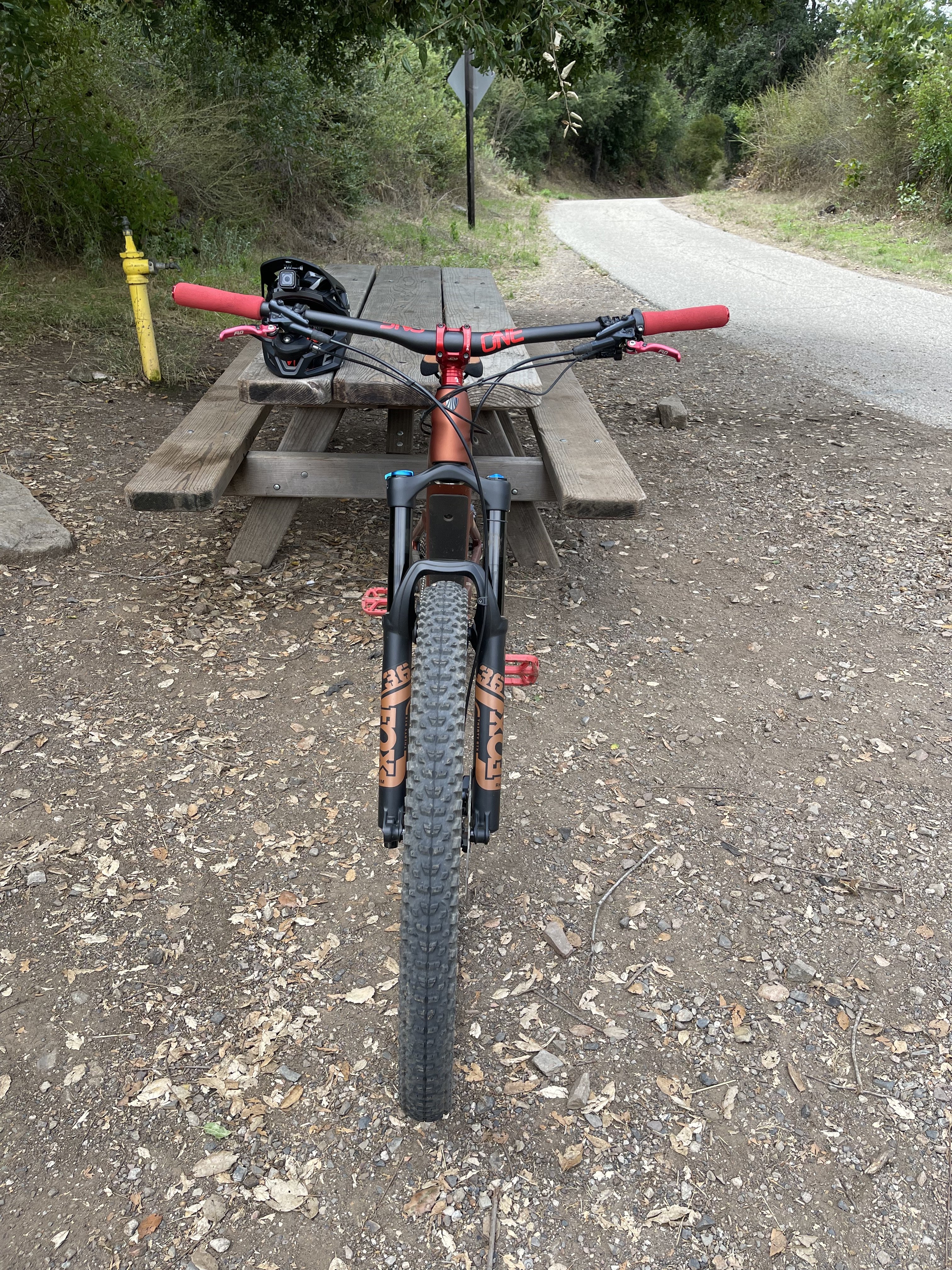

I had this and turned out my front tyre was folding on harder turns. I realised when watching slo motion video back and I could see the front tyre fold and tuck under the rim, then re grip and force the steering.
I ditched the thinner tyres for something better.
PS Rekon are pretty flimsy and 20psi (depending on your weight) might be too low.
Ok thanks for that. I’ll try 25 and see if that helps.
Sounds to me like your fork is undersprung (you mentioned running below rec'd pressure). When you use F brake or shift your weight forward, fork compresses/rear end unloads, head angle steepens, and you get nervous handing.
20psi for the F tire should be OK long as your not getting flats.
I wouldn't touch Rekon's for local terrain, nor would I trust an app much for your suspension settings.
I think the app is a very good starting point. I’ve been thinking about it this morning. Now that my suspension is broken in, it does feel way better now compared to when it was new, I’m going to go back up to the recommended pressures for my weight. And, then go from there. I have a 40 mile ride tomorrow morning. So, that’ll be a good test. I’ll take my pump with me in case I don’t like it.

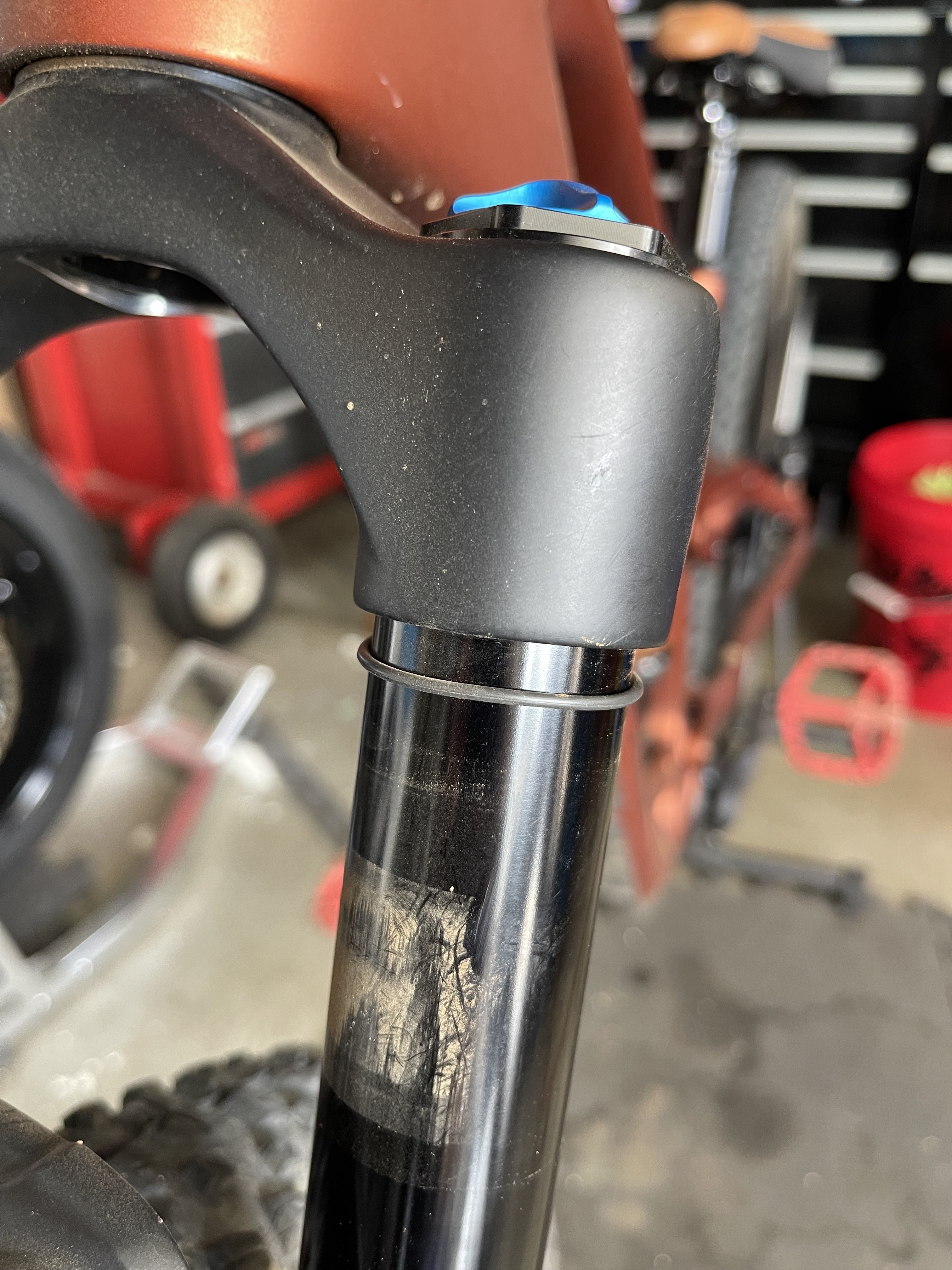

So, the only thing I’m not happy with my 9.7 is, pretty much anytime I’m going down hill, I seem to be all over the trail. Especially down hill turns, and it seems that I oversteer at the exit of corners. I was running the compression adjuster on the right leg open. I am now running it, partially closed at the 3 o’clock position and that seems to help a lot. But, the problem is still there. I’m going to up the pressure by five psi in the fork and see if that helps. I am running softer than recommended pressures. I’ve never had that problem with a mountain bike before. And I am a fairly competent rider. I am an ex pro open class MXer and I’ve been riding mounting bikes for a long time. Any ideas to help this problem, besides learning how to ride? 🤣 Thanks!
So, before todays ride I made a few changes. And they all seemed to work really good. Now that my suspension is good and broken in, I upped my ready to ride weight higher in the Trek app and I used those pressures and settings. The only difference I made was add 5 more psi in the fork. I also upped the pressure on my front 2.6 Recon to 24 psi to match the rear tire. These tires are pretty light. So, I think a little higher psi is a good idea. And, I didn’t hear the front tire pinging off of rocks like it used to. Right away, it felt better. I also tilted my seat back just a little and it just felt more comfortable to me. I’m still running the compression adjuster at the 3:00 position. So, I’m very happy with these changes. It doesn’t want to oversteer or be all over the place going down hill. And, I side a good portion of my travel. So yeah, I’m happy with it now.
