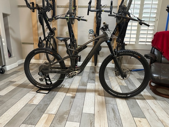

Anyone have a bike rack that hangs their fuel exe vertically? Is that ok to do that? The garage is accumulating some bikes and we are thinking getting a rack for better storage, any recommendations is appreciated.
We’ve got (2) velocirax tilt& pivots and are super happy with them. Freed up a lot of space and the bikes don’t bang into each other

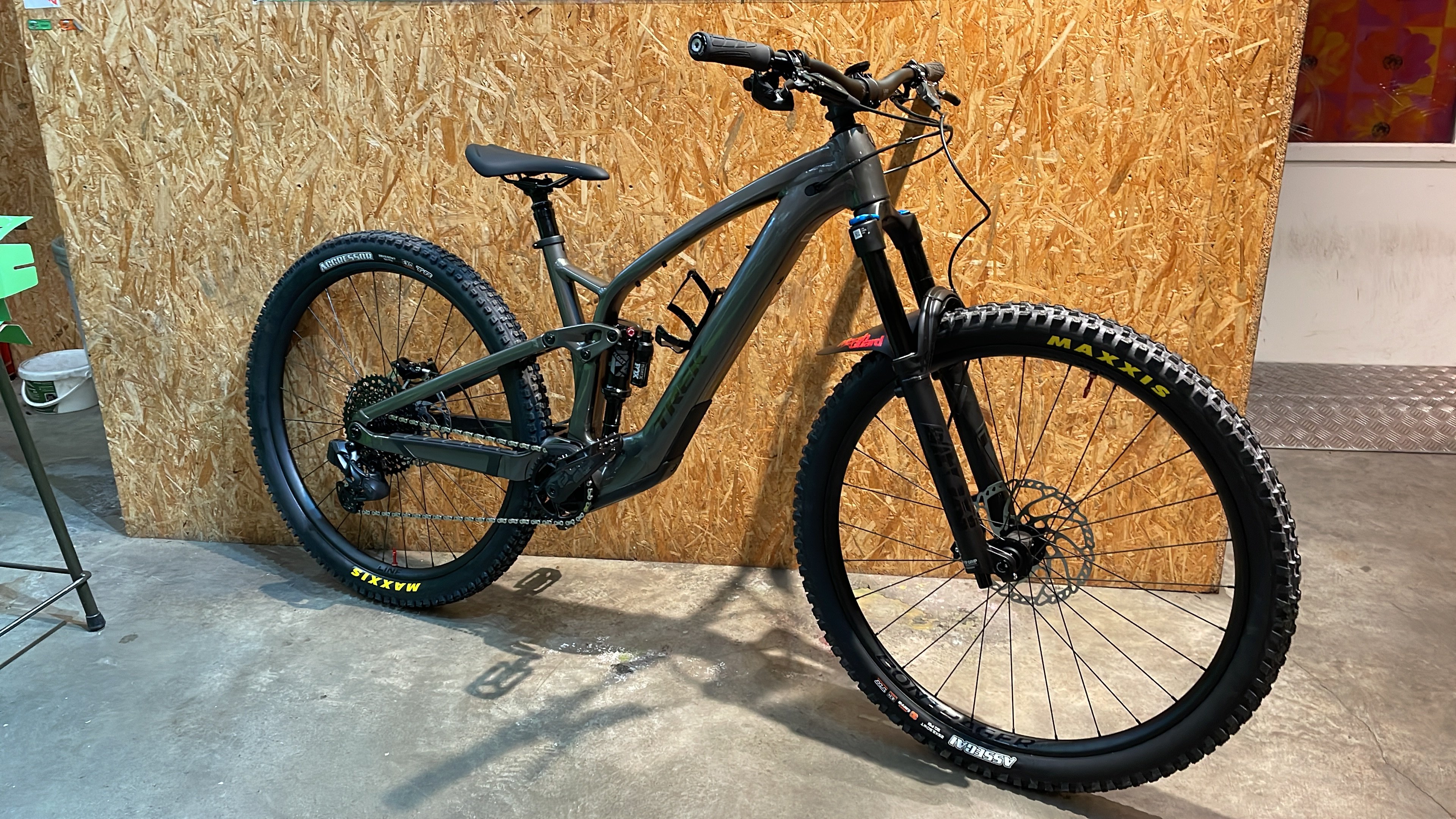

After a couple of nice years on a Rail 9.8 2020 wich I upgraded with GX-AXS and first SRAM G2-rsc and then Code-rsc's it was time for a nice EXe-8.
On the Rail I mostly ride in Eco or Tour. 80% of my rides are just over the border in Germany and Belgium and a little further away in France and off course the Alps. So I thought the EXe would suit me perfect. Was lucky to get to test a EXe-9.7 for a long weekend when my Bosch engine broke-down (code 500, so a dead one....) for a trip planned to Luxembourg. Pretty quick I noticed this test bike was gonna cost me mony, haha.
So after the summer ordered myself a nice one when the alu-version came out and the bike became a bit better affordable and also because I wanted a alu-bike again instead of a carbon. Don't ask me why, I can't explain :cool: .
First had my sights set on the Fuel EXe-8 with the AXS-Transmission, but all my analog bikes have the normal AXS so opted for a 8-XT instead in the collor Satin Mercury.
Directly swapped out some parts;
XT drive-train for GX-AXS with a XO1 cassette
Deore brakes for Sram Code RSC (frontbrake hose still needs to be shortened)
Bontrager XR5 for Maxxis Assegai and Aggressor in 2.5WT with Cushcore insert
On the list for the near future is an areshaft upgrade to 160mm.
This weekend first ride planned in Germany - Wuppertal area :)
I built my own. I can move the vertical mounts anywhere along the unistrut. This allows my to space the bikes any distance apart that I want. My heavier bikes have the rear wheel on the ground to support the weight of the bike. My gravel bikes are hanging by the front wheels.
got a few steadyracks, almost all of different models. I went with the Steady Rack E-Bike Rack, not for the weight limits but for the fender clearance.
