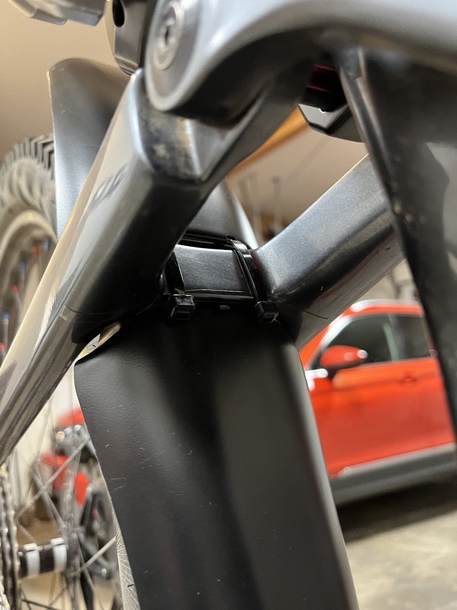

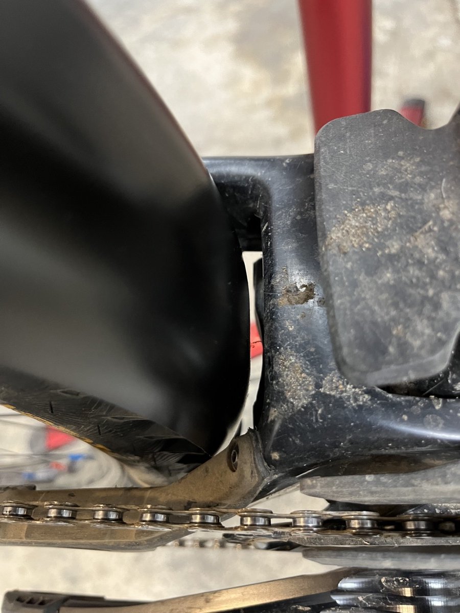

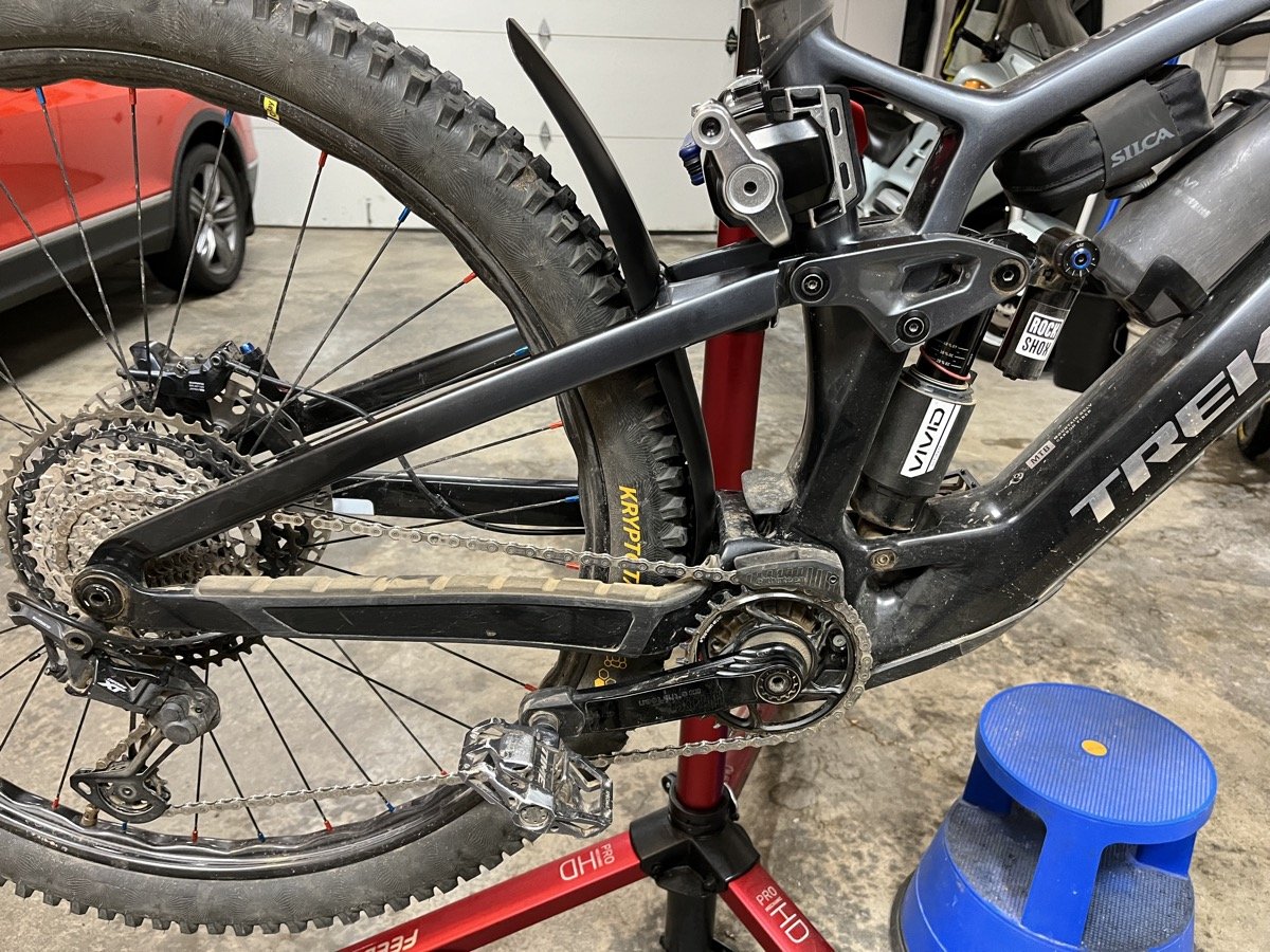

I decided to see if the sicomtbproducts rail mudguard fits.
It does. This is on a Large Exe.
I applied some clear protection tape on the contact areas. Rode it today and only heard it make any noise on some large hits. Mainly just the lower part contacting the chain stay/bb area.
View attachment 125822 View attachment 125823 View attachment 125824

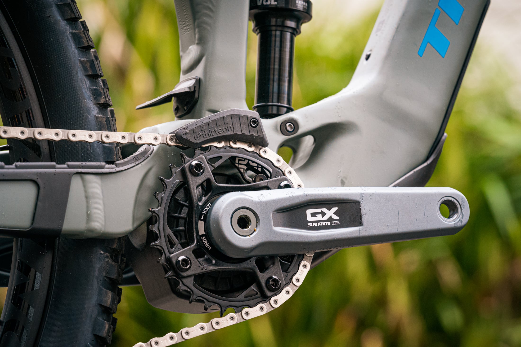

By the way, how is the new e-thirteen Helix crank going? Is the q factor wider than the stock e-thirteen alloy crank? I bought a 155mm one in an effort to stop pedal strikes now that I have mulleted my Ex-e but I have not installed it yet
I recently switched to the Forx 155 cranks and I love them. Zero strikes!
I've been on those Helix e*spec cranks for a while. Q-factor seems to be the same as the stock alloy cranks. They have not come loose. I went 160mm, maybe fewer pedal strikes but less torque while climbing too.
The cranks work well. I mainly wanted to try shorter. Still getting used to that after coming off 175s for years. The Q seems the same as stock.
