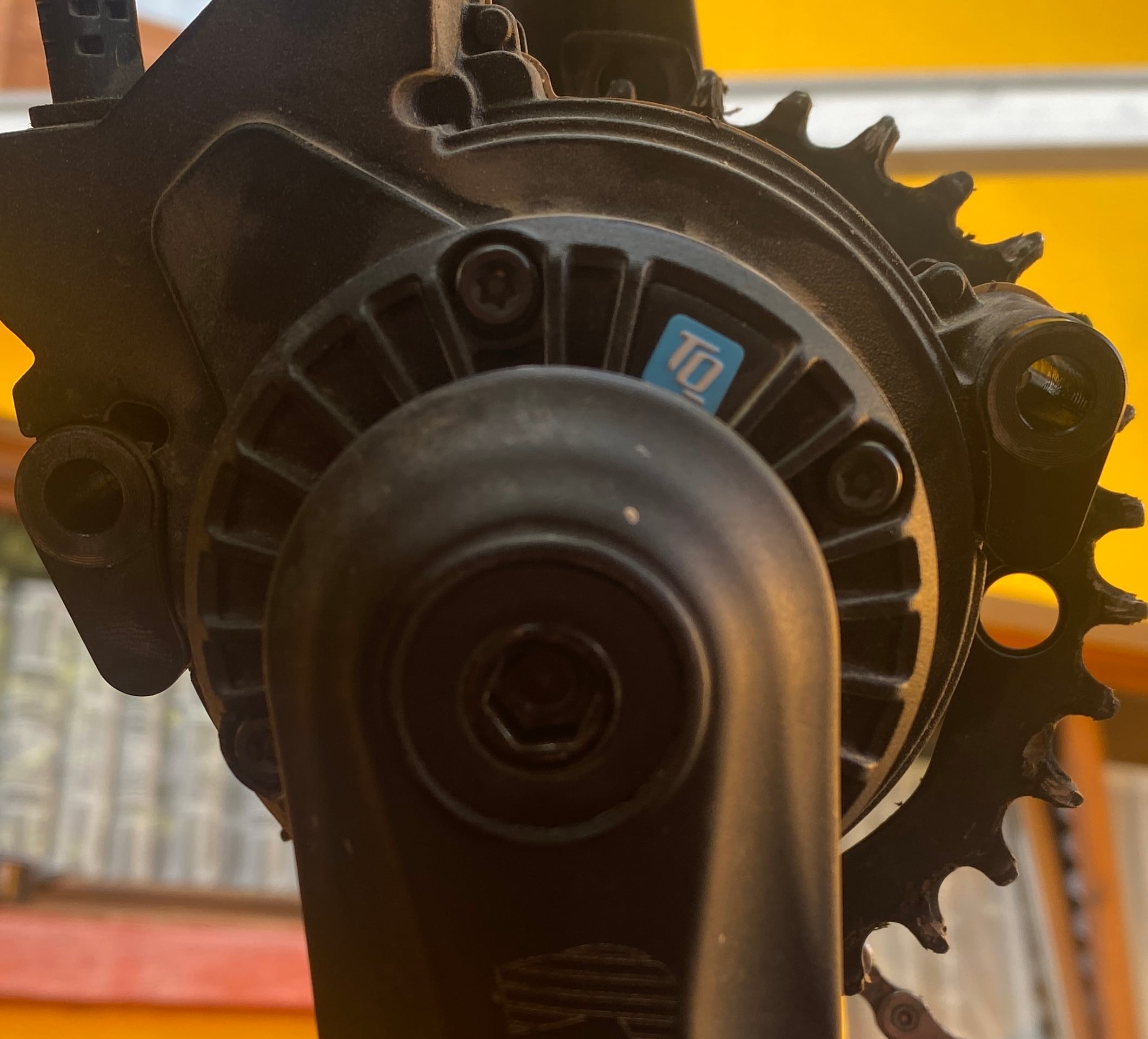

Post a picture of the mounts of your motor,I'd be very surprised if it doesn't have them.
They are adjusted using a torx bit, and to the untrained eye may look non adjustable.
I already posted some pictures in my previous post :)
I was so dumb and took two pictures from the drive side and none of the non drive side :rolleyes:
There is no Interface for any torx bit only a hollow tube where the mounting bolt goes through.
Yeah you did, they were posted while I was typing. Please Can you post some pictures of the non drive side. The adjuster are on that side.

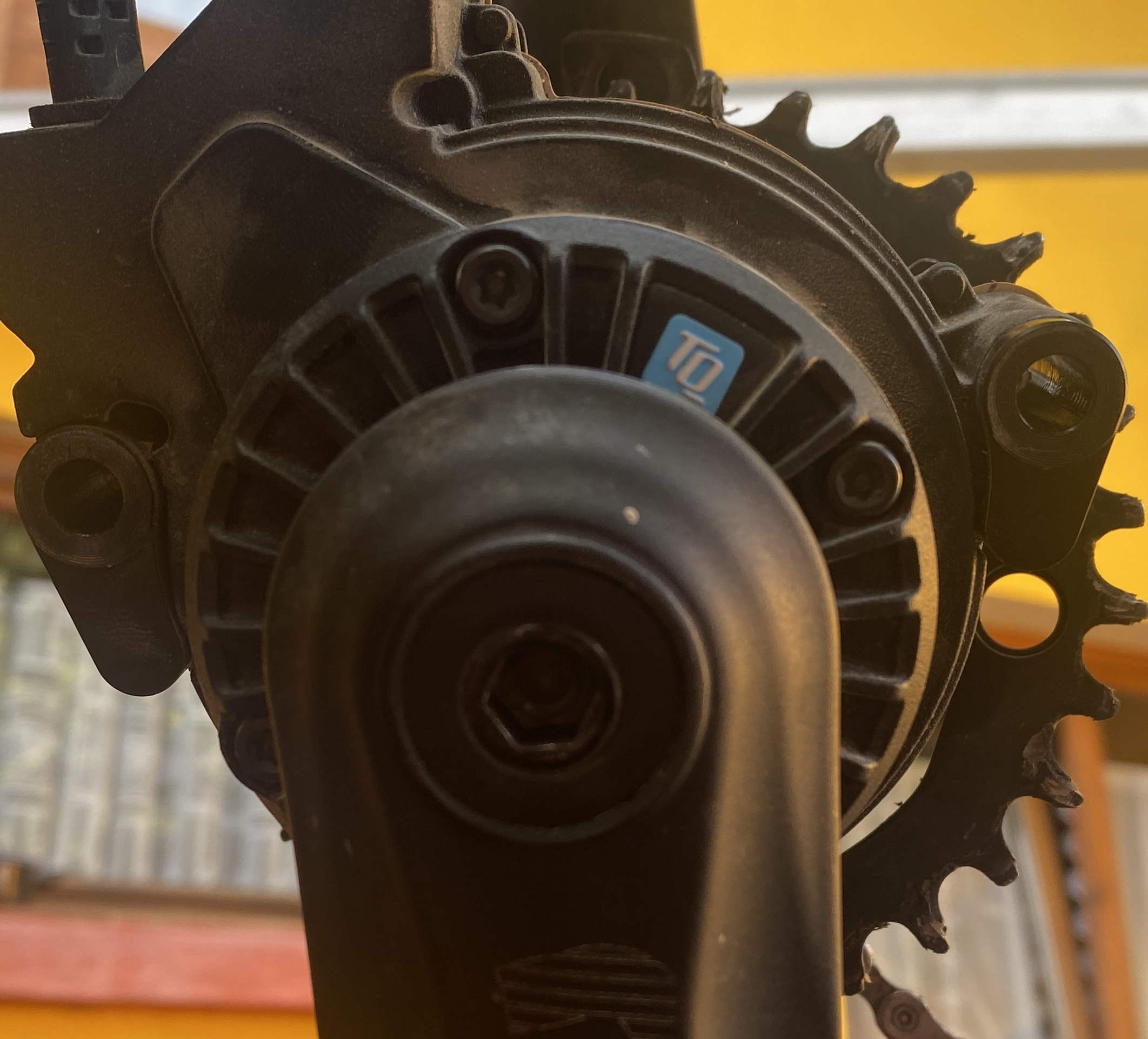

Haha,
maybe i'm not that dumb, i only uploaded the wrong picture.
If you zoom in you can see there is no torx socket.

Haha,
Ta ,yep,looks like you are missing the adjusters, you can see the inner threads that the adjusters screw into . Time to go back to trek/your shop I think,unless you just want to see if you can take up the slack with a washer or two?

There is no thread, the inner surface is completely flat and not interrupted. I think the "threads" you can see are only imprints from the mountingscrew in some grease inside the tube 😅
It has to be a completely different part i think.
Maybe a washer would do the job but it hurts myself to fix something thats wrong from the factory with a washer, especially on a bike that expensive.
But thanks for the super fast help. I will contact my dealer and wait what they say.

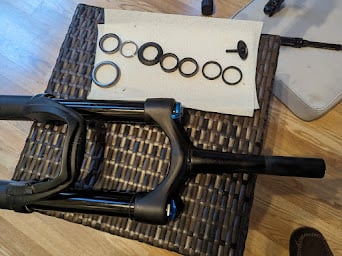

Took my headset apart tonight. I have the 9.7 bike. I noticed my top and bottom bearings didn't have the rubber seals that usually mount above/below the bearing (not talking about the seals inside the bearing, those are intact). Is this expected for this particualar headset, ? Picture below, components layed out in order.

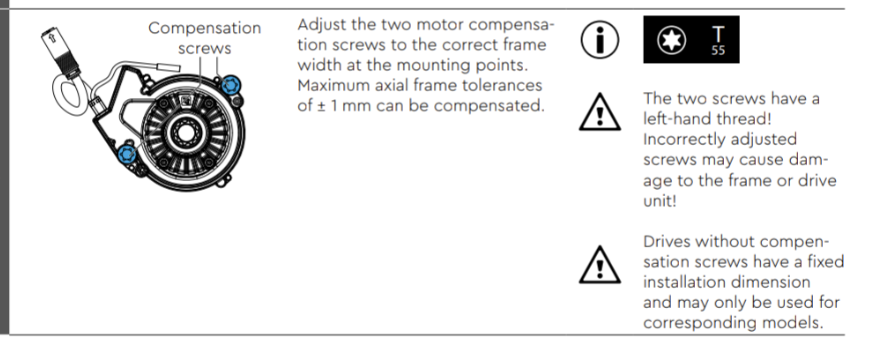

In that TQ motor install guide it does mention some motors without compensation adjusters..not sure what the description means though.. fixed installation dimensions for corresponding models? shrug

In that TQ motor install guide it does mention some motors without compensation adjusters..not sure what the description means though.. fixed installation dimensions for corresponding models? shrug View attachment 120137
I think the interpretation is correct, " corresponding models" are probably checked at frame manufacture stage to be the correct dimension for the fixed motor mount widths, but given achievable mass manufacture tolerances I can see how this leads to creaking in some new bikes. Compensation screws seem like a good idea....

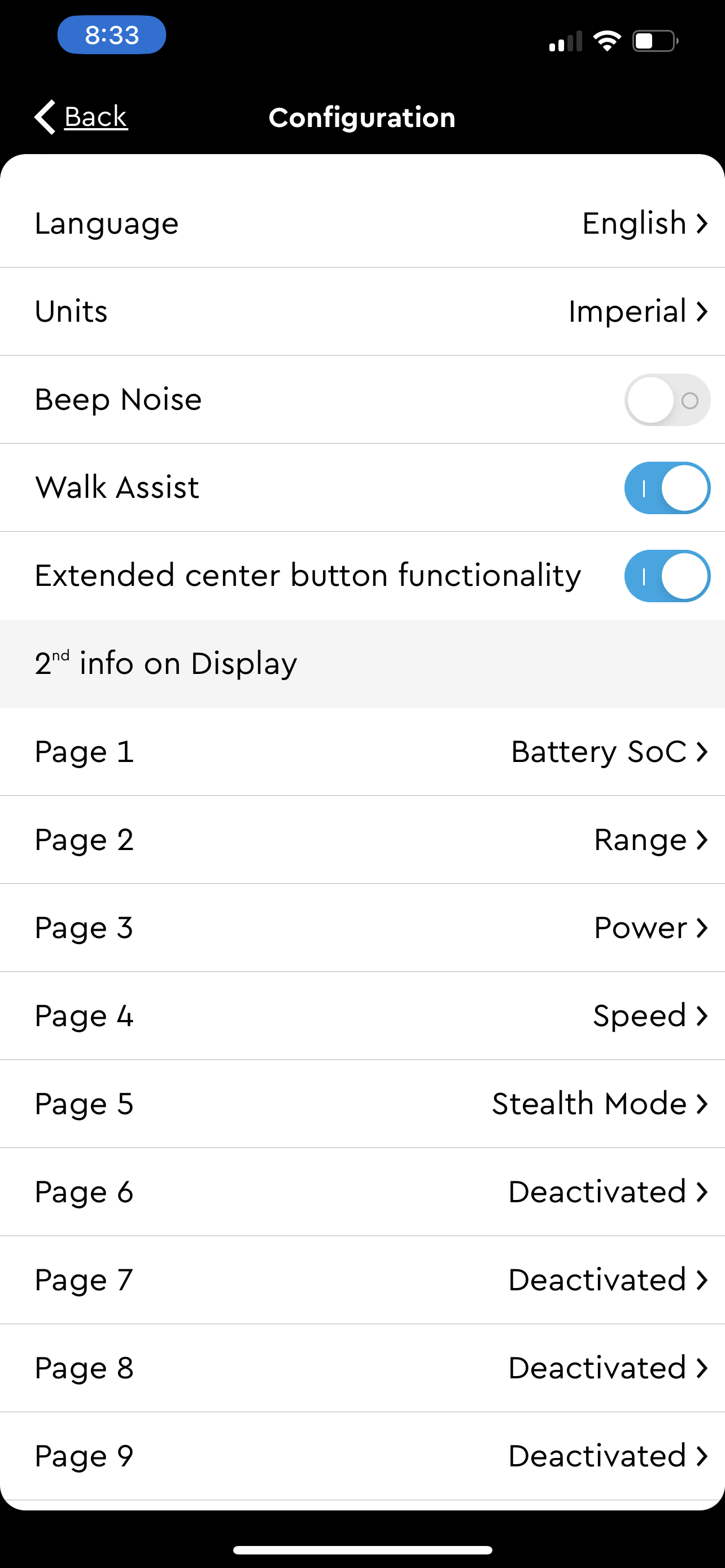

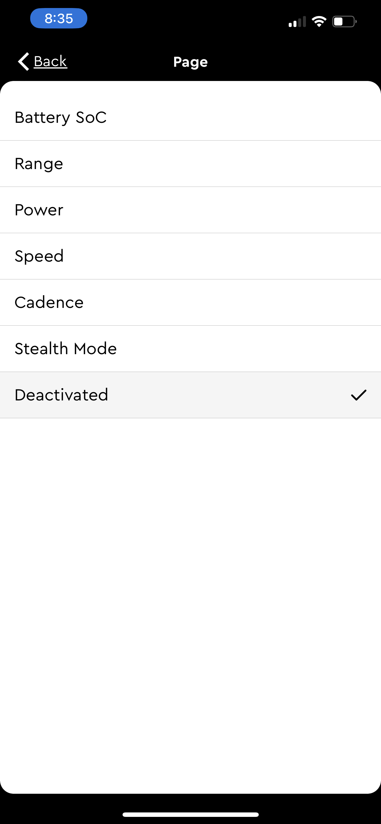

I finally had a day to drive to Trek (corporate owned/bought out store). I had scheduled an “on the spot” firmware update over the phone the day before. I had not had any updates since purchasing my bike on 11/30/2022 so I figured why not. It took half an hour and they tried to charge me $36.xx but I argued the guy on the phone said simple updates they wouldn’t charge. So they tossed the service ticket. Meh. I still have my one year level 1 service so I may use that for another free firmware update in November if there is one.
Anyway enough rambling. I noticed something my TQ app allows now but I’m not sure if it’s related to firmware update to TQ app update. TQ app version 1.3.2b1
Before if I turned off walk mode it said it could not be done. Beep noise can be toggled on/off. Also, I can now enable stealth mode but it’s not fully stealth which is kind of annoying. Also the “extended center button functionality” works. What I find it does is a single click brings the motor up power levels and then back down in reverse. Double clicking the center button changes the pages. There is a cadence page and stealth page option along with deactivated option for pages.
I do not know my firmware version. Trek did not have any printout for me and I don’t know where to find that information in either apps.
I added pics and video if this is interesting for anyone.

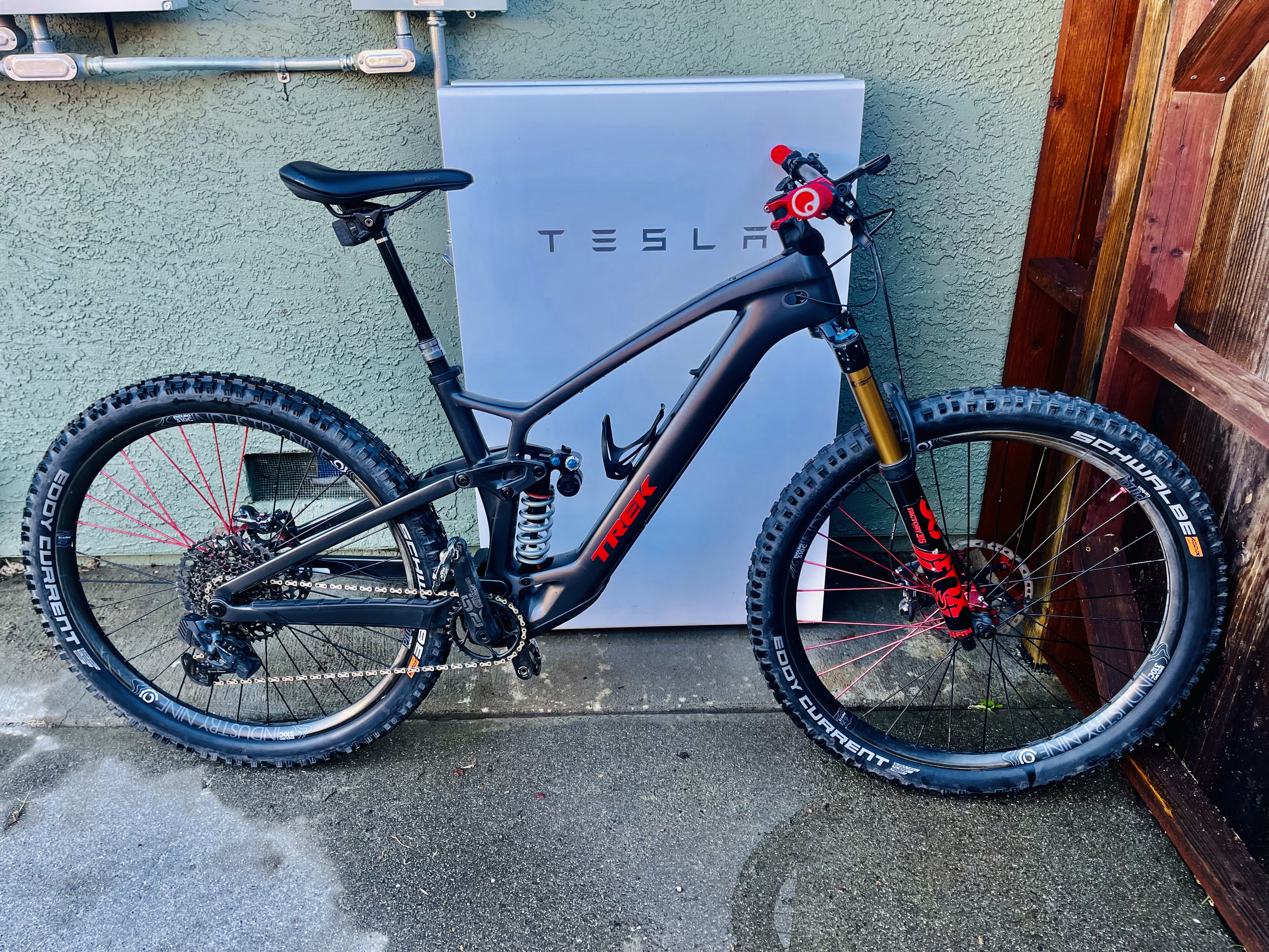

This is how we run my partners Specialized Turbo Levo. It was 29” stock and she kinda hated it. So much she was riding her meat bike even when riding other eBikers! She’s 5’-6”. We put a 27.5” 170mm fork on it, 27.5” wheels with 2.5” tires. I have to say it rides great!
We’ve run the geometry in both Hi & Low and she prefers low (which is real low). You can run the rear shock with less sag, so you have a lower static BB/CoG without It spending so much time deep in the travel.
If I was in your shoes, I’d buy/borrow a 27.5” wheelset and try mullet first. If you go full 27.5” I think you want the 170mm/27.5 fork too. You lose some roll-over with the smaller front wheel, so adding travel compensates for that and keeps things comfortable.
