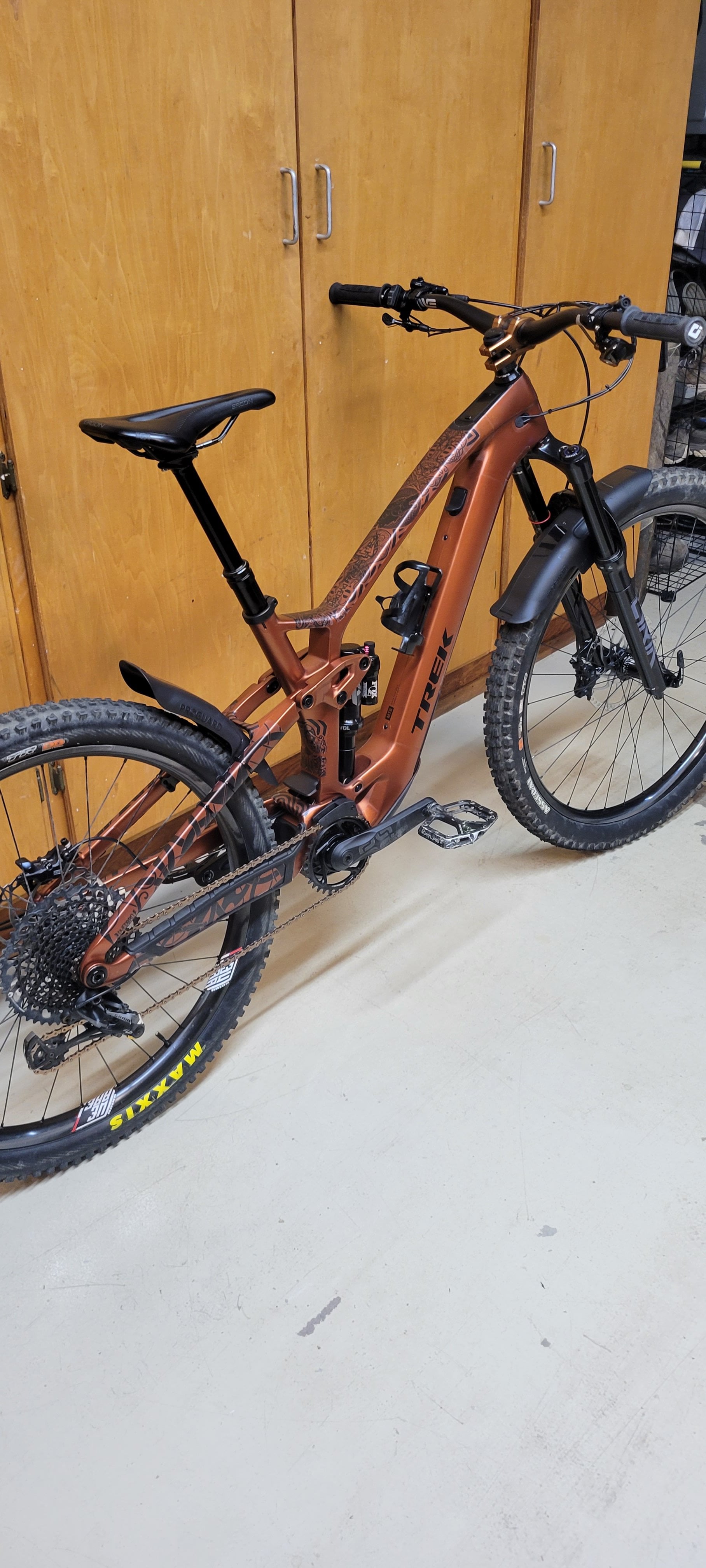

Picked up a 9.7 a month ago from my local shop. I liked all the colors but this one caught my eye most. I've since upgraded the following permanently - stem, bars, X01 AXS, BikeYoke dropper, Dominion A4 Brakes/Rotors and i9 Carbon 31.5 hoops. Temporarily, I moved my Zeb over from my EVO to see what the 160 travel felt like.
My initial take on the bike stock - poppy and super fun on medium/groomed trails with the ability to do many more miles, of course. Stack height is lacking quite a bit.. added a riser bar and i9 stem flipped to get a more comfy riding position. SLX brakes lack in the heavy hitter category where I like to be so they were the first to go. I lean more towards gravity fed trails/extended downhills with random drops and rock gardens. The fork changed everything. Running low BB with dual 29 and a 160 fork really helped keep the front end up. The Zeb is burly anyway as well as weighing in the same as the Rythm so I though I would need to upgrade to a Zeb as well after testing it for a few weeks. Instead I spent the 75$ on a 160 airshaft from Fox for the Rythm and I have to say I'm very impressed. At 170lbs I pulled one token leaving a total of 2 and cleaned out the excess fox grease and it's pretty butter. If I every feel I need to drop a half pound or gain more rigidity in the future I'll upgrade but for now I'm liking the Rythm. Moving to X01 AXS allows me to keep all of my bikes maintenance the same and share parts if I'm in a pinch. Swapping that from the SLX/XT group shaved some weight as well as the carbon wheelset but EXO+ casing Assegai and DHRII added all of that weight back on. It's sitting at 41lbs as pictured and is riding great. It's not as much of a basher as my EVO, which I've kept, but it get a lot done well and I can still scandi-flick it around a corner with some extra umph on the way out. I'm getting close to the 3k' as advertised for range +/- depending on the terrain.. super technical climbs take more juice, extra boosted steep gravel road climbs do the same whereas if I have extra time I can same much more energy.
Items that popped up since picking this up - crank needed the 50nm treatment to get rid of the creak that started day 2. Lower shock bolt has now been torqued to 15nm after rattling for a while - keeping an eye on this per the forum. Finally; I've noticed the dreaded motor noise between pressure and coast coming from the TQ. If y'all hadn't said anything I probably wouldn't have heard it over the Hydra hubs screaming. It seems to come and go or my style of riding doesn't get to the point of noticing it as much as others but I'm keeping an eye on it and notified the dealer as well. For the future - I was thinking of a coil shock to soften the rear up a little.. it's a XCish trail bike after all but the Float X has really impressed me. I'll leave that alone for now. I'm not on forums much nor monitor but there was some really great info here so I though to share my experience. Hope this helps others!

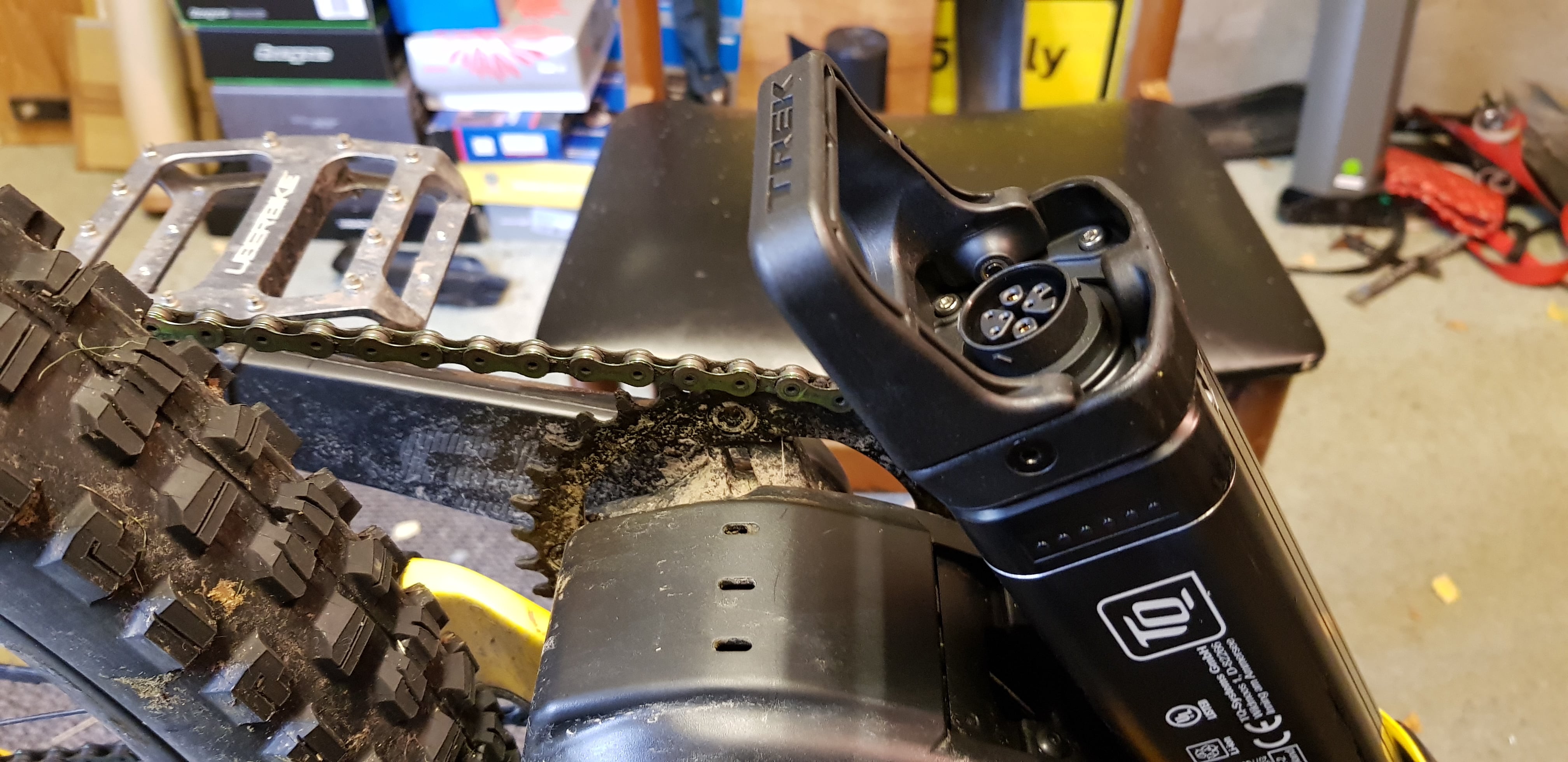

I would suggest that, when you get a minute, you all slide your battery out of the frame and check its orientation.
If the orientation is such that the LEDs are on the non-drive side of the bike then that is wrong (as was my wife's) and you will not be able to charge the battery out of the bike as is.
The end caps were incorrectly connected by 180deg at both ends and, with the pull handle positioned as it is, it is not possible to connect the charger cable into the port as the 90deg bend on the cable cannector is hard up against the plastic handle.
Page 15 of the service manual specifies that it should be done in the correct manner - but unfortunately Trek have assembled some battery packs incorrectly, slid them into the downtube and delivered them to bike shops around the world. I needed to check that I could charge the battery outside the frame and I'm so glad I did.
It didn't help my understanding of the issue that the separate schematic of the relationship of the orientation of the charge port vs the LEDs was also wrong in the manual with the port shown out by 180deg.
My wife's bike is the 9.9 AXS XX1 but this issue can affect each and every model in the entire Fuel EXe range - so be aware.
TQ knew of the problem and had had discussions with Trek Production about the issue but still some will doubtless be 'out in the wild'.....it's not a TQ error, it's a Trek assembly error.
My own 9.9 AXS XX1 is due the end of this month and this will certainly be an aspect for me to check - my bike shop are also now aware.

In the Service Manual, page 15, it looks like the end cap orientation can be easily corrected, if necessary. Only four screws hold on each end cap. If that's the case, this should be an easy problem to solve.
XrayZulu
Nov 8, 2022
30
20
That is how it is corrected, at both ends, so it is solvable but that wrong alignment allied to an incorrect illustration of the charge port vs LEDs arrangement gave a couple of confusing days.....

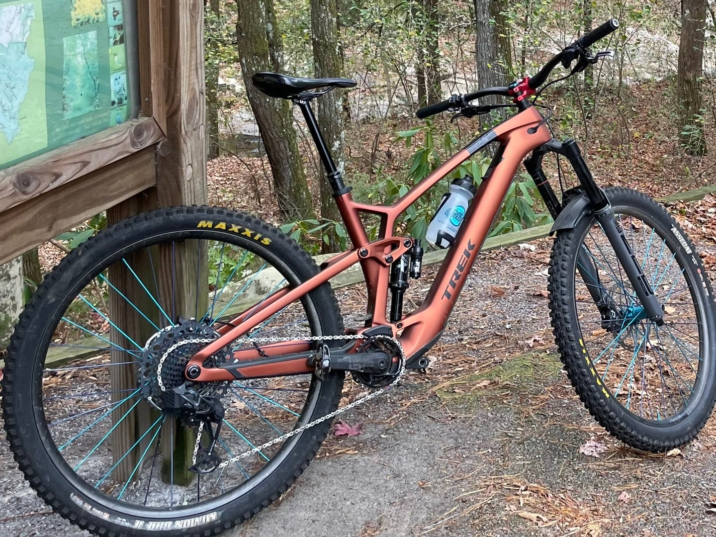

Just got my 9.7 in Matte PennyFlake over the weekend. Had to drive a little over an hour to pick it up (central San Diego to South Orange County with some traffic).
Just one ride so far, but completely blown away--mainly because it feels so natural with the light weight and power delivery.
This bike now sits next to my Santa Cruz Heckler 9 MX and Stumpy Evo. Unfortunately I can see my Evo getting a lot less ride time now.
Here are some pre-ride pics.
(Edit: the Trek bike shop could have done a better job setting it up, though. Among other things, the cockpit cable/hoses are a bit too long and need to be trimmed)
View attachment 100634 View attachment 100635
