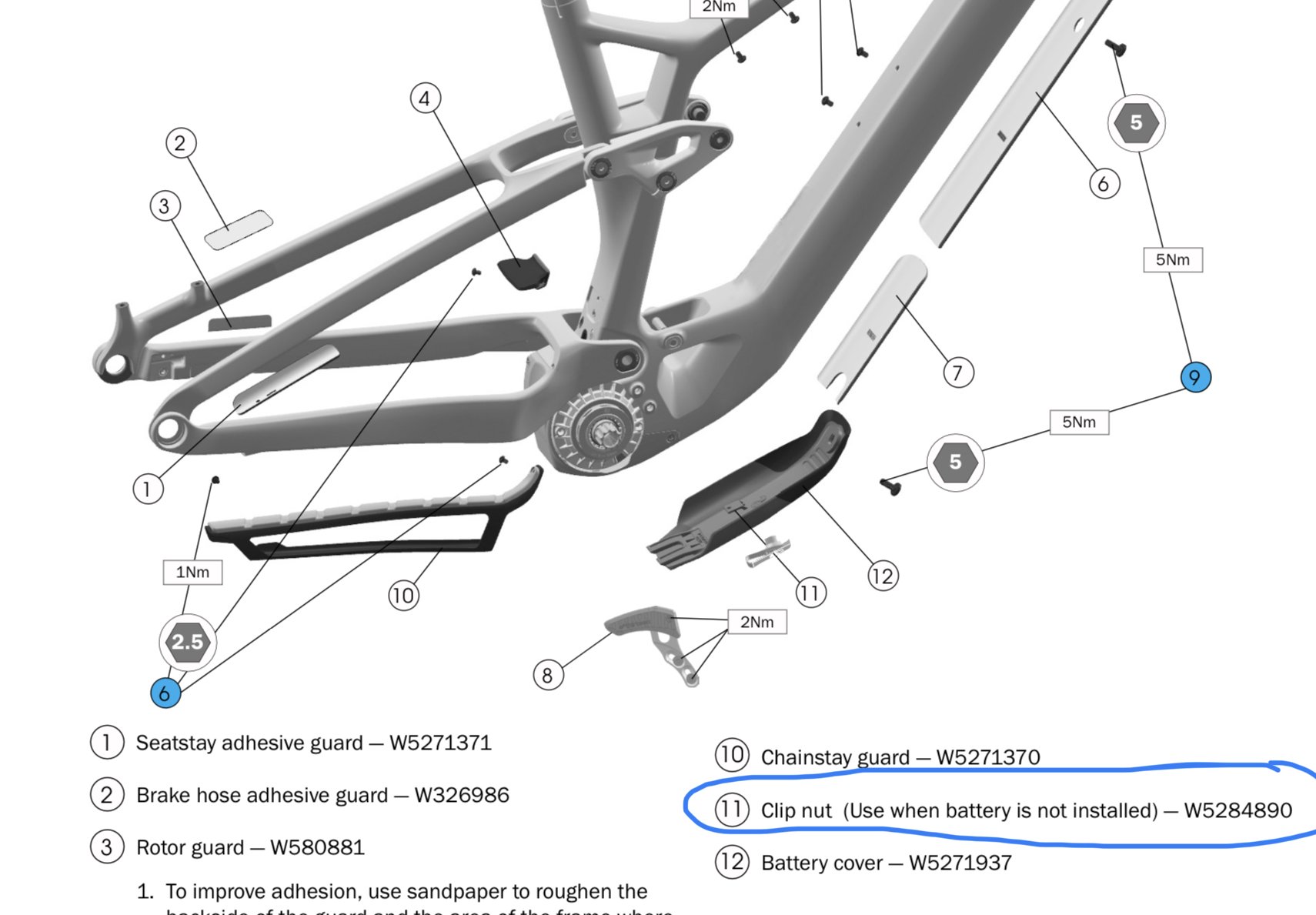

Far as the holes for battery holes, I'd probably just put electrical tape over the upper hole, and then the lower one you'll want to have in place to secure the lower cover. Someone here suggested having a spare lower battery bracket to secure that bolt/plate.

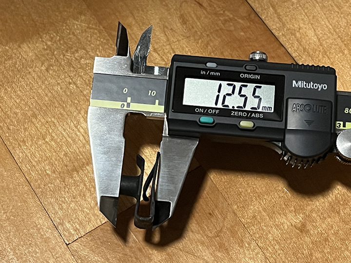

There is supposed to be a clip on the inside of the battery cover (bottom plate) that can be used to reattach the plate without the battery inside. The bolt screws into the clip then. Mine was missing However.

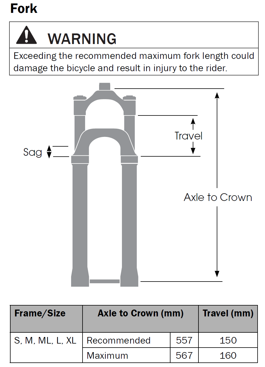

Hey all. I know that going too long on the front of the EXe voids the warranty, but does going over on the stroke of the rear shock also void the warranty (assuming clearances are okay)?
Almost certainly. I would always assume that any manufacturer will tell you the frame has been tested using the shock specs (stroke and eye-to-eye) listed, and use of a non-standard shock will void the warranty. That said, you could always message Trek and ask.
This is correct. I spoke with Trek corporate about this last week actually. Technically it's untested and could cause a warranty issue. But their warranty process is case by case looking at the details of what happened. So if the extra stroke contributed to the warranty-related issue somehow, it would be problematic. If totally unrelated issue you should be fine.

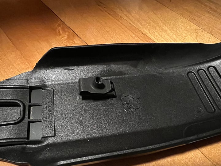

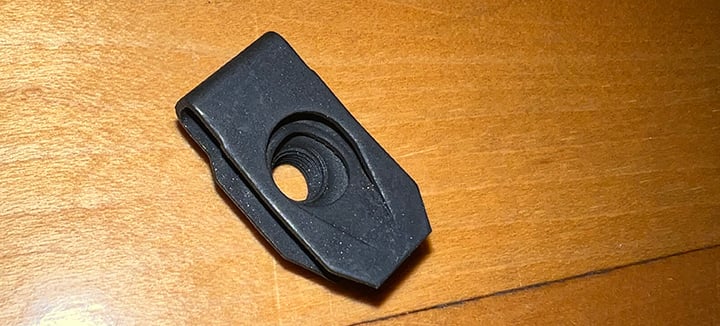

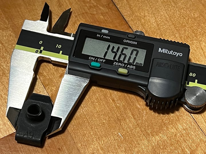

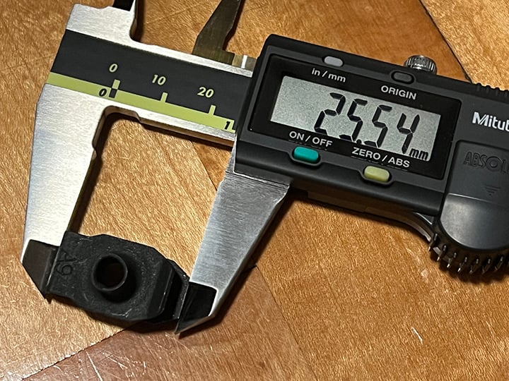

Here's some pics of the clip if it helps anyone.

Thanks for this you guys! Given the potential problems, then, I think I'll stick with 140.
If the manufacturer is smart they will list all the requirements up front as 'outs'. On a high level they list total vehicle weight of 300lbs, a '160' fork (no axle to crown height given, which would have been the smart way to spec it) and 205-60 rear shock. Clearly hacking the software or dicking with the motor is an implied no-no.
Conversely, all the torque specs in the manual appear to be negotiable currently (lock ring and lower shock bolt to name two) so maybe they don't have quite the handle on their side either.
The slightly longer stroke does get the expensive parts lower to the ground though by ~5mm. Little bit of trade though. longer fork moves things up, longer stroke shock moves things down. A bit of a wash.

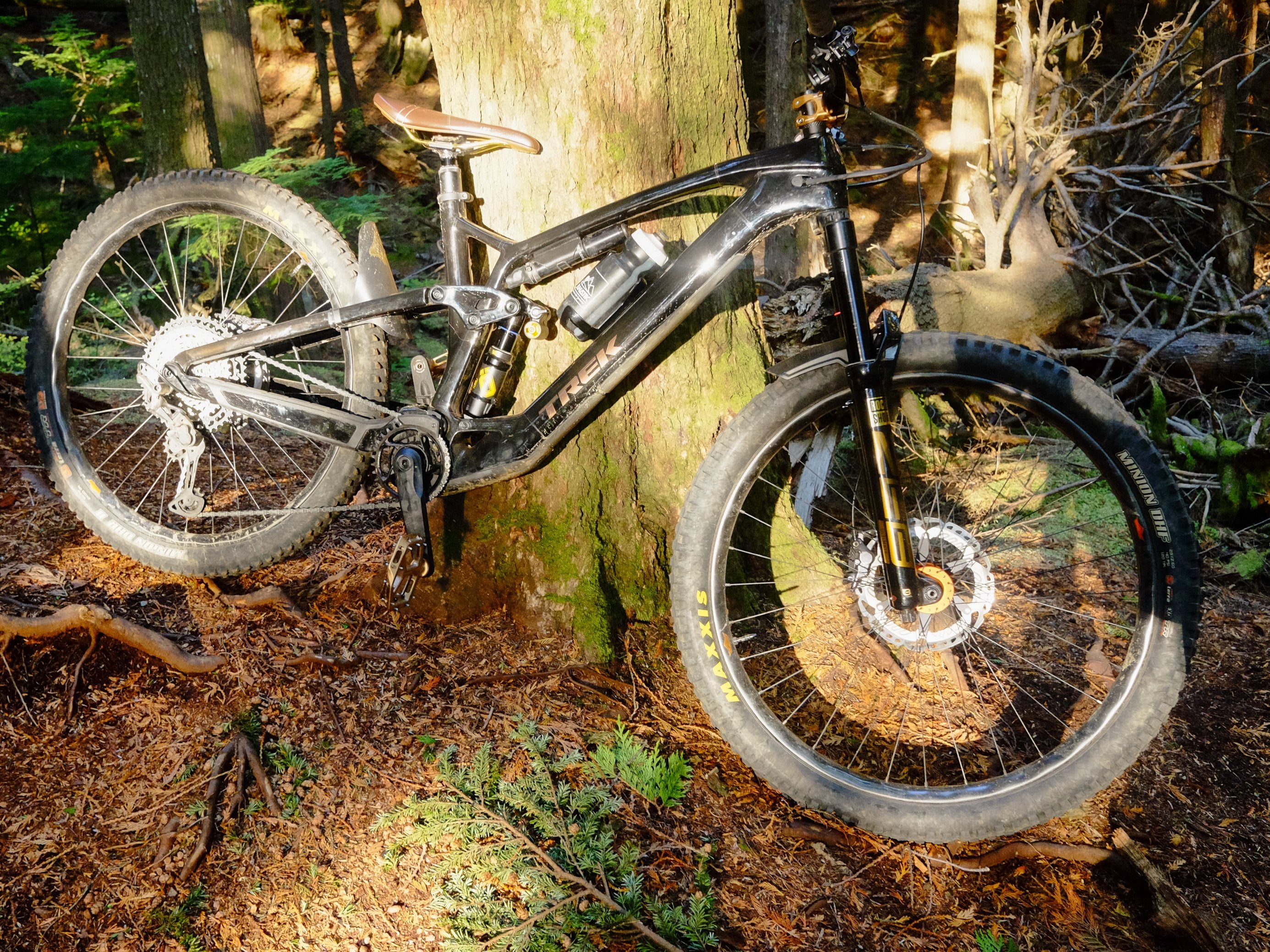

I’ve mainly been riding around dusk and haven’t had too many opportunities for photos. But a lot of great riding and upgrades have been been happening! Conditions have been dry & cold here. I think the cold temps reduce range. I did one ride that was 14 miles, 2800’, mix of trail and Boost (with max boost settings) that killed the battery. But several other rides in the 3300-3600’ range, mostly trail, with 20% left at the end. Overall I’m very happy with the bike especially now that I’m getting the suspension dialed in.
Since my original build:
Zeb 160 Ultimate, 2023, 2 tokens, slik graphics
Ohlins TTX1 rear shock, 205x62.5mm
OneUp 210mm dropper post
Chromag Lyft saddle (stolen from my other bike)
Jank components pump holder

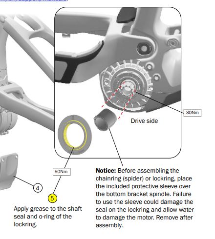

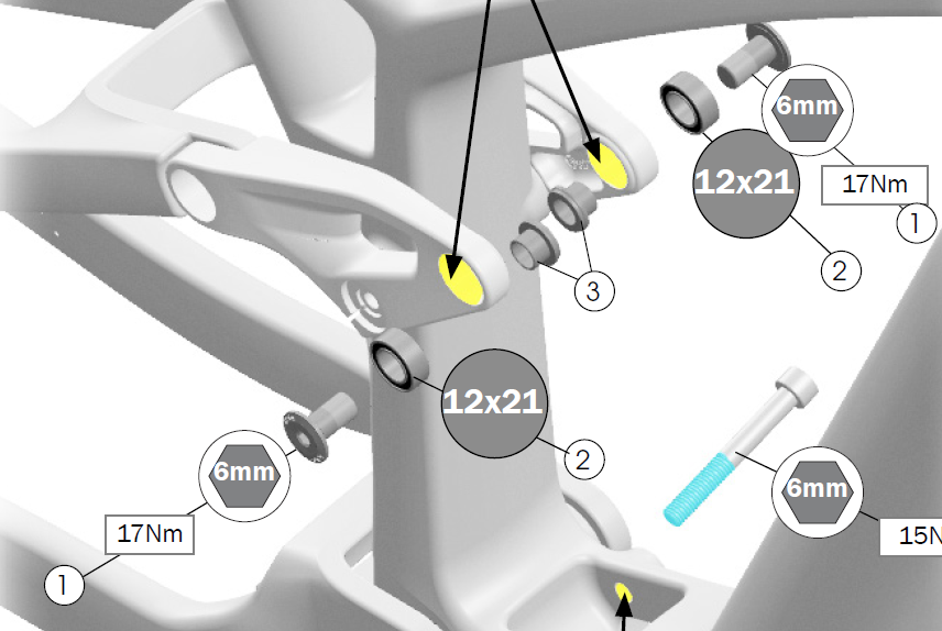

I've been hunting a creak on my bike, which ended up being the hub driver. But my first assumption was a loose motor lockring which a lot of people have mentioned.
So first observation is that the lockring itself says 30nm torque, but the trek service manual say 50nm.
Also, the service manual has this somewhat ominous warning about using a protective sleeve. None was included with my bike- Did any of you get one?

  • Clip attached to inside of the lower battery cover (some reported this missing, but this should be there from factory)

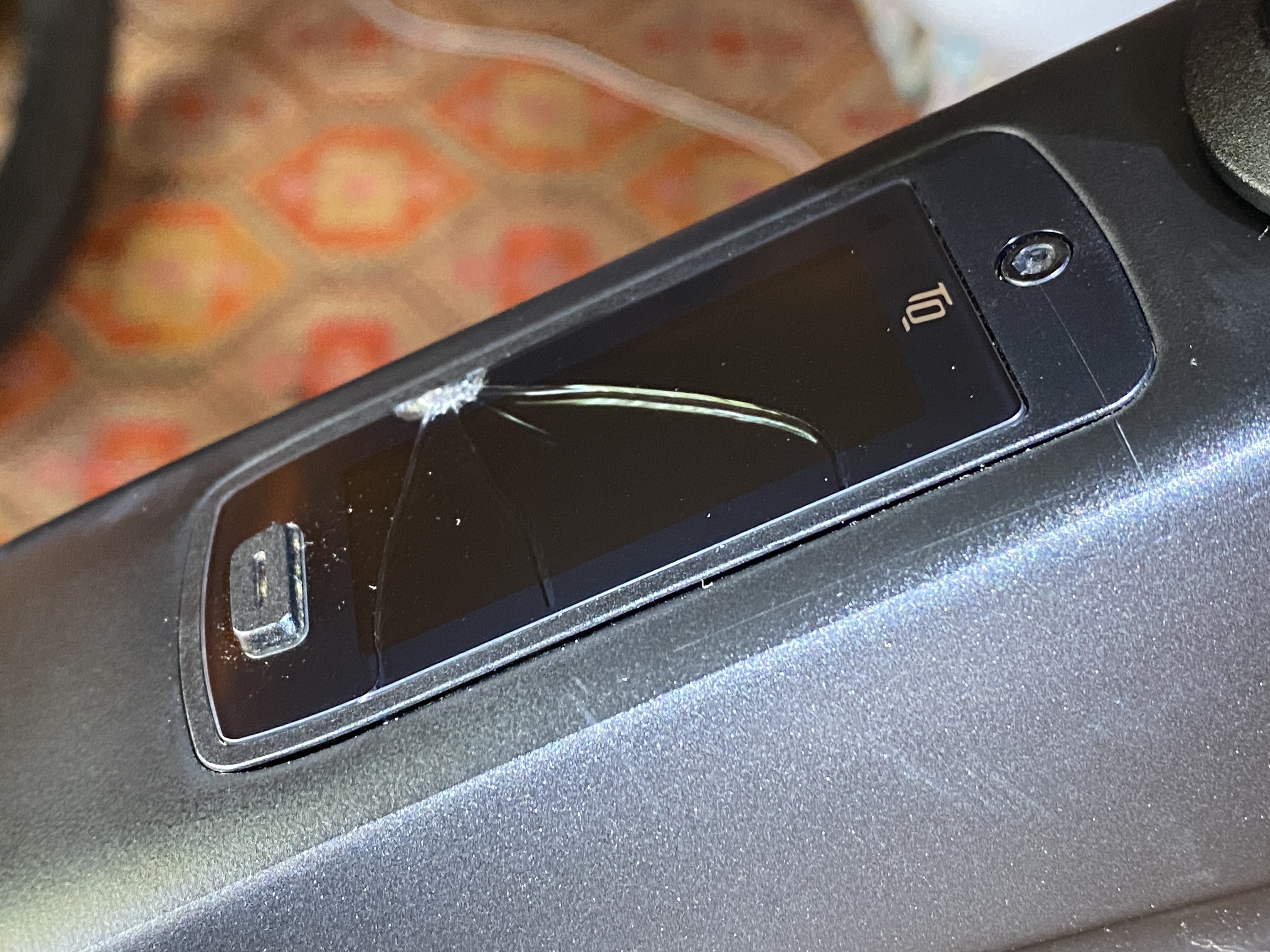

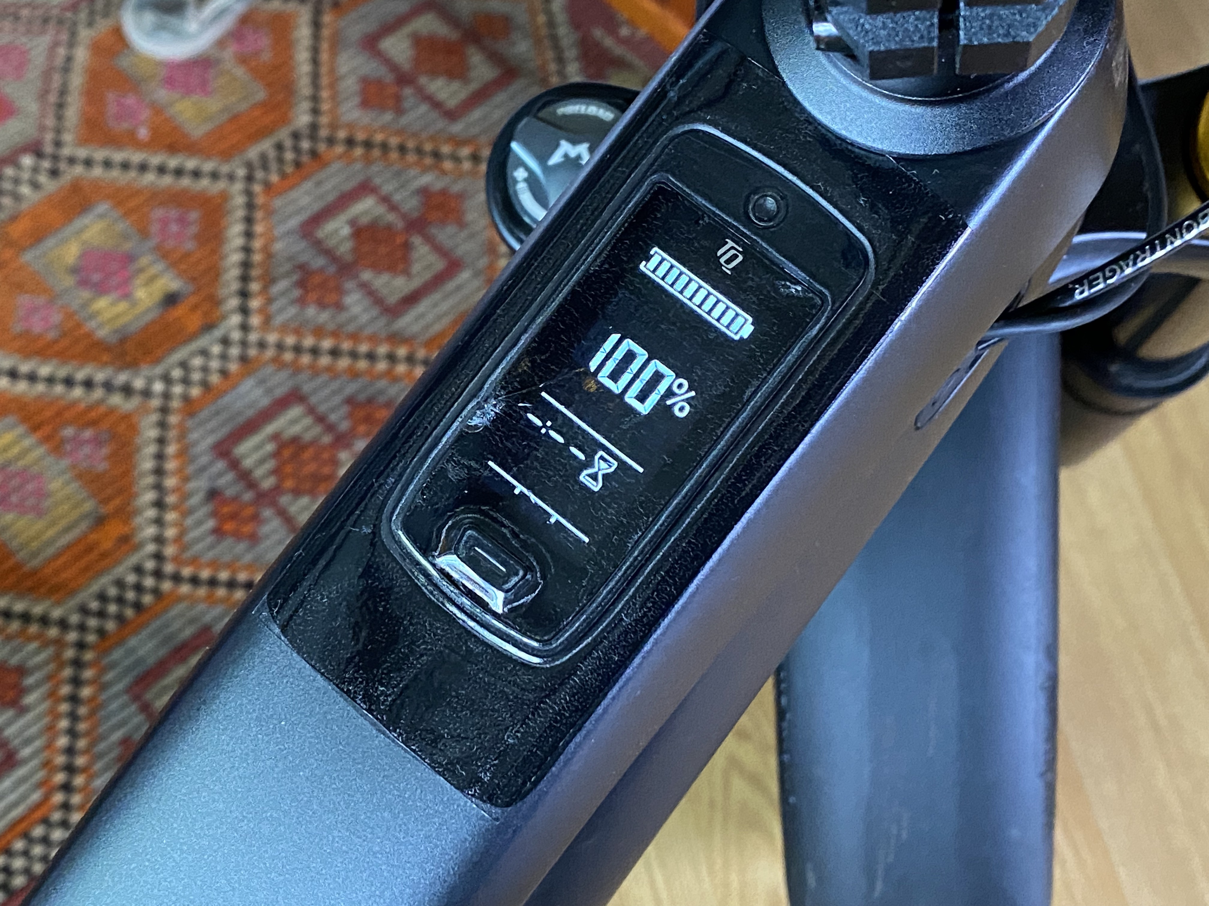

Highly recommend taking a piece of frame protector type tape and covering the display. Unfortunately my Bontrager BITS tool slipped out of my gloves and dropped about 1" onto the edge of the display 🤬 Also the other edge of the display has a slight space between it and the frame, and it probably a prime spot for water to get in, this should fix that too.
DugT
Sep 4, 2022
136
119
Truckee, CA
I'm not an engineer but I don't think tape is thick enough to protect the glass in that situation. It's great that the display still works, at least so far.
Chris James
Nov 12, 2022
Big Island of Hawaii
since I've got nothing much to loose, I just tried recreating it by dropping it again - but w the tape on - and no problem. Truth be told, I do have two layers of tape now. The problem is that sharp hard metal edge of the tool and the glass edge that's the problem, so the thick vinyl tape does help.
