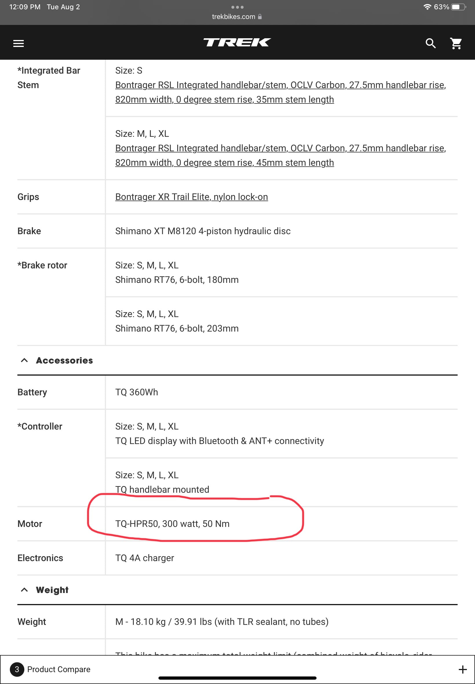

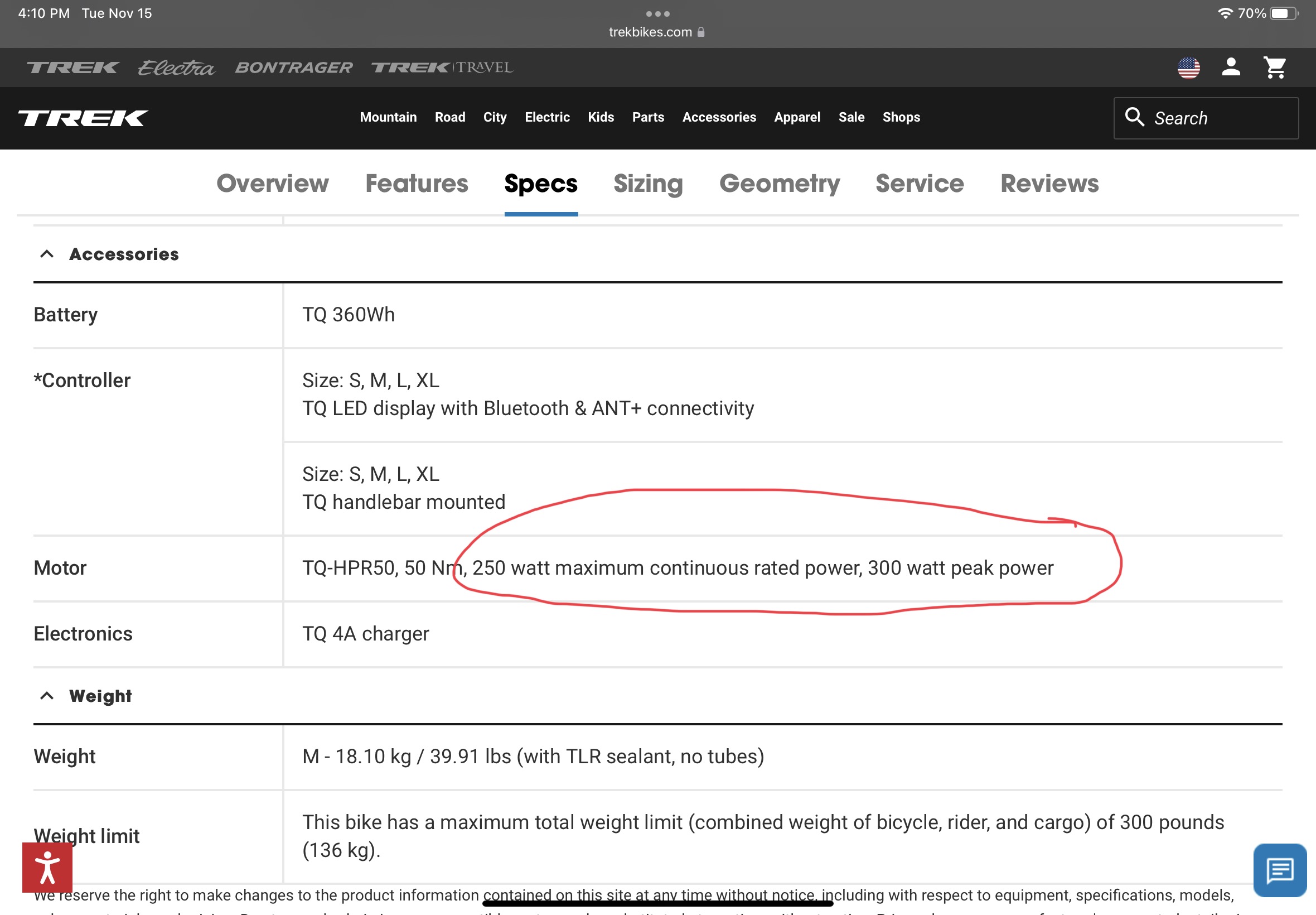

Did TQ just change the motor power spec?
i just came across something that may be evidence of some motor reliability issues.
when I read through the current specs on the 9.8XT EXe today, I saw a different motor spec than when I ordered my bike back in July and took some screen shots of the specs. I added the screen shots below. Does @Roman from TQ or anyone else know why this changed? First pic is Original spec of 300W. Second pic shows current spec of 250W continuous with 300W peak power.
Was there a change? If yes, why? Will that change be applied to existing bikes with firm ware updates?
I think that's just a terminology thing, all motors have to have max continuous rated power of no more than 250w to be legally classed as a pedelec in the EU. Peak power can be way higher than 250w,and is 300w in the case of this tq motor,but other motors like Bosch gen4 have the same max continuous rated power of 250w,but their peak power is something like 600w

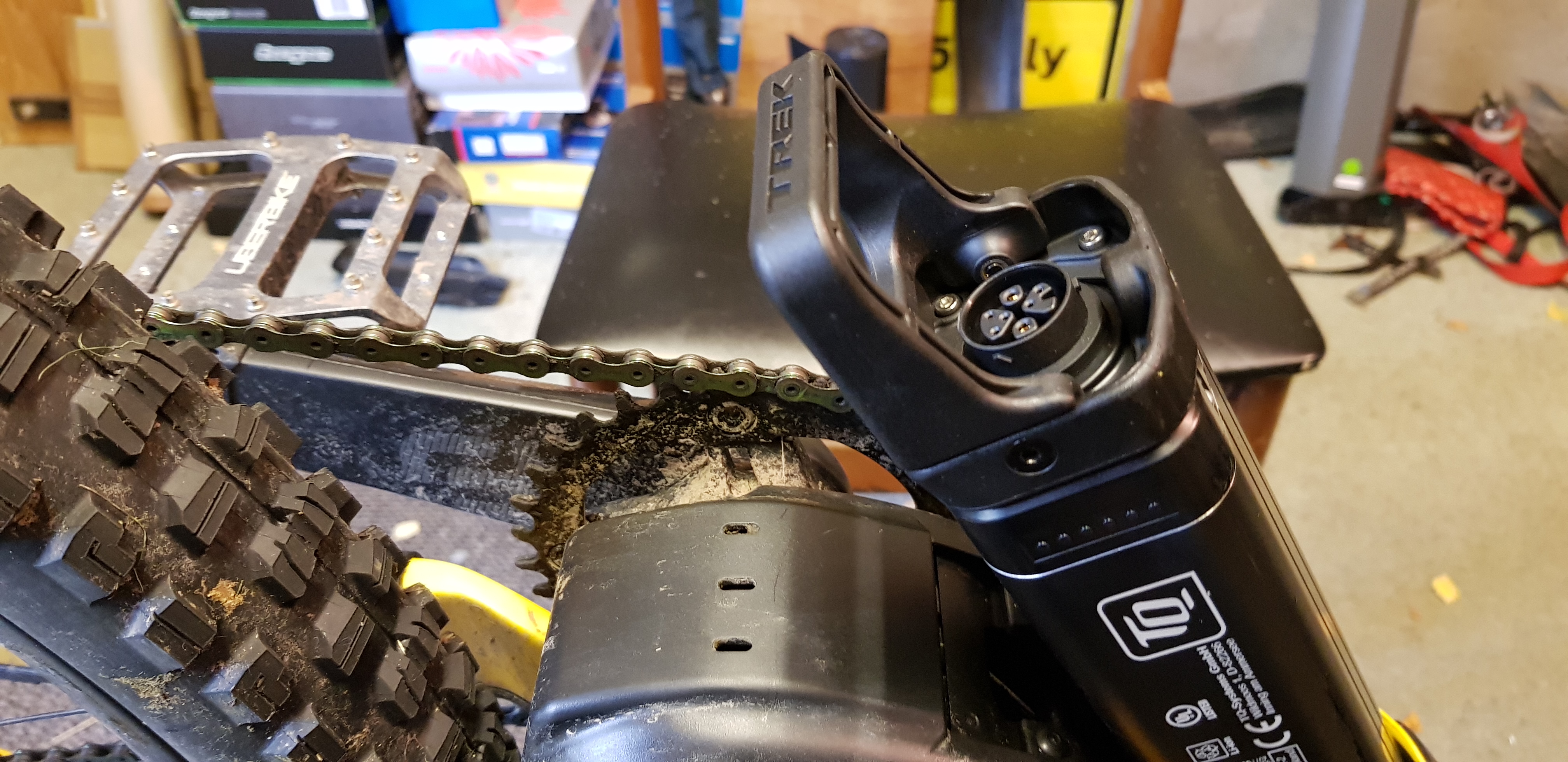

I would suggest that, when you get a minute, you all slide your battery out of the frame and check its orientation.
If the orientation is such that the LEDs are on the non-drive side of the bike then that is wrong (as was my wife's) and you will not be able to charge the battery out of the bike as is.
The end caps were incorrectly connected by 180deg at both ends and, with the pull handle positioned as it is, it is not possible to connect the charger cable into the port as the 90deg bend on the cable cannector is hard up against the plastic handle.
Page 15 of the service manual specifies that it should be done in the correct manner - but unfortunately Trek have assembled some battery packs incorrectly, slid them into the downtube and delivered them to bike shops around the world. I needed to check that I could charge the battery outside the frame and I'm so glad I did.
It didn't help my understanding of the issue that the separate schematic of the relationship of the orientation of the charge port vs the LEDs was also wrong in the manual with the port shown out by 180deg.
My wife's bike is the 9.9 AXS XX1 but this issue can affect each and every model in the entire Fuel EXe range - so be aware.
TQ knew of the problem and had had discussions with Trek Production about the issue but still some will doubtless be 'out in the wild'.....it's not a TQ error, it's a Trek assembly error.
My own 9.9 AXS XX1 is due the end of this month and this will certainly be an aspect for me to check - my bike shop are also now aware.
So do you re-position the handle or the plug to solve
You cannot reposition the socket, that is built in to the actual battery as is. (although the relevant diagram in the service manual shows an incorrect orientation relative to the LEDs)
You need to rotate the end caps at both ends by 180deg, which is straightforward, which will then allow the 90deg connector on the charging cable to connect without hindrance when charging outside of the bike. The LED side of the battery will then be on the drive side of the frame when inserted, as it should be, see service manual.
Does your bike have a wrongly constructed battery assembly then? (I can't be the only person in the world that this has happened to, can I...........:rolleyes:)
Checked my battery and both ends are correctly mounted where the LEDs are on the drive side and the handle is positioned to allow the charging cable to fit properly.
