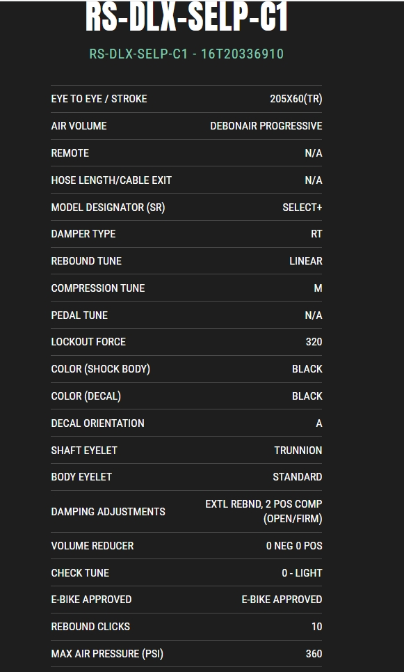

Does anyone know if there are any volume reducer tokens installed in the rockshox select+ rear shock that comes standard on the 9.5 bike?
If so, how many are fitted?

All the 205x60 Float X shocks comes with 2 spacers. You increase rear travel by approximately 5mm if you take one out, and approximately 10mm if you take both 2.5mm travel spacers out. . .

here is the data from my Deluxe Select+ from the Fuel EXE-e 9.5

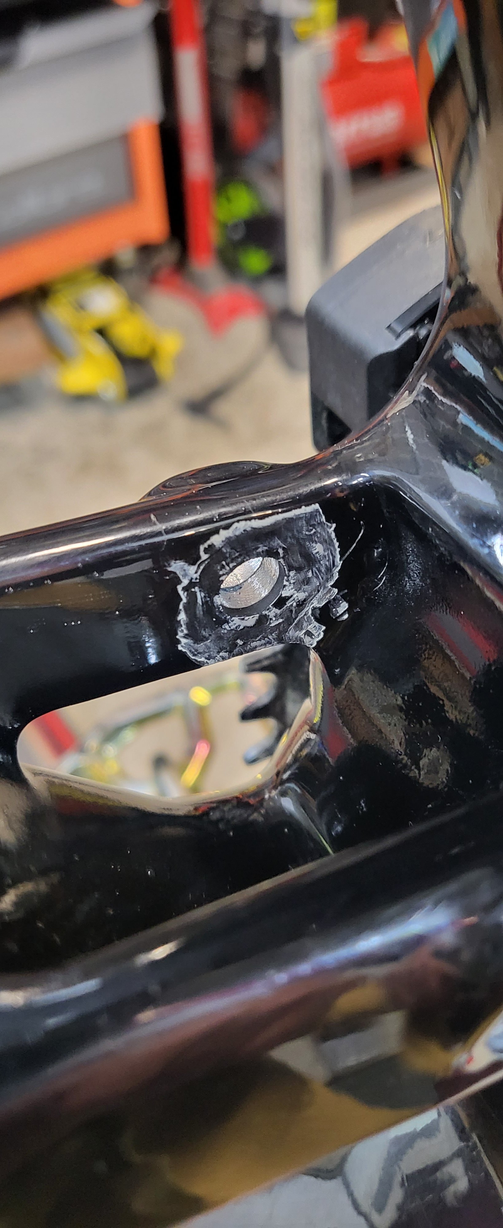

The paint durability is very subpar. The paint durability, the small pivot bearings, the headset top cap, and the lower shock mount are my only gripes. And, at least on the Matte Penny Flake, there is no Pantone or other color code for touchup paint because of all the layering.
It's a gorgeous color, but swing and a miss as far as practicality. Contrast to Santa Cruz where you can literally go to myperfectcolor.com and search by the name of your bike and order touchup paint.
And before everyone tells me to install RideWrap, that doesn't excuse the brittleness of the paint, and the fact Ridewrap might be a really good idea only makes the fact they don't have a frame only option even more annoying.
