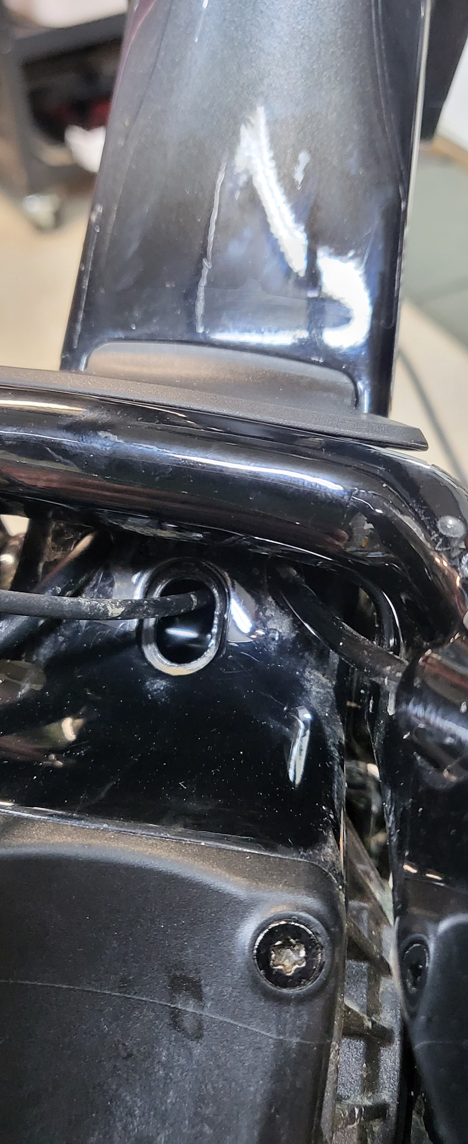

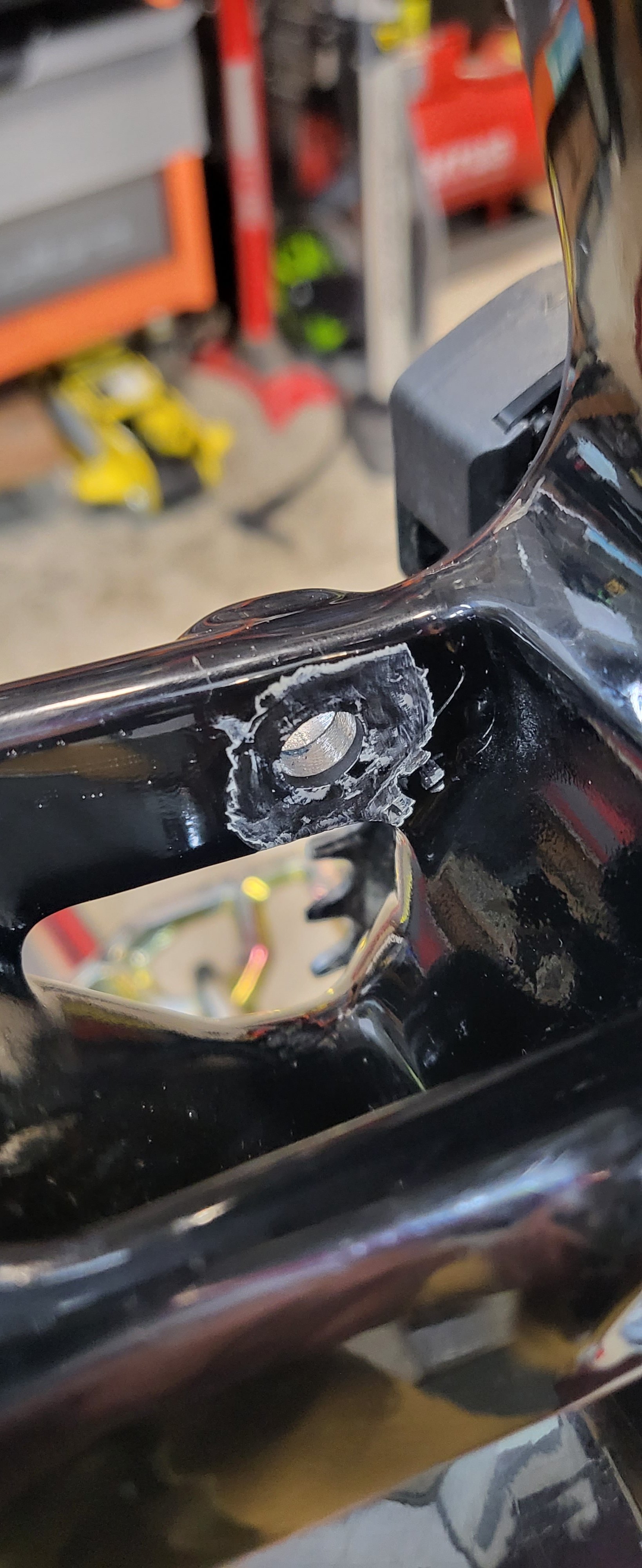

missing clip in battery cover
i just took my battery out for the first time and saw that the clip that is used to screw the bolt into when riding without the main battery is missing. It is supposed to be attached to the cover. I will let my Trek shop know next time I am there as it is not urgent for me but you may want to check Your bike. Without the clip the cover cannot be reattached as the bolt normally screws into the battery. Without that clip to receive the bolt it cannot be reattached if the battery is not installed. Why May this relevant? I plan to store the battery in the house during the cold winter months and it will be good to have the plate attached to the bike during that time. I also read that some people may want to fly with the bike without the main battery and ride with just the range extender.

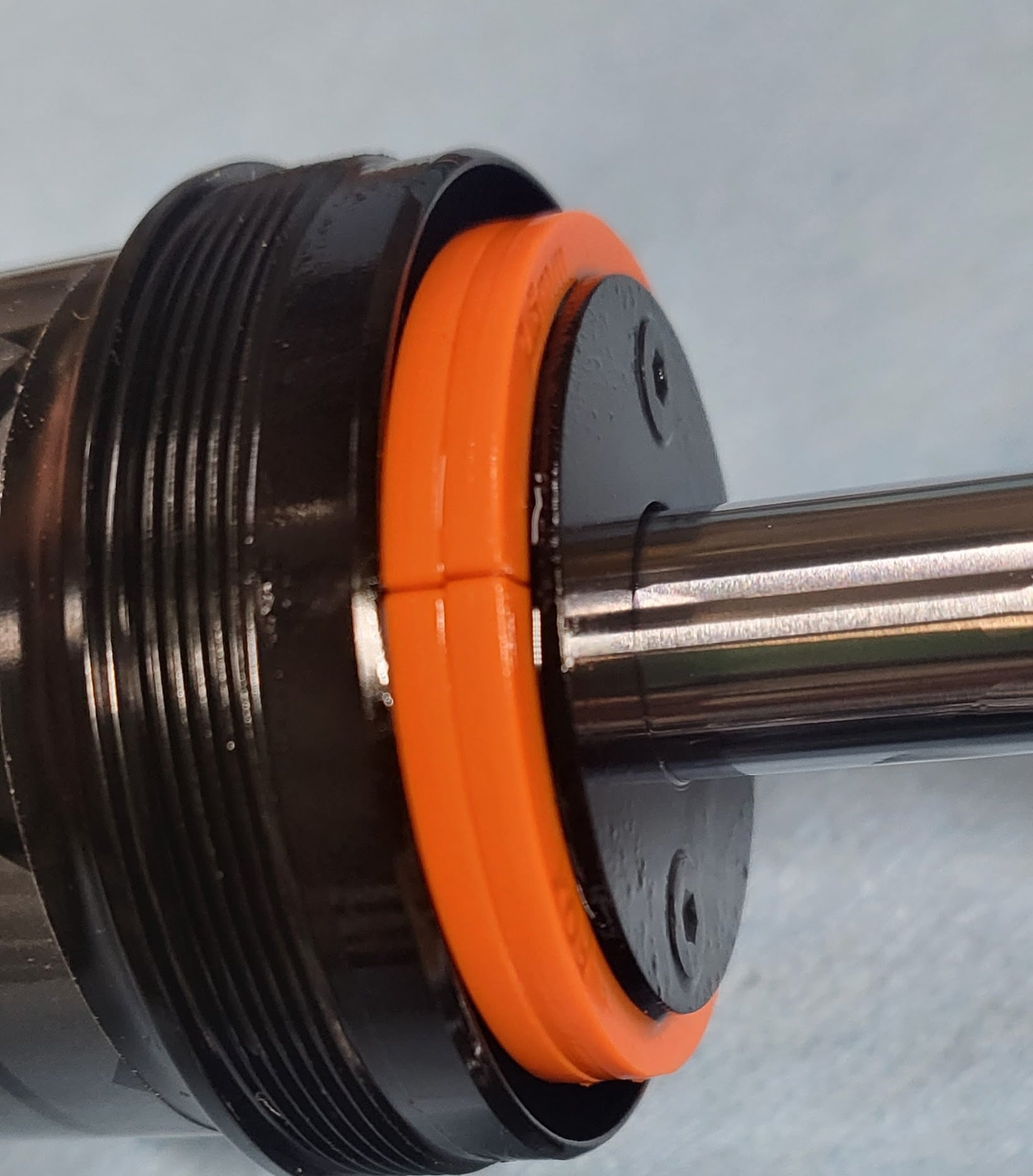

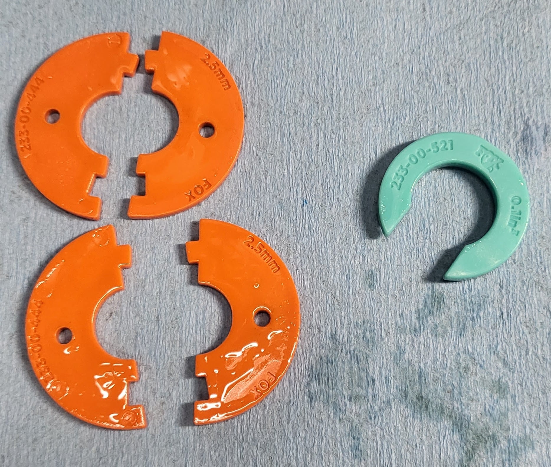

And I might have missed it, but my AU 9.7 came with 2x 2.5mm spacers and a 0.1in volume spacer ( I saw a question about this further back in this thread)

And I might have missed it, but my AU 9.7 came with 2x 2.5mm spacers and a 0.1in volume spacer ( I saw a question about this further back in this thread) View attachment 101165 View attachment 101166
All the 205x60 Float X shocks comes with 2 spacers. You increase rear travel by approximately 5mm if you take one out, and approximately 10mm if you take both 2.5mm travel spacers out.
You need shorter screws if you want to take both spacers out.
Seems like people have no issues with bottom out clearance.
