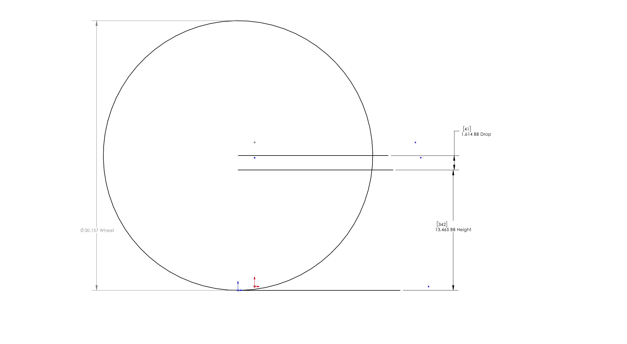

Did a quick sketch based on Treks published geo. The variable is the wheel diameter based on BB drop and then deriving the resulting 'BB height'. Their numbers work if the tire diameter is 30.157". I just did a quick tape measure on mine and its 29.75" (756mm) Bontrager 2.5 stock tire.
So with a 41mm drop and a 756mm wheel/2=378mm-41= 337mm in low. I guess 29'er is a useless number.

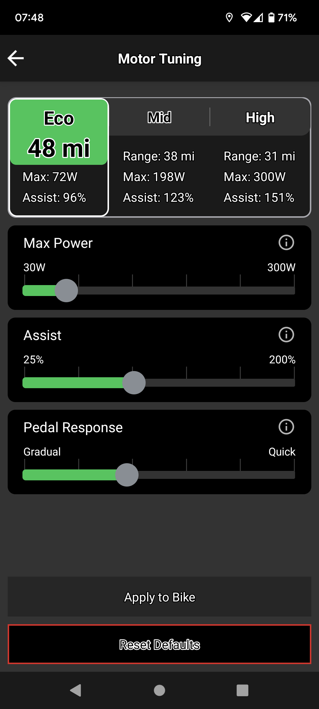

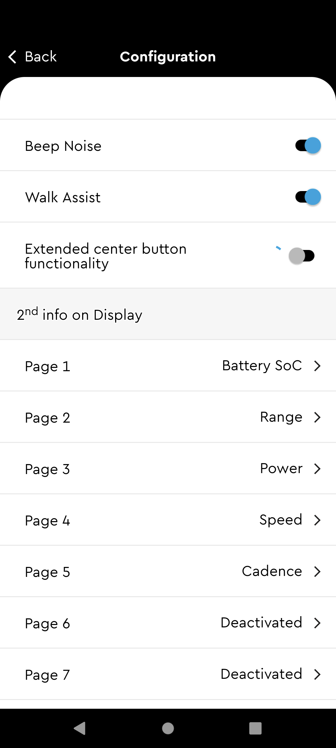

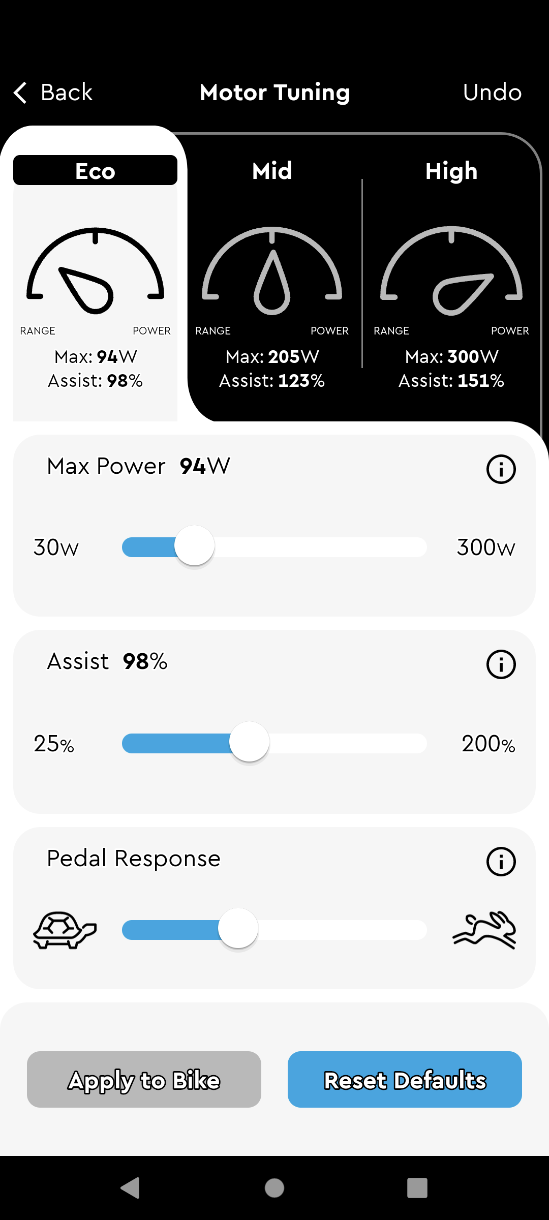

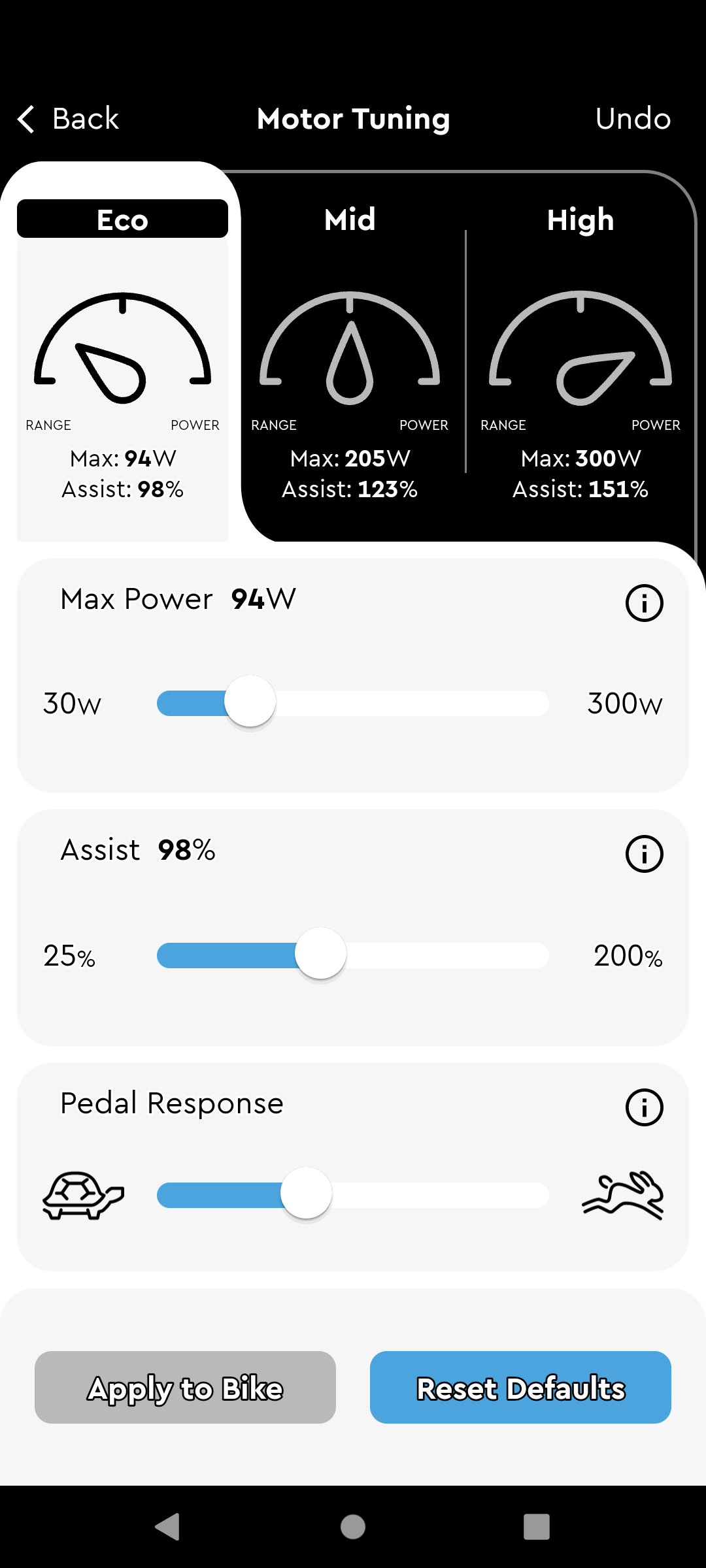

I notice that the official tq app (as opposed to the trek central app) is now available for download on the Android play store.
It seems to have more customisation options for the motor than the trek app, such as "extended center button functionality",and the ability to add more screens of data for the bike display,such as motor temperature,heart rate etc.
@Roman - what is the extended centre button functionality?
Edit: although it looks like I can't actually enable extended center button functionality,or add any of the other data pages,maybe it needs a newer version of the motor firmware than I have?
it also looks like the motor power numbers show lower in the trek central app than the tq app. Tq app screen above, trek central screen below for same settings.
Same with my 9.5 I bought at the weekend, doesn't activate 'Extended centre button functionality', whatever that will be.
I'm always careful with firmware updates, they can often lock good capabilities out (anti right to repair). Hopefully they release some patch notes
Thanks for that feedback and your questions!
1 Extended centre button functionality means you can use the centre button for changing support modes but then need to double press for switching screens.
2 The Trek Fuel EXe requires a software update to be fully compatible with the TQ App. Update is available at your LBS since November 1st.
3 You have all avalaible data pages active already, motor temperature and heart rate are not featured
is this really demanded by the customer and brands? This imo only makes sense if a bike has no remote but I can't think of a user group that would like to ride like that.
wouldn't it make more sense to map some extra functionality to the 2s button press? for example switching to other profiles (different setup for 3 support modes as wished from somebody in the feature request thread). Or something else.
Someone did mention on the TQ feature request thread that they would like an alternative way of changing modes , they had experienced a failure of the handlebar switch that meant they couldnt change modes . I'm sure that TQ had already developed this feature before they read that comment on here though.
I think its useful to have the option to change modes in a different way, for exactly the reasons described above, but its quite a niche thing.
I'm interested in why the TQ app shows higher max power figures for each mode compared to the trek app, when they are each connected to the same bike. This is purely from a nerdy perspective as it wont make any actual difference when using the bike.
Its necessary for bikes, that do not use a remote. There will be road bikes with the central display unit only.
Yeah, i understand what you mean. On the other side, the product as a whole is also about simplicity and focusing on the natural ride, therefore we dont want to overcomplicate.
shame that the exclusive trek display is limited regarding features compared to the default. however I think I've noticed bpm on the segment display greyed out in some videos. but can't find it now. maybe some of the owners can confirm.
It is not, you got me wrong! Heart rate might be a future feature, motor temperature will probably never be. Both are not available for anybody today.
