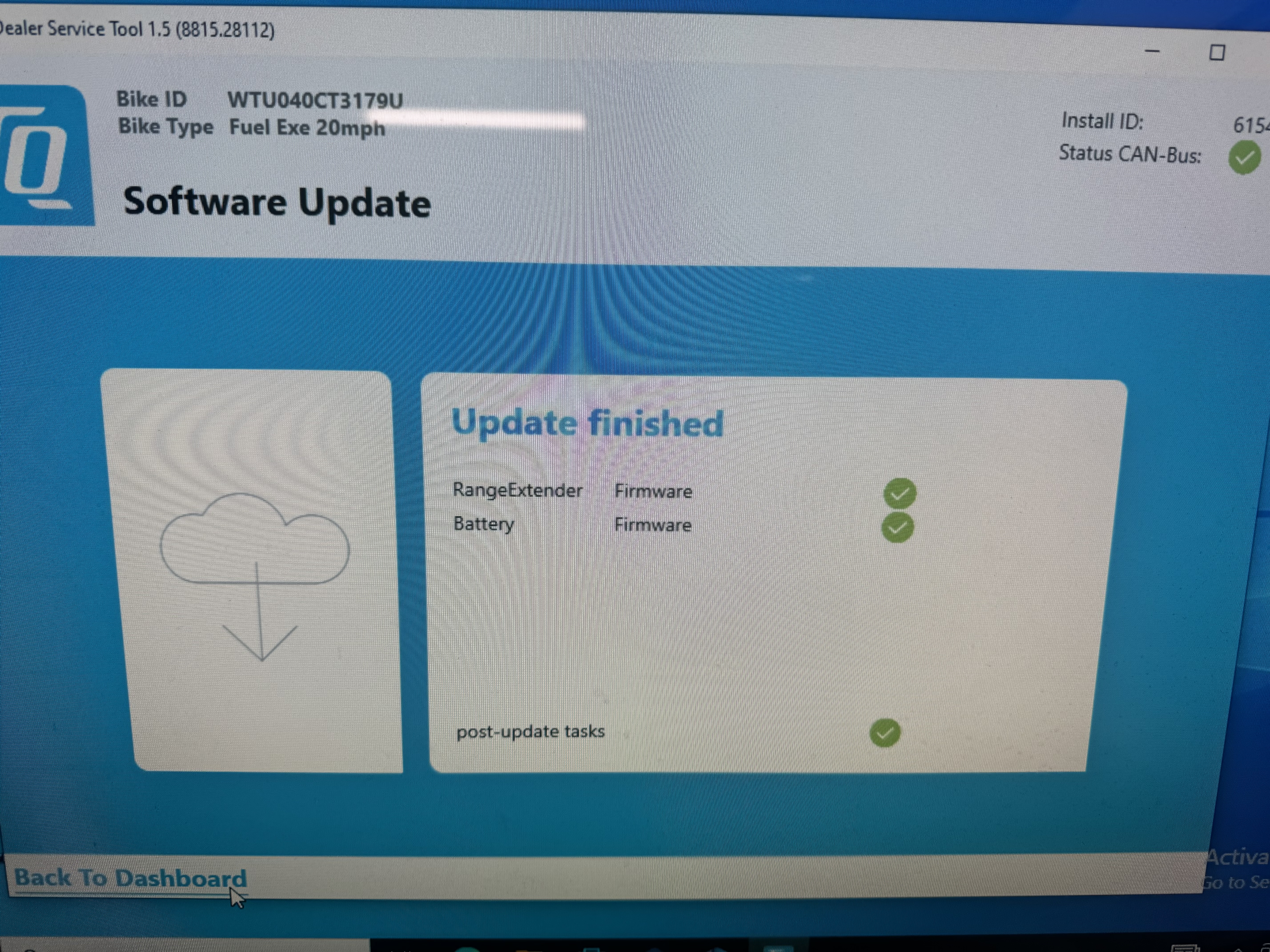

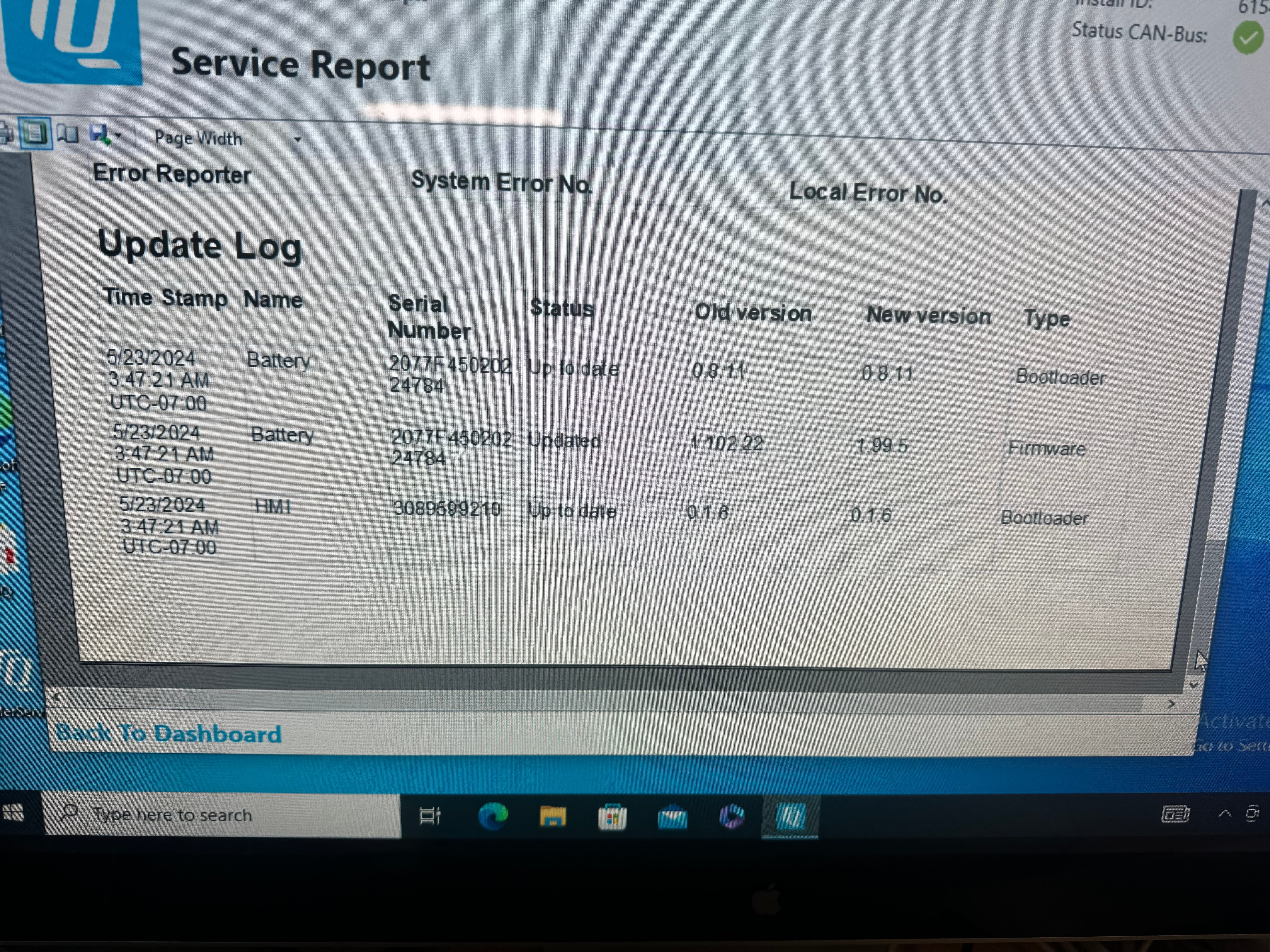

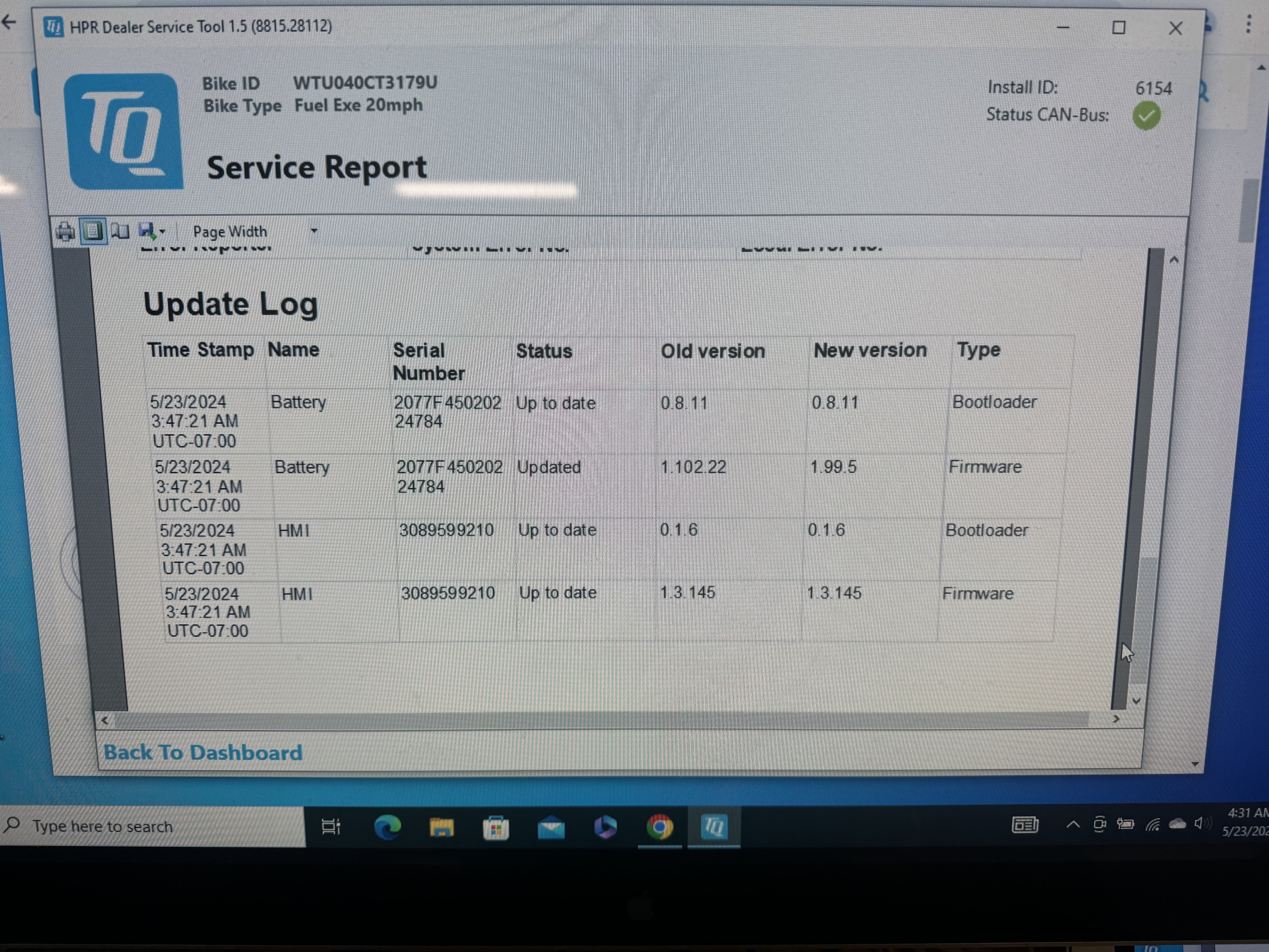

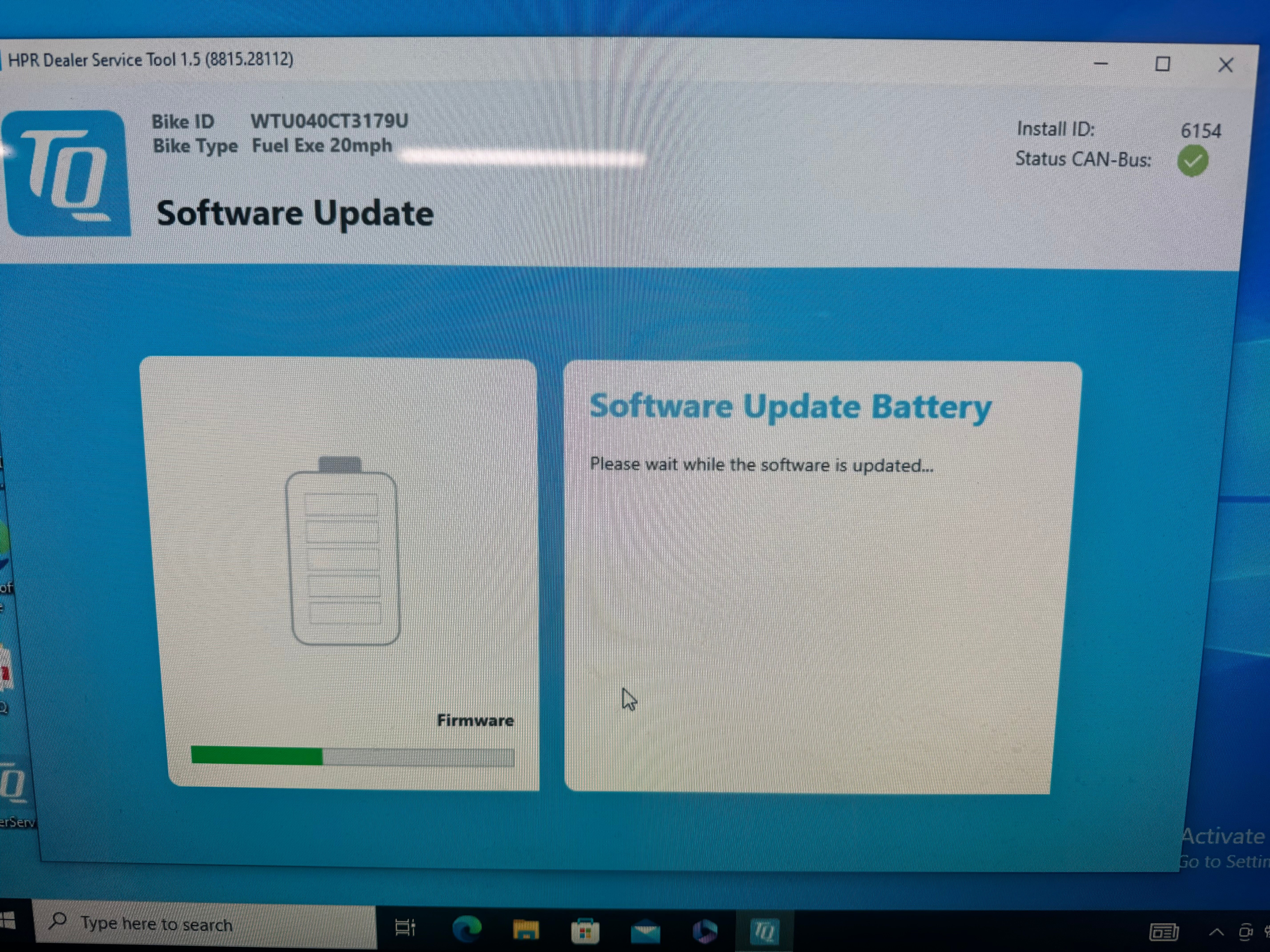

Was at LBS today and updated the firmware of all components.
Still can't see firmware versions on the TQ app. What could be the reason?
For those that have the ability to update their firmware or has a bike going into service anytime in the near future. The service tool is currently reverting the firmware to an older version. I am not sure if this is intended or a bug so I have reached out to TQ for clarification. The firmware affected is for the battery and range extender. Everything else matches TQ’s website.
Side note: TQ app loses the ability to see the firmware version as well but I believe that this functionally was part of the latest update.
View attachment IMG_1259.jpeg View attachment IMG_1260.jpeg View attachment IMG_1261.jpeg View attachment IMG_1262.jpeg
View attachment 141012 View attachment 141013 View attachment 141014 View attachment 141015
Please update if you learn the reason

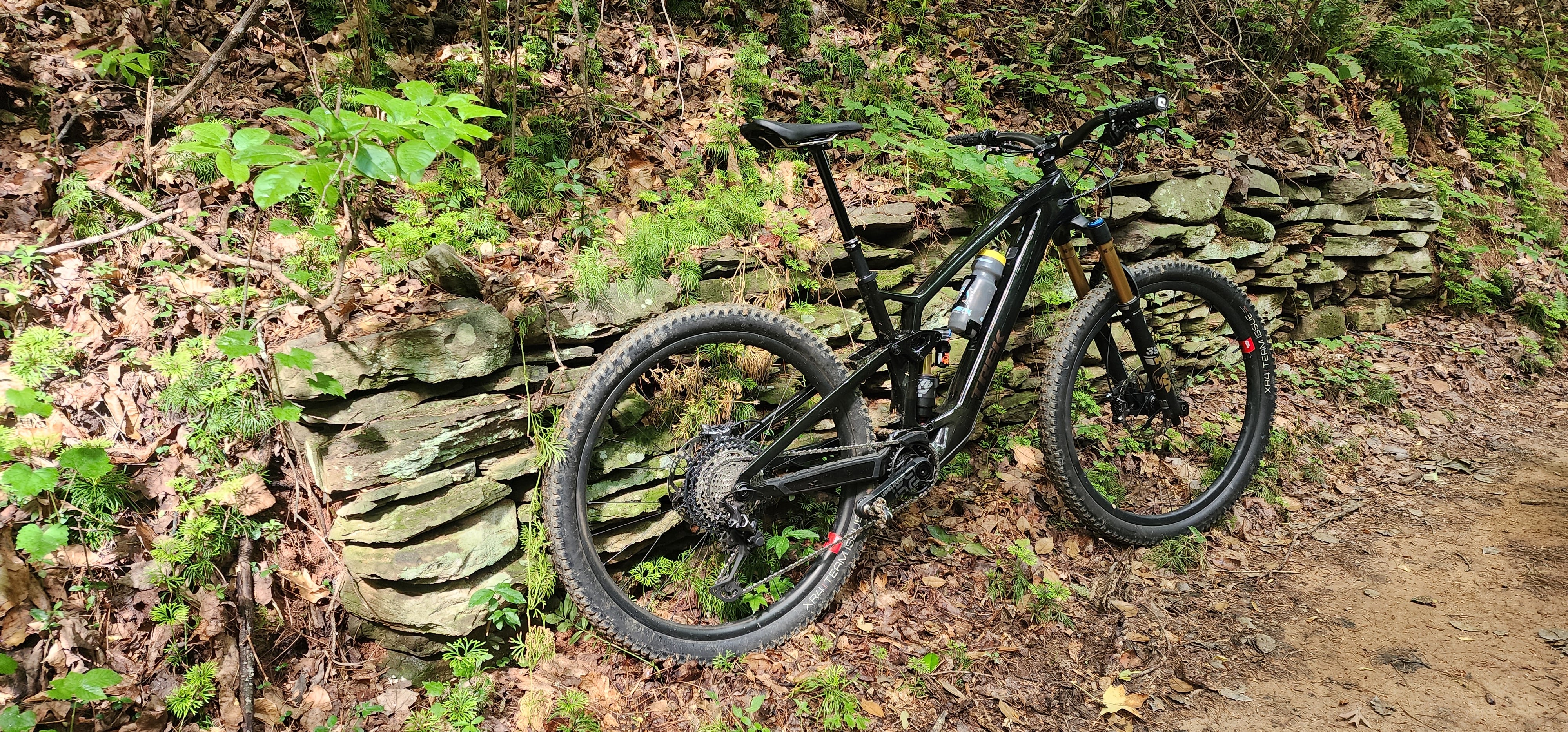

The X2 has been a very worthwhile upgrade.
Just wanted to follow up on the adjustments in reference to pedal strikes. Moving to the high position all but got rid of my issue. Have not noticed any negative results of the change. Still running fork at 150. Will be making that change at some point, maybe next service.

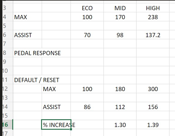

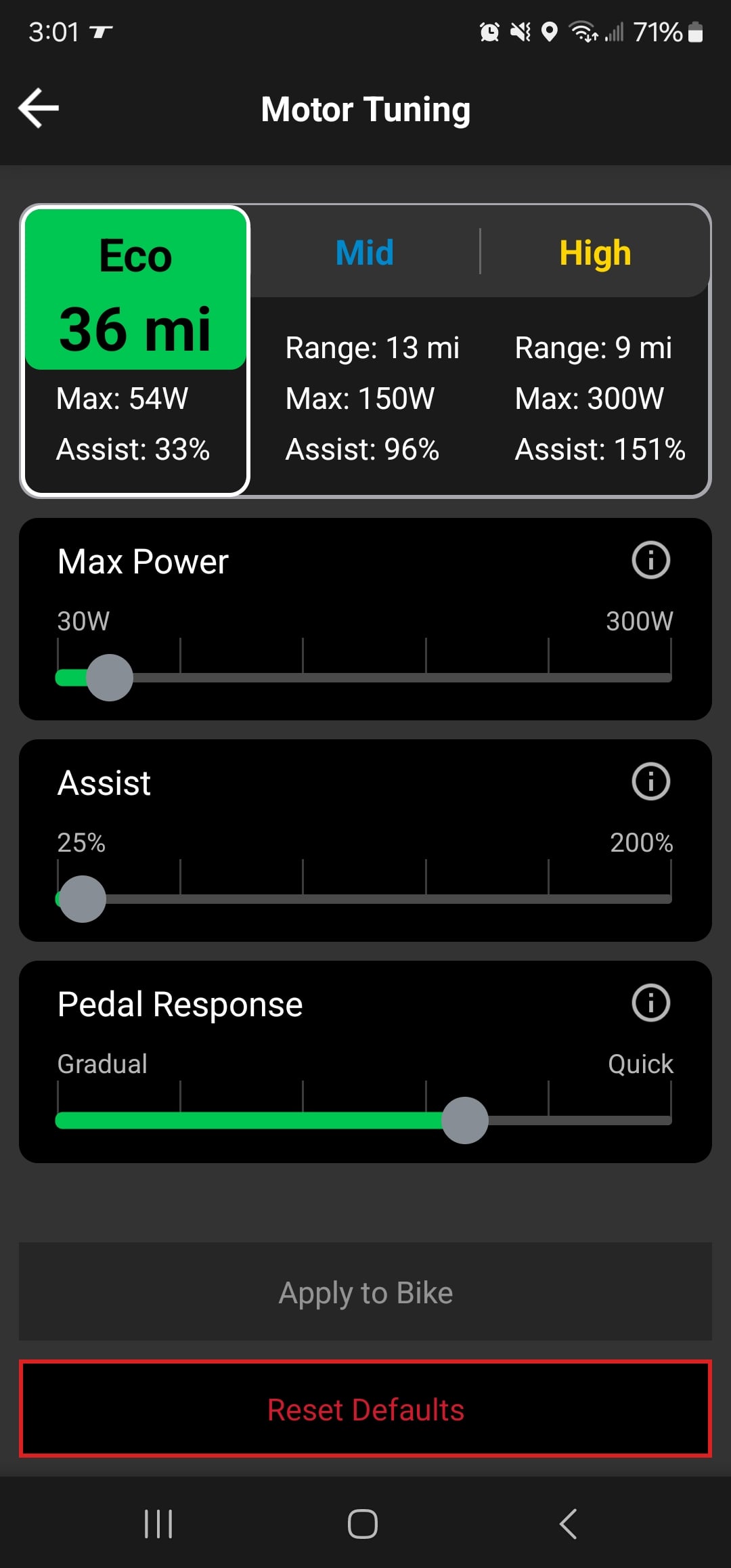

Thanks. I am well below where you are set. Will have to some more experimenting. I feel like I am working harder currently on eco mode than I do on my normal bike. I did a ride yesterday mostly on mid and used high for a couple sections.
I am still a little fuzzy on exactly what the % assist means.
IOW, does it mean that it assists 33% up to 54W, or something else?
DugT
Sep 4, 2022
136
119
Truckee, CA
I set my assist levels up a couple of years ago and now I don't remember exactly but I think your example is correct.
